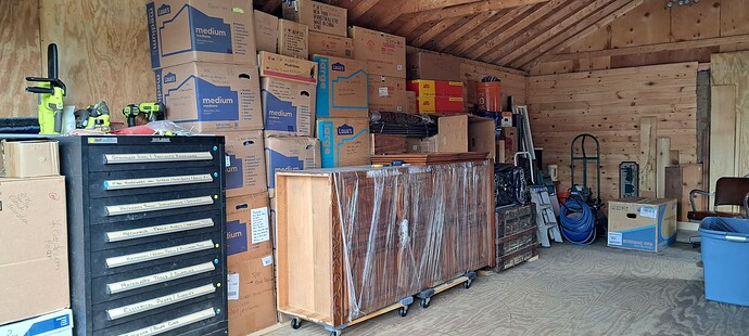

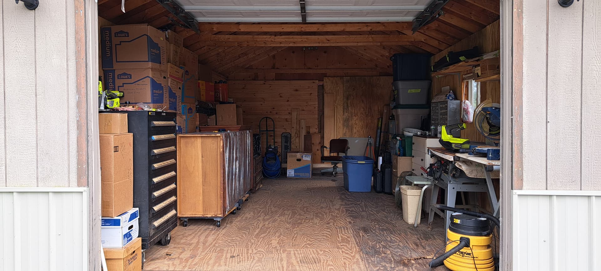

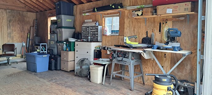

As a first step, today I organized all the boxes and bins. I went from a random mix not piled very high to large piles of same size boxes or bins. My tools and saws are accessible and set up.
At least the center is clear…
Some of those boxes are tired of being moved. I hope they don’t crash. That happened to one pile in storage…

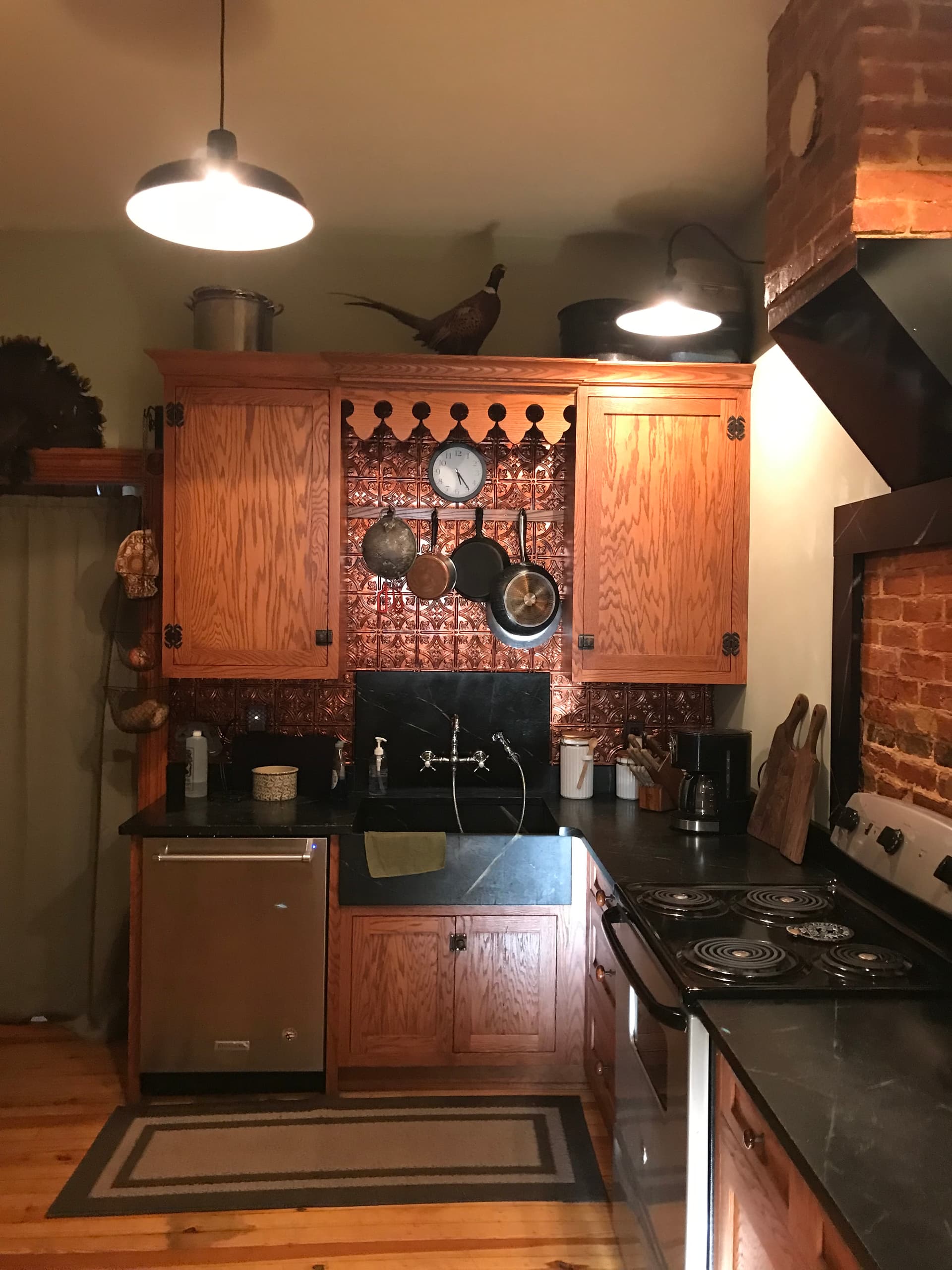

I’ve pretty much decided on a suspended drop ceiling. Have y’all seen the simulated tin drop in ceiling tiles? The FEBT used them in the Robertsdale museum. They are pretty cool. They also make rusty corrugated metal panels. They are cool too, but cutting to fit is much more work.
shopping
Jon, will they absorb sound or reflect noise?
They are plastic, so not absorbent. Not the same as acoustic tiles.
Yes,
Used the same material for my kitchen backsplash when I gutted and redid it in 2016.
