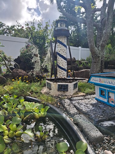

Our inspectors debarked at Haluku’ilio (Dog Wall), the main harbor of No’u’ea.

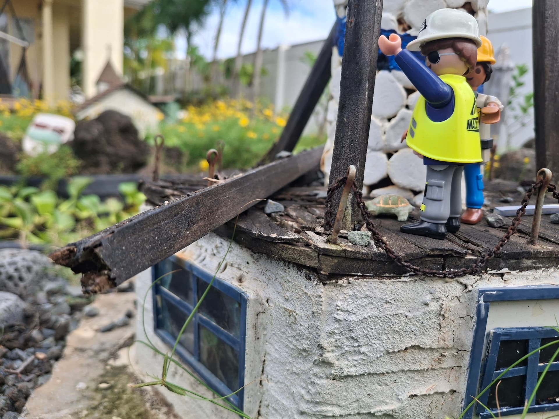

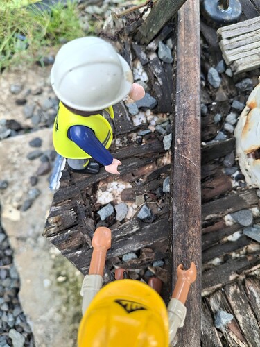

Five years have taken their toll on ke Hale Ipukukui o Haluku’ilio (the lighthouse at Haluku’ilio). Rust is visible from the station, and the support beams have collapsed.
Clearly, it is hazard to the keeper and surroundings and thus no help to mariners!

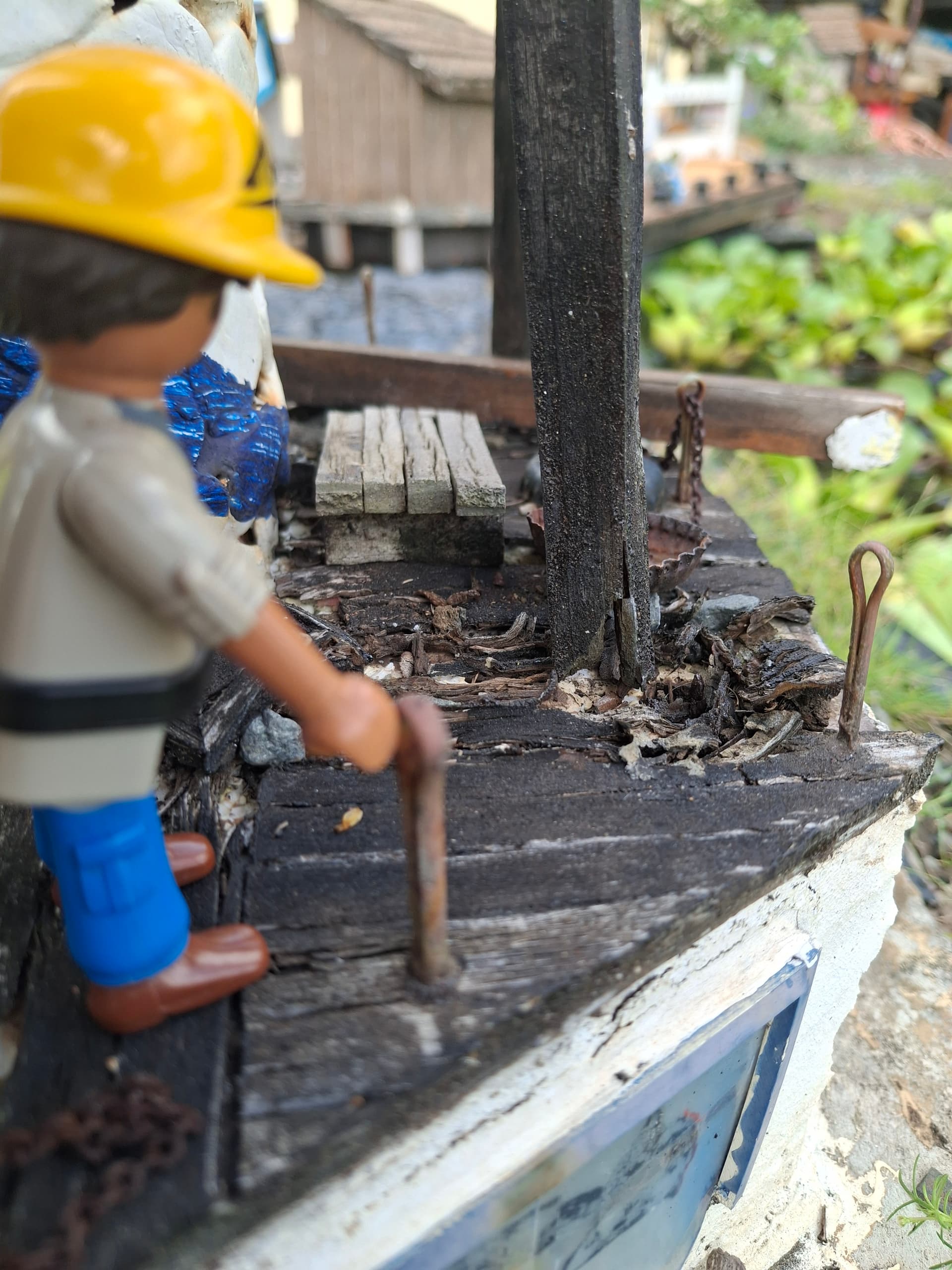

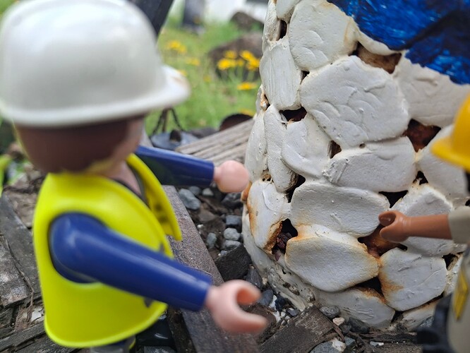

Closer inspection shows serious rot at the foot of one of the support beams.
Rot on the roof deck was everywhere and severe.

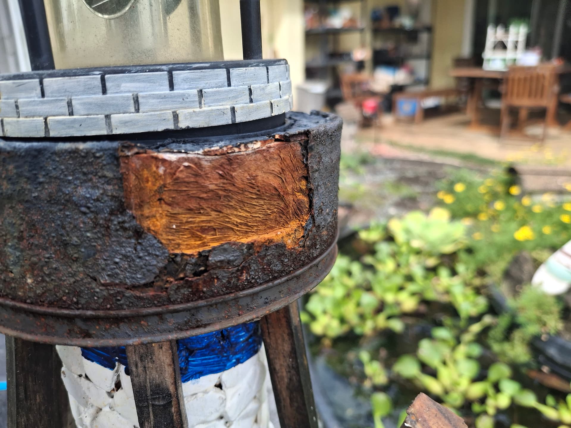

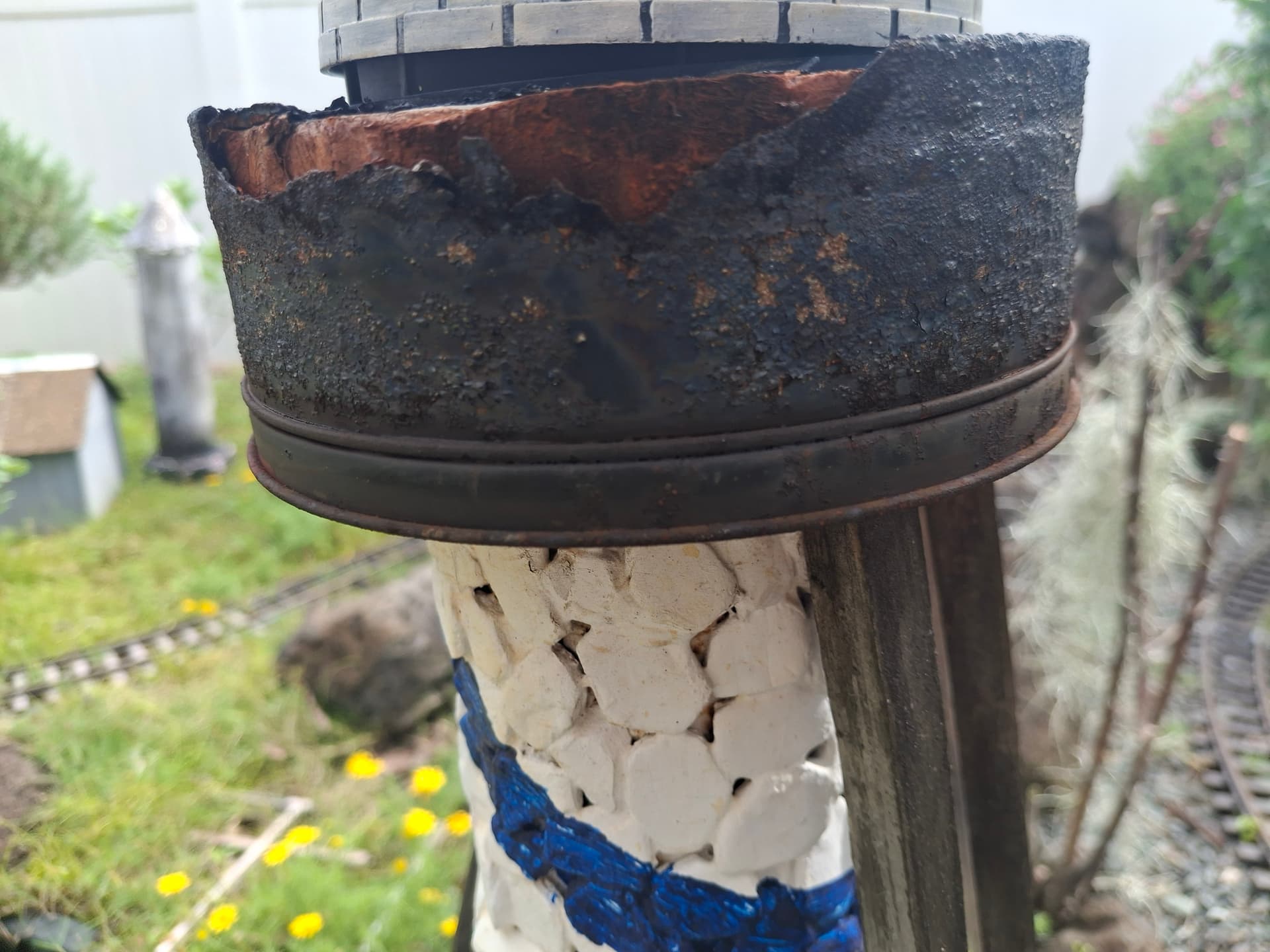

The tower structure, soup cans behind foam “rocks” and latex paint appeared solid, though rust was bleeding through.
The light platform was a totally different story. This cookie tin had all but surrendered to the elements!

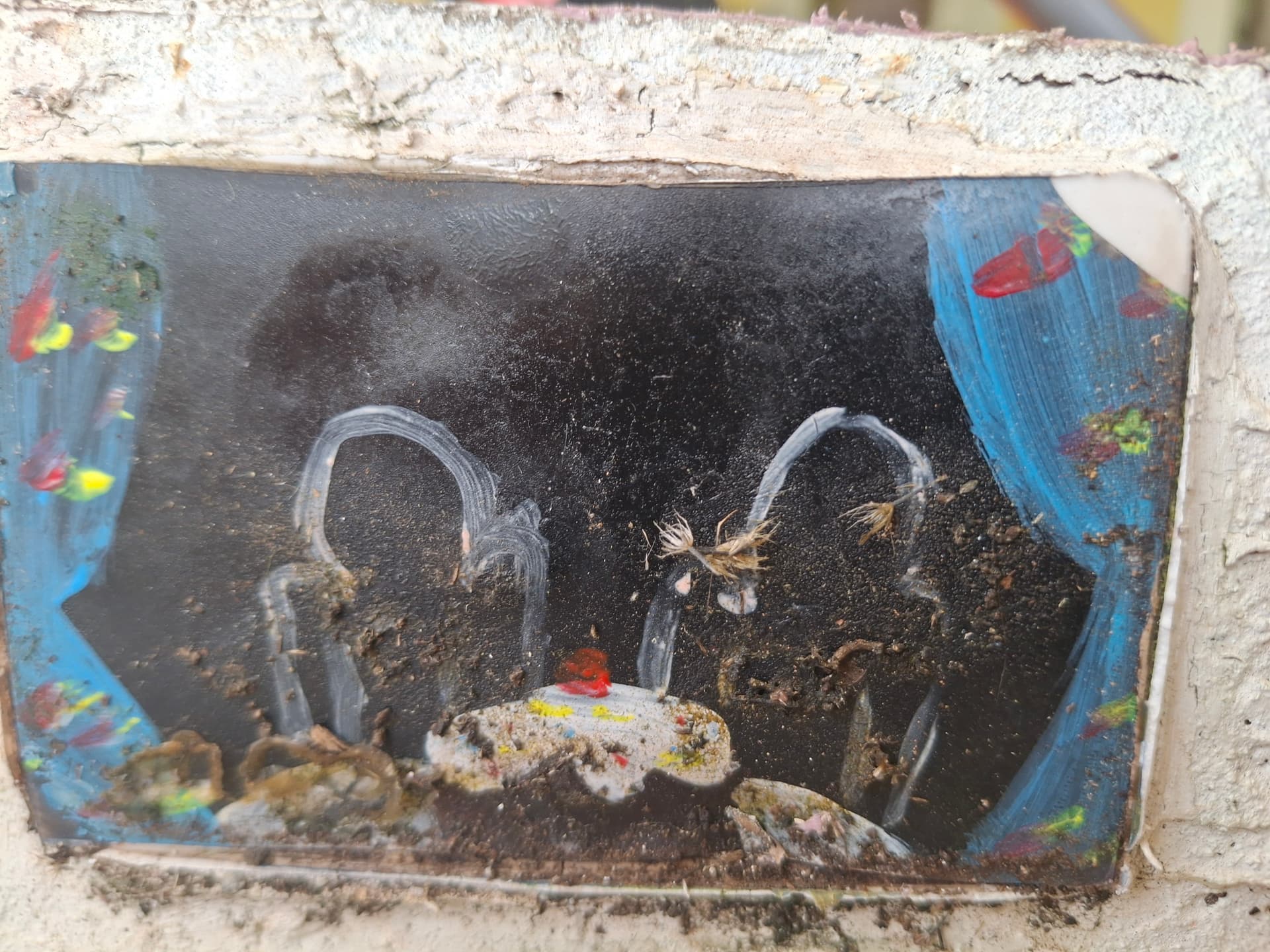

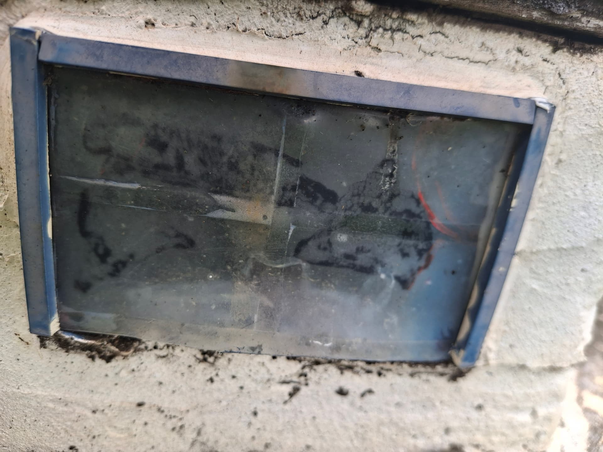

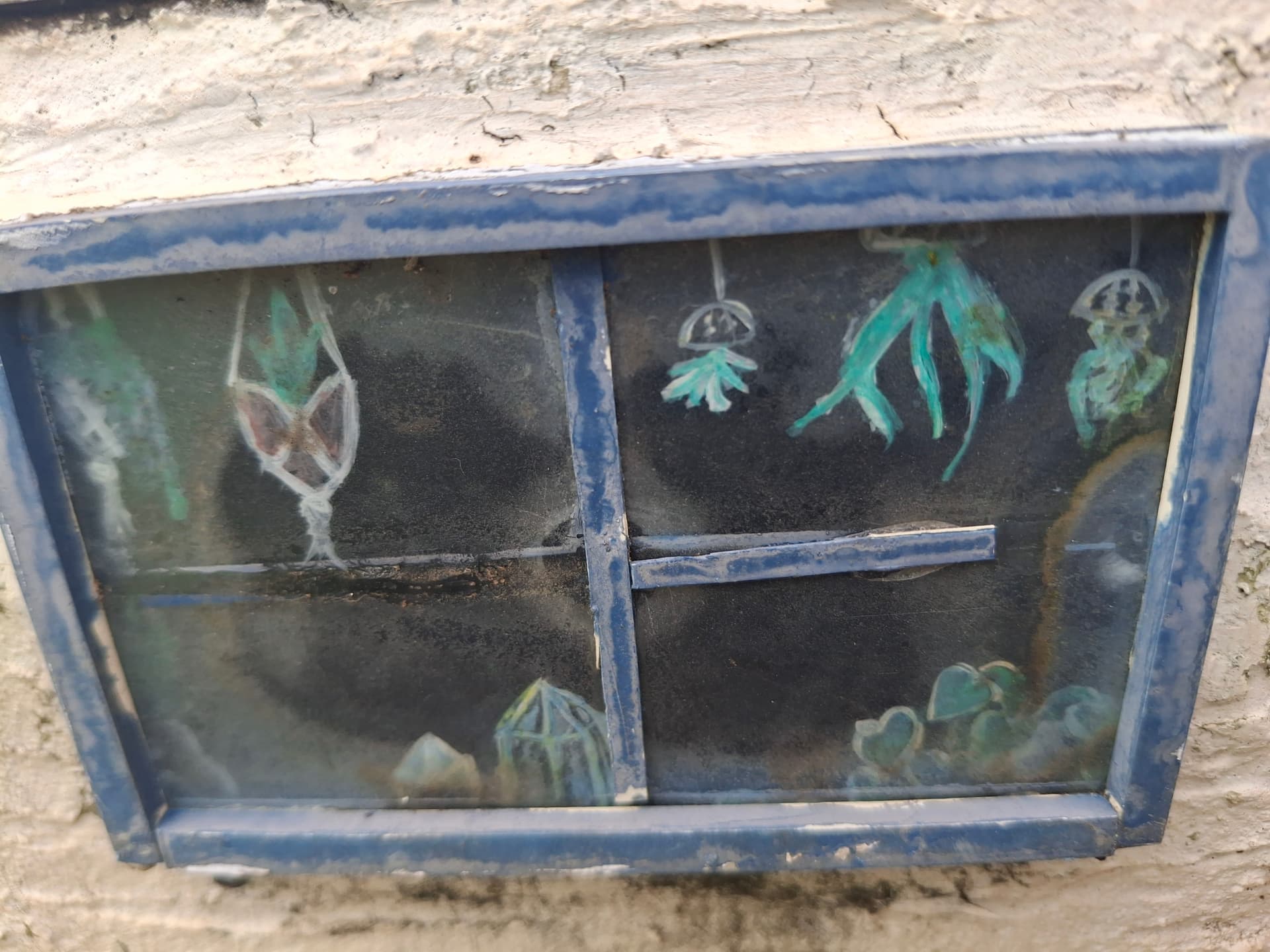

The windows were two pieces of plastic, with the girls drawing on one, an an outer sheet applied over the top. The artwork, what I think is the most important part as it, more than anything, places this building in time, seems to have survived.

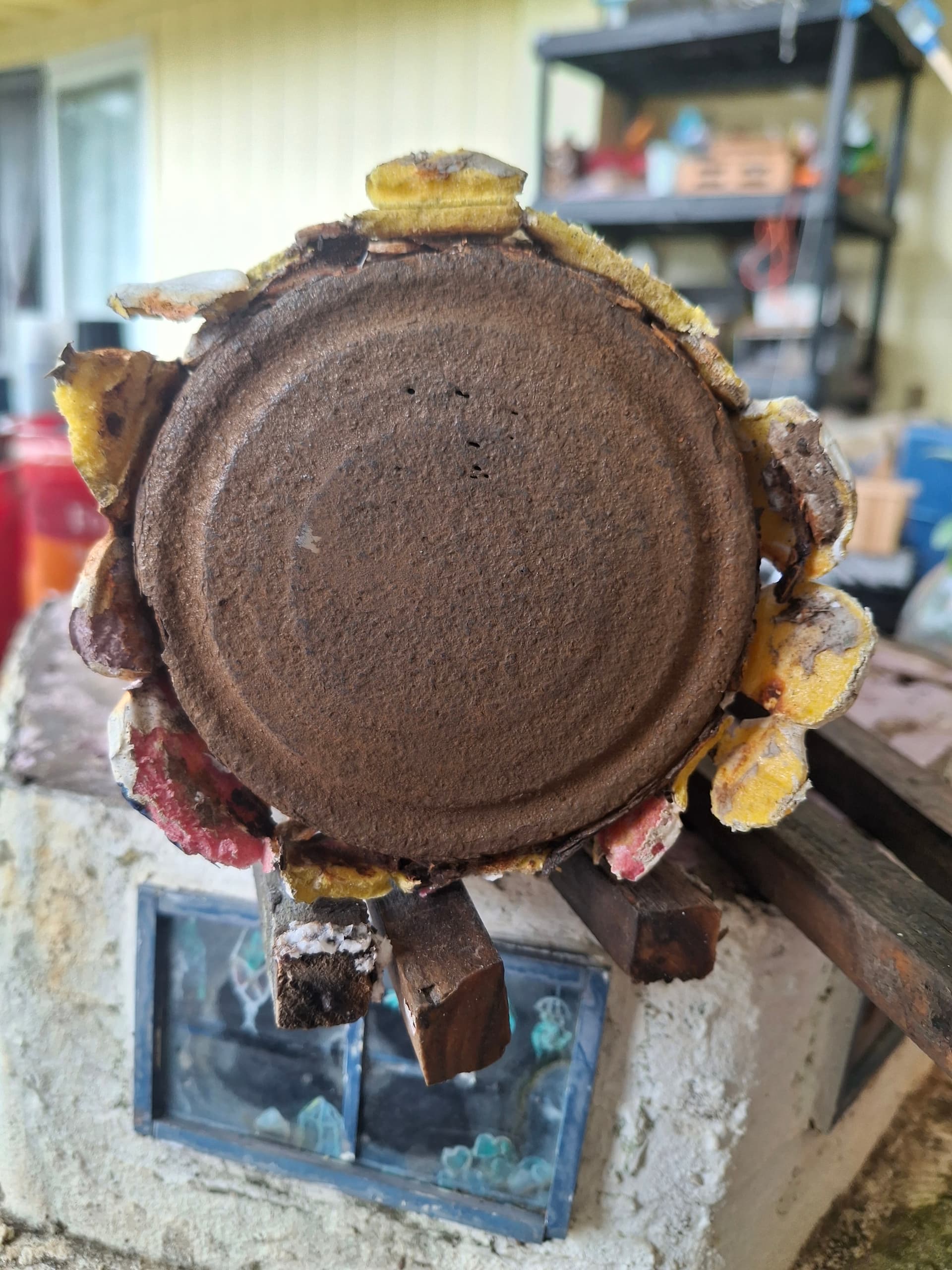

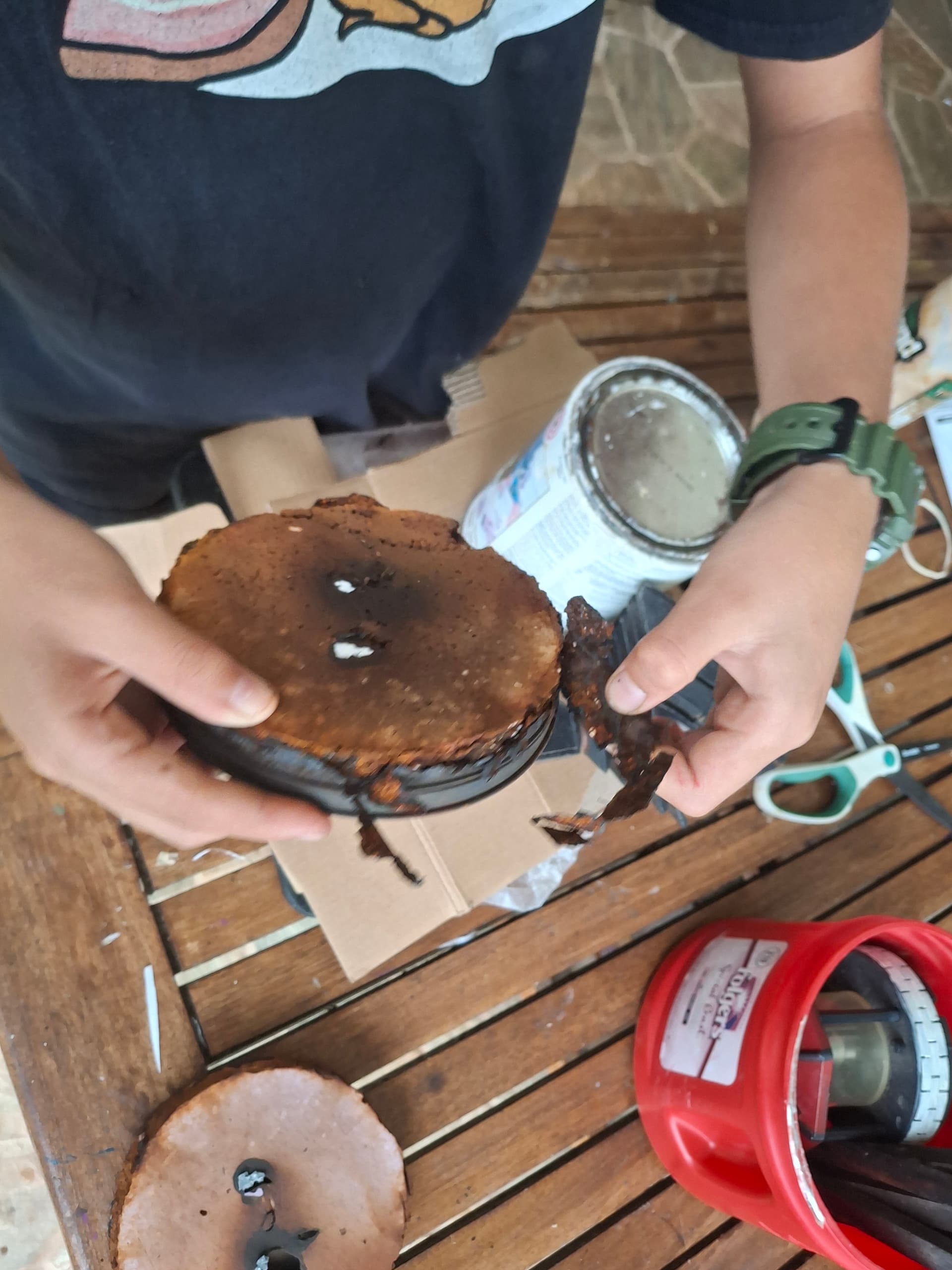

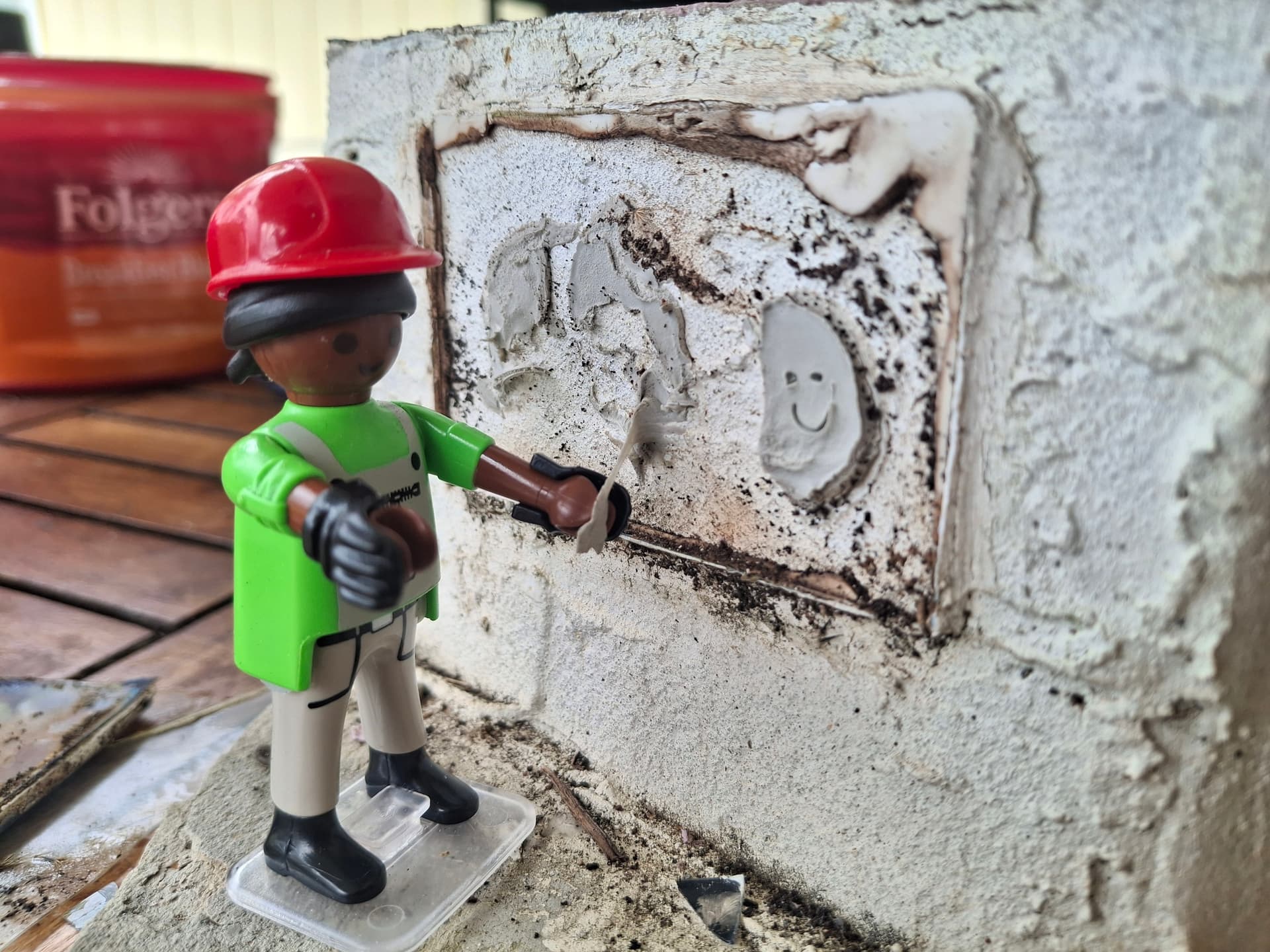

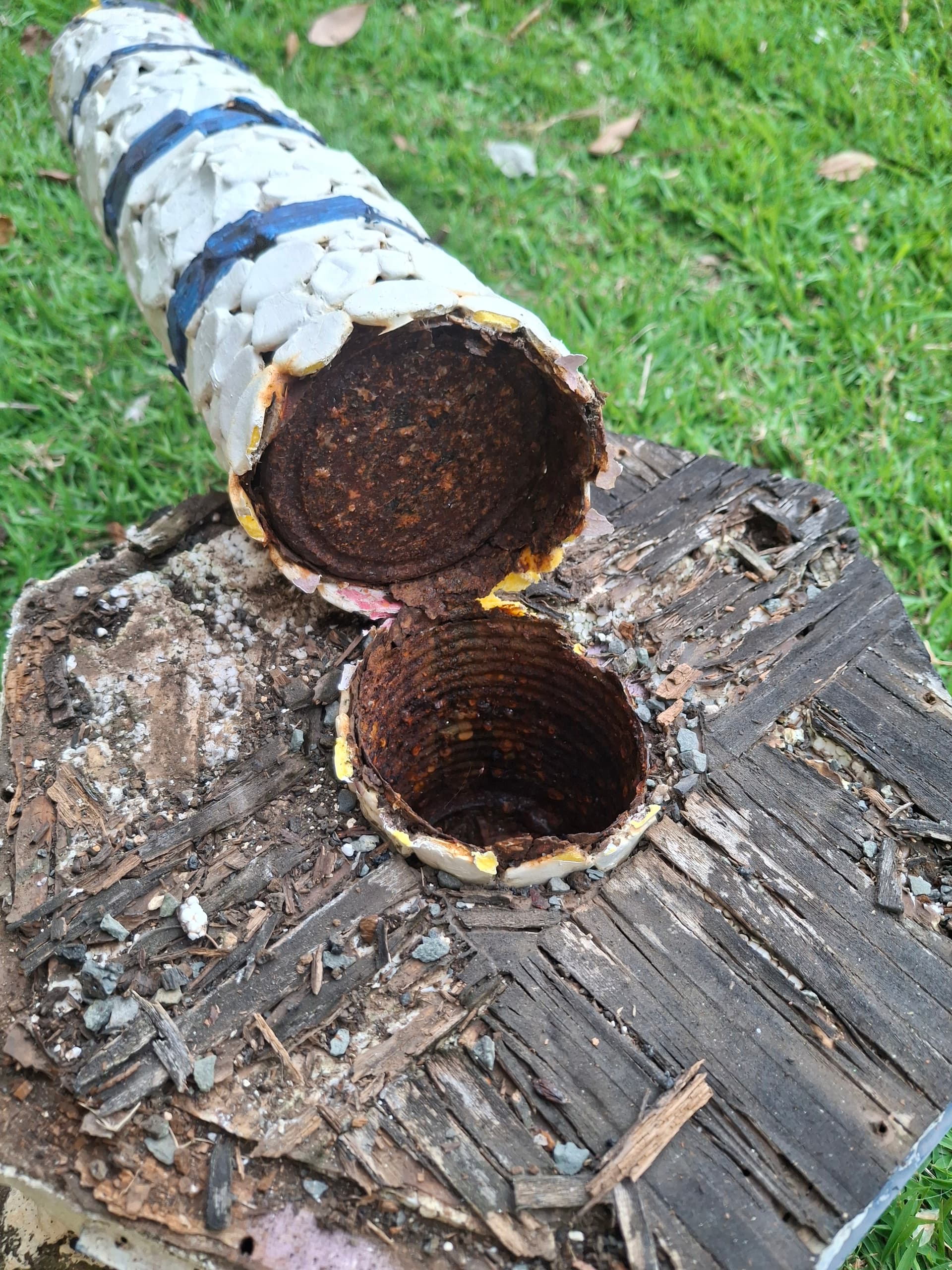

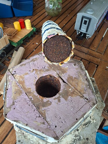

So, it looks like I ate my words!
The top of the foundation can was entirely rusted out, and the foam “rocks” were keeping the tower up! The last shards of metal snapped as I started to scrape off the old decking material. My guess is that water simply built up near the base of the tower and the tannins of rotting wood hastened the corrosion. During the rebuild, I’ll tape a hole in the floor for drainage, and I’ll figure out a way to lift the tower slightly above deck level to prevent puddling.
The building is sound.
Foam is immortal!
Kid-zilla joined in the demolition progress, and pealed away the cookie can (I should’ve had him wear gloves).
He thought the rust-infused foam looked like a big cookie! The foam bit in the lower left of the photo was part of the insert. There appear to be burn marks. These align with the battery, so I wonder if, at some point, we had a short or if heat from the light was enough to make this smolder.

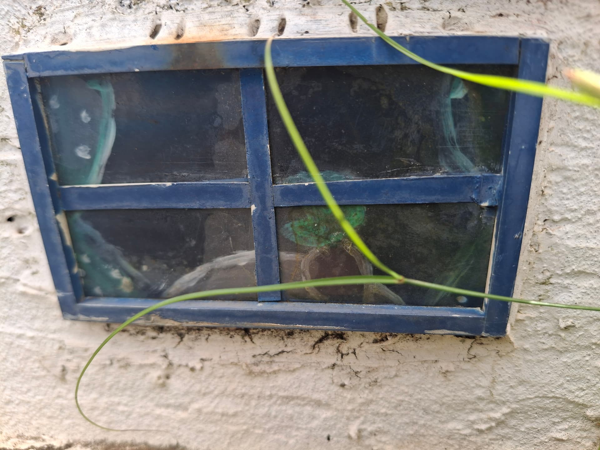

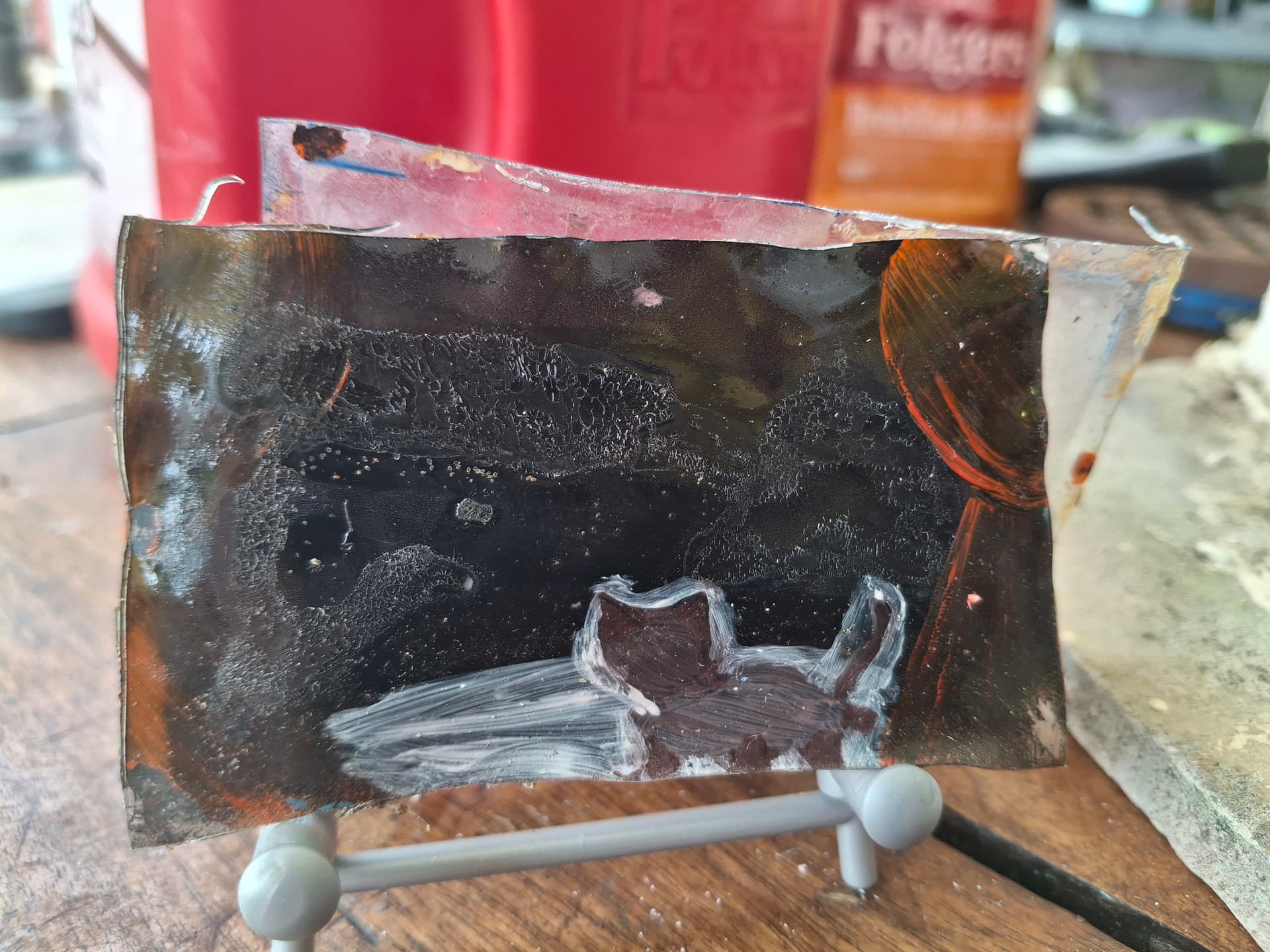

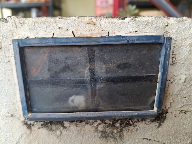

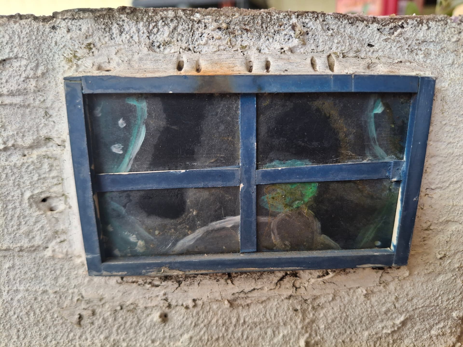

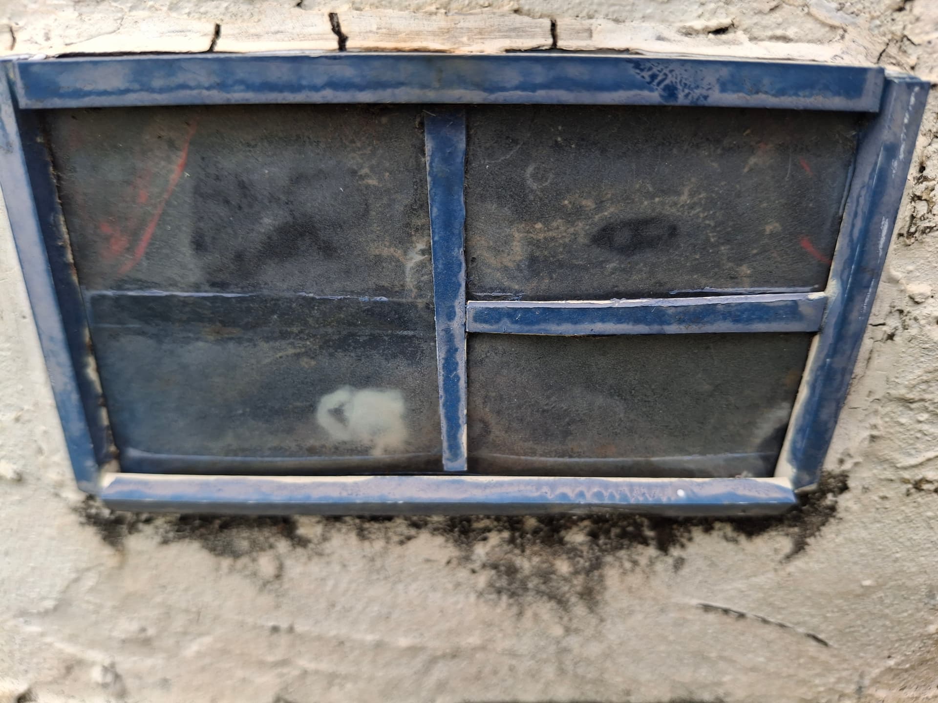

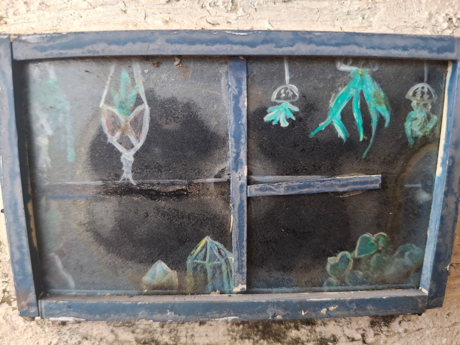

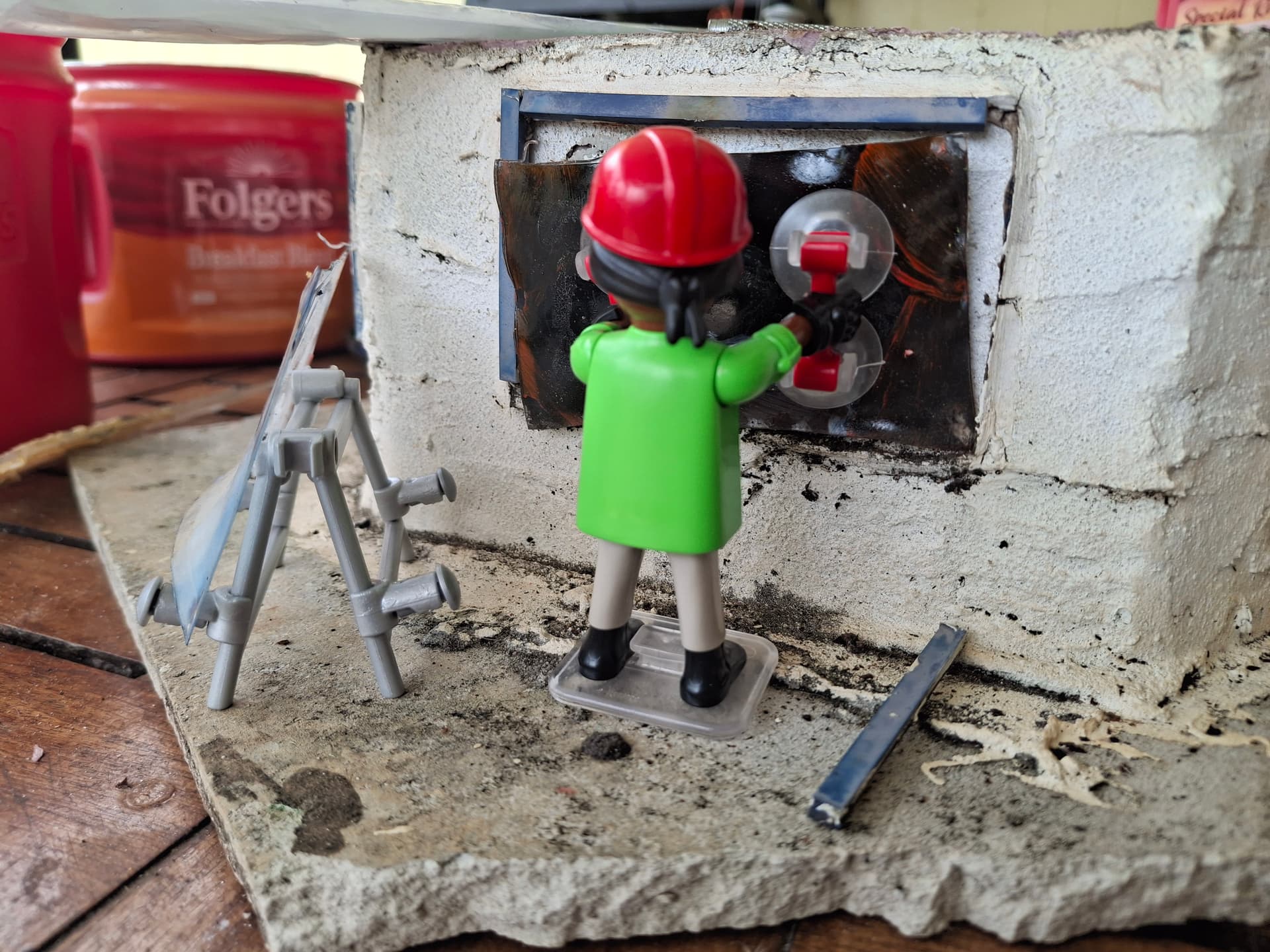

Next, I brought in a glaser to help with the windows.
The windows have the girls’ original artwork, the most irreplaceable part of this tower.
As you can see, the outer plastic is shot!
About half the windows got shrinky-dinked, but the underlying artwork was relatively OK. Less damaged windows like these will be left alone.
Sometimes, with preservation, you have to know what is fine as it is!

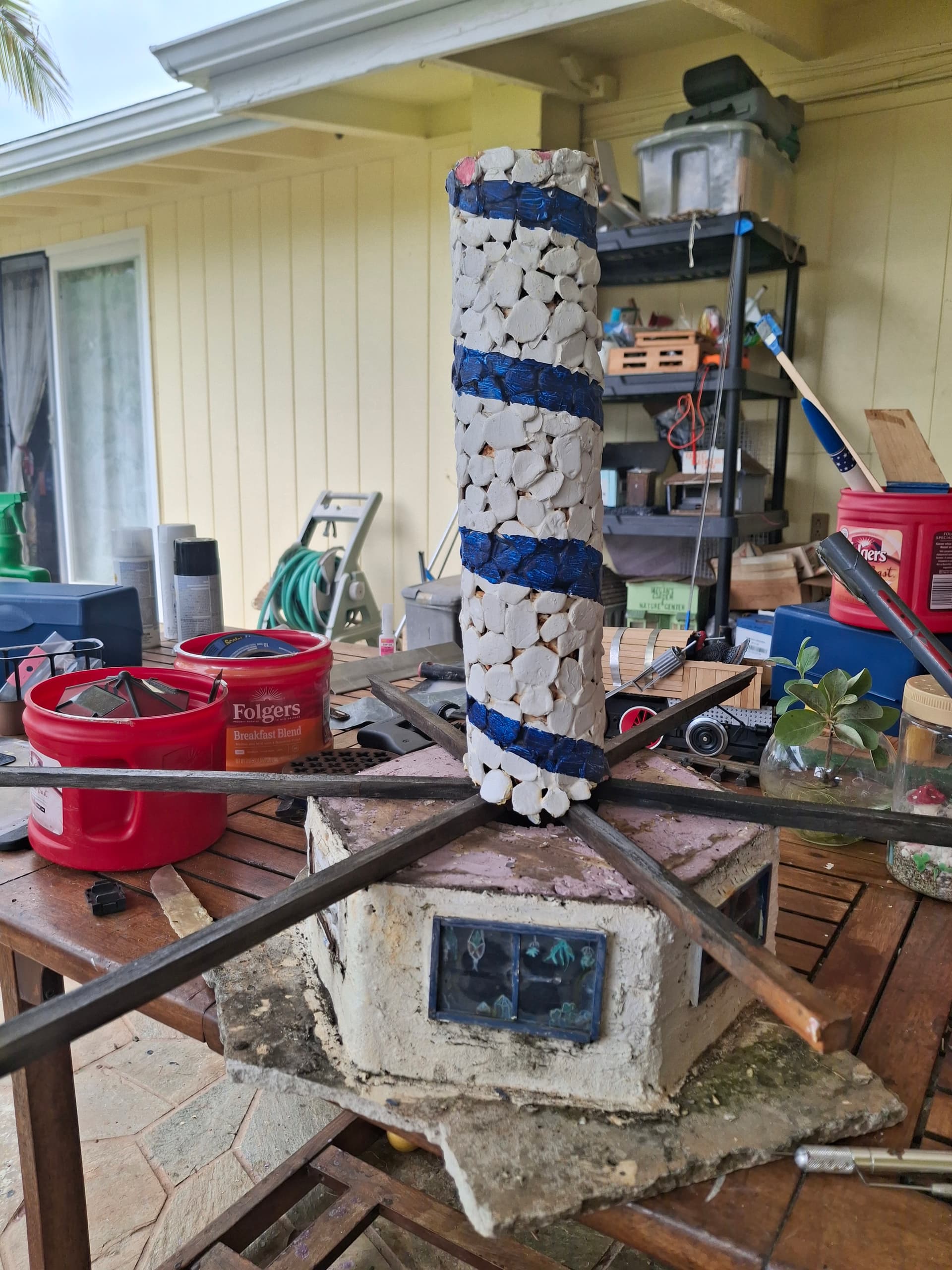

The 1:24 gang and I focused on converting the salvaged buttresses into supports for the tower’s bottom, first by carefully measuring how much we needed…
…then by chopping them to size.
I was impressed, really, how well the TiteBond III seal preserved all but the bottoms parts of these pieces, which you can see here:
The cores are pristine. Needless to say, lathering projects with TiteBond III will remain a Triple O best practice!
Next, we laid out our network to see where the notches had to be to receive the tower.
It was at that point that I realized I had no idea how I was going to cut those notches!
The gang and I experiment with both the chopper and a mini table saw…
…only to discover that circular blades make circular cuts, so that what looks good on one said is totally kapakahi on the other.
Some epoxy putty fixed this…I hope.
I then switched to hand tools…
…which went a whole lot better.
After this, the lads and I carefully marked where the tower would need to go…
…aligned the timbers, and glued them in place.
We finished the day by weighting it all down while it dries.

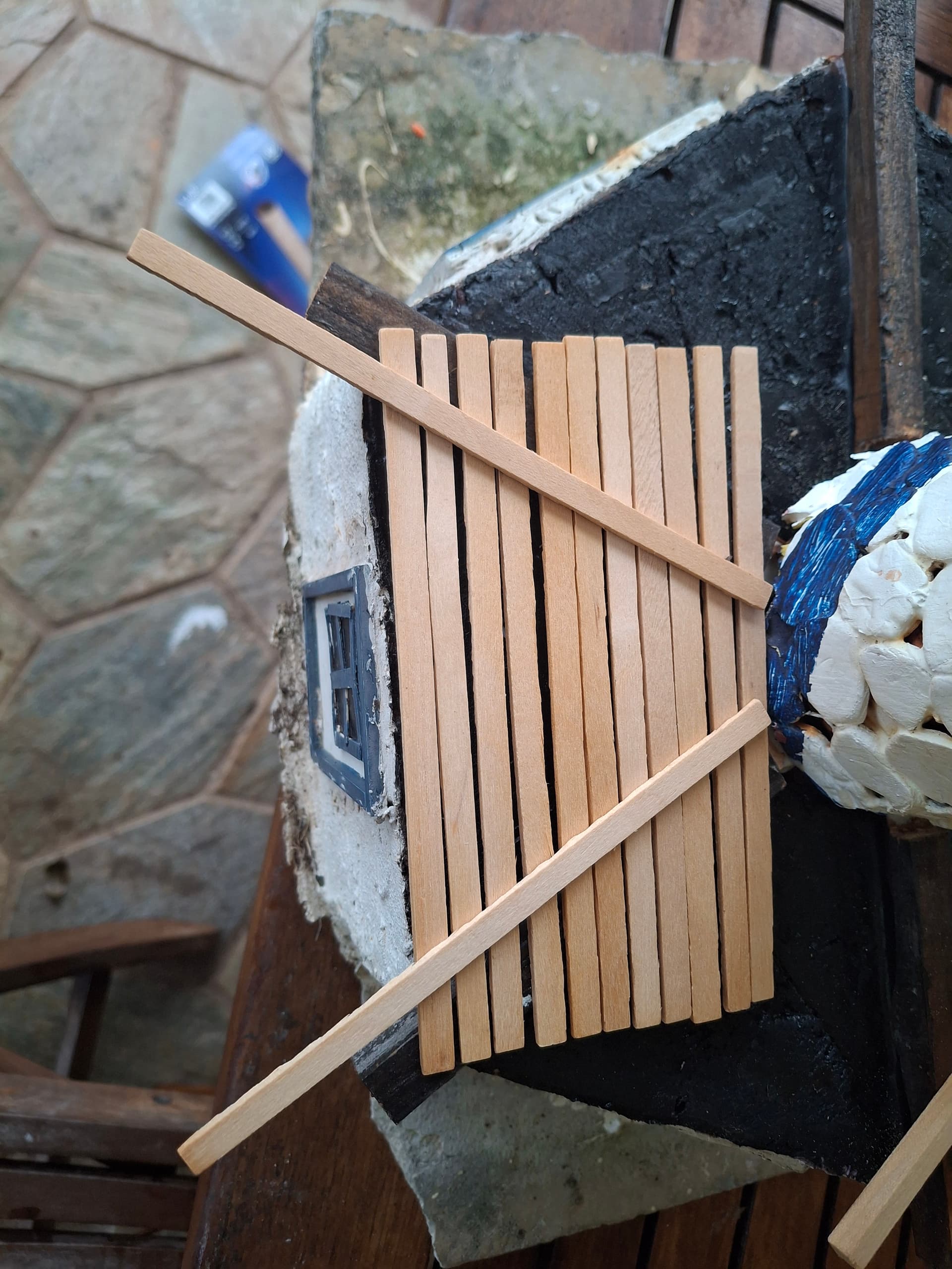

We finally got around to this project. I had stained all the “decking” earlier this week. Kid-zilla helped trim away some framing…
…and, after he left for the movies, the 1:24 gang arrived to shape it and hammer it in place.
I will note that Kid-zilla called me out for not wearing safety goggles! Good for him! Shortly after he left, the cutting disc broke free and shot across the lanai!
Meanwhile, I am again learning a lesson about building to common angles and sizes. The decking needs to carefully match so that errors don’t propagate from “pie piece” to “pie piece.” Basically, each deck needs to be laid down, marked, and cut so that it comes at least close to abutting the neighboring bit of decking and still has enough slack on the other side to be glued to the roof beams. Someday I will learn to accurately use a ruler…perhaps when I start a new - rather than rebuild an old - building!
