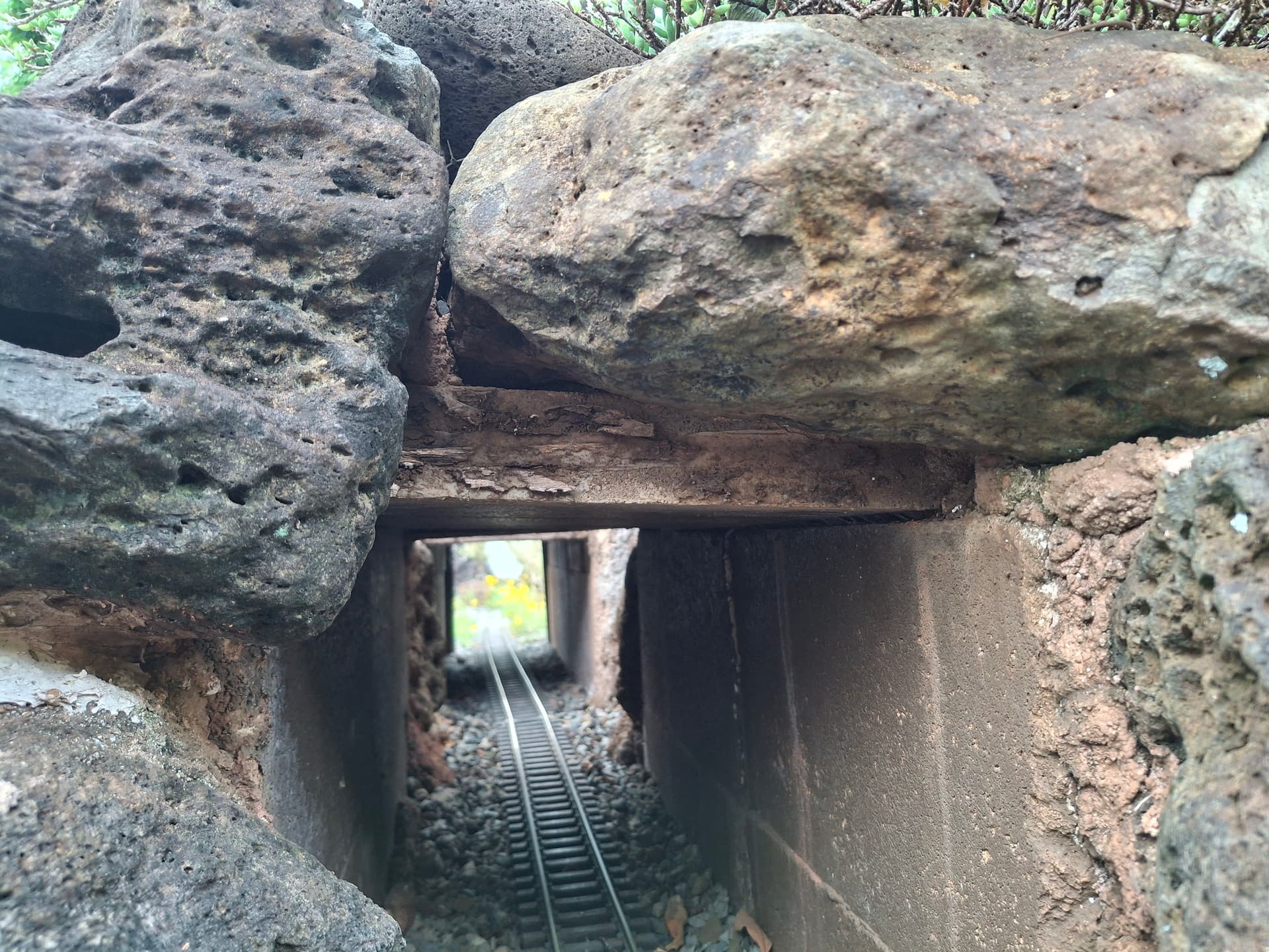

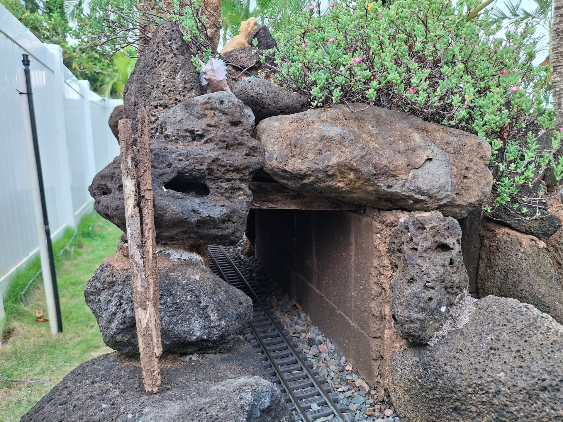

Our control are some 1/2" x 1/2" basswood timbers we once installed to hide cinderblock tunnel cores. These timbers faced the prevailing winds. Overhanging lava rock partially protected them.
They were not treated with TiteBond III or anything else. Installed in 2015 or 2016, they finally rotted off this spring.

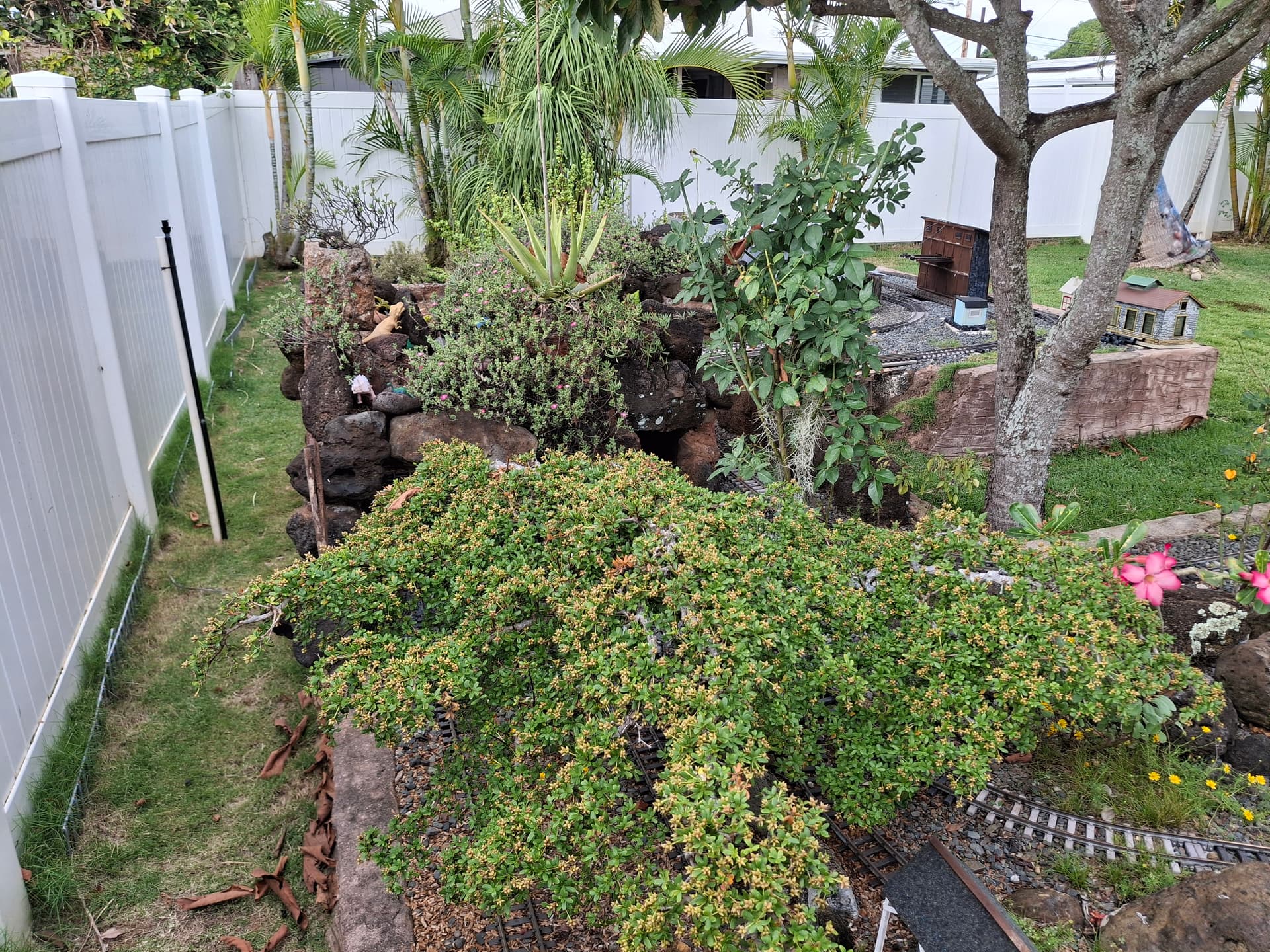

Plants have grown in, blocking any view of the portals…
…so there are no current plans to install new timbers.

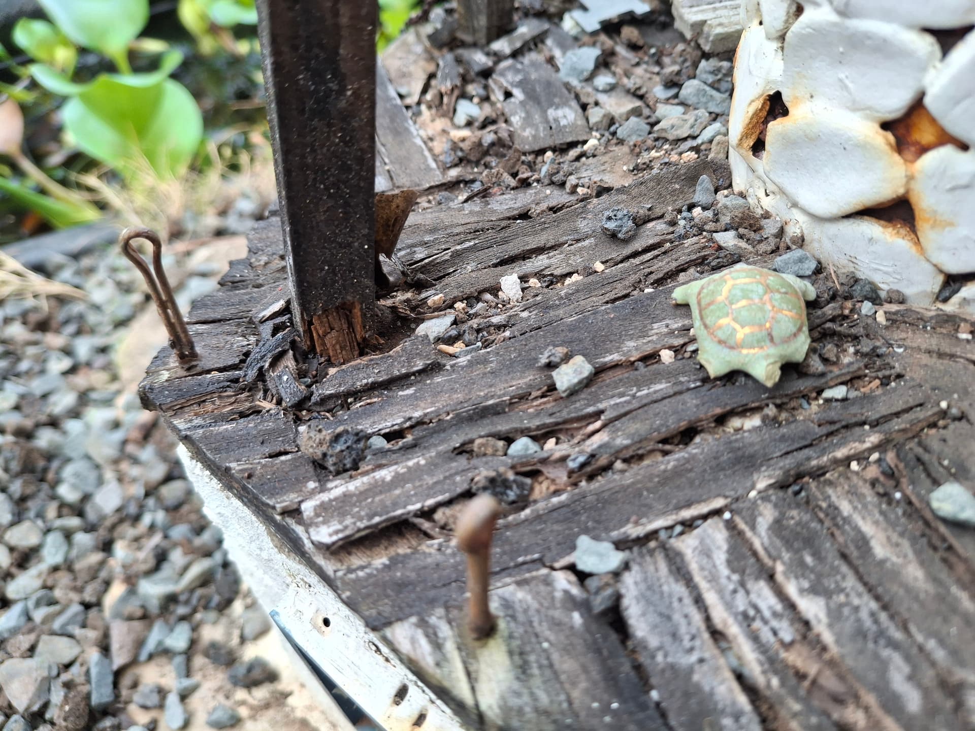

One example, 2021 Mik Challenge – Hale Ipukukui o Haluku’ilio (The Lighthouse of Dogwallow), had a craftstick upper deck and some basswood supports. Here’s what that deck looks like in July 2025:
Note also the rot at the foot of the support beam. The rest of the beam as well as all the other beams, is sound. Replacing this deck, probably with scribed plastic, is on the 2026 goal’s list!

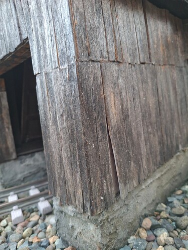

On the other hand, the M&K Sugar Mill has been exposed to the elements since 2020. The core is foam covered in crimped can and craftsticks. As of July 2025, the craftsticks look like this:
I think they’ve weathered quite well, and, even better, there are no softspots on the planks at all. Minor warping has exposed some of the core, but you can barely tell.
