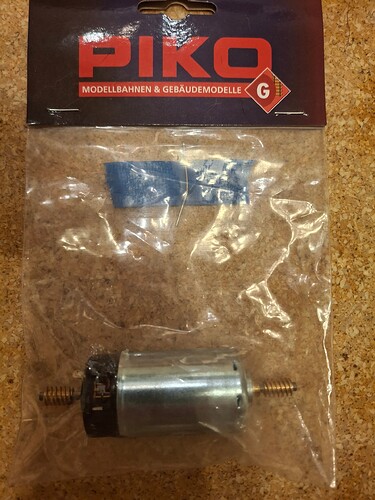

I am pretty sure that the motor is having issues, but, before I spend for a new one…
- Am I correct? Is this the motor?
- Is there a way to clean the motor’s internals? Somewhere I remember reading about a motor cleaning kit, where you stick the motor in some sort of solution and let it run?
- Has anyone modified the PIKO motor block to fit a BUEHLER motor? The latter is half the price of the PIKO part, but this does not look like a modification that can be done without some careful consideration and perhaps tools that we don’t own.
