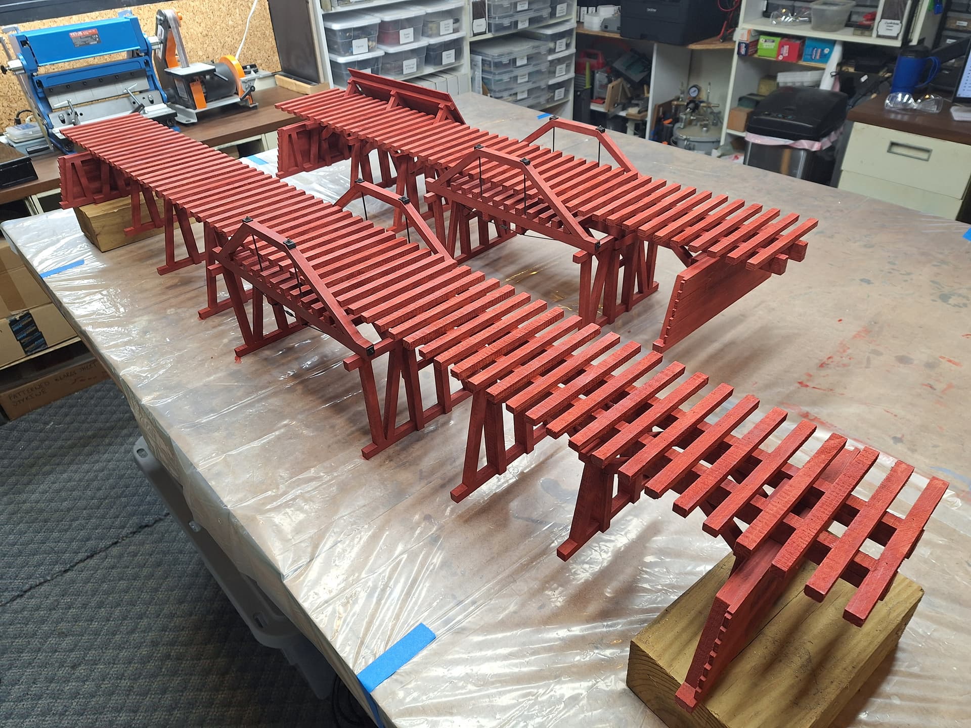

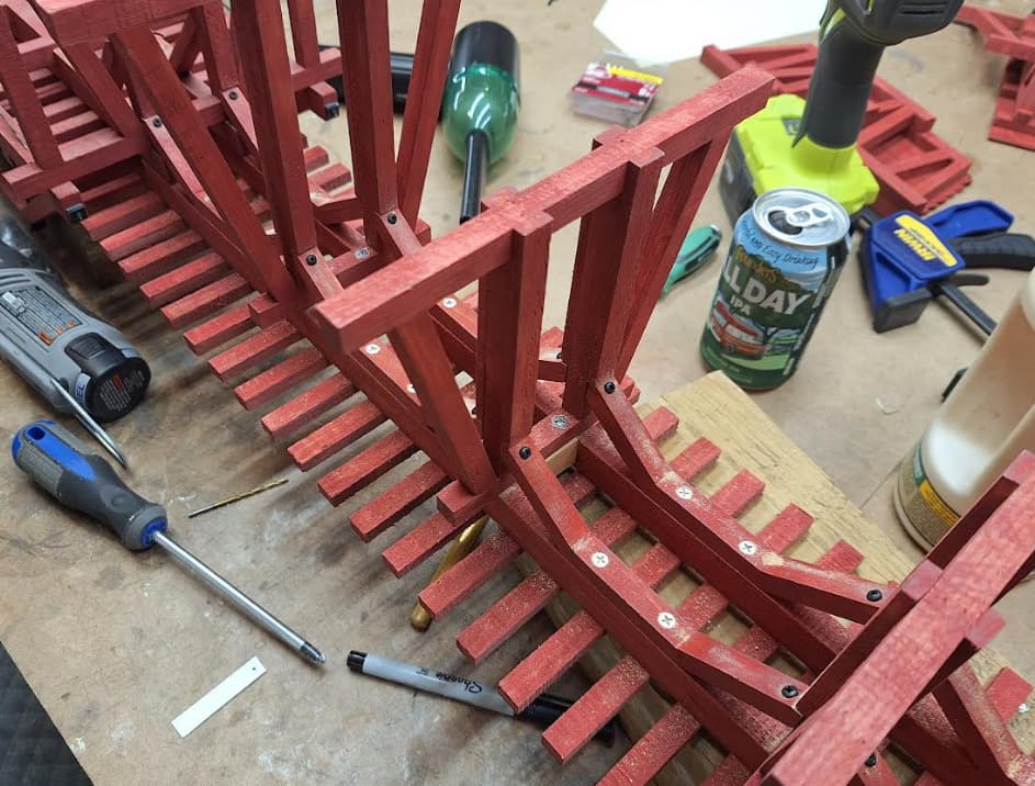

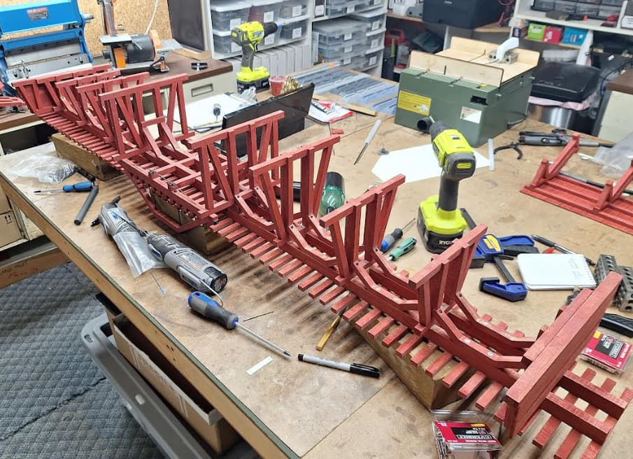

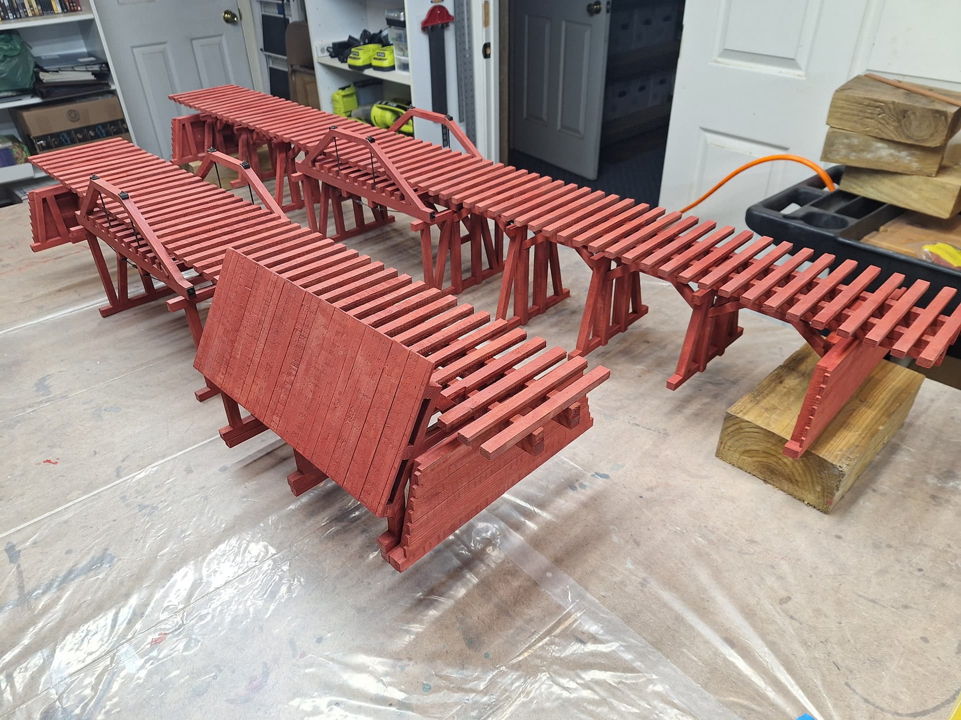

I’ve made a little progress here and there, starting with a better plan on assembling everything. The original idea was to glue and pin, but I’ve decided to screw all the subassemblies to the deck. The bents needed something firm to screw to, so I cut and stained cross-pieces for that.

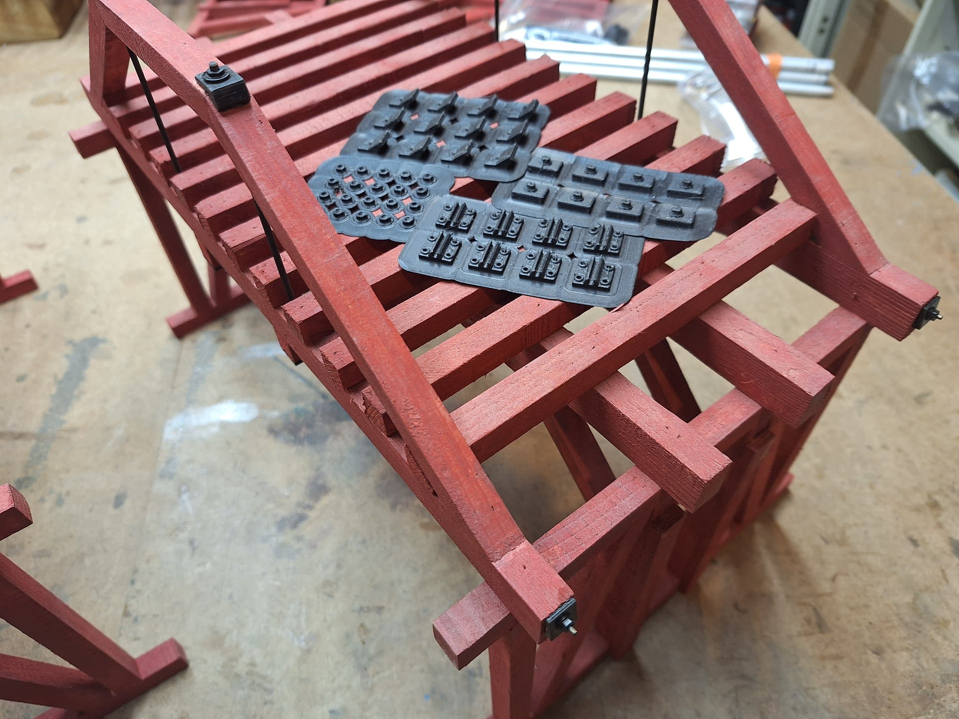

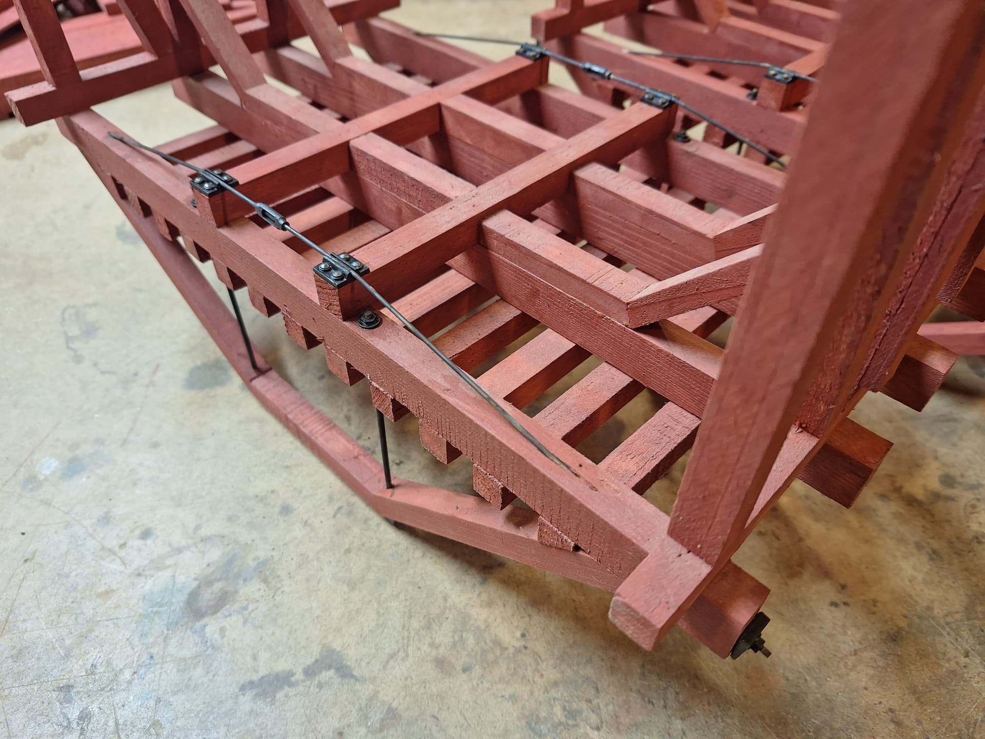

There’s some details on the bridge portions, which were going to utilize brass rods and these 3d PLA prints done 3 years ago… pretty rough looking.

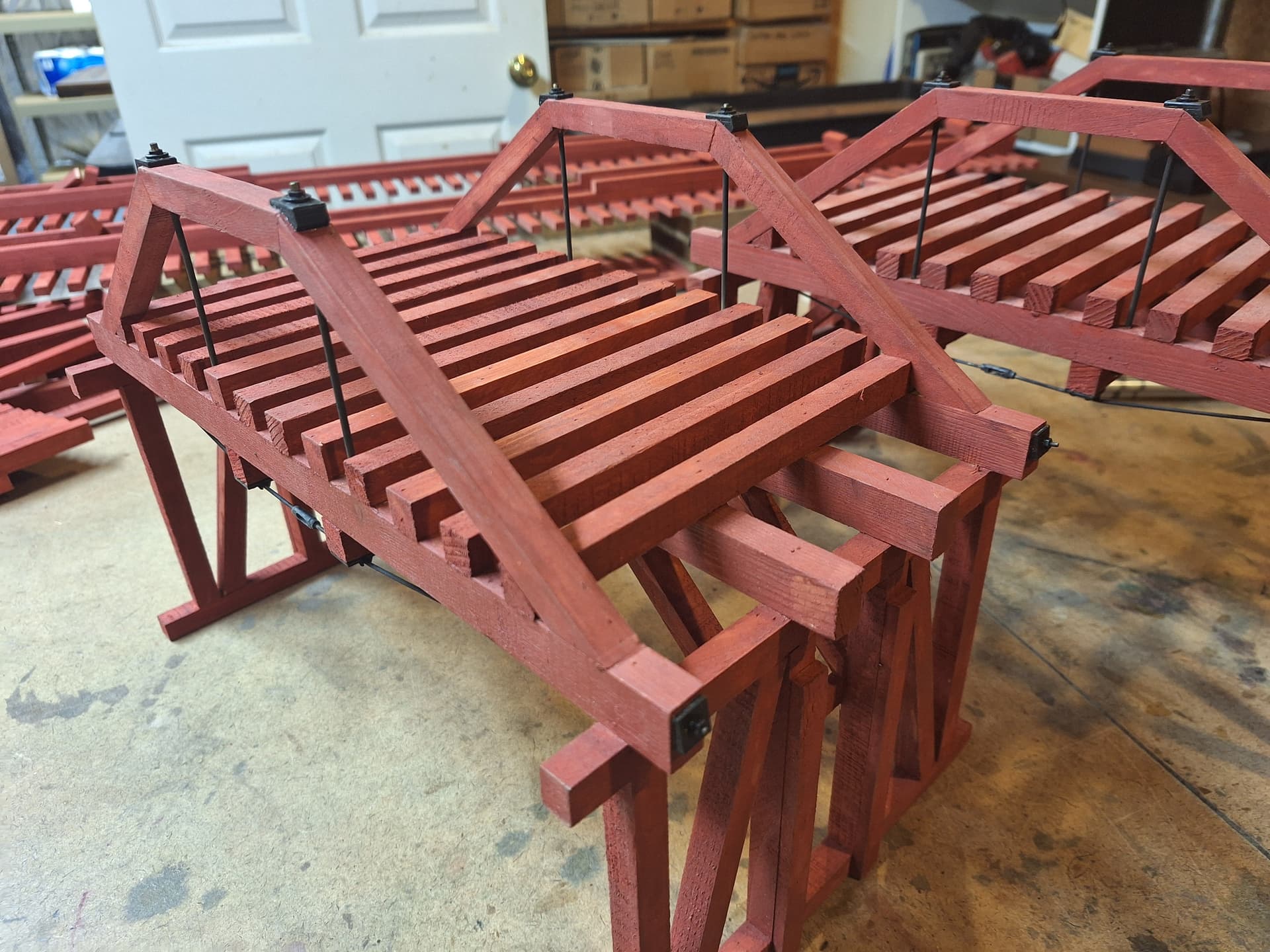

So I reprinted them in “tough” resin, and painted / clear-coated them. Here’s the bridge bling installed with the blackened brass.
I’m sure those diagonals should be set into notches into their supporting beams, but this is a 10’ rule project. Heck with my eyesight it’s a 4’ rule project. :grinning_face_with_smiling_eyes:
By the time this bridge is finished it will be outdated and need replaced with steel or concrete!
You can always add 4x cleats with bolts and strapping. 6 bolts per cleat should look ok JMHO YMMV
Where did you hat that hardware? Are they actually screwed where you can tighten them up or just the plastic 3D and stuck on?
It’s just 3d printed (resin) and brass rod. The bottom saddles are pinned, but the rest is cemented.

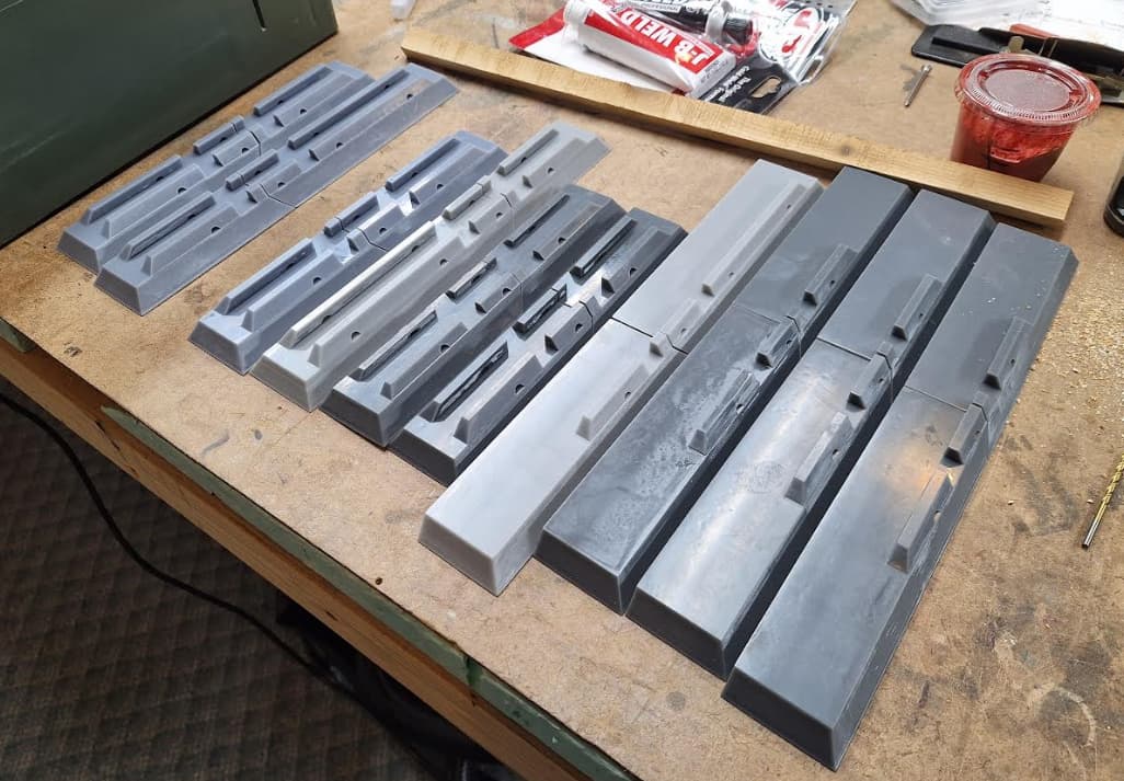

Been screwing around today,

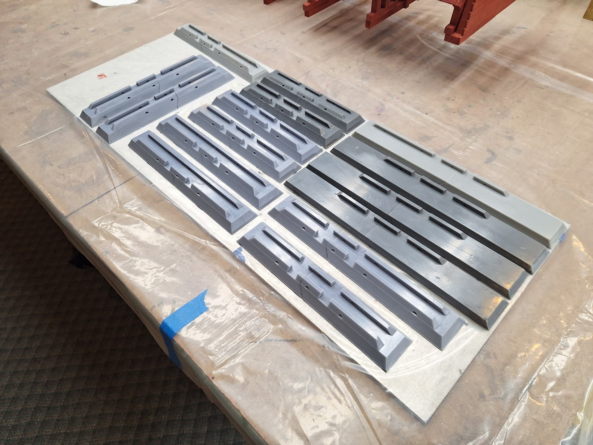

…and also continuing to print the foundations.
More on those tomorrow I think.

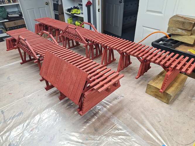

These two are assembled and touched-up. Next they’ll need the linseed oil.

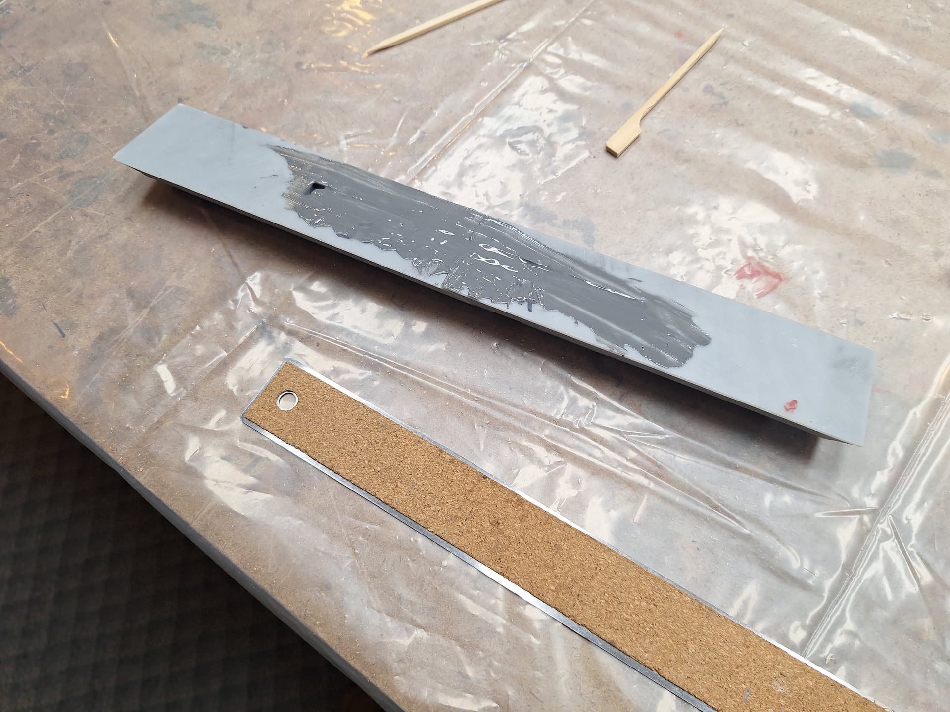

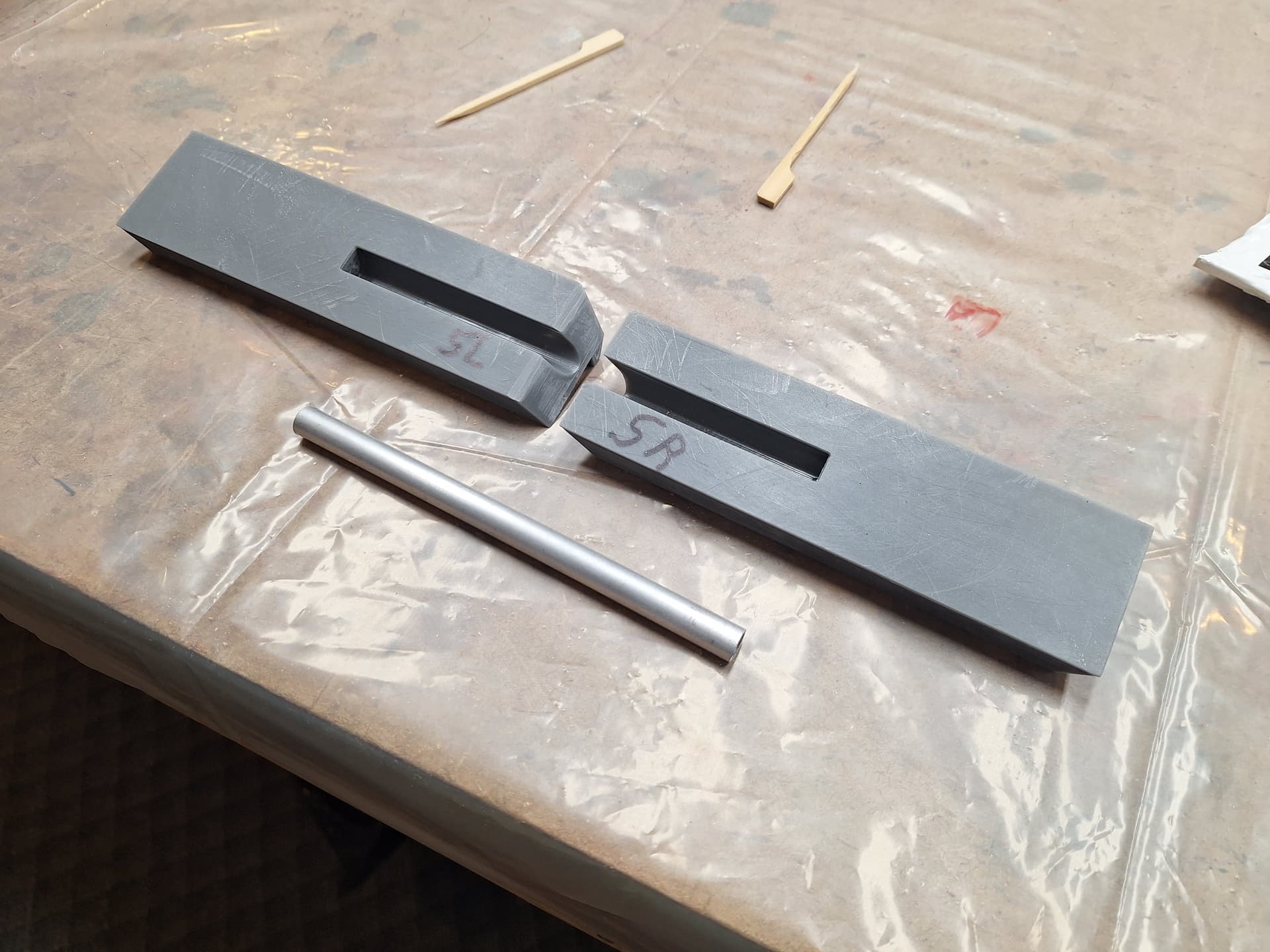

I finished printing the foundations this morning. Since they were too long for the printer (flat against the screen), they’re all in 2 pieces that need joining. I used 3/8" aluminum tube, and slathered then in with JB Weld.
The tubes came from old Xerox machines which David Maynard garnished while servicing them. He brought them to a DnB to give away, and I figured I’d use them somewhere. Didn’t expect this! But they worked great.
Wonder how Mr Maynard’s doing these days?
Here’s the finished foundations, which will get sprayed with 2 or 3 coats of gray.
FWIW, the odd diagonal wall thing is a wood slide. Workers would throw cordwood off a flatcar and let it sit beside the trestle until needed. In post #118 I show a couple of old photos.
Well built Cliff. I thought the wood slide protected the trestle from the waste material they dumped
Thanks, David!
Yeah, just the cordwood. I’ll probably make some sort of pile, and glue it together to be lifted away with the slide. This is a leaf-inviting zone, so the slide is removable for leaf-blowing. Which means it’ll end up a mile away in a big storm, unless I tether it somehow. Along with the cordwood pile. Hmm…
