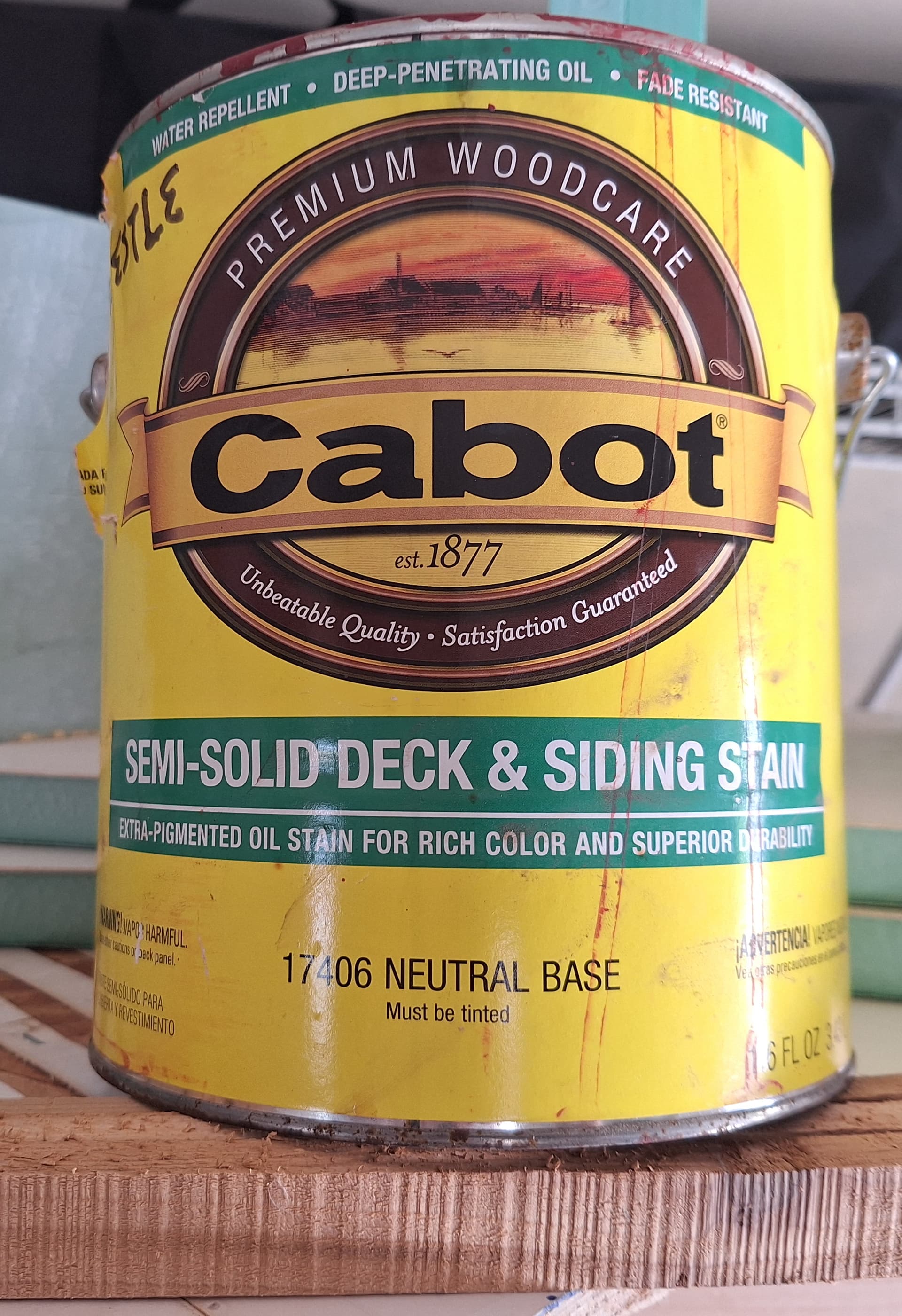

I just tried some new motor oil, and it doesn’t look like it’s penetrating the stain, or adding any tint. Here’s the stain:
It says “Satisfaction Guaranteed,” so what cold possibly go wrong? :crazy_face:
BTW the wood is cedar, so I’d originally hoped that, plus this stain, would last a long time.
Not really trusting it though…

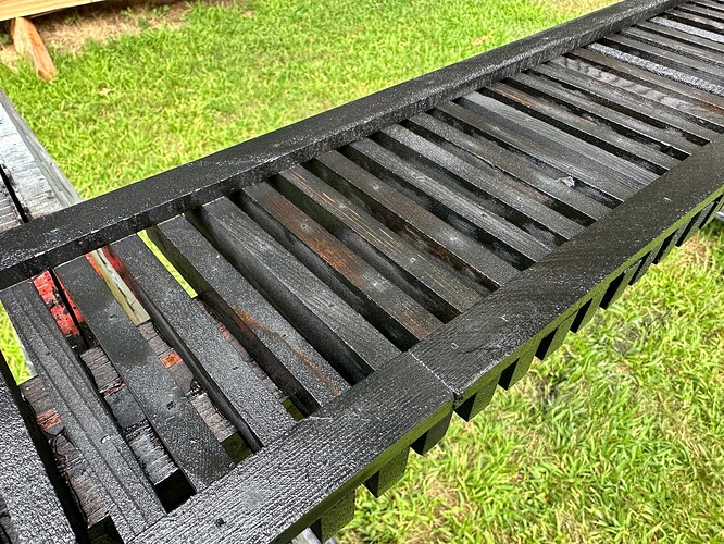

For my bridges I use ebony stain and then a couple liberal coats of boiled linseed oil.
Even though the oil looks like it’s sitting there on the surface, you’re convinced it’s penetrating?
Is your stain a “sealer” stain?
And your Cabot being an oil based penetrating stain should achieve results inline with motor. And I’ve never gone to Linseed oil since I can get used motor oil when needed. But you already have this knowledge. Just double checking for newer methods?
Makes sense, David.
But maybe Bob’s discovered that linseed oil is good “belt and suspenders”?
No, you dont want a sealing stain. And yea, the linseed oil penetrates.
I can’t tell if my Cabot stain is the sealing type. Doesn’t say so… but either way, that’s what’s on.
