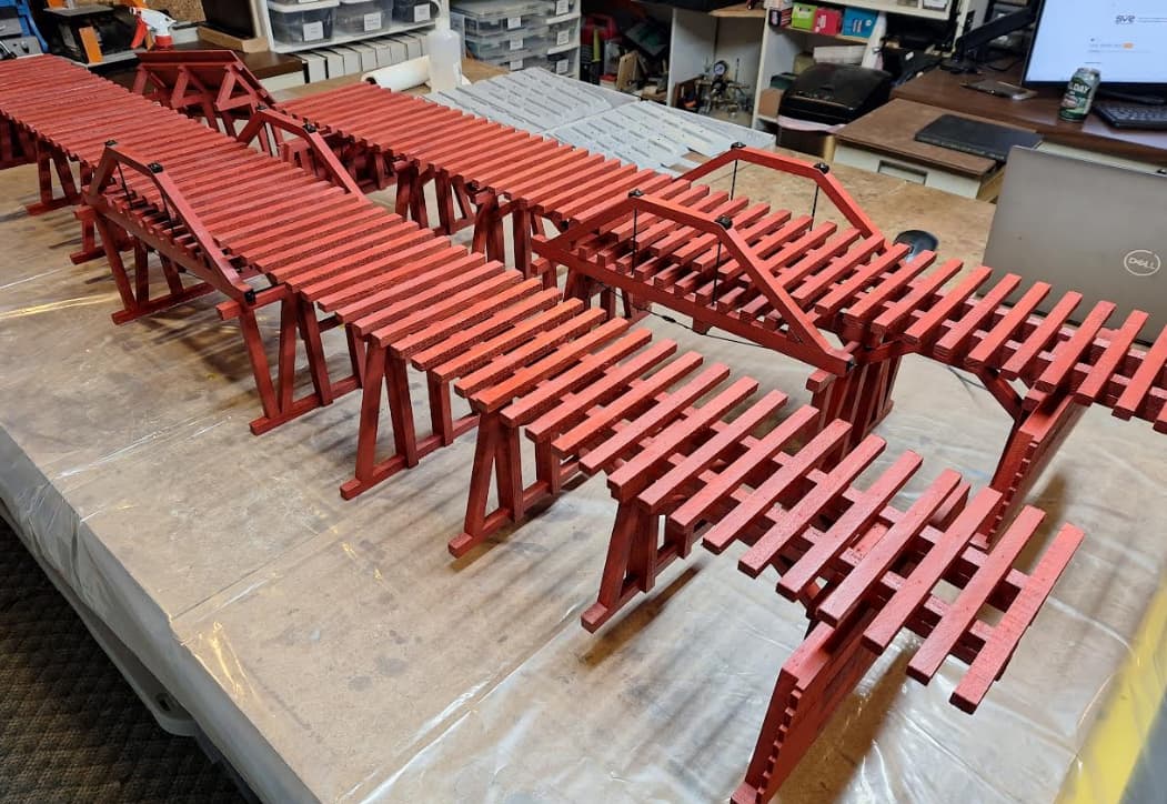

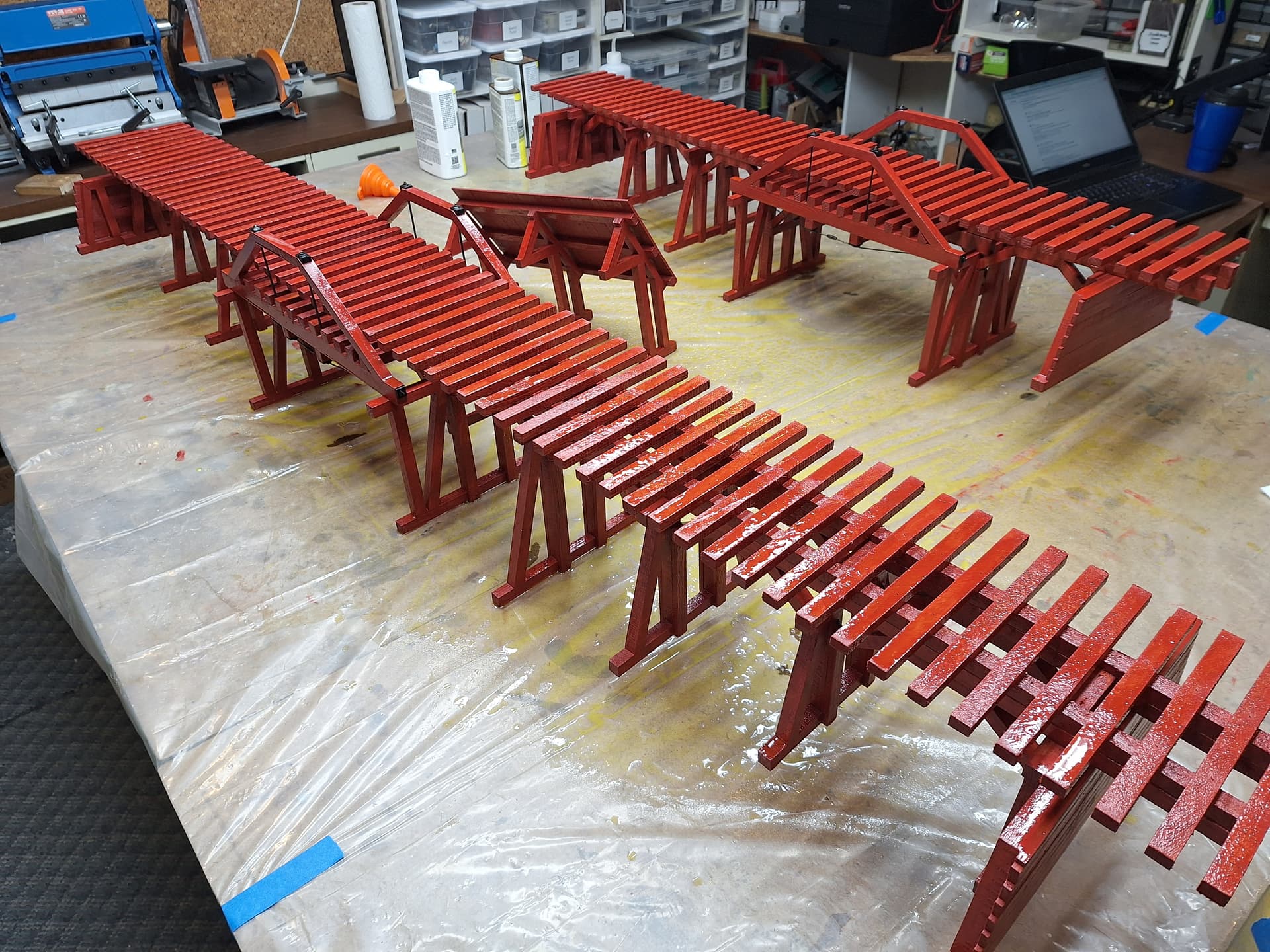

Before work I sanded the foundations and then drained them of excess resin.

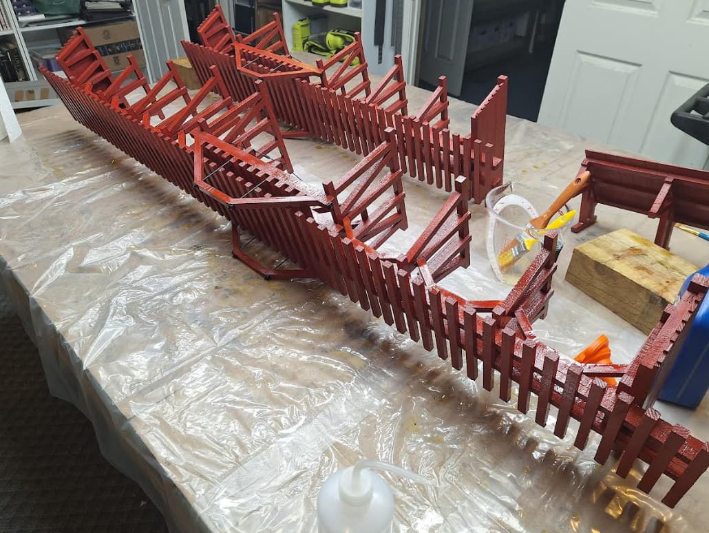

On my lunch break I sprayed 50:50 linseed oil / denatured alcohol on the trestles (2 rounds), and painted the foundations.
Need a couple days for everything to dry now.
You honestly think we believe that?
The oil / alcohol seems to be penetrating / evaporating nicely.
Hollywood, BD, do you think I should give it another round tomorrow?
That’s kind of what I do on Cedar. I mix the ebony stain and the linseed oil and apply liberally. This is what it looks like after a few years out in the weather. It even survived the move!

Looks like that is what BD recommended Cliff. And with spray coating it I’d be heavy handed

Mixing stain with the oil, there’s a thought. And it looks great!
I mixed the alcohol with the linseed oil so that it would spray from a spray bottle. A little stain in that mix would probably be just fine.

Sounds good, thanks Hollywood. Yeah, I sprayed until everything was dripping. But I suppose if the wood can soak in more, keep it coming.

It finally dawned on me that motor oil breaks down more slowly that plant-based oil. So I mixed motor oil 3:1 with denatured alcohol and slathered it on for my 2nd coat.
It seems to be soaking in nicely, and not attacking the painted bits.
