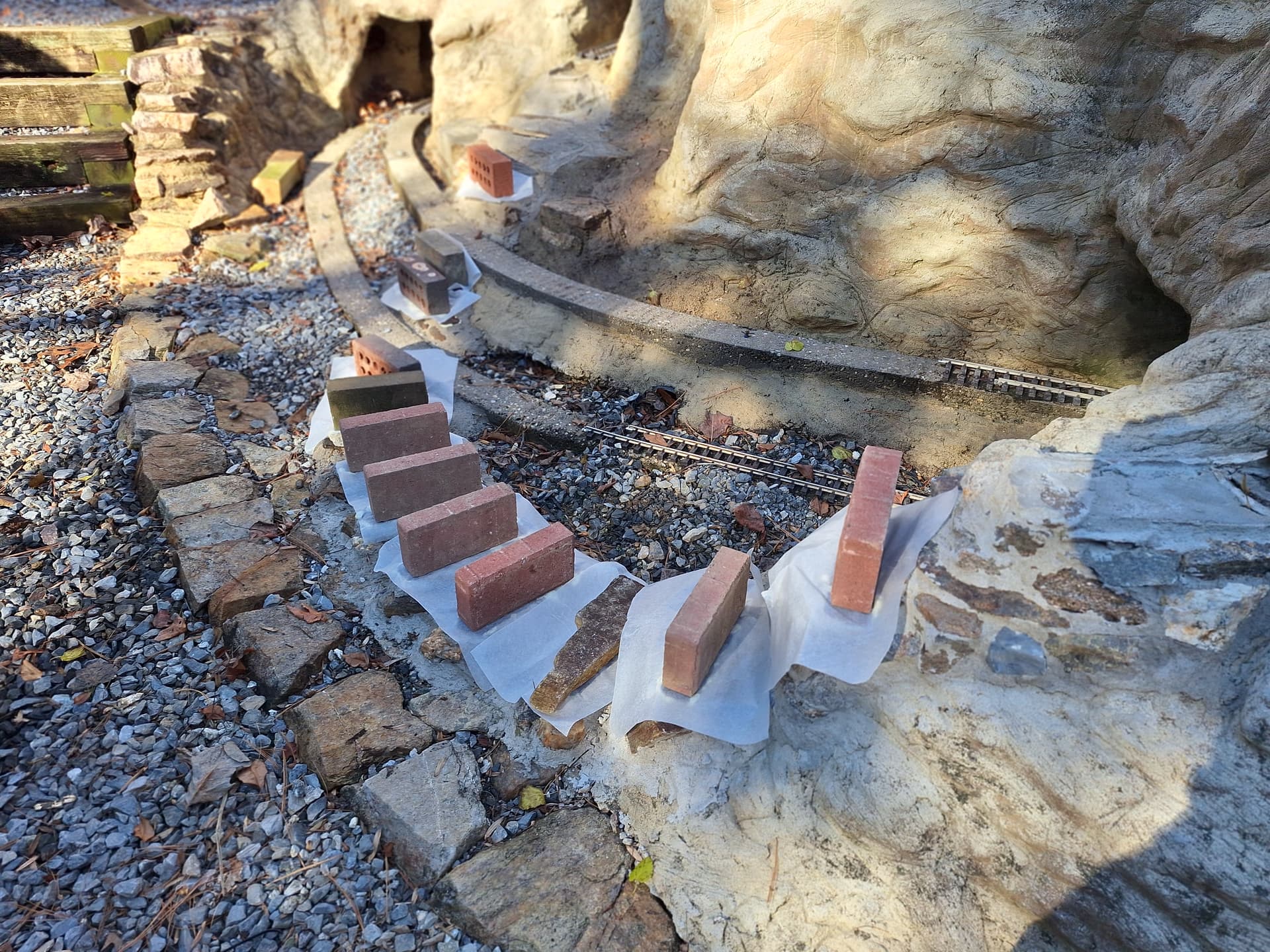

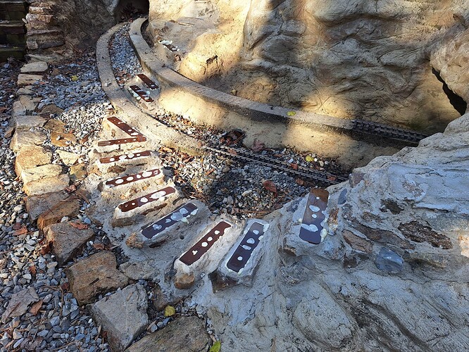

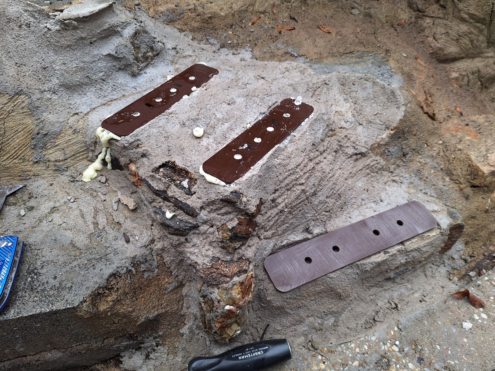

Back to the trestle. After a few days of letting the concrete dry (it’s been rainy), I tested Gorilla Glue for adhering the plex base plates down. Per GG instructions I’d roughed up the bottom sides of the plates on the belt sander to let the glue bite.
The glue worked very well, so this morning I did the rest. The bricks were to react the expansion of the glue. Had to use wax paper under the brick, because the glue in the small holes wanted to glue the brick down as well.
The glue expanded and set fairly quickly.
I left the top smooth for the later addition of indexing pieces, and that smoothness helped in the excess cleanup.

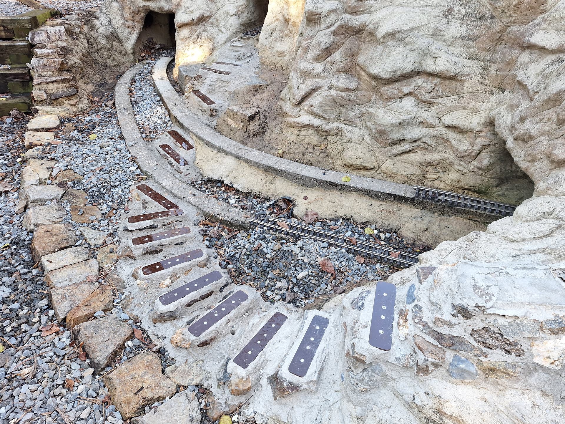

The above shot looks the same as a month or two ago, but now the plates won’t fly away in the wind (as they were tending to do).

Cliff what are plex base plates and what advantage do they offer over the concrete?
Bill, I guess mainly I tried to design for massive inaccuarcy. :grinning_face_with_smiling_eyes:
These plates give the bents a target area for each bent to rest. Once they find their final parking place, the plan is to adhere U-shaped indexing pieces to lock the bents laterally. They’ll be plex as well, and get bonded to these base plates.
Vertical inaccuracy (“tolerance” sounds better, right?) is via 1/2" thick boards which go between bents and plex plates. More on that later.

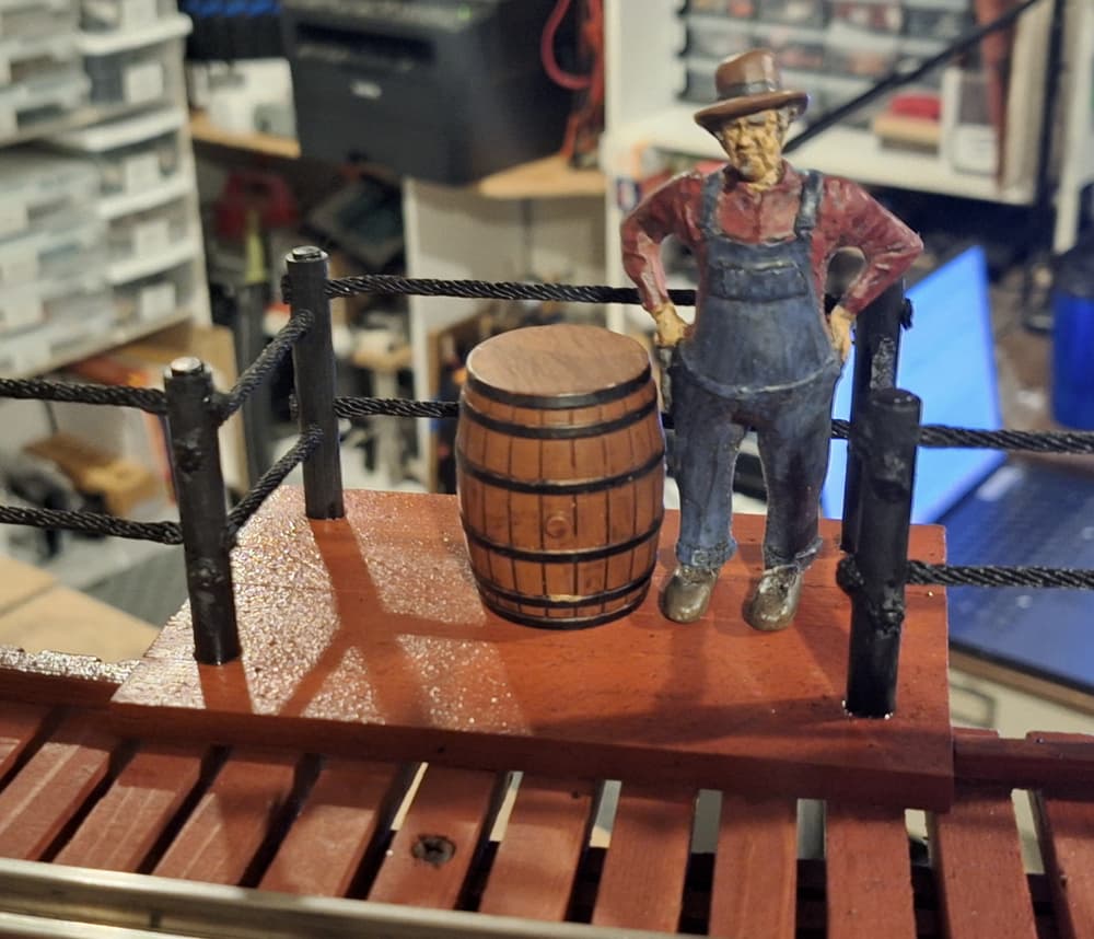

The Chief Engineer of the C.V.S.Ry. Over Engineering Department approves of your work! This has become quite the project. Well done so far!
The V&T Section Chief says Thank You!

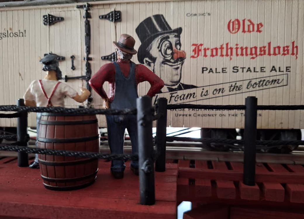

Cliff;
Are we sure only water is in that barrel. Could it perhaps be Old Froth & Slosh? The Section Chief looks a bit too content.
Best, David Meashey
Dave, uh, I’m afraid I have no information on that…

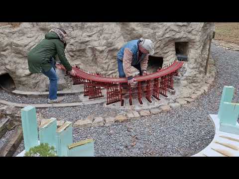

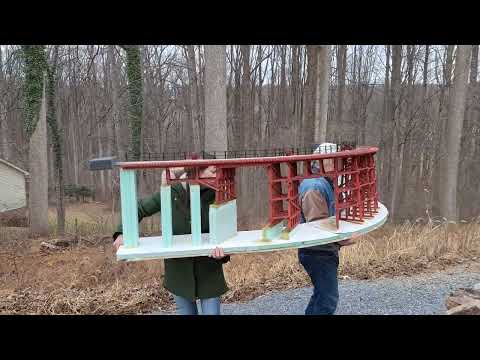

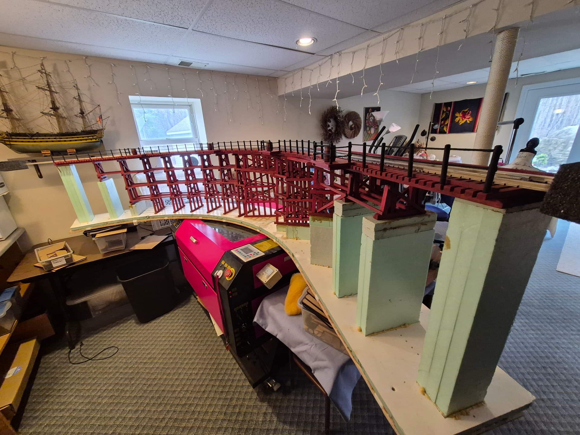

Moving day, yay. Our daughter Leah helped me carry the thing out. Since I sort of promised Rooster a video, Linda handled that part.
Long part 1: gettin er out.
Short part 2: placing it on the piers.
Now comes shimming, securing, and trackwork, hopefully this weekend if the weather holds.

Good job Cliff! I wasn’t sure you were going to make it without mishap, but seems you had good help.
I know everybody here was rooting for you :smiley:
Thanks Rick! Yeah there were some close calls, but nothing catastrophic or even difficult really, thank you God!!
Wow. That was impressive not only the maneuvering outside but how well you’d CAD your layout that it dropped into place.
Makes my feeble attempt at a bridge seem worthless…
Although if I had space, I’d have to build a model of this…
