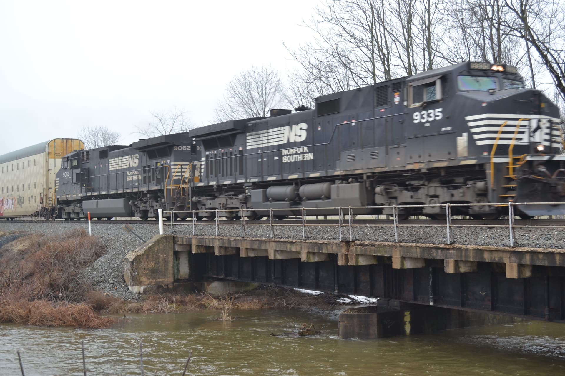

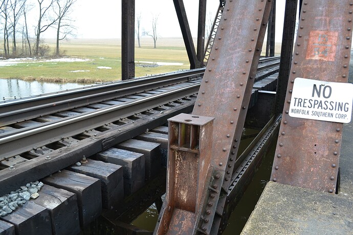

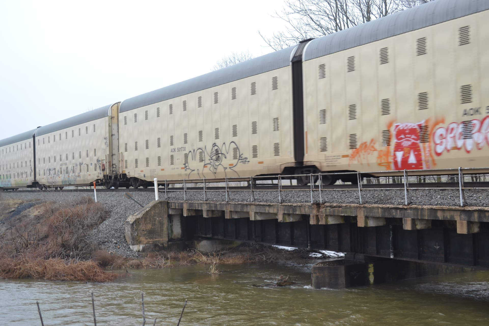

Made me think about my pics of the Norfolk Southern Lurgan Branch. Before and after guardrails and still no guardrails.
Old pictures 117
Same creek different bridge within 1/4 mile apart. New guardrails on one bridge but still none on the other.
Old pictures 111
Old pictures 113

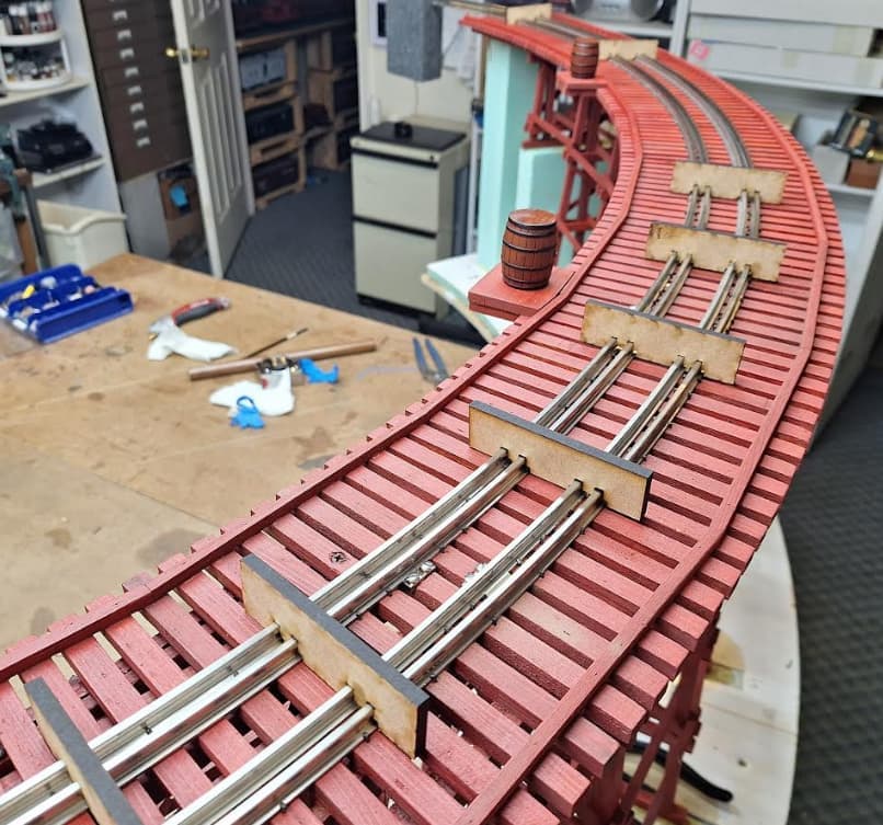

The main rails are down (Rooster, I took the day off), and am starting on the guard rails.
I’d started out with Kadee rail gauges (thanks, Bruce!), but noticed that with these hideously tight curves (R4’) they’re not as accurate. This is due to their having 3 points of rail contact. I spiked the rail with the Kadee gauge flipped one way; but when turning the gauge around, it was either too tight or fairly loose.
So I made these gauges to 45mm, and they fit LGB track exactly. (Oddly, they don’t fit my Train Li track because it’s 44mm! Weird.) The gauges also hold the guard rails tightly, so those shuold go quickly.
I’ve decided to move ahead with the handrails on the barrel side. They’ll represent pipes with tarred rope slung between.
