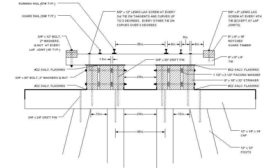

Anyone think guard rails would be of practical help in preventing derailments here?
NO!
but i think, they could prevent tumbling down of derailed trains.
That’s what I’m getting at. You’ve personally seen their effectiveness in that regard?
only indirectly. i have seen a big hauler taking a 5’ dive from my trestle without guardrails.
(it gave an interesting sound on impact)
it could still be used - for modelling a Casey Jones scenario.
Cliff I’m not certain, but I believe you are thinking prototype guard rails where Korm, may be thinking protective rails that possibly angle out from the trestle and are sturdy enough to actually support the train. The prototype will possibly keep a derailed truck from jumping too far past the track line, but if the stouter variety is used though totally non prototypical it may keep an unguarded train from meeting it’s maker. JMHO YMMV MUD :sunglasses:
I do not know what the prototype had, inner or outer like the RGS but i would add them regardless. and they should be of smaller rail section. I use code 250 for the main so my guard rails are code 215.
AL P.
my miles vary just by some yards…
neither did i think about guardrails like in switches, or on some curves (or canadian bridges)
nor about ugly chains or piano wires alongside overhead layouts.
when i answered Cliff’s question i visioned the oldest type of “guardrails”
the solid ten by ten or ten by five beams, that were on bridges and trestles bolted to the outer ends of the ties/sleepers. these beams potentially hinder the roling stock to go over board.
(my trestle did not have them)
Yes David, like that. I was just trying it out with a loose truck, and the extra rails really do seem to keep the wheels from straying too far, like you and Al are saying.

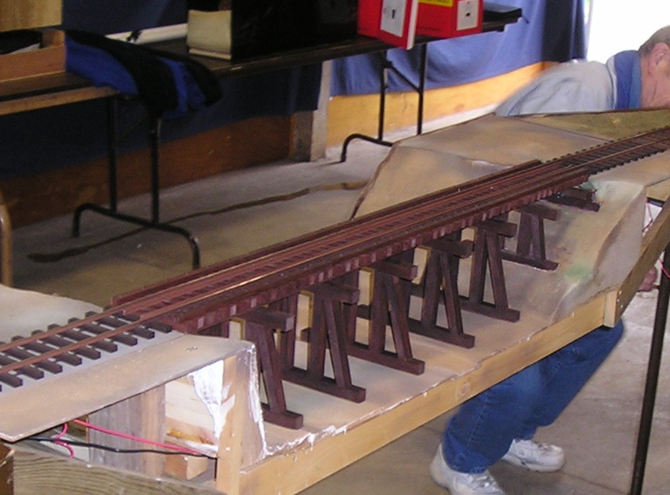

When I built a small trestle for Clem’s modular layout, it had guard rails and guard timbers.
I don’t know where I got them from, but I have a bunch of GIFs from Bridge57, and a drawing marked ‘typical construction’.
P.S. My trestle had prototypical bolt heads along the guard timbers. Roger’s K-36 snow plow was so wide it hit every one! We had to rip them out.
Al, is that based on prototype usage of cheaper rail for the purpose, or is there a mechanical reason for the smaller size?
I have plenty of same size rail (350), but not 250 (which would look odd I think, and take awhile to acquire). Any real disadvantage to staying 350?

Great drawing and info Pete, thank you.
