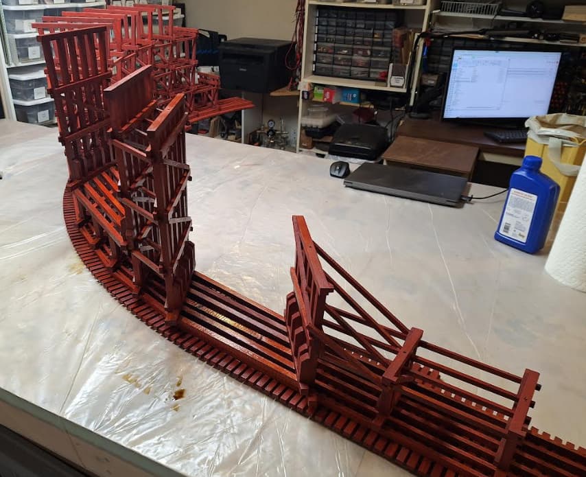

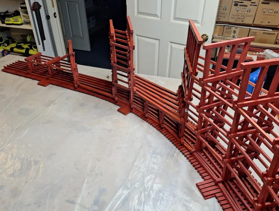

Starting to oil it. 3:1 (mainly used) motor oil to denatured alcohol for penetration. Got the used oil from the local gas station, no prob.

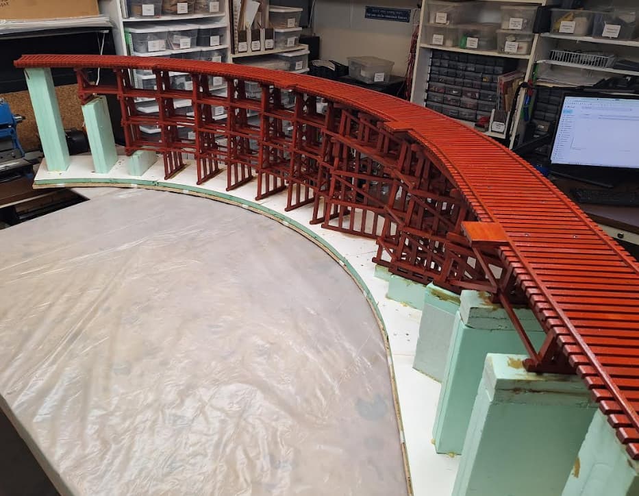

Got the oiling done this morning.
When recoats are needed I’ll look into a cheap spray gun I think.
Hand pump sprayer works

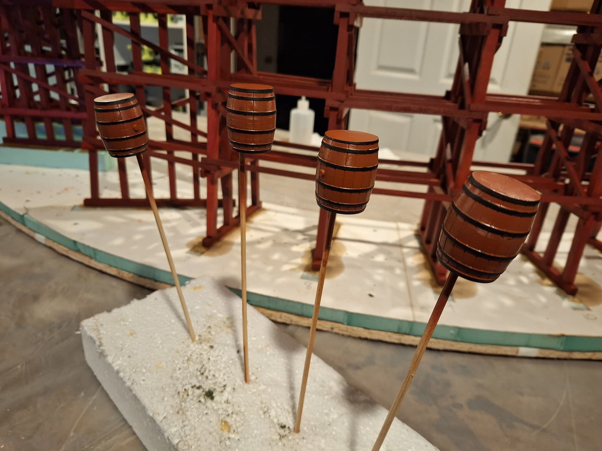

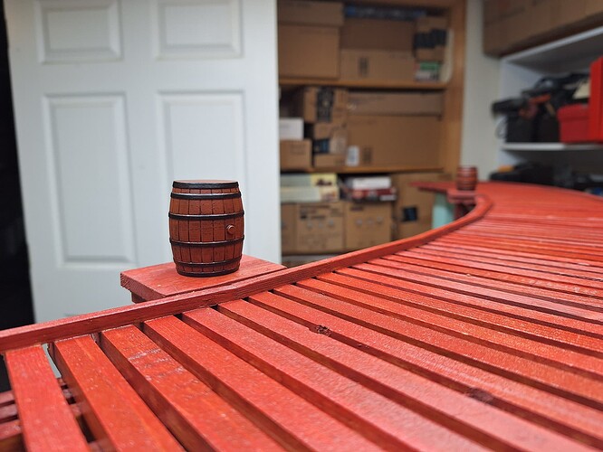

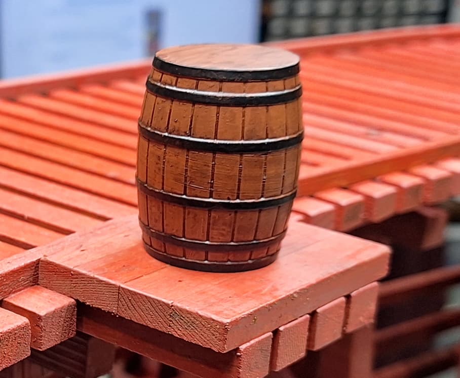

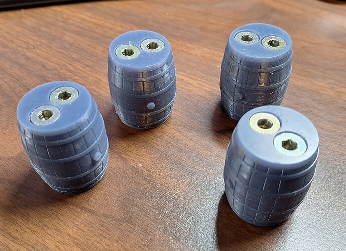

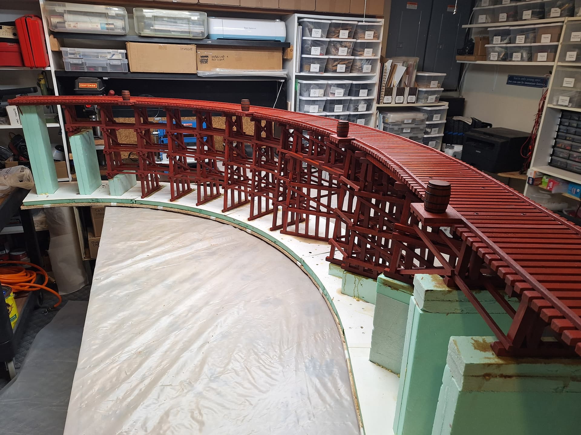

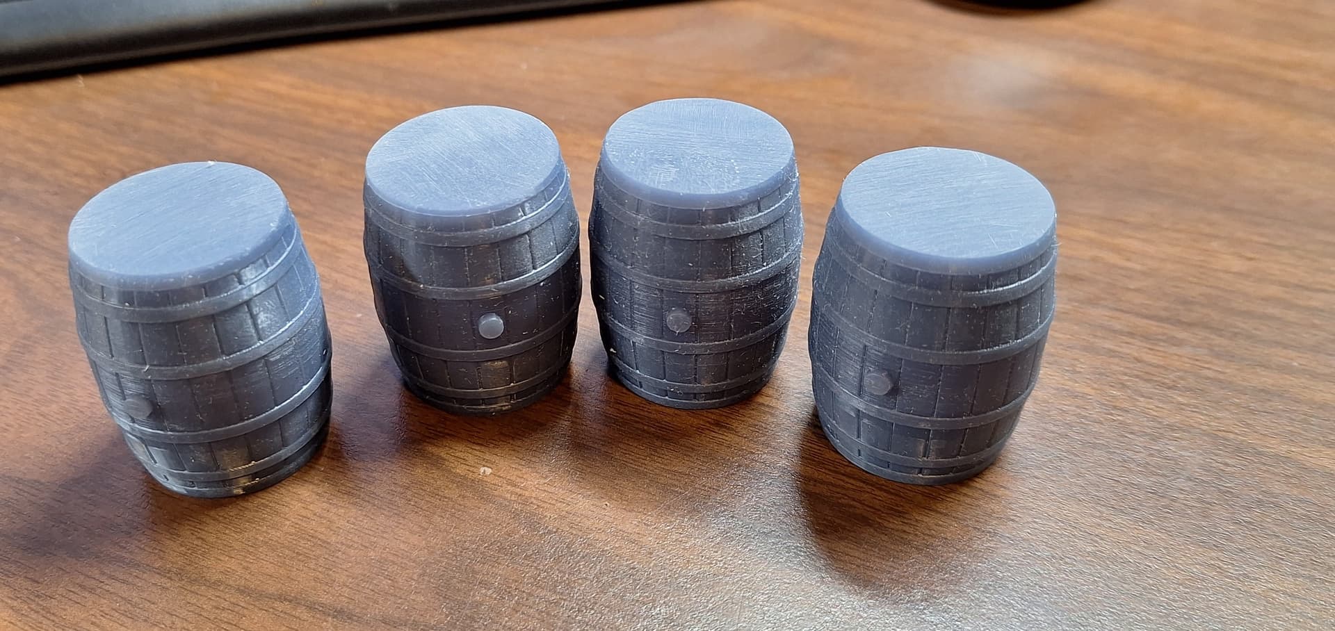

Added barrels. Resin printed, sprayed, hand-painted hoops, Army Painter wash, flat clear coat.
Threaded inserts, #10 screws & washers from the bottom.

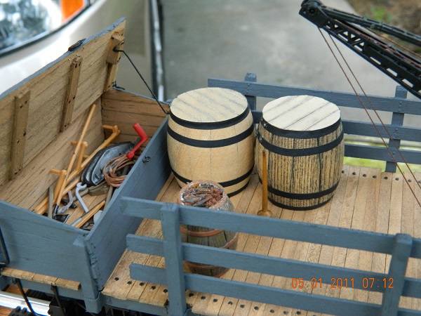

Probably a moot point, but English Leather men’s fragrance users have a built-in source for barrels - the wooden bottle tops. Make the stave lines using a scribing tool, thin basswood scribed for the top (I used dirty Diosol to bring out the wood grain, but Tamia black panel wash would work.), and black draftsman’s tape for the bands. They look fairly convincing, and they’re free. Mik would be proud!

Cliff,

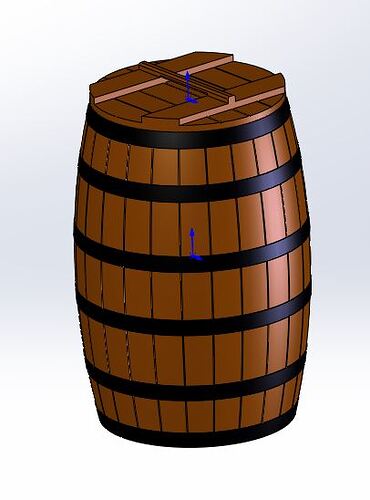

Your water barrels are missing covers!
