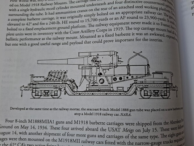

We will be drawing from two sources:
As ever, we will build to the exacting standers of 1:24-ish PLAYMOBIL Scale. A functioning piece of rolling stock that evokes the railway guns of old is the goal, not an exact model.

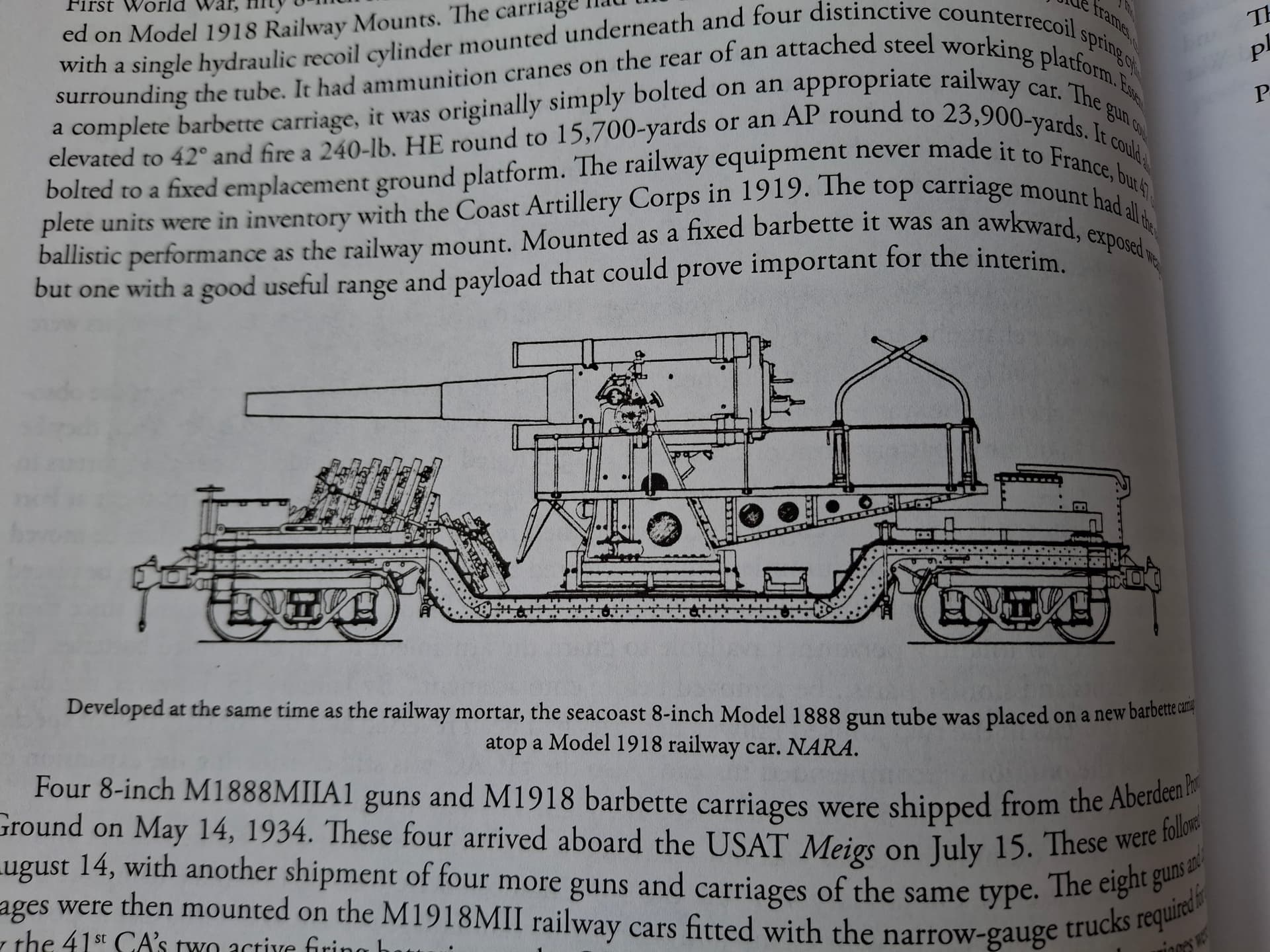

The Willford book provided a good sketch of the m1888 gun.
I’ve met the author of this book. If you are into coastal defense, he is THE source, with decades of personal research poured into preserving this dead branch of the U.S. Army. The book is a labor of love and a masterpiece of history by a dedicated and passionate “amateur” historian. Oh, it had sketches of the mortars, too, but Kid-zilla declared them “weird.” We’ll make the gun. We wouldn’t want to be weird!

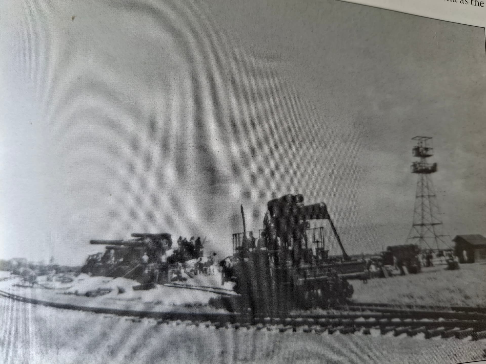

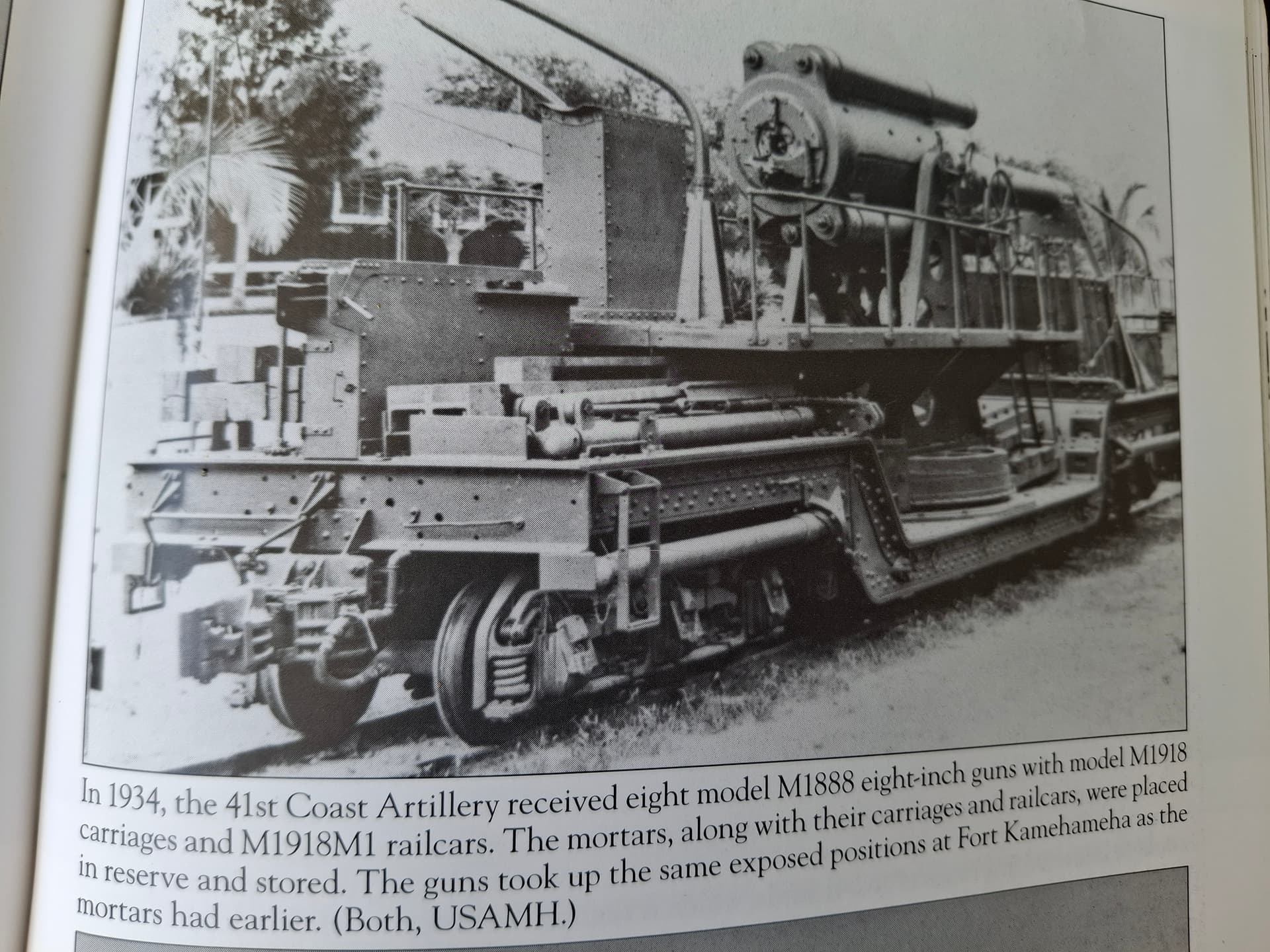

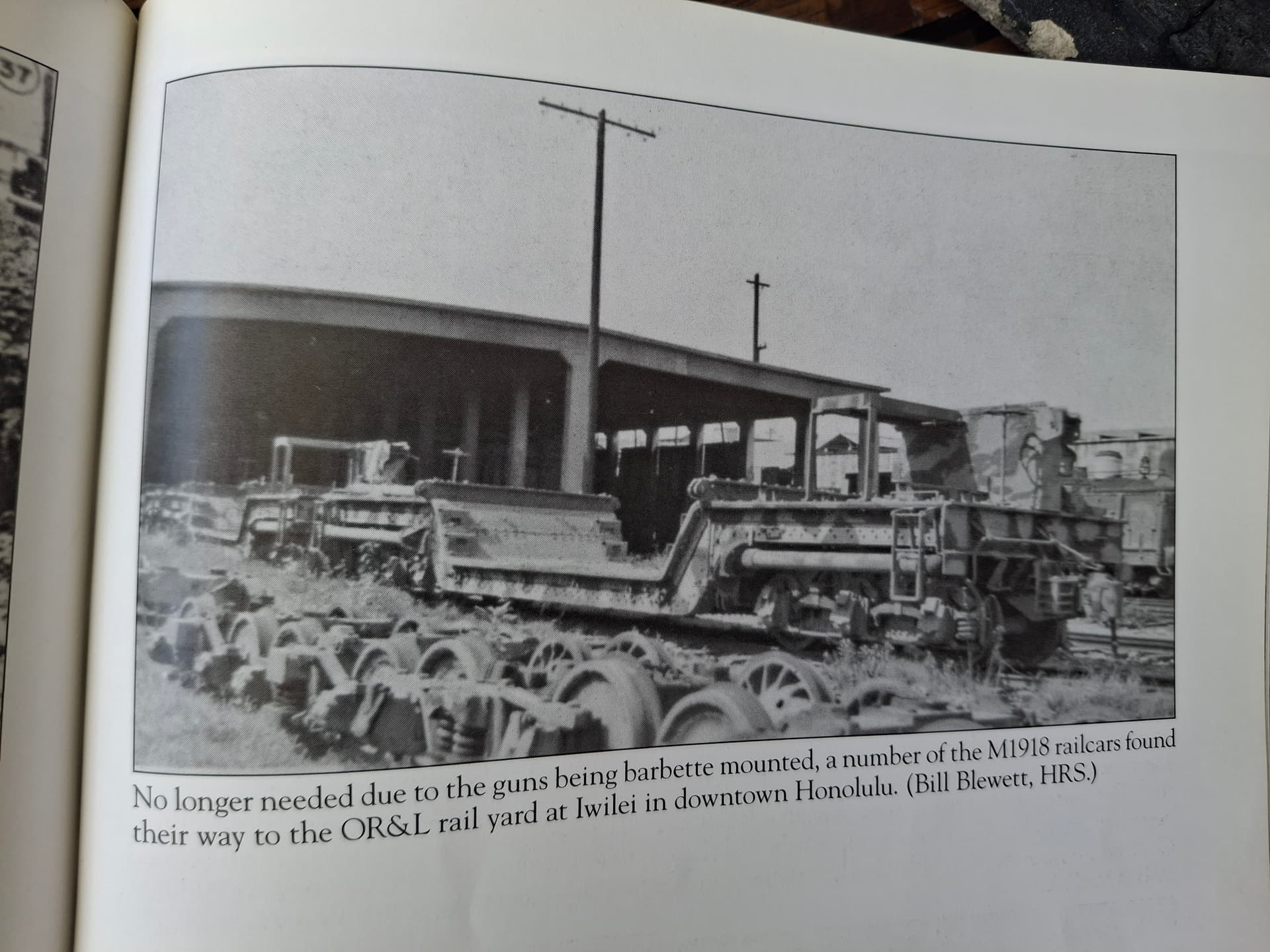

The Livingston book is more railway focused. Its pictures will guide the carriage and general “in use” character. Key will be the drop-center flat car.

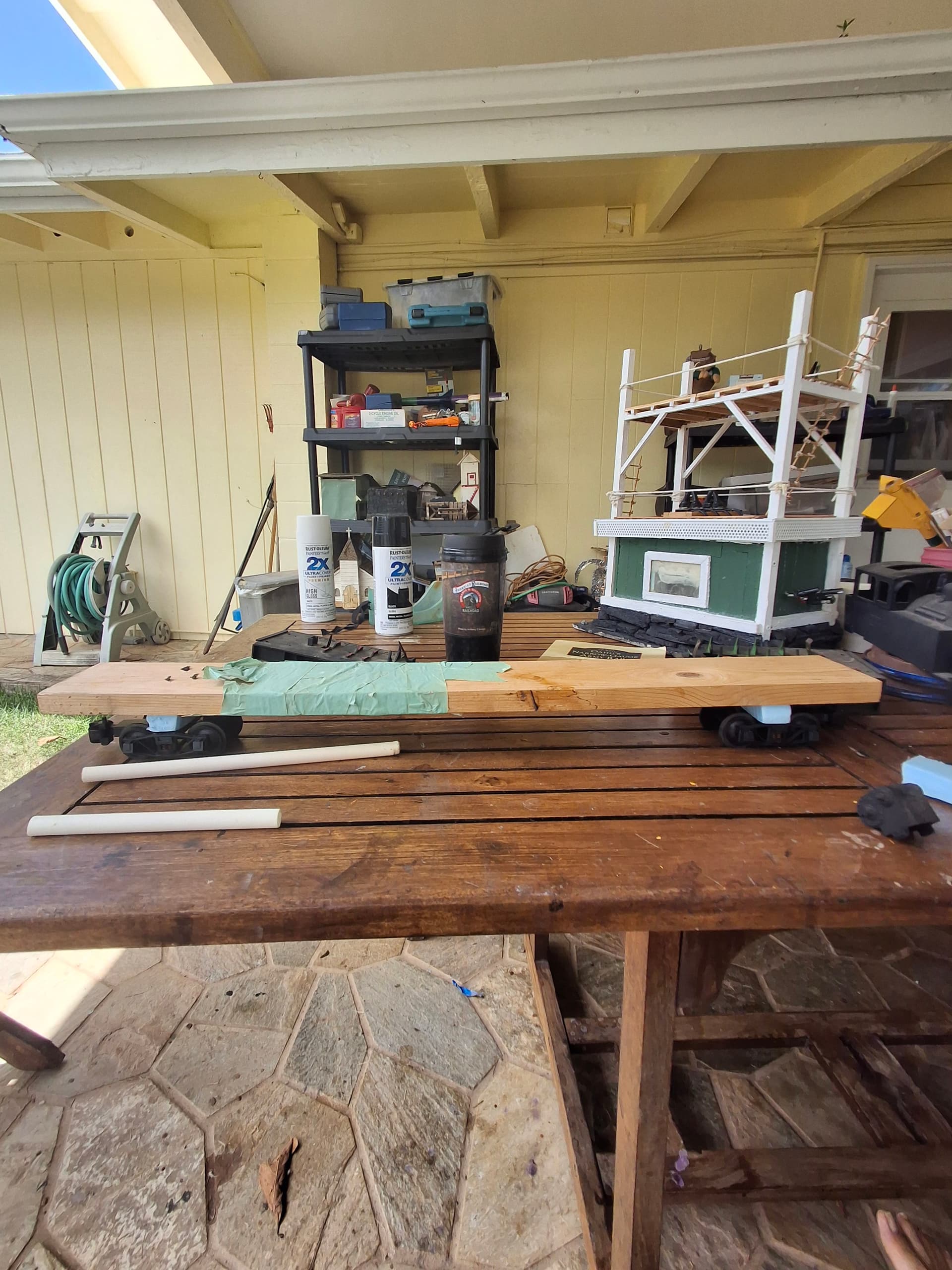

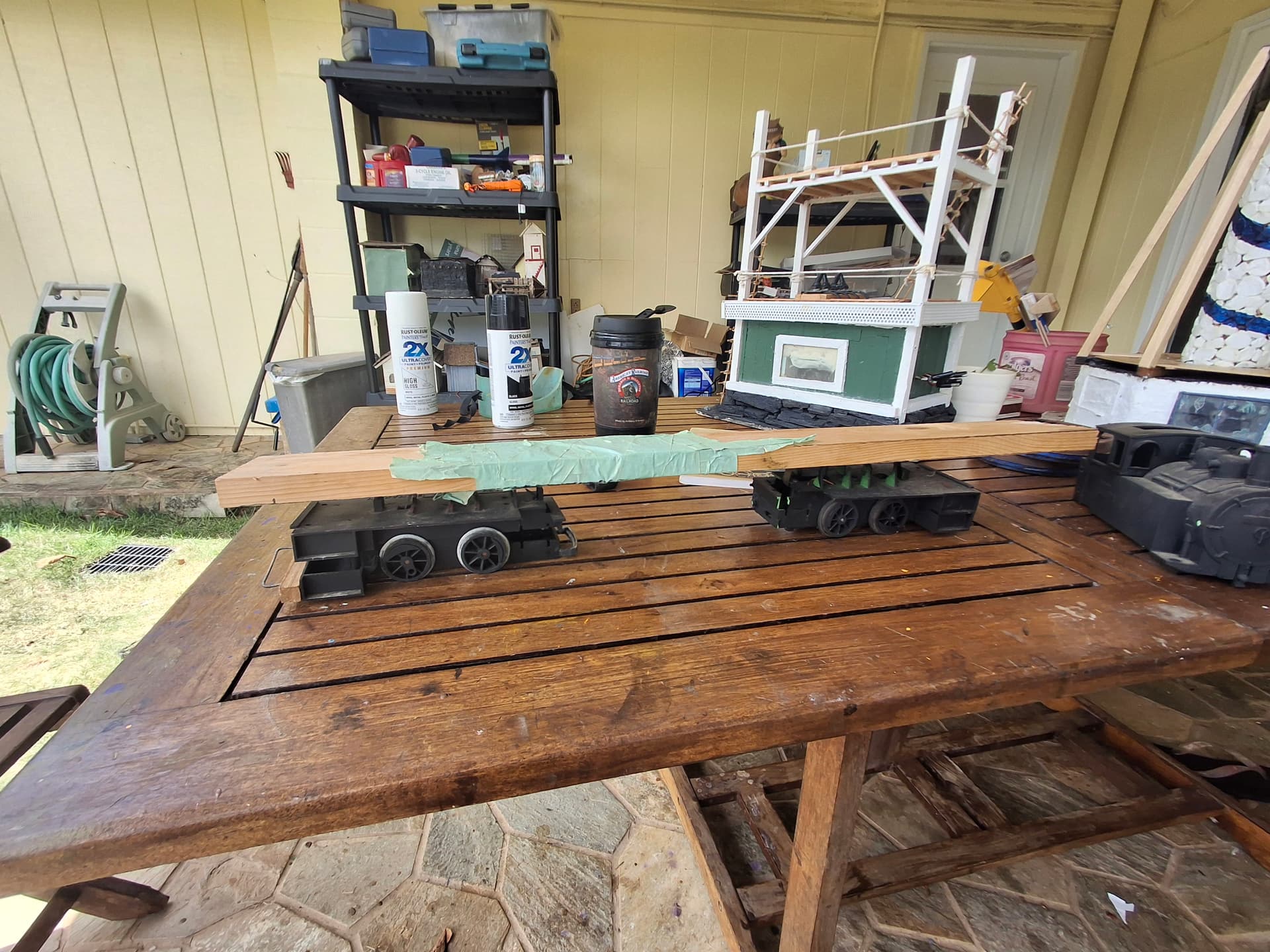

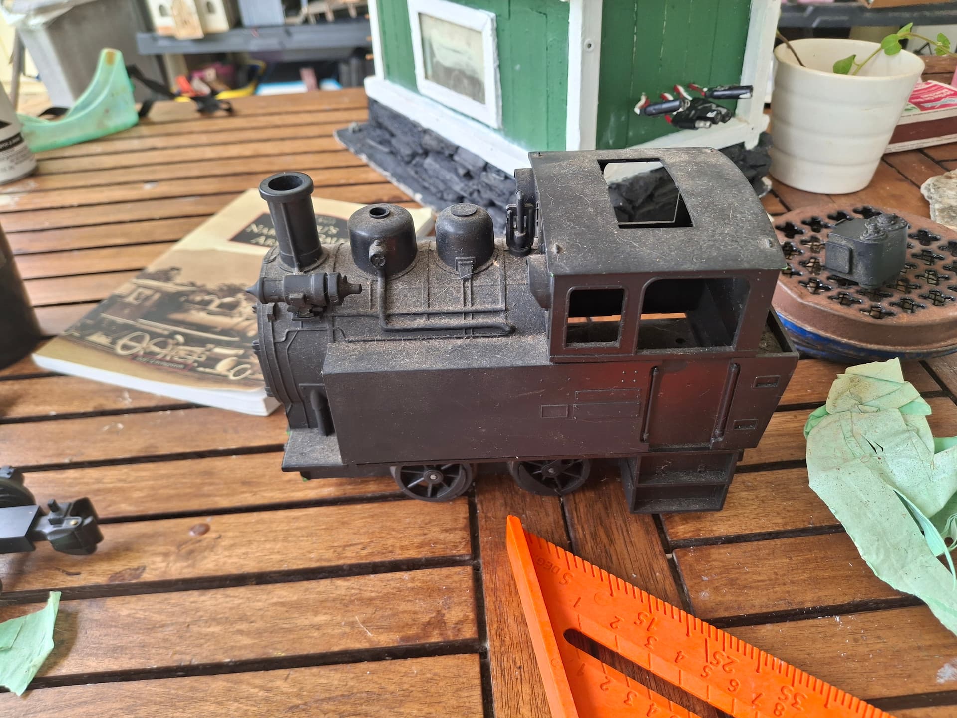

We did some material accumulation last weekend. I had originally thought to use the battered chassis of my re-powered LGB m2075 (battery). If figured the locomotive chassis would give this project an appropriate “heavy” look.
Kid-zilla then actually referenced the source material, and he noted standard freight trucks in our bits box would look better and be truer to the prototype.
Show off.

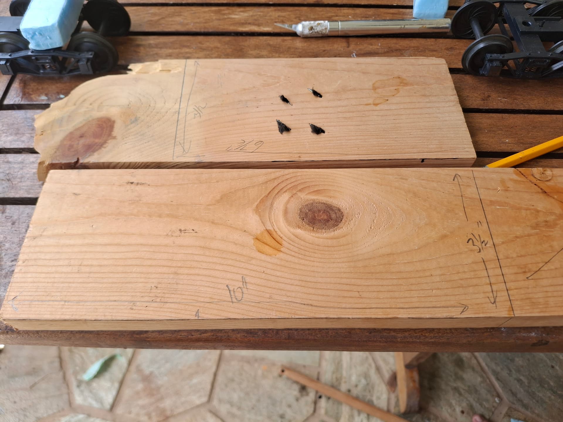

The board comes from our large “gemuckabucket,” wherein long, tall, awkward bits of stuff with no immediate hobby useage go until we recognize their worth. At one point, it had supported a mattress. When we pulled off the tape, we found this:
After nearly consigning this board to the hibachi, Kid-zilla noted that the longer, lower bit could be cut in two for the upper platforms and upper bit trimmed to be the lowered deck. Again I say, “Show off.”

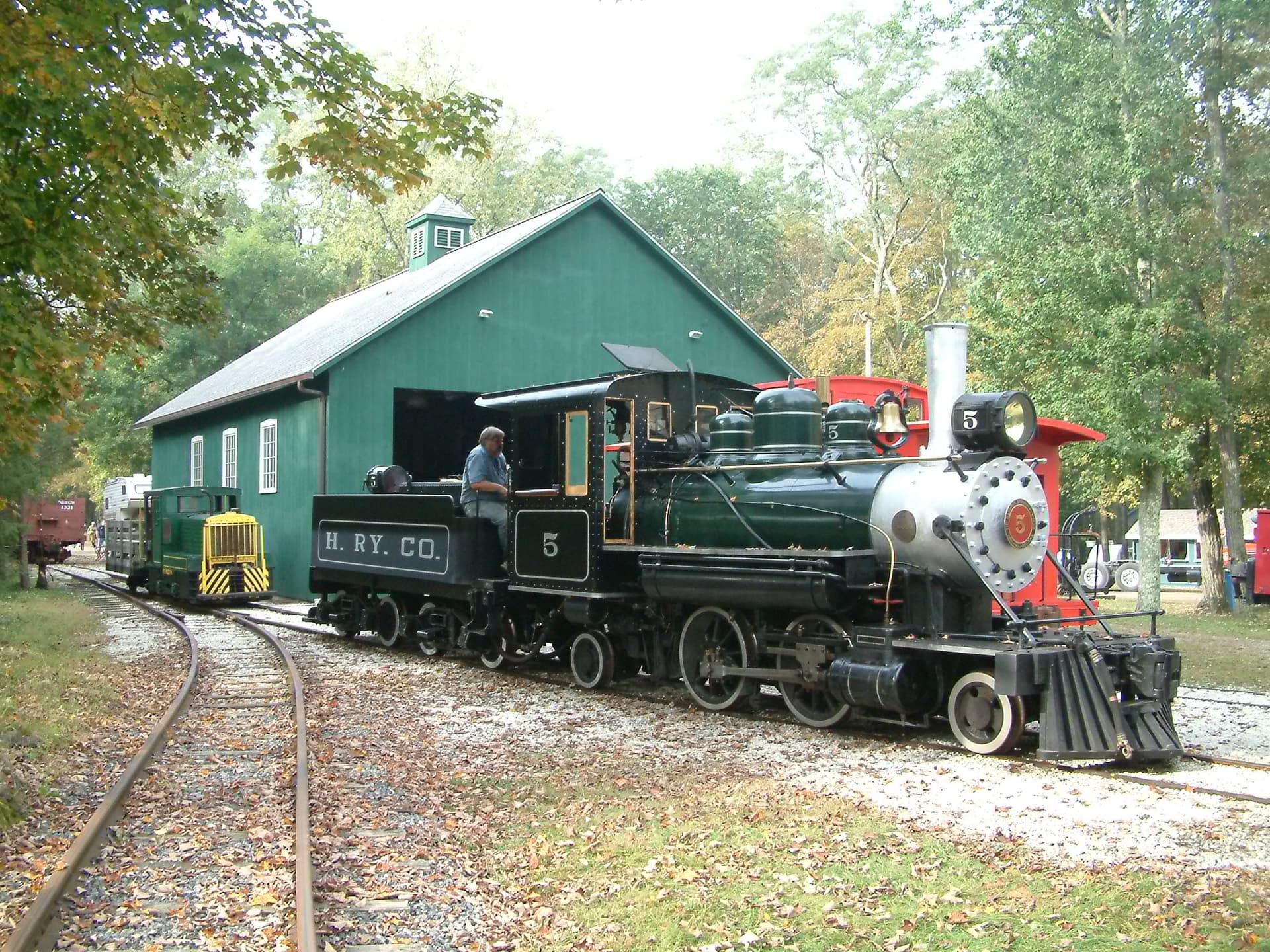

I purchased a Bachmann Industrial Mogul (2-6-0) years ago hoping to model Hawaii Railway #5 that runs at the Connecticut Antique Machinery Association in Kent, Connecticut…
But alas, H. Ry. Co. #5 is a 2-4-2 and I was never motivated to try and modify the Indy to that wheel configuration. :frowning:
The Indy would be a great place to start for the Oahu loco on the book cover!

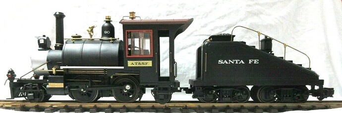

Might be able to start with an Aristo 2-4-2 Rogers, remove the saddle tank, and replace the tender.

For the project at hand, fear not @JRad ! There is a plan for a locomotive, as we have one more m2075 shell laying around.
We’re going to get a USA Trains or PIKO chassis, tram it up, and just have fun. Eventually…Interestingly, OR&L did not have a 2-4-2, so your Hawaii Railway Co. #5 could be from another island or a plantation. OR&L stuff went global when her flag fell…

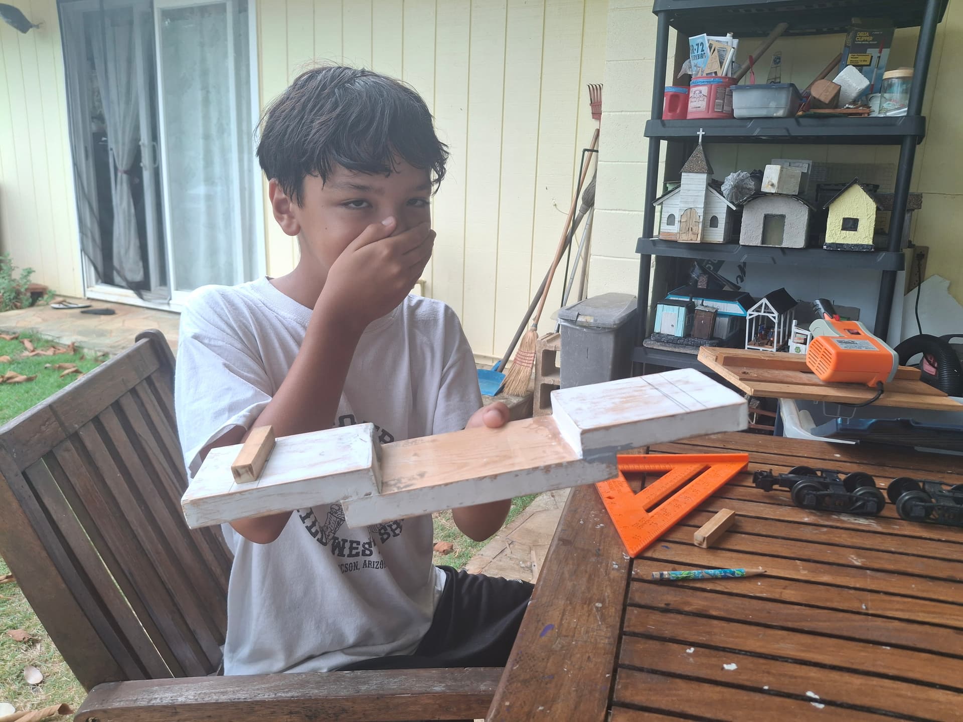

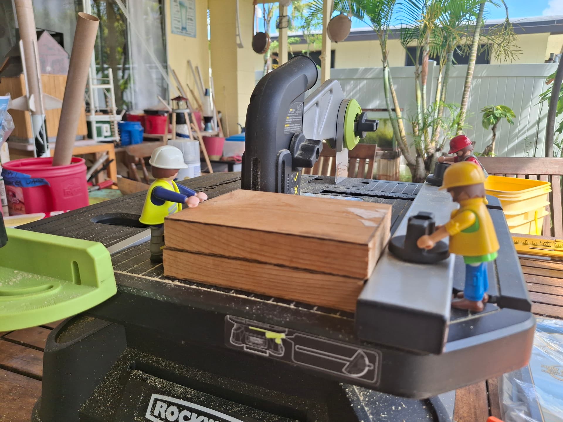

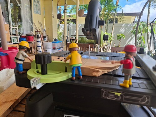

We are starting this project with the carriage, basing it on the picture in my previous post. We are gathering ideas and bits for the gun, but I want there to be some progress! To that end, the 1:24 gang and I brought forth Sabre Saw from its lair to convert a broken bed board into a lowered flat car.
My inability to make a straight cut is a long running joke here, and this was no different.

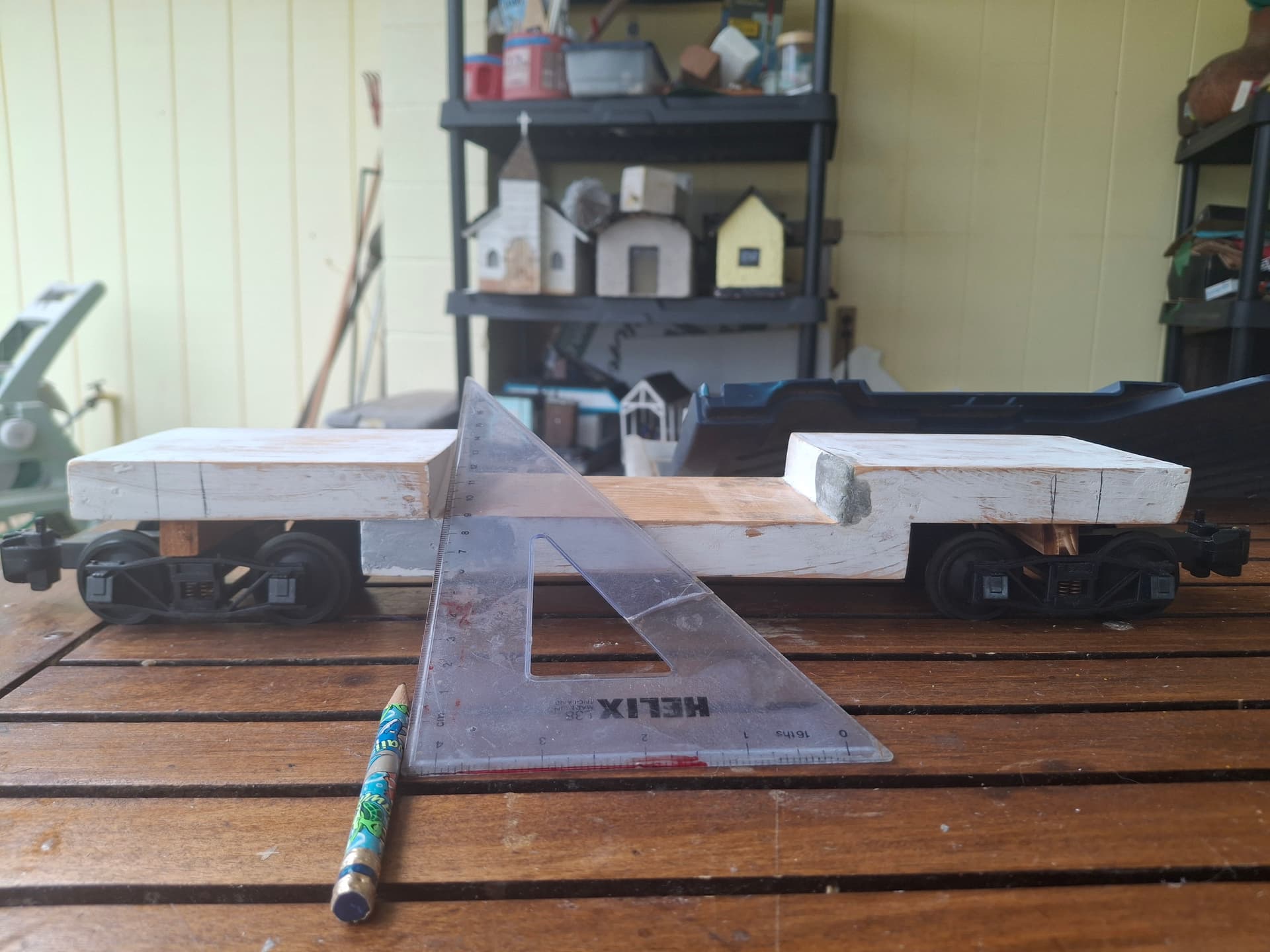

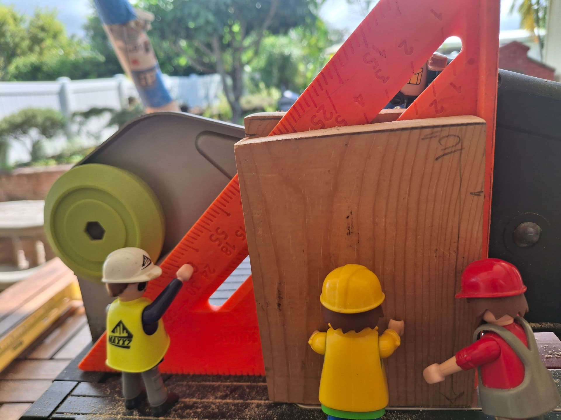

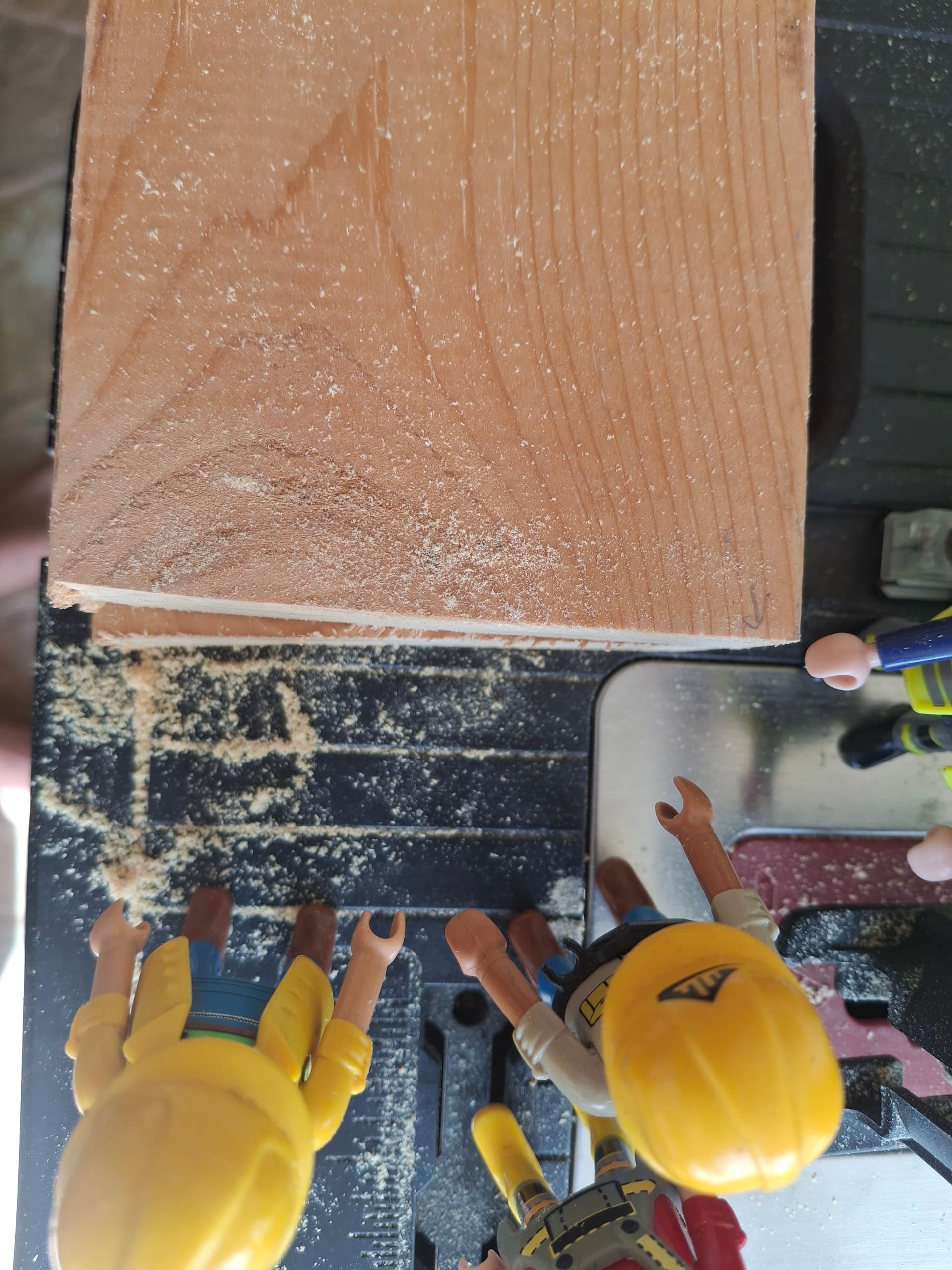

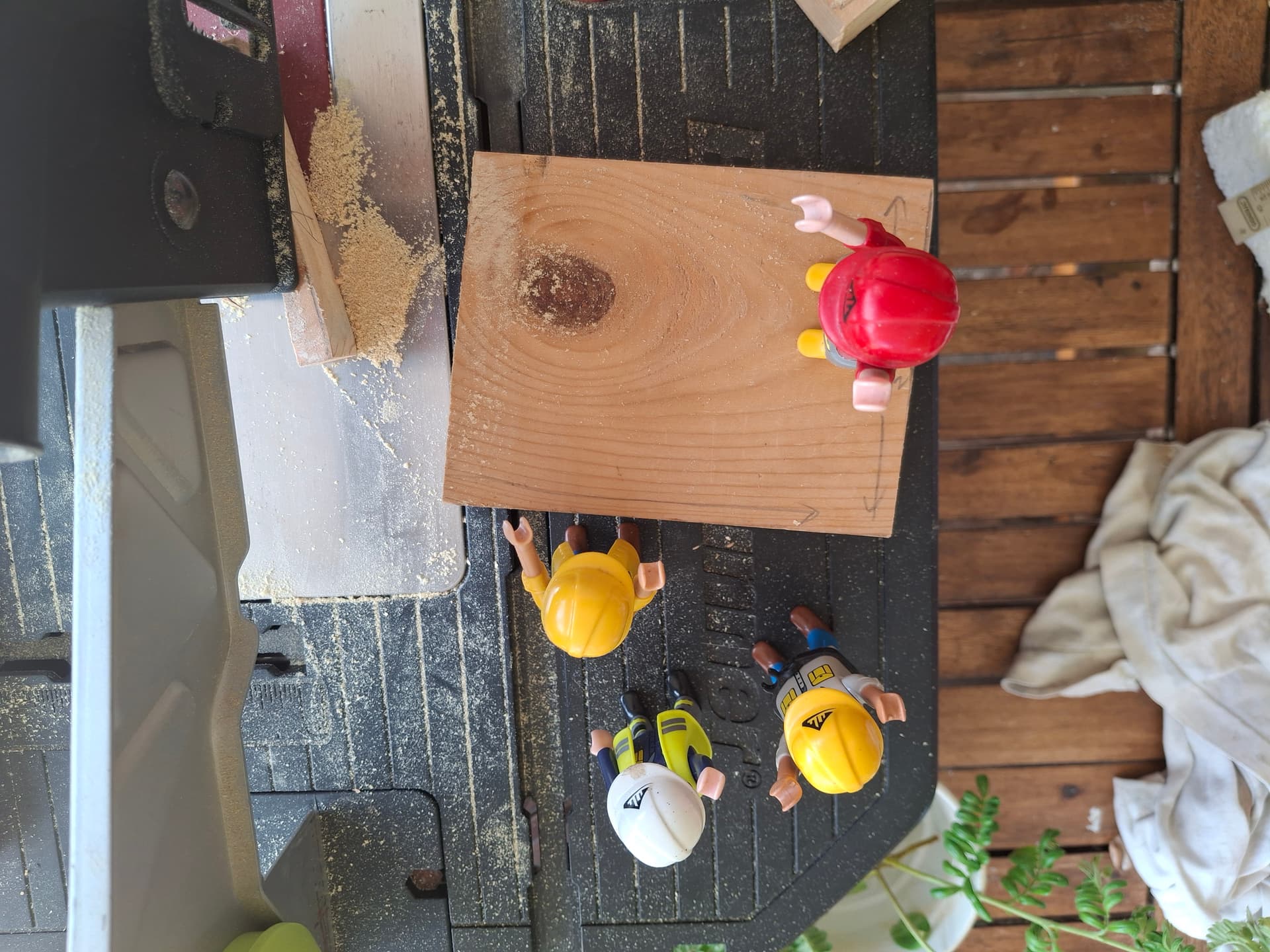

Realizing that countinuously sanding and filing and cutting to get even chunks would result in a Z-scale car, we used our triangle to assess the damage…
…set the gate appropriately…
…and got good enough.

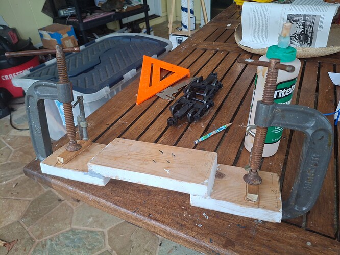

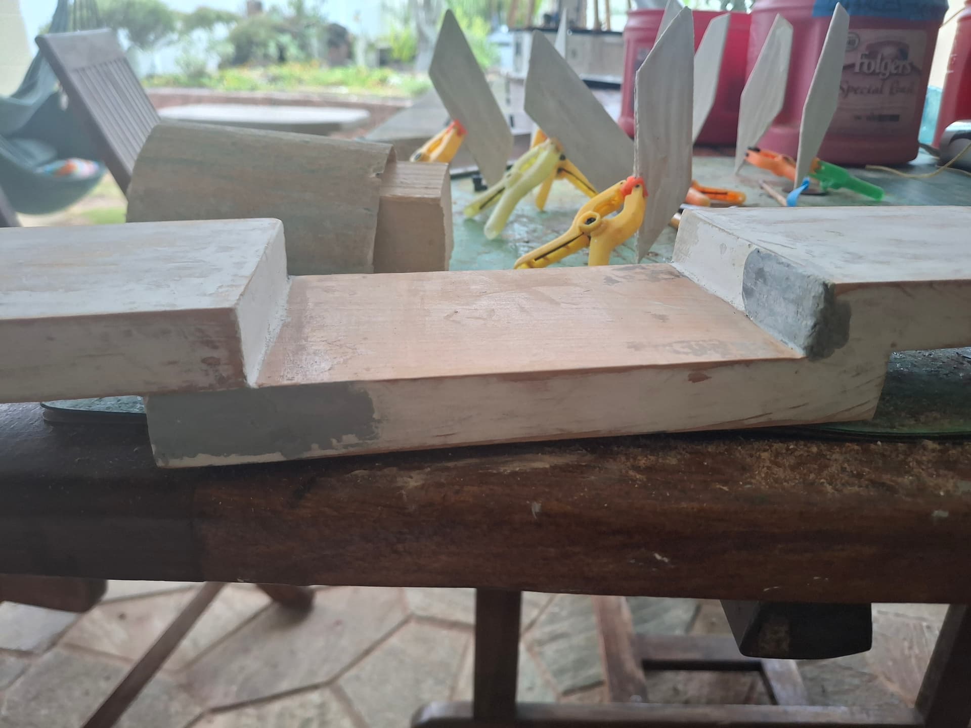

Kid-zilla noted the prototype sloped down to the lower deck. I noted no part of me was even going to make the attempt at an angled cut. He agreed we can make stairs, which other prototype images show. Phew.

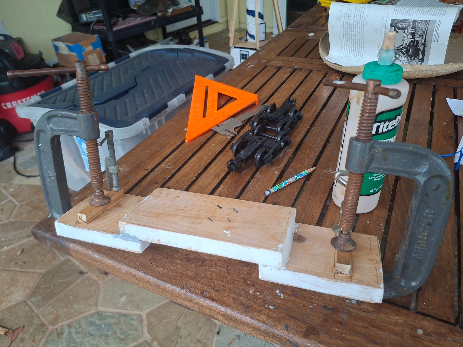

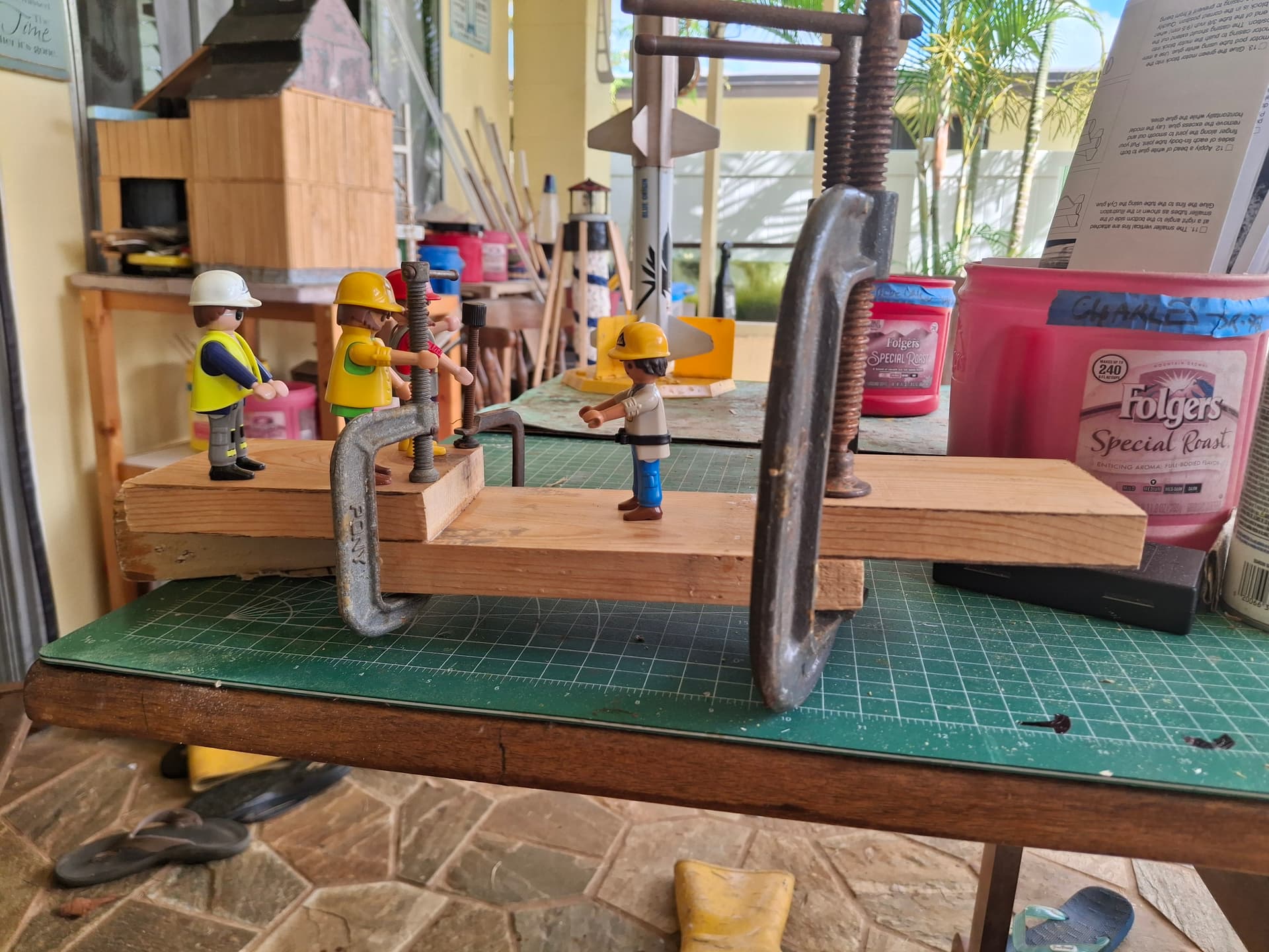

After a bit of glue and some clamping…
Kid-zilla and I parted company so I could engage in a dinner date…
…and get in some diving.

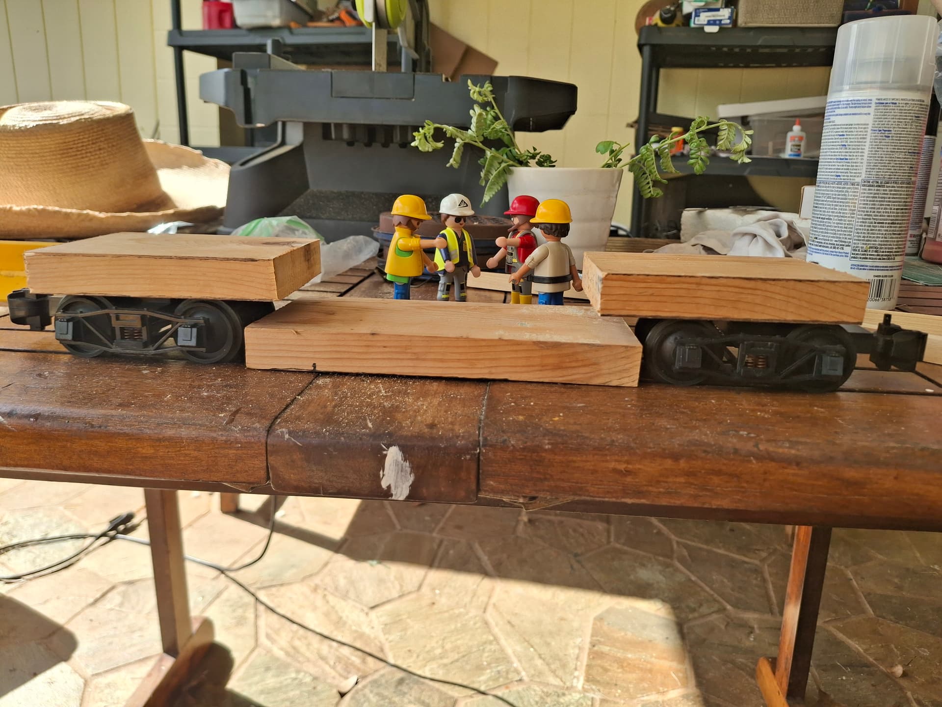

Kid-zilla and I eventually reconvened to put on some wood filler, sanded like the devil, and got a decent basis for this project.
The small timbers were used in lieu of bolsters to get a sense of the height. The whole rig is about the size of an LGB box car, so it should work.

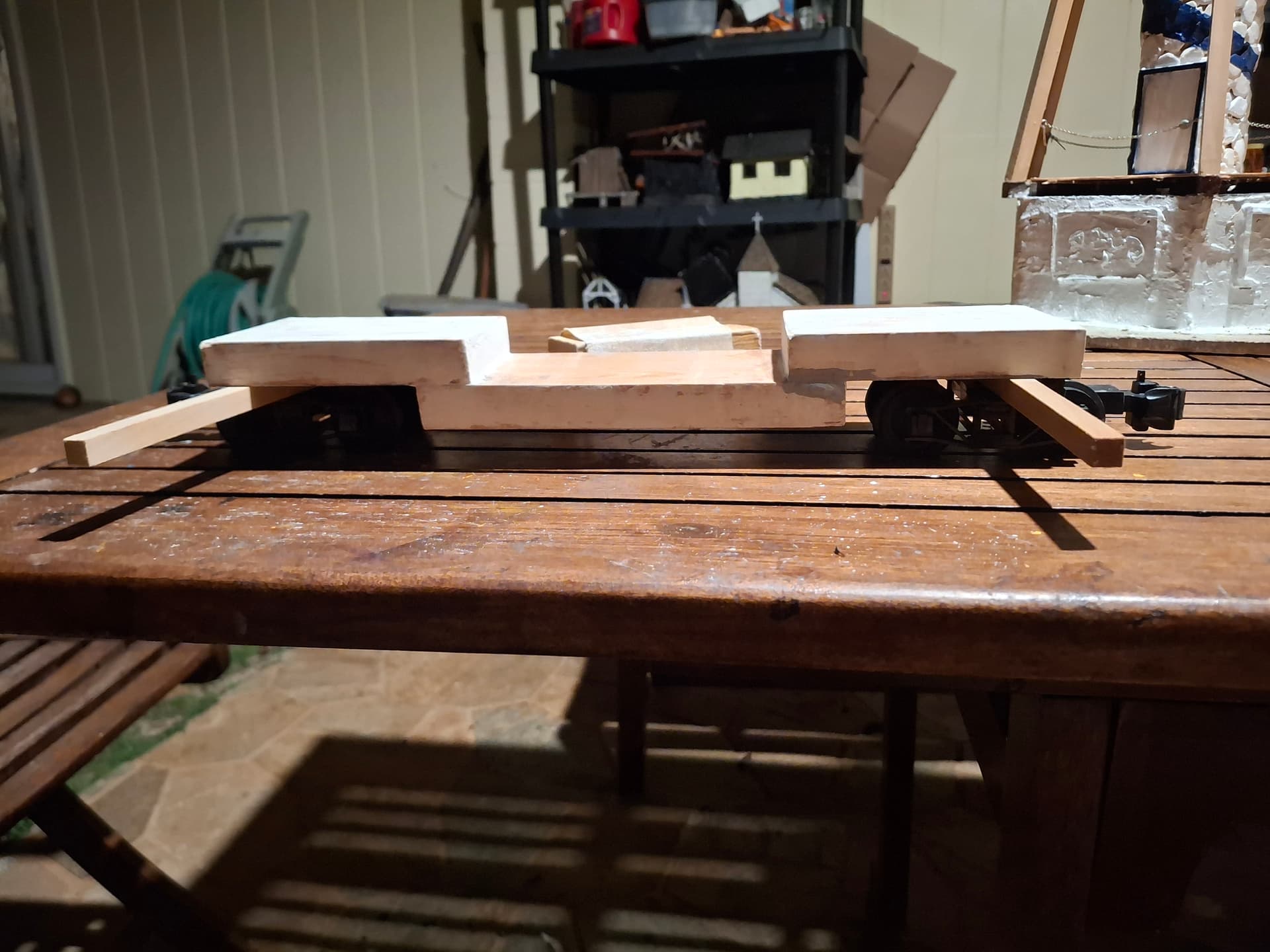

Update:
Kid-zilla took on my alternatively straight cuts with some epoxy putty and sand paper.
This will make the detailing much eashier. To that end, basswood strips are on hand, as are the beams for the bolsters. We’ll cut and install the latter this week or weekend before detailing out the car. No point in adding details if the car won’t roll on the pike!

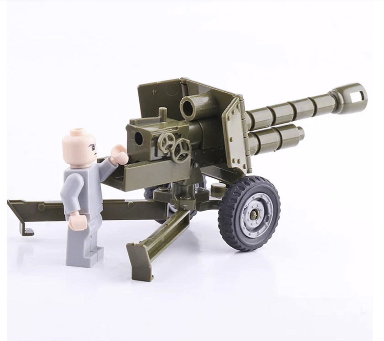

Here you go. $8 and the size of a Playmobil man.
https://brickblockarmy.com/products/ww2-m1938-m-30-howitzer-122mm
Or maybe something more elaborate?
https://field-artillery-store.myshopify.com/products/model-bricks-howitzer-set
I saw that set for $27 instead of $40, and Aliexpress has the same without the box for $6.40
https://www.aliexpress.us/item/3256812343602125.html
Pete,
A belated “Thanks!” These guys are actually LEGO sized, which is closer to 1:48 / O Scale (As an aside, I have heard that LEGO deliberately made sure neither their trains nor their wider system matched with any commercial model scales.). The m777 is a 155mm gun, or just over 6". That would make it a 3" piece in our PLAYMOBIL-sized world. The barrel diameter is not that important, though. I’d be concerned that our artillerists would look awkwardly large next to it. Still, this is pointing us in the right direction. If this company has, say, a 12" gun, we may be in business!
P.S. This “Sluban” company makes a wide array of WWII themed stuff. There is a hobby centered on elaborate LEGO-compatible models of WWII stuff, and those companies will drain the bank. This Sluban stuff could easily fill the background or serve as gaming pieces. Cool!

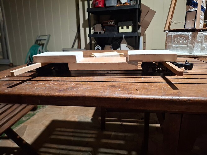

Speaking of this project, we made some today! I am home with 'flu, alternating between boredom and lethargy, using projects to combat the former and e-loafing to combat the latter. Frankly, bouts of lethargy are winning…
At any rate, I found some wood strip begging to become bolsters and cut it down to suit. Then, I used our triangle to align the trucks on both sides, lining up the car’s ends with the edge of the journal boxes the scribing vertical lines to mark where our bolsters have to go.
Kid-zilla came home at some point and determined I was too brain dead to continue. He was right. Note how I carefully marked the bolsters’ positions on the top of the flat car!
I showed him how to use our big, orange triangle to transfer the marks, gave him a ruler, pencil, and paper, and let him math and mark away.
The bolsters are drying in place as I type,
I was originally mad at myself for cutting the bolsters the width of the trucks rather than the width of the car. We referenced the photos, however, and this mistake works in our favor (“favour” for Pete (@PeterT) and Bill (@Hines). Sorry, @Korm m, no umlaut.). We reverenced the prototype photos, and the telescoping legs that stabilized the car when the gun was firing actually tuck in under the deck. I knew that subconsciously, of course…
With the bolsters in place we can begin detailing this thing, using our photos as guides. I think we should do the rivets. Kid-zilla thinks I’m nuts. We’ll see!
