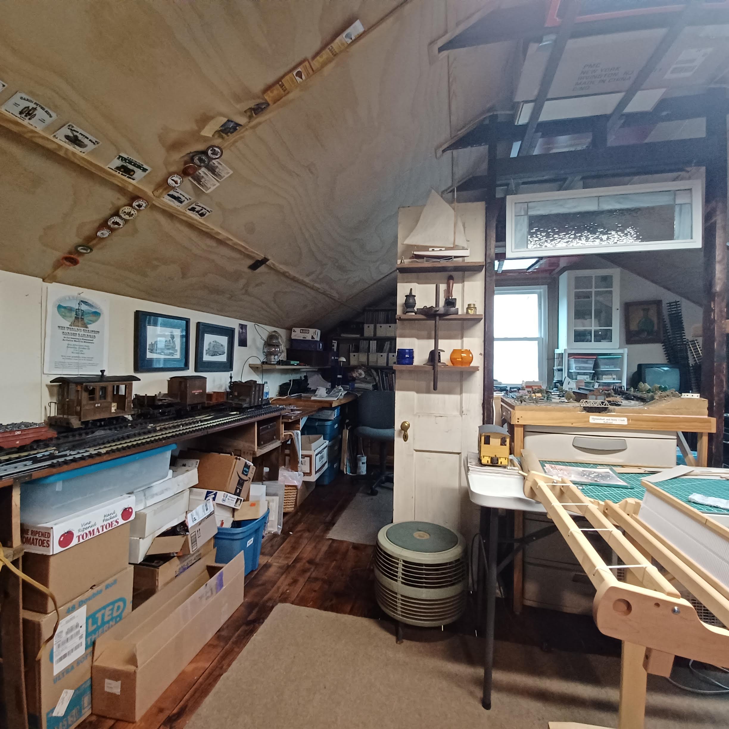

FWIW when I renovated my ancient garage, somewhat like yours, cheap construction from the 50’s with a second floor, I insulated then used plywood and it worked out very nicely, also storage for train boxes, half wife fabric room and half train room.
Jerry

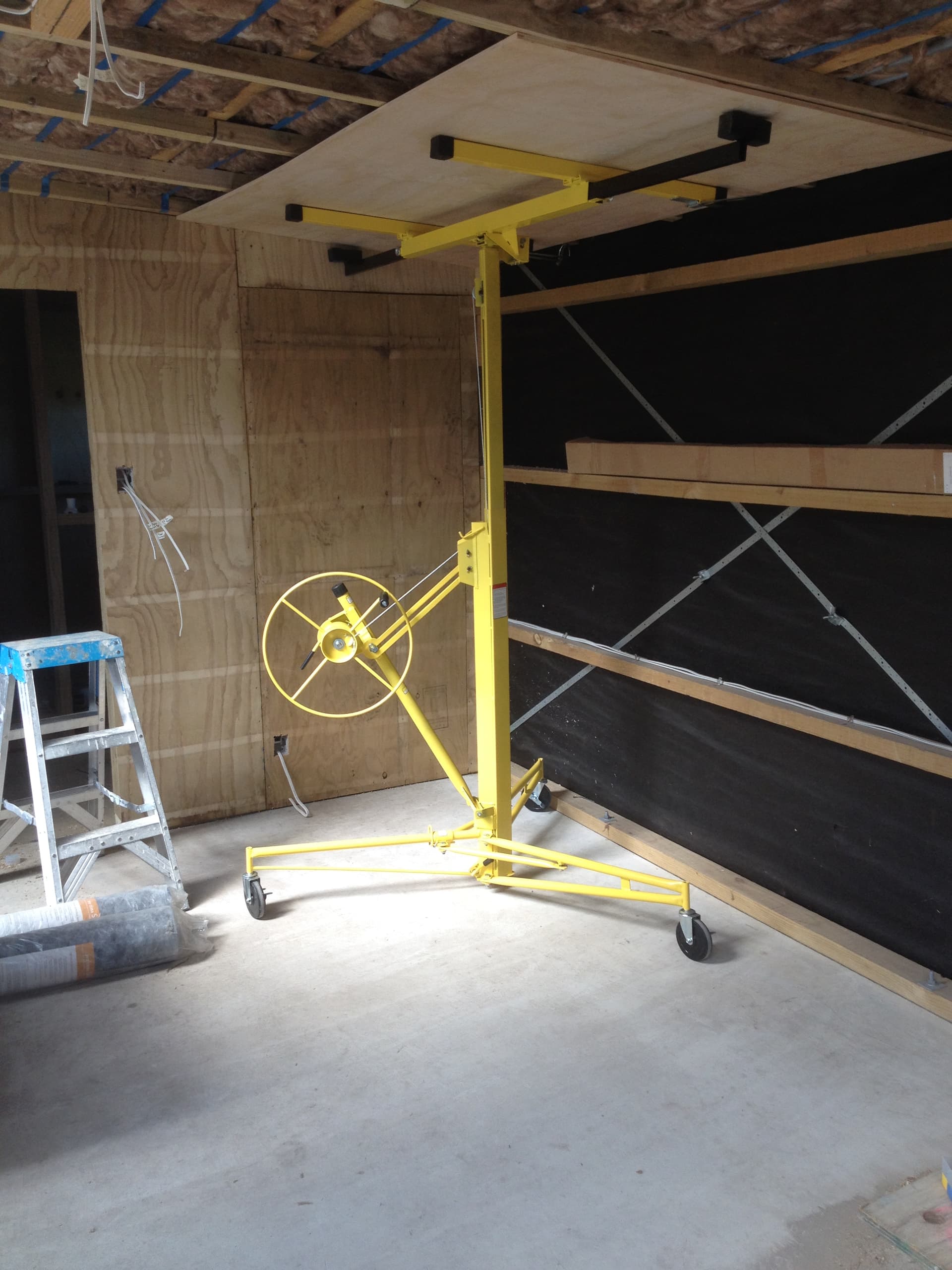

I lined the walls & ceilings of our shed with 12mm. Mainly as I had 2’+ spacing on the framing. I did splash out on a drywall lifter as I had 30 odd sheets on the ceiling. If I convert to USD I can get one locally for a touch over $200 today.
It was absolutely worth it, and you’re welcome to borrow it if you can pick up. :grin:

I’d love to, but I think I can buy one for a lot less than the round trip fare!
They are $220+tax here at Harbor Freight. I could probably sell it on Marketplace for $100+ when done. Might be worth it.
I’ve pretty much decided on the 3/8 ply but I will pre-paint it. I also think I will just buy new rather than trying to salvage the moldy stuff. My big decision on the moment is a flat and low (7ft) ceiling, or a angled side ceiling at about 7’ 9". The advantage to the lower height is I can get R-30 insulation between the ceiling and the joists making the roof truss. This allows storage above the roof joists.
Or, better yet, there is a slightly used one on Marketplace for $100 not too far away.
