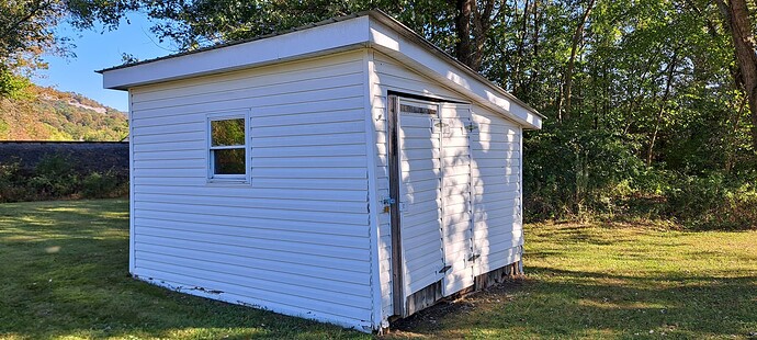

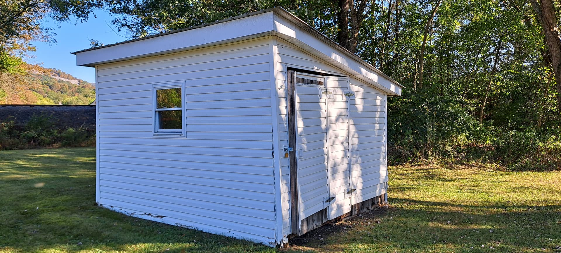

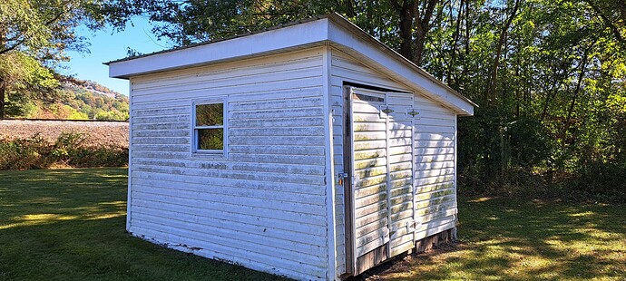

Today was power wash the tool shed vinyl and metal siding on the garage day. I didn’t take a before and after of the garage, but the dramatic difference on the tool shed was similar on the garage metal and the house vinyl.
My brother and sister-in-law are coming down for the FEBT reunion this weekend. I don’t want the view from the train to look bad!

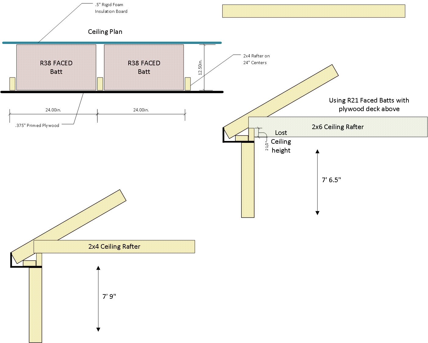

I’m still struggling to make a decision on what to use for a ceiling and what insulation to use. I’d like to use a high R value in the cieling and create some empty box storage above the ceiling. I’ve decided, due to cost, that the actual cieling will be primed 3/8" plywood paneling. The framing and insulation is still an open question.
I could use 2x4 rafters on 16" centers and R15 insulation with some plywood above for storage. Estimated cost of rafters and insulation is $450
OR -
I could use 2x6 rafters on 24" centers with R21 insulation and still use plywood decking above where needed. Estimated cost of rafters and insulation is $635
OR -
I could use 2x4 rafters on 24" centers and R38 insulation. The insulation would extend well above the rafters. I could use a few sheets of 1/2" rigid foam insulation board above the insulation to store empty boxes on. Estimated cost of rafters and insulation is $685
Using 2x6 rafters I will loose 2.5" of ceiling height as shown below…
Even though the R38 is the most expensive option, it maintains the ceiling height and uses less rafters so less labor. Also, I expect I’ll save quite a bit on Propane with the additional insulation. It will probably be the winner.

I wouldn’t do a rigid foam over squishy insulation, because the foam board isn’t that rigid. You’d have to limit what you put up there.
My first question is, How will you access the above-ceiling stuff? With every third space left open, or? How do you close those access spaces with insulation? Hinged panels? And will you put lighting in this attic area? If it’s not easy to get stuff up there and back down, it’ll just be a deep six zone.
The vaulted approach has advantages. Your existing rafters (diagonals) are what, 2x4? You could double their depth by adding another set of 2x4’, using long deck lag bolts to secure them. That way you’d have space for baffles against the roof sheathing (a must; air must flow between soffits and ridge) and 6" of insulation betweeen the newly-widened rafters.
You could leave the back side of the insulation exposed, or panel all that and paint. That’s what I did. I don’t necessarily recommend that, because it was SO tedious to work above the joists and notch around them. If you want to know how I did, let me know.
Regardless, the ceiling joists (horizontals) can become a rack for long stock. All is visible, no extra lighting needed.
Also, you can make plywood shelves at the ends of the joists, partial or all the way down the shed, for small item storage. That would leave ladder / access space down the middle, with things to left or right in easy reach.
FWIW I’m using the exposed joists for a mix of lumber and sheet scraps. With a ladder nearby, it’s worked quite well to get stuff up and down.
If I did that, it would only be for empty box storage, nothing that would compress the fiberglass or damage the foam board.
I plan on a single hatch, 24" x 36". A plywood cover perhaps with insulation attached. The access could accommodate pull down stairs in the future. If there will be lighting, it will be just a single bulb fixture near the hatch.
I’m resisting the vaulted cieling for several reasons. It would be more expensive, requiring more insulation and cieling panels. The additional cost of sistering all the roof joists to accommodate more insulation would push me over budget. I don’t enjoy working on a ladder and above my head, so installing all that would not be my first choice.
I’m going to give this another hard look today. I’ll look at the option of using the level of the existing rafters which would give a higher cieling and use less wood.

Jon I’m with you about keeping warm so I like your last idea but why so tall it just makes a bigger space to heat.
As usual, Rooster is right. If I use budget as a guide, using the existing rafter height, I’ll call it semi-vaulted, by adding 2x4’s on 16" centers where they are missing and using R15 insulation comes in as the least expensive option at just over $400 without any paneling.
But then, dropping it to flat across is only $20 more. A lot less space to heat.
Spending the extra $20 once seems like it will save you plenty in the long run.
Yes, and it’s a simpler install. The rafters can rest on the top plate rather than being suspended in mid air trying to keep them all at the same height!
