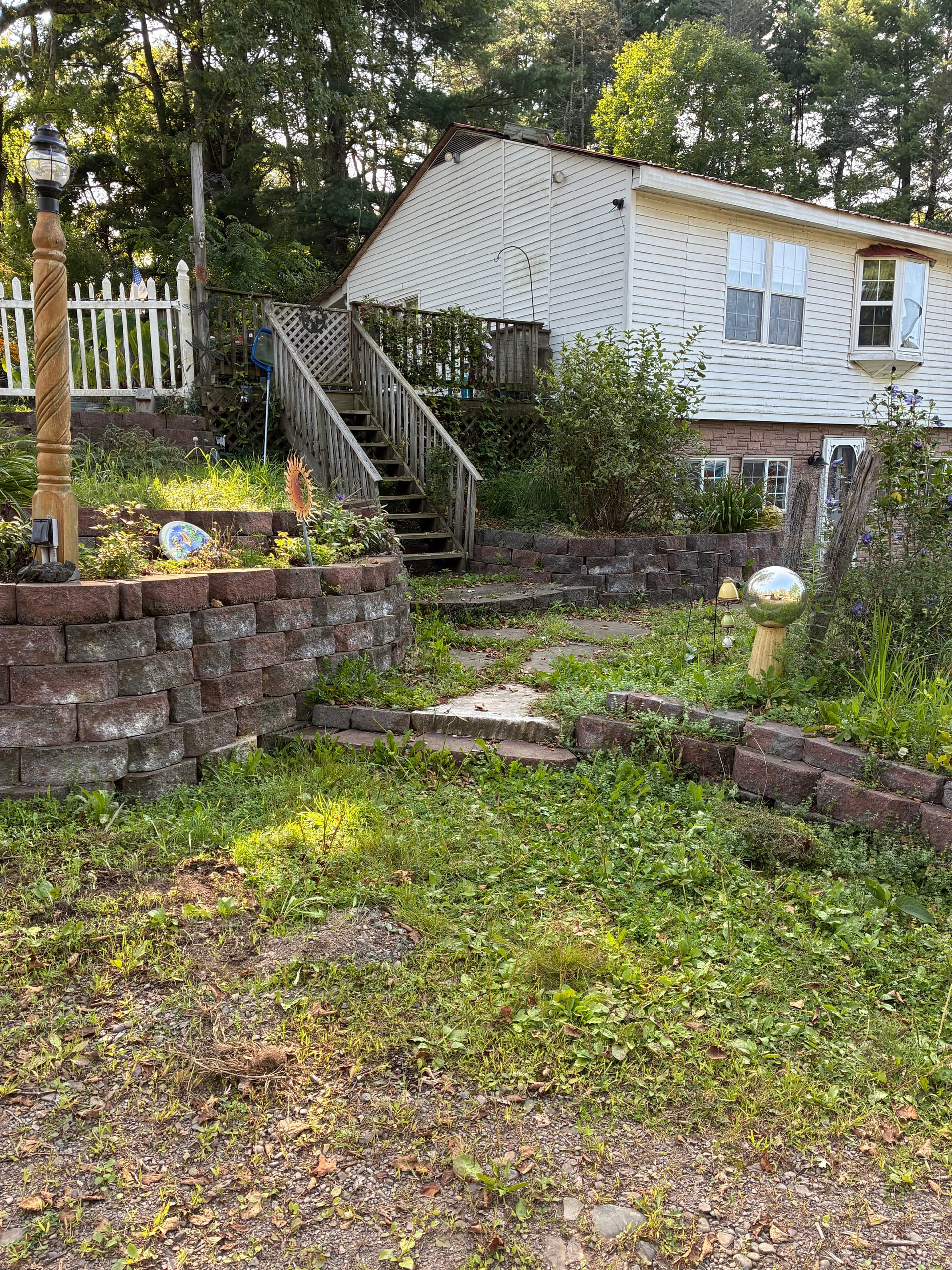

We are fast as we have had lots of experience with the blocks, we have over 1000 blocks stacked at our house. I will have to post some pictures of our other walls.

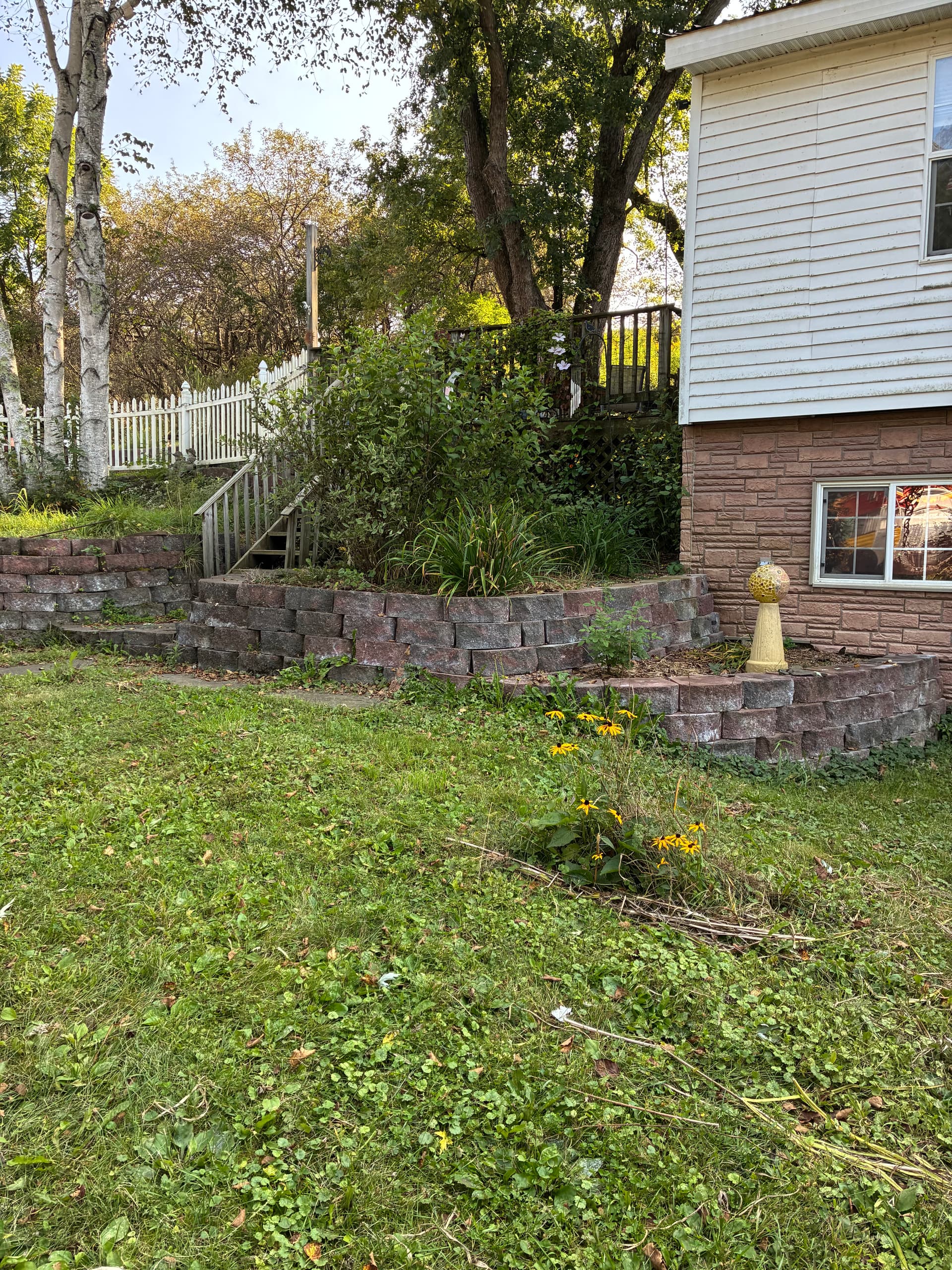

Here are the block walls we have done over the years. Steps up to the deck.

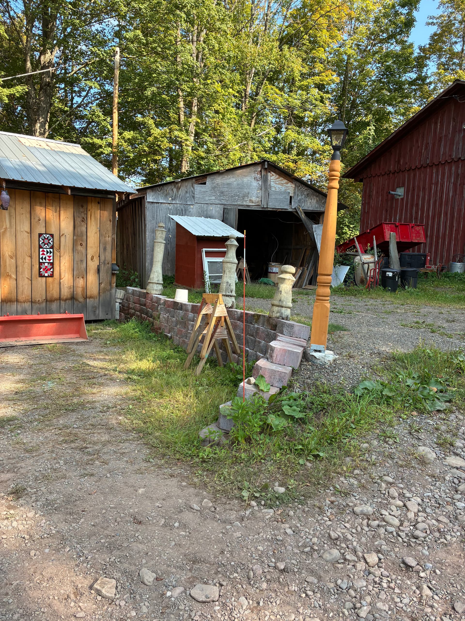

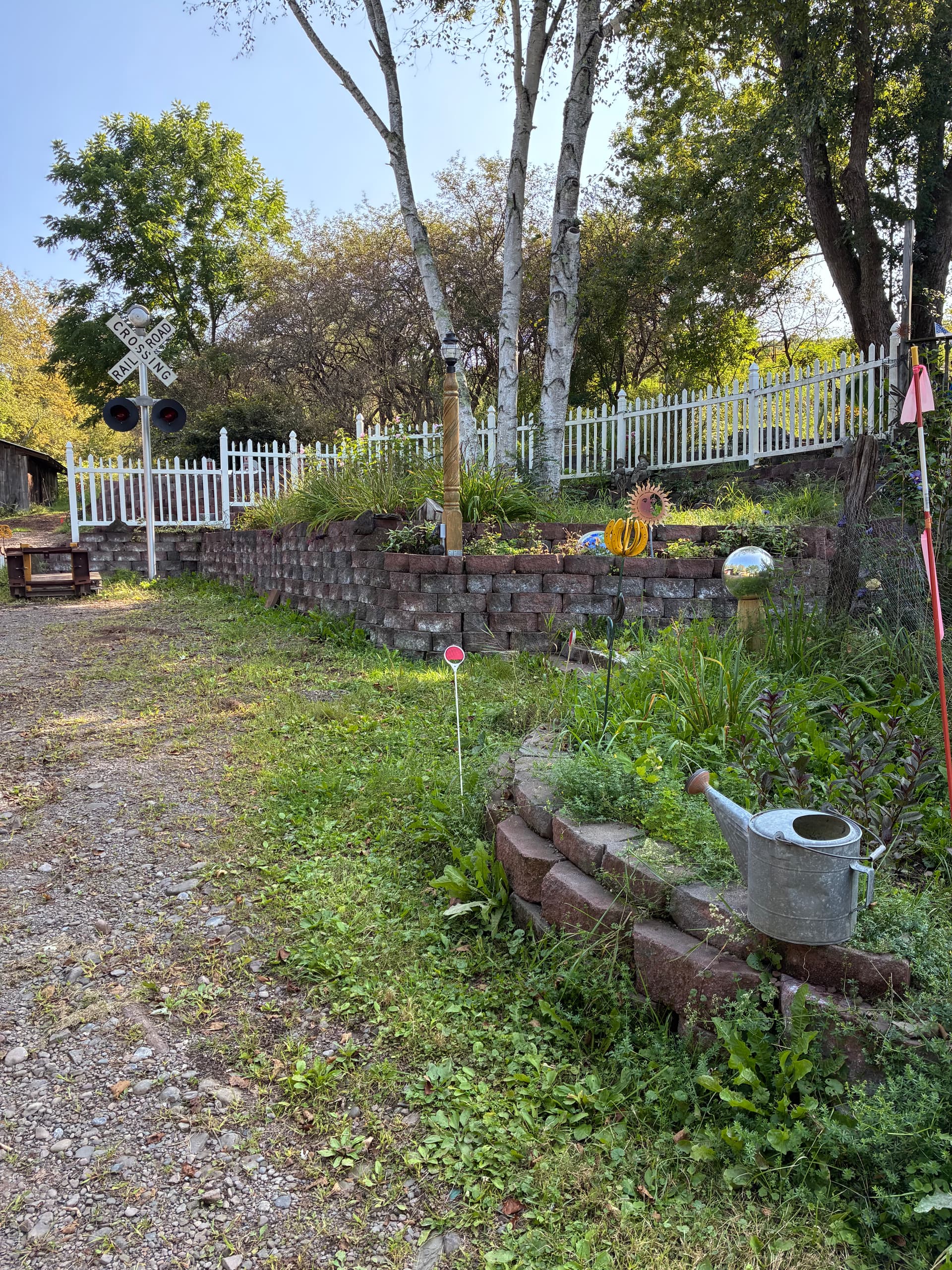

By the driveway the bigger pond is to the right of the lamp post.
Front of the house.
The building to the left is tractor and camper garage, on the right is the old furnace shed that I have to clean out and repair.

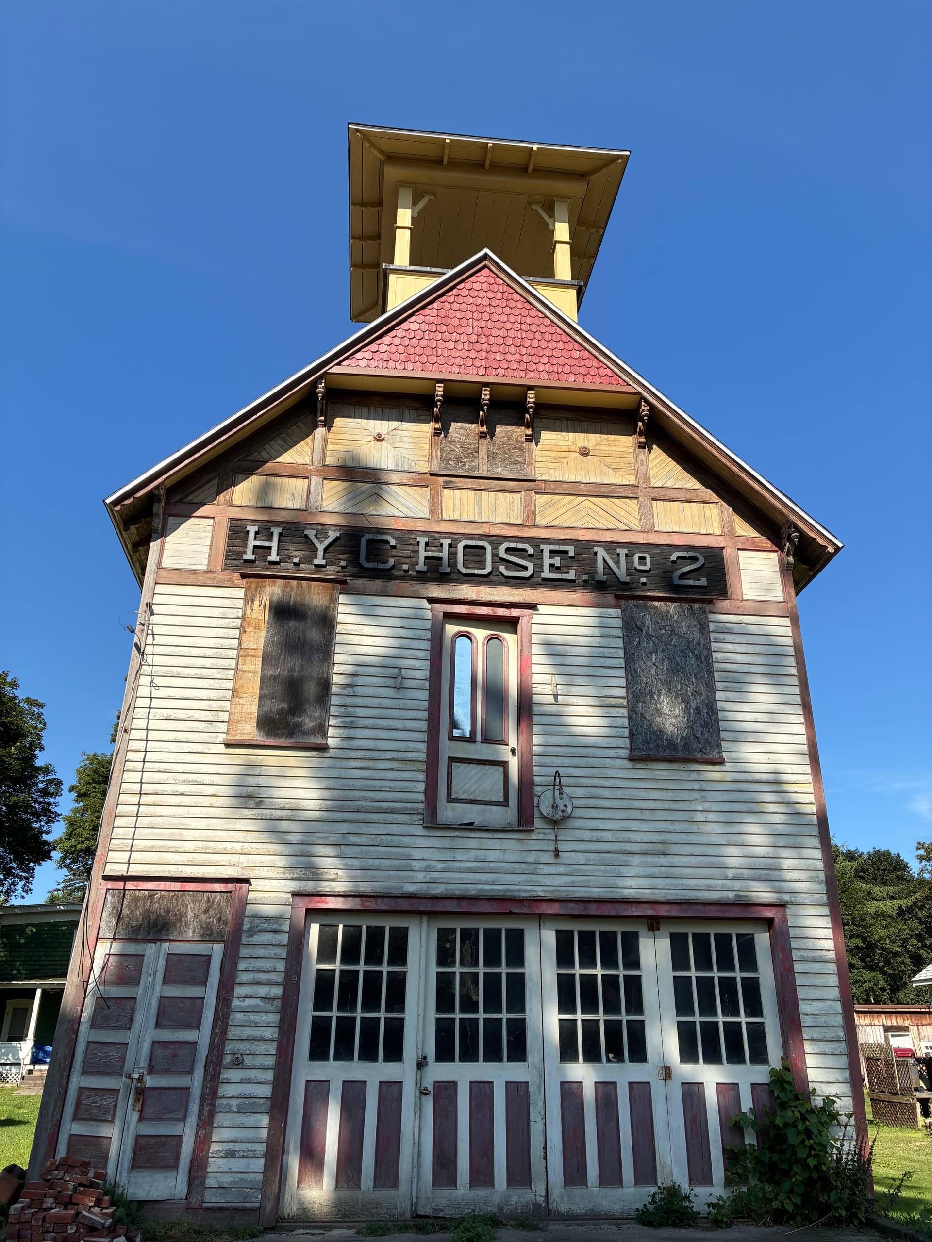

This is a picture of a fire house from many years ago that I am going to model.
This is what it looks like now, a local business owner is slowly restoring it, he gave me permission to measure it and take close up pictures.

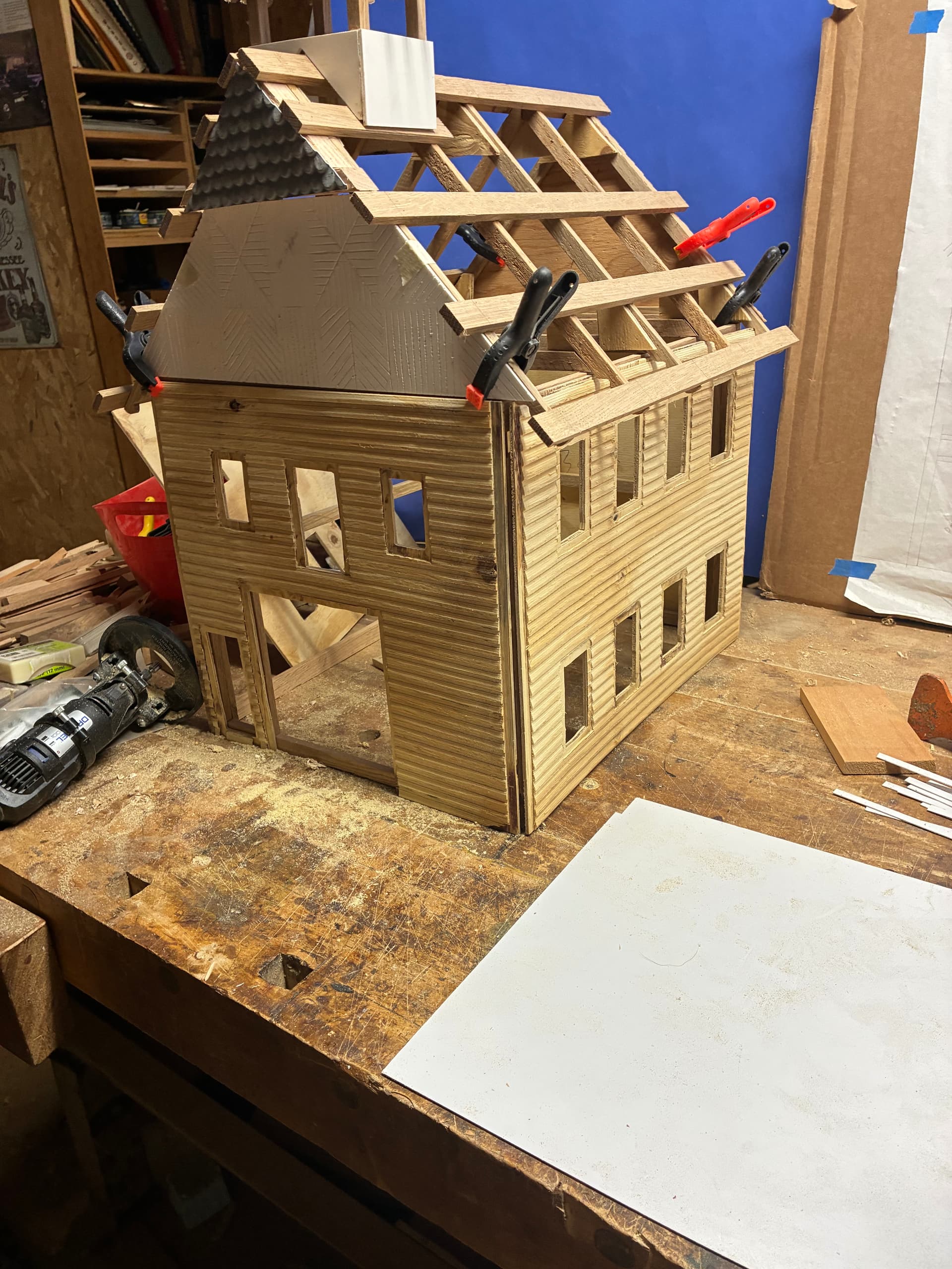

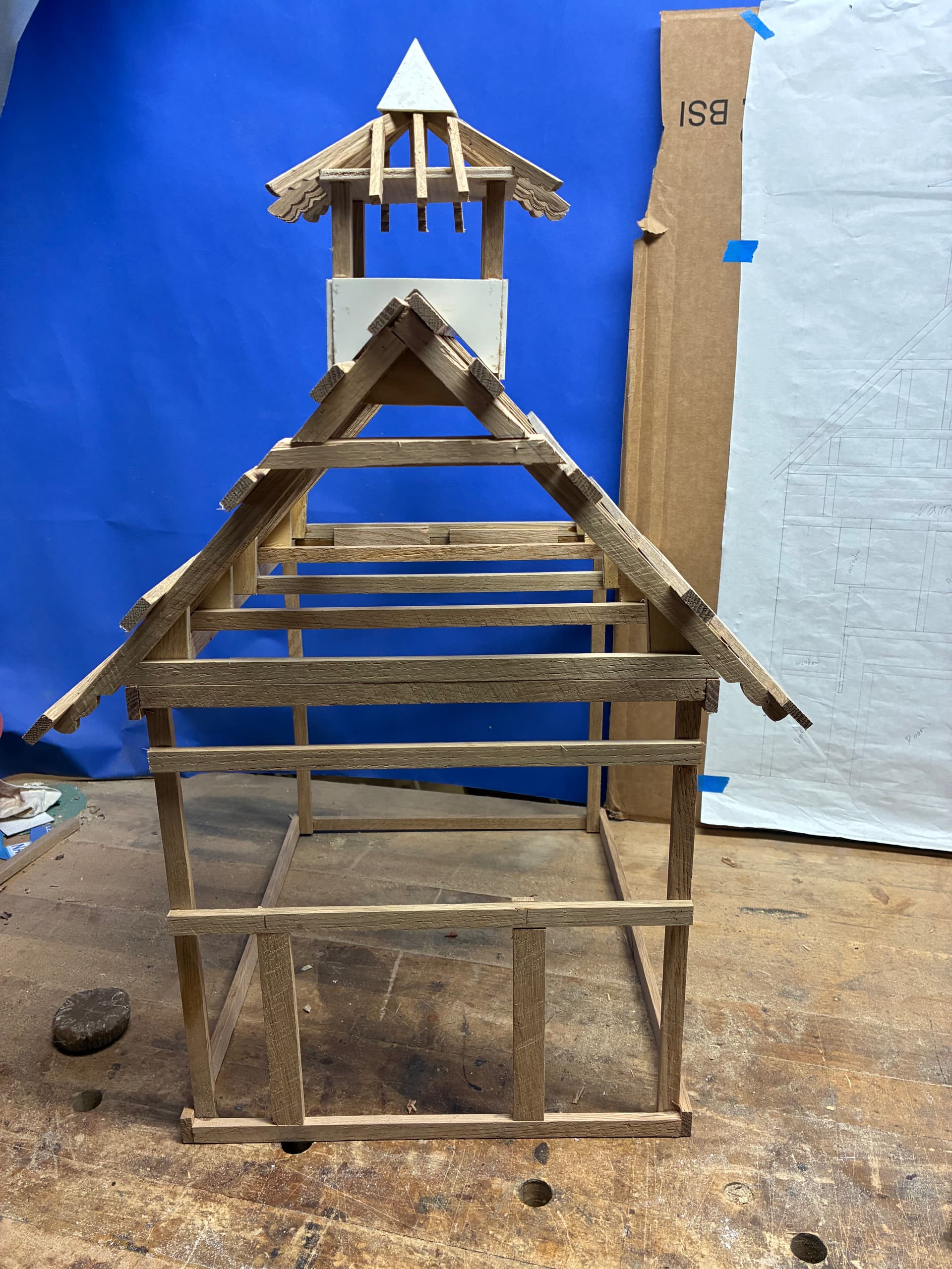

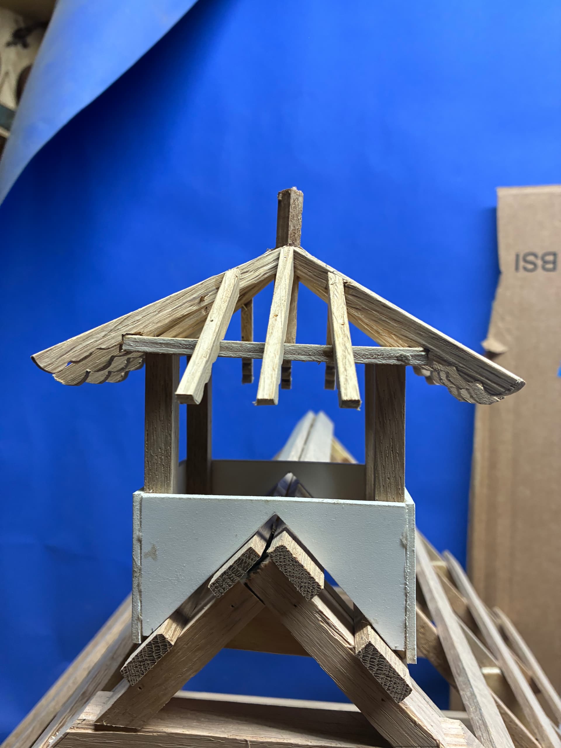

It has been to nice out side to be in the shop, then it rained for a couple days which we needed, so I started to model the fire house.

I suppose the tower part held a bell for sounding alarms, and was not intended for hose drying? Neat structure.
Regards, David Meashey
It is my understanding there was a engine tire (steel ring) up there, he is trying to find one.
Have him contact Brad Esposito at the East Broad Top Foundation. There are a large number of tires on the property many of which are for locomotives that no longer exist. A purchase or barter might be possible.

Had some shop time to work on the fire house. With the weather turning colder I will be in the shop more. Marie is painting the siding and trim, assembly should be this week.

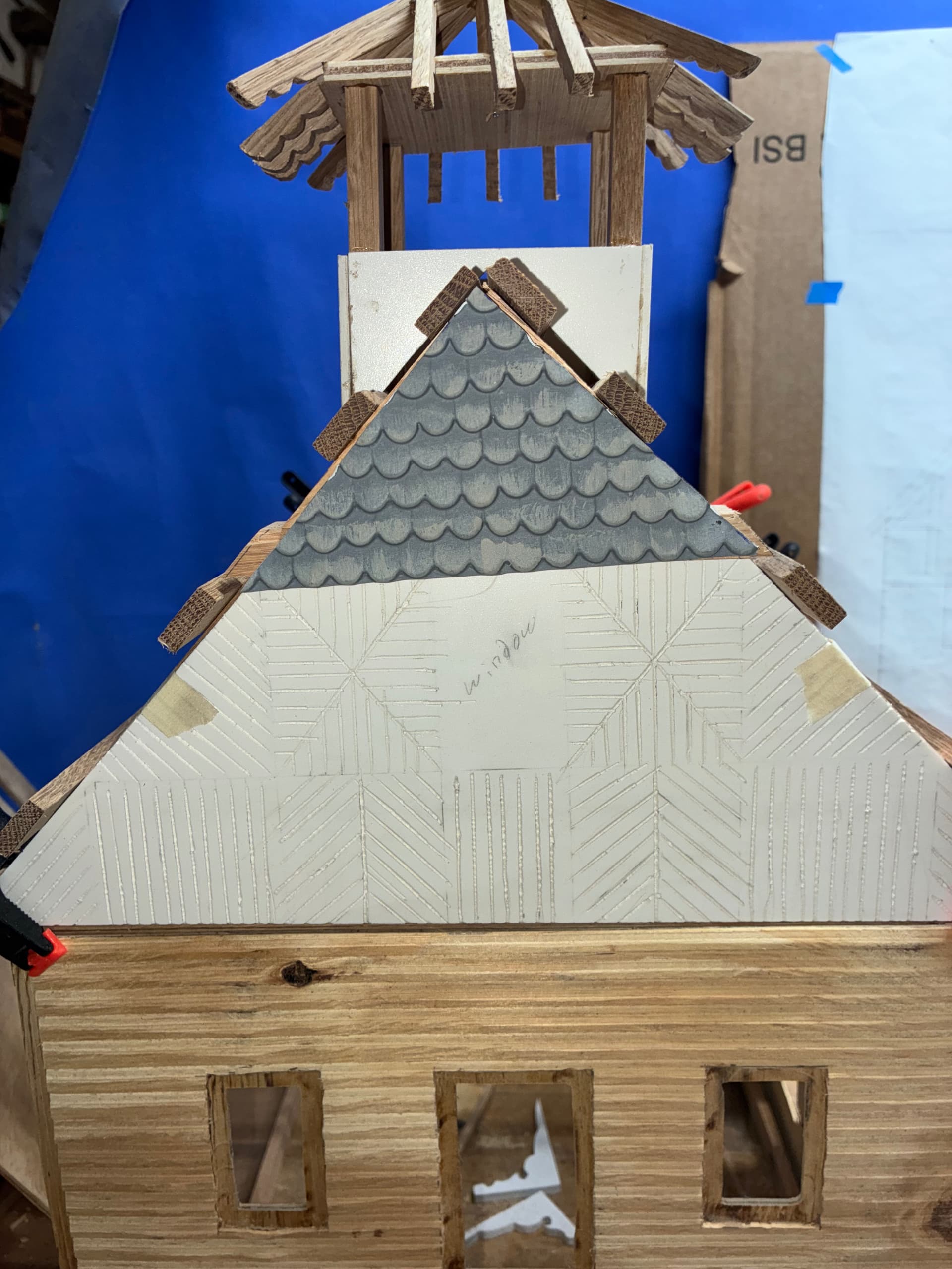

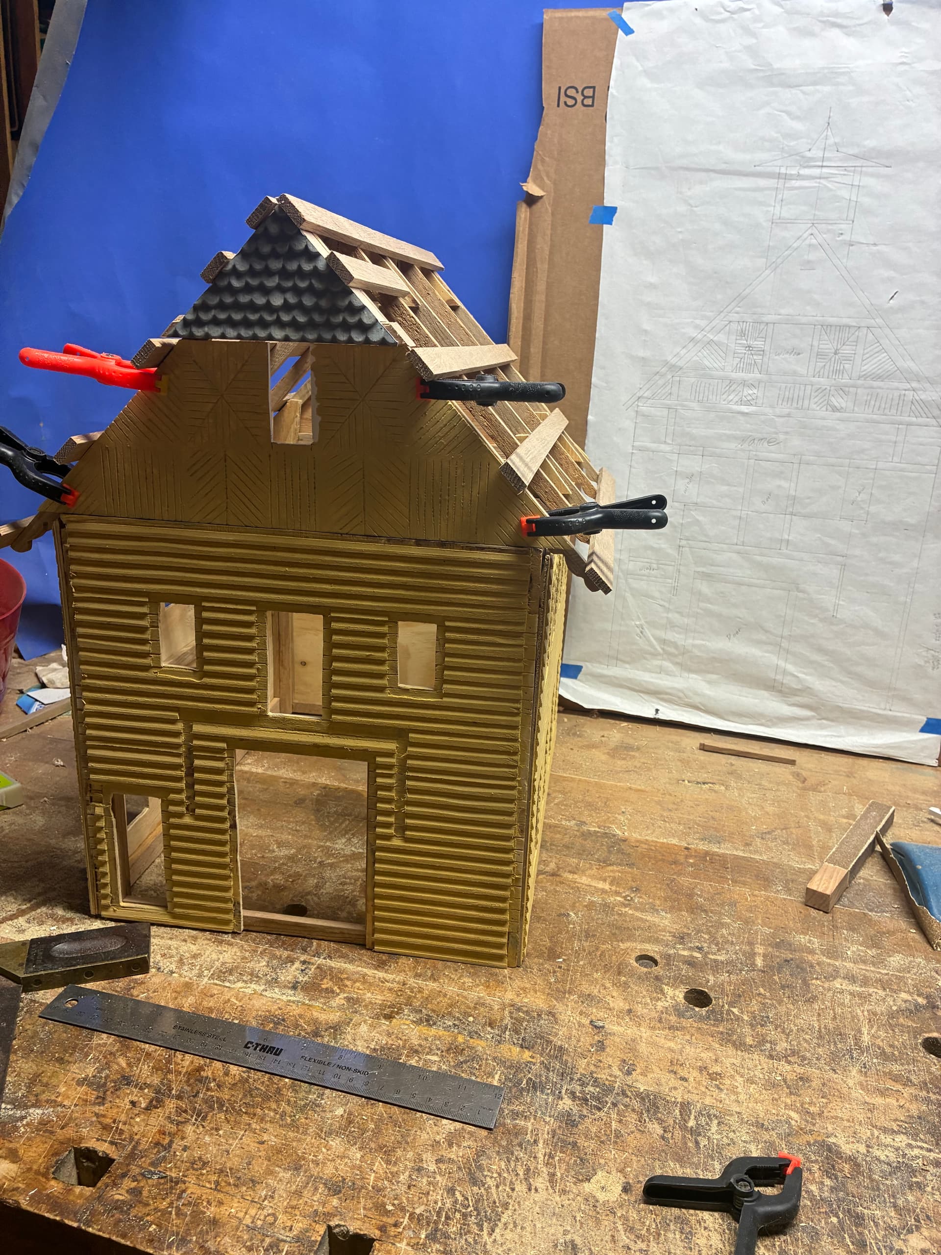

Mark would you run us through how you did your shingles and siding?

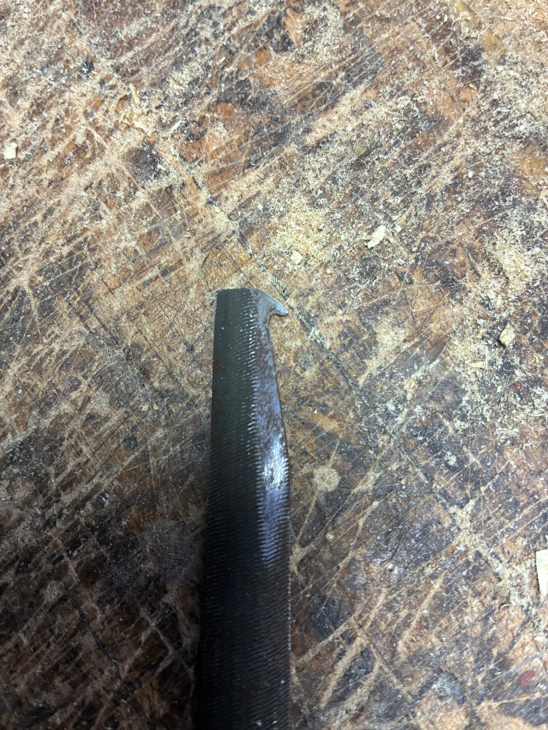

The shingles are plastic from Ozark Miniatures (https://ozarkminiatures.com). The siding in the peak on the end is PVC that I put groves in to simulate individual boards.
Picture is of the tool I made from a file to make the groves. Using a steel straight edge I pull it and the point cuts a grove.
The lap siding is made with plywood cut on my table saw. Using a dado blade I set it at 15* angle and move the fence each cut depending on how wide I want the boards. This building I am making 3/8” cuts so I move the fence 3/8” each pass.

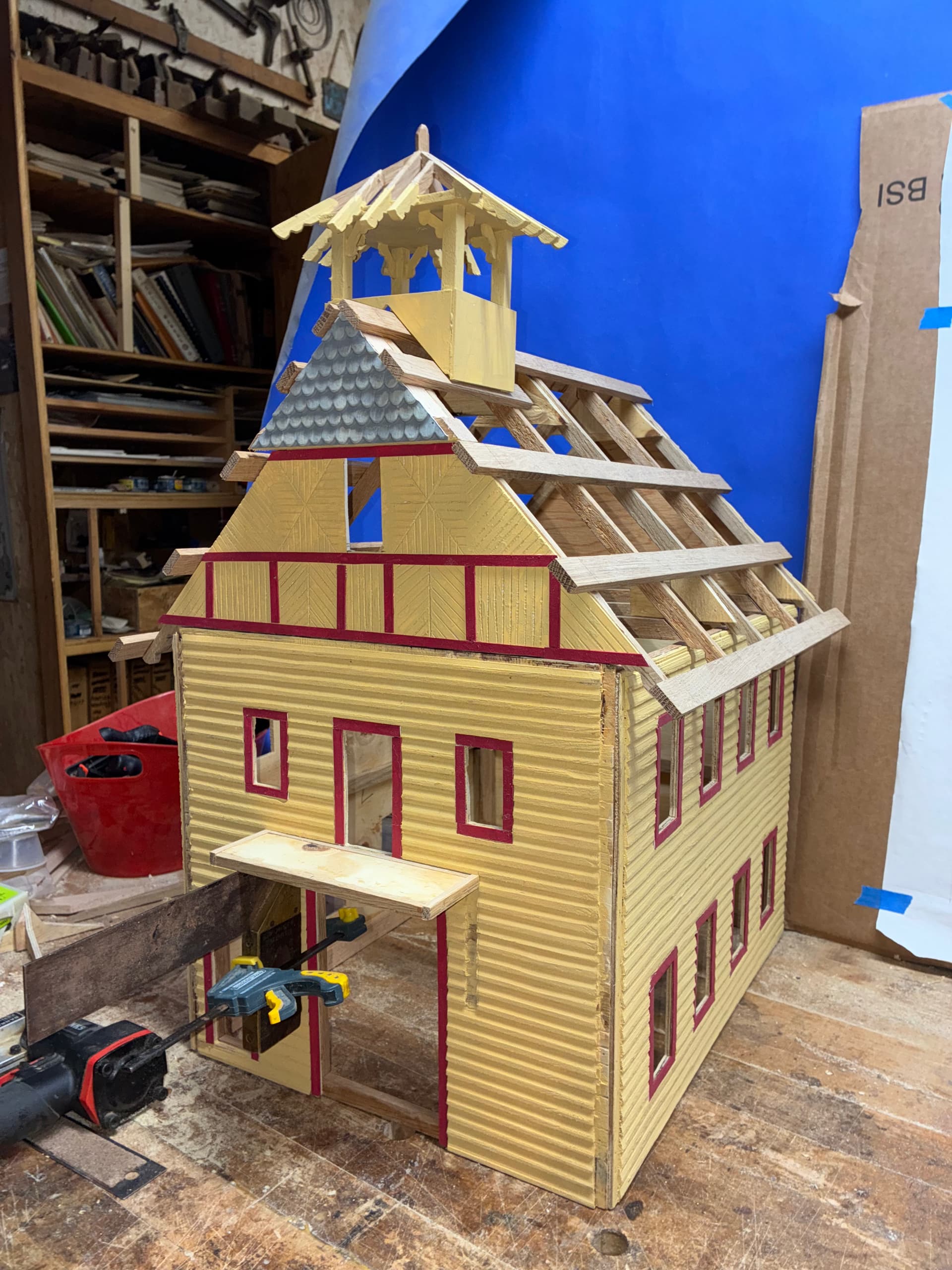

Marie got the siding all painted and I glued and pin nailed it on, she is painting the trim.
Ok, Who the hell is painting the gable? You got an easy 6 color paint scheme going up there!
You trim out that stick work (carvings) and dang…I love it!!

Started to put the trim on, painted PVC.
Mark you two are doing a fantastic job with the details and paint scheme. I’m sure that soon we will see the 3 accent lines on the frames and no doubt you still intend to cut the corners on all those frames and set the rosette corner blocks in. Will that front over hang get scroll work support? A bit of ginger bread goes a long way. :sunglasses: :innocent:
