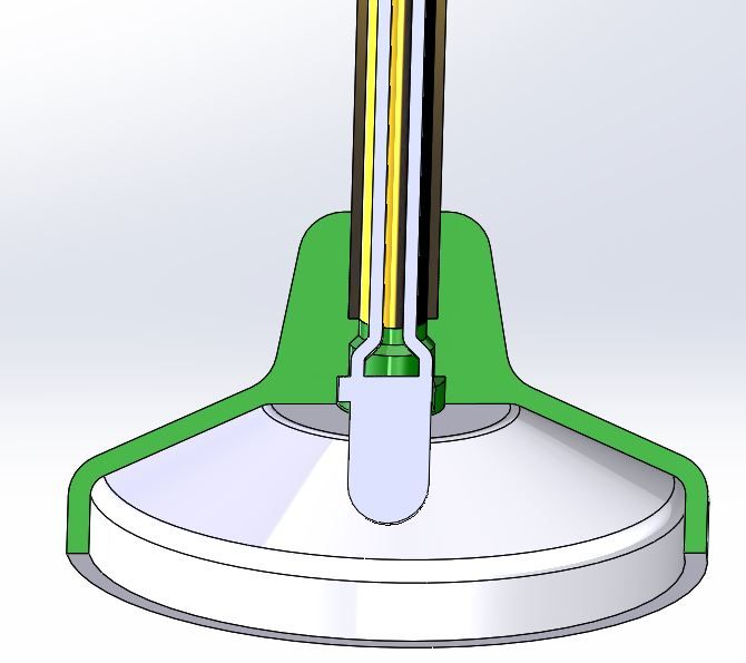

Landrel,
I really like how you mounted the lamps in your engine house, and has given me inspiration to get mine finished. I was also having issue with the lamp shades, and getting the LED to fit up inside further on some commercial (Ozark I think) lamp shades. so I have 3d printed a few and need to take it to the next level. thanks again for the inspiration. my design below:
(https://www.largescalecentral.com/FileSharing/user_2560/RGSNH/Capture.JPG)
Al P.
The Evan Designs Led come per wired so they fit pretty well into the shade. I just drill out the hole to the correct size…
Ty
