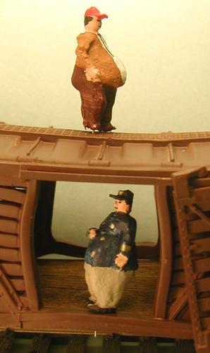

If any crewmen from the Gorre & Daphetid sits up there, thats going to pop a wheelie!
HA, and I thought I made my figure fat. Those are some robust gentlemen
