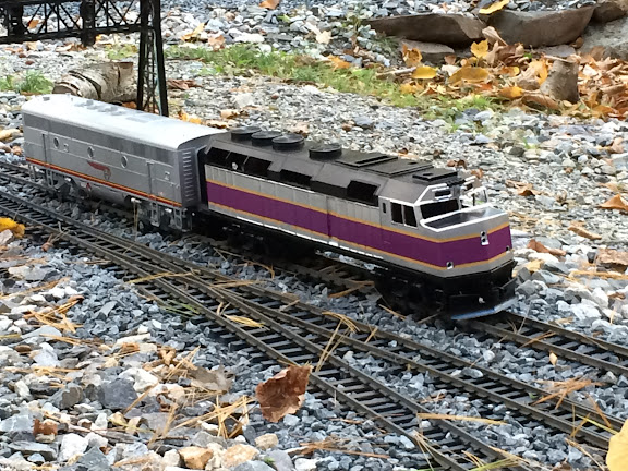

Much to the displeasure of the silver paint, the purple vinyl didn’t work out very well, so masking and painting was required instead. That said, aside from a few touch ups left to be made on the striping, I’m satisfied enough to move on to adding windows, screens, and final lettering. I’ll also be adding a few tanks and assorted appliances to the undercarriage when the time comes. The snowplow is at a very effective low height for plowing, but I feel its design is a bit short for the high-riding pilot of the F40PH…I may raise up the plow a tad just for aesthics.

The RCRR was handed a steep fine today from the FRA for running their F40PH on the mainline without having proper window glazing. We argued that the locomotive also did not have steps, lights, a fuel tank, and air tanks either, but that only seemed to make matters worse. At any rate, ex ATSF F3B successfully provided some electrical power to test the controls and traction motors on MBCR 1011. Aside from a cracked gear, which caused a bit of wobble on the forward truck, all went really well.
In contrasting David’s proto photo with my shot above, its clear to me that I need to paint the sill of my locomotive silver. While this is the frame of the model, it’s not really the frame of the real locomotive, but rather the bottom of the cowl. I think doing this will fill in some of the vacant space between the plow and sill. Unfortunately, the edge of the sill will need a bit more aesthetic prep work before becoming silver.
The RDC and the F40PH match up very well. I still have three more RDCs to dress up in MBTA colors. They will also have their frosted glazing replaced with tinted plastic. Afterall, these represent RDCs in a more contemporary scene after they were modified into push-pull coaches.

A little more progress was made this weekend! MBCR 1011 has freshly repaired gears and a temporary battery-R/C inside. Also did a few more paint improvements and I’m testing out the “T” logos for size.
