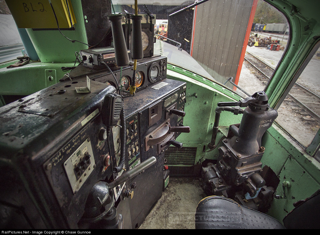

I see a MAI lines, but no sand or bell lines on the MU hoses.
Nice job filing down the USAT glad hand for the Main Res. line. Here’s an inside view of a BL2 for your viewing pleasure!
Thanks for the pic Craig
For some reason the picture did not display for me. I can see it in the editor though. I wonder if it will show in this quote.
