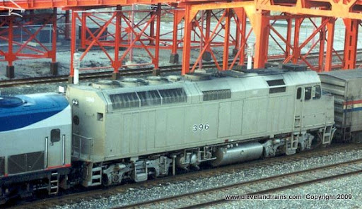

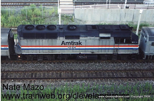

Here’s a phto angle might help, from high on broadside http://picasaweb.google.com/lh/photo/eLCbzhmFZxSq0dLK5mPxpQ or another way [url]
(http://lh4.ggpht.com/_7caRrOjlH5U/ShCC8tbt8kI/AAAAAAAAAPw/tE_KOeFIMsc/F40-308.jpg)
[/url] Hey look! they copied your paint job!
(http://lh3.ggpht.com/_7caRrOjlH5U/ShCC-87vmnI/AAAAAAAAAQQ/39rdgLjBZmc/f40-396.jpg)
