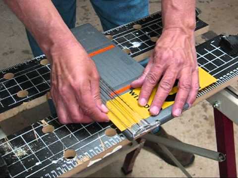

If you’re working with shorter (~12") strips, this method might help to at least do the scoring, if not the actual cutting.
I guess my first question is what size sheets are you planning to cut your stock from and how much do you want to waste? Remember to include the thickness of the blade you are cutting with. Most blades will require 1/16" to 1/8" thickness in waste.
I echo the Rooster on those questions. The sawdust amount is also a factor.
I’ve tried to shear styrene sheet with a paper cutter, but it walks all over the place. So though I haven’t tried it myself, the idea of pressing a cutter wheel down onto the sheet seems more likely to give a reliable result for either scoring or cutting.
FWIW, from Styrene cutting Device? | ModelRailroadForums.com
What I use most is a paper cutter that I got from the office supplies section of Walmart. I mounted it on a piece of MDF, added sheet hardboard to make the base more level with the cutter surface and added hardboard strips as guides to keep the stock sheet of plastic square. I push one of the cutters (the green parts) from bottom to top to keep the sheet against the guides. I have not needed to tape or clamp the sheet using this cutter. I like this enough to use it to square up my mistakes cutting other ways. Here it is.
