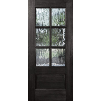

I can’t make out but a dark hole where the door is…
And this one the door is conveniently open.
Close look at the pic with the family shows a 4 pane upper window that I can see. Would normally have a raised panel of some sort. The 4 panes look to line up with the window glass lines.
If the windows are boarded over, yes they would board over the glass in the doors with a piece of plywood.
Maybe the above will help

I’m thinking there could have been a transom above the door as well?
Looking at the Issaquah depot which is similar era and RR construction it doesn’t have a transom so maybe there wasn’t one.
In the picture of the windows boarded up, I think I can make out a white “blob” where a window might be on a door but can’t be 100%. Again going back to the Issaquah depot, the doors are solid wood.
Okay maybe not a white blob but there’s something across the door frame area. Maybe a 2x4 or something blocking the door, nailed across the frame. Like that really would stop someone from breaking in.

Yes, In my worthless opinion it appears to be a transom window.
