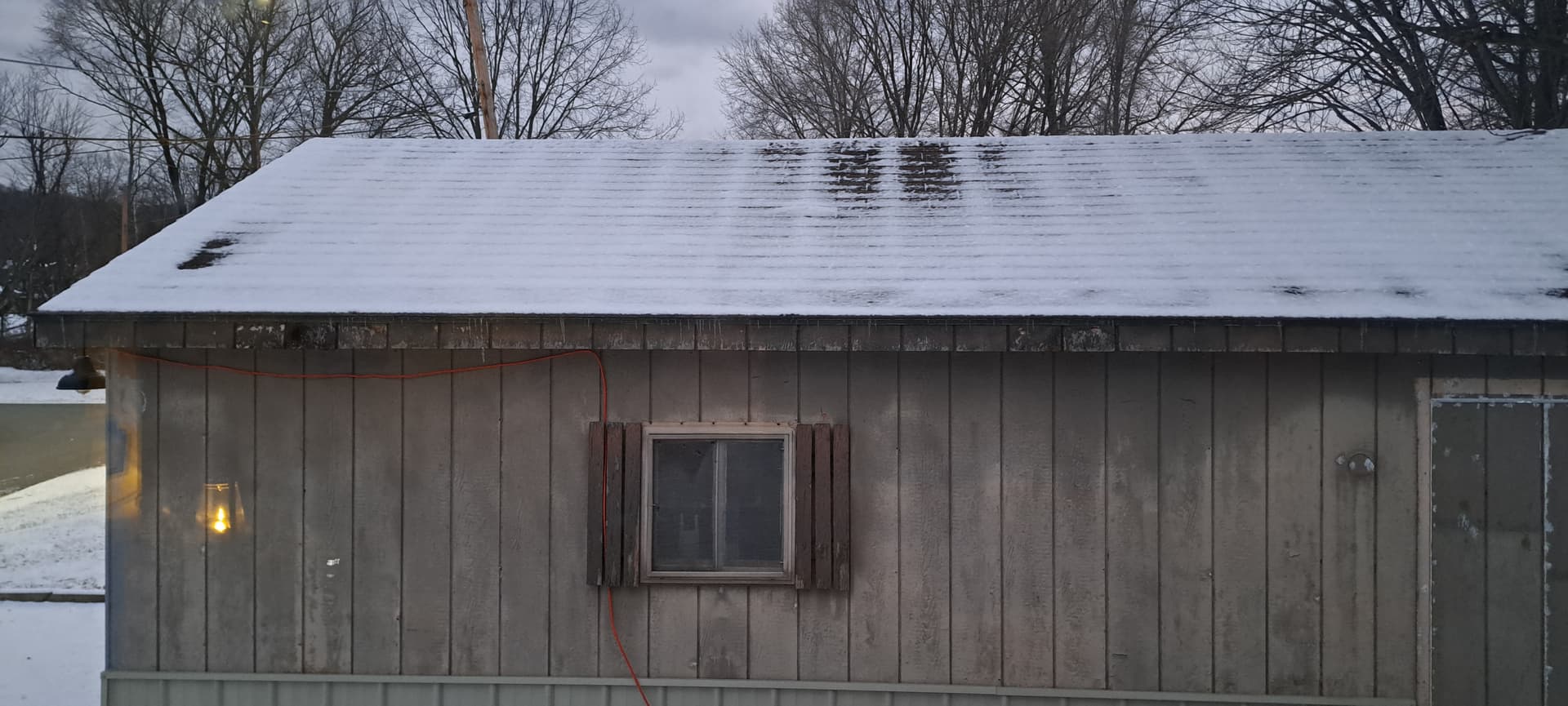

They say that you can judge the efficiency of roof insulation by observing snow melt. This was taken 24 hours after our second measurable snowfall…
That big dark spot is directly above the uninsulated attic hatch door! I definitely need to attach some foam to those doors!

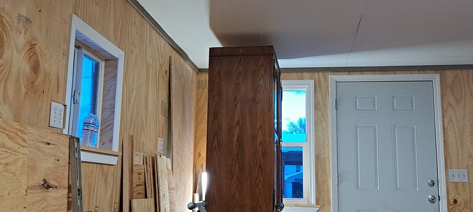

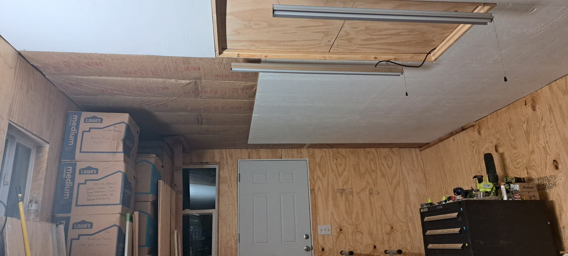

Closing in on the last of the finish work. Yesterday I completed priming and painting the last four ceiling panels, two of which are only 15" wide…
I still have not selected any millwork for trim which I want to do soon. We are running to the city today for french toast components and supplies before the big snow arrives late Saturday. Perhaps I can come home with some! If I do, I think I can wrap up the structure this weekend.

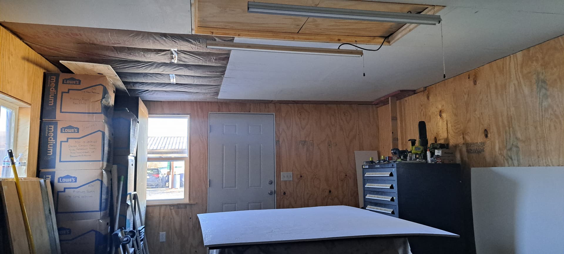

Today I hung the last 4 panels. The skinny ones required cutting open the insulation and adding some blocking as the last full width sheet landed on all but .125" of the joist…

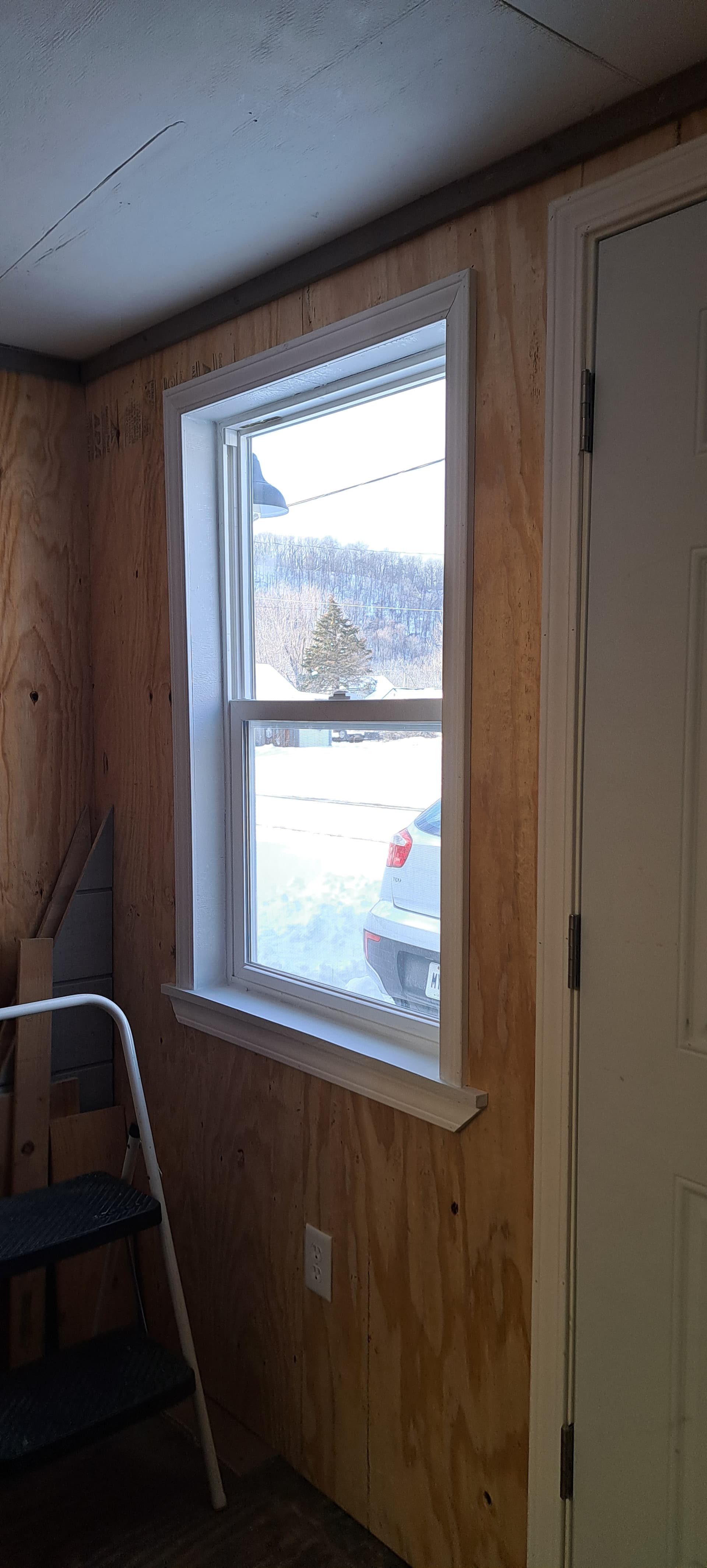

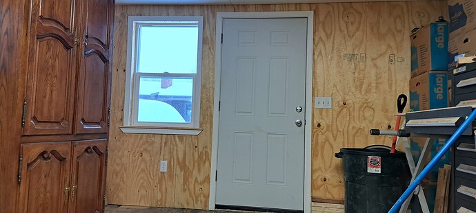

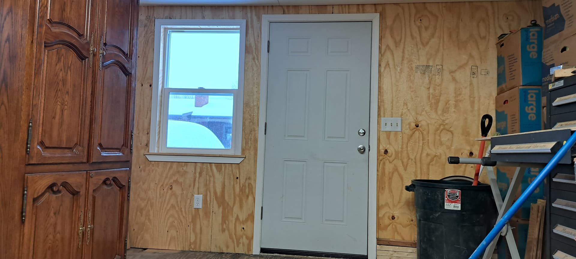

I dug a path to the shop and cleaned it several times. After an hour or so moving stuff yet again to dig out the brads for my brad nailer I did manage to get the door and window casing installed before the football game and a generous helping of French Toast for lunch!

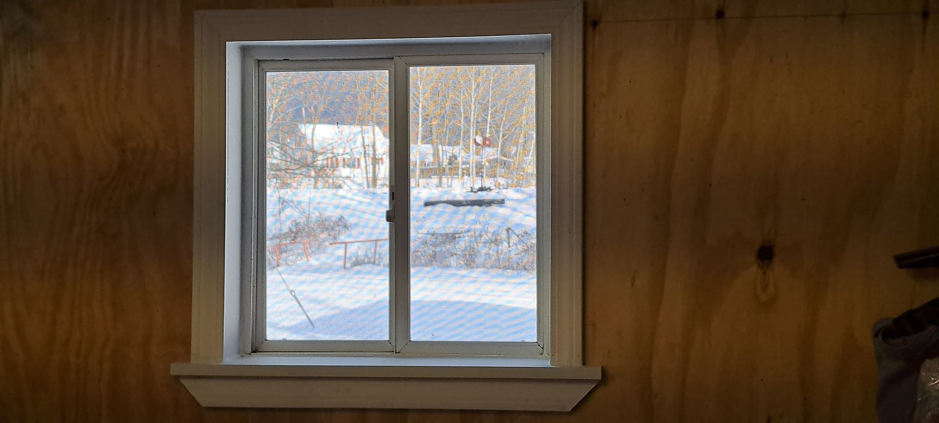

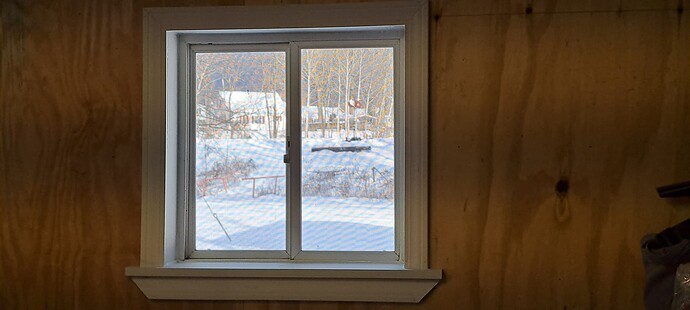

Toward that end I finished the widows today after digging the cars out.

I decided to prime the window reveals and sills. That brings the look together to where I can safely ignore it, or move painting way down the priority list.

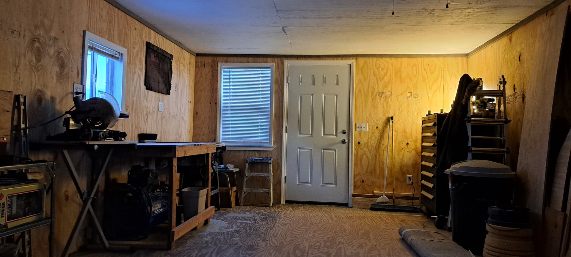

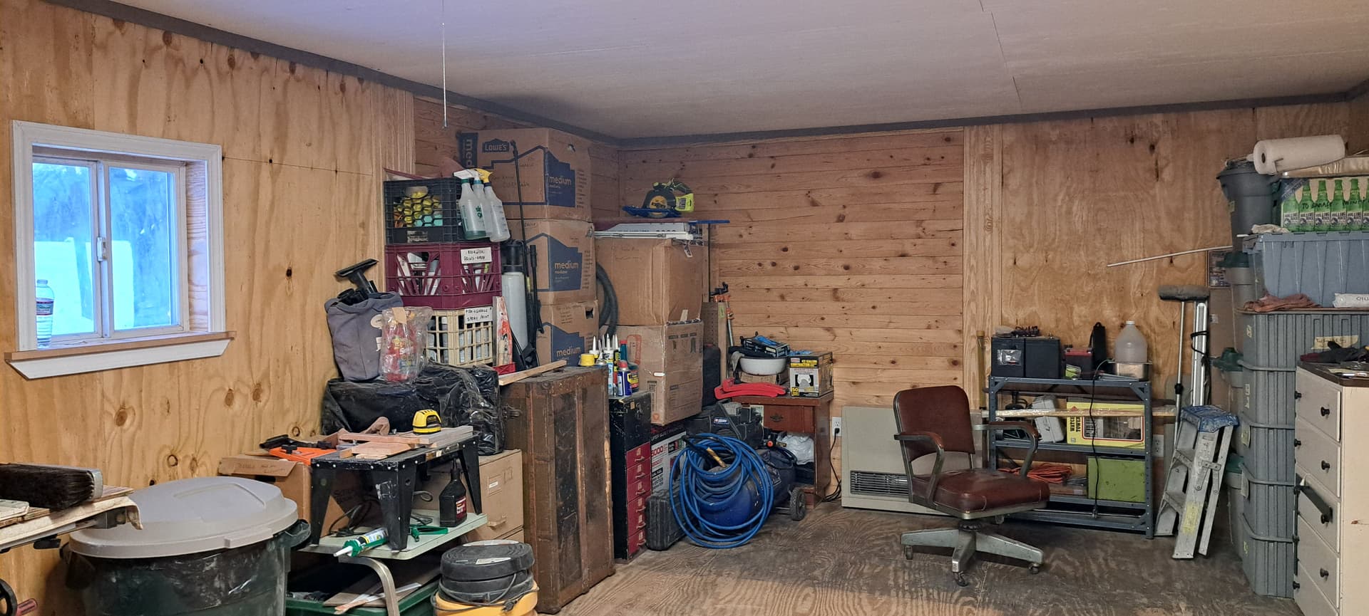

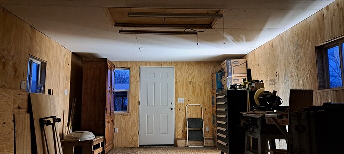

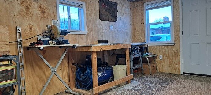

Yesterday I built a new work bench from leftover and salvage wood. Today I moved another ton of stuff and setup the shop area at the North end.
Jon, this looks more fun than a gym membership. You must be sleeping quite well at the end of each day.
Looks great, Jon!
