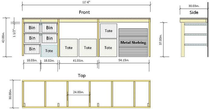

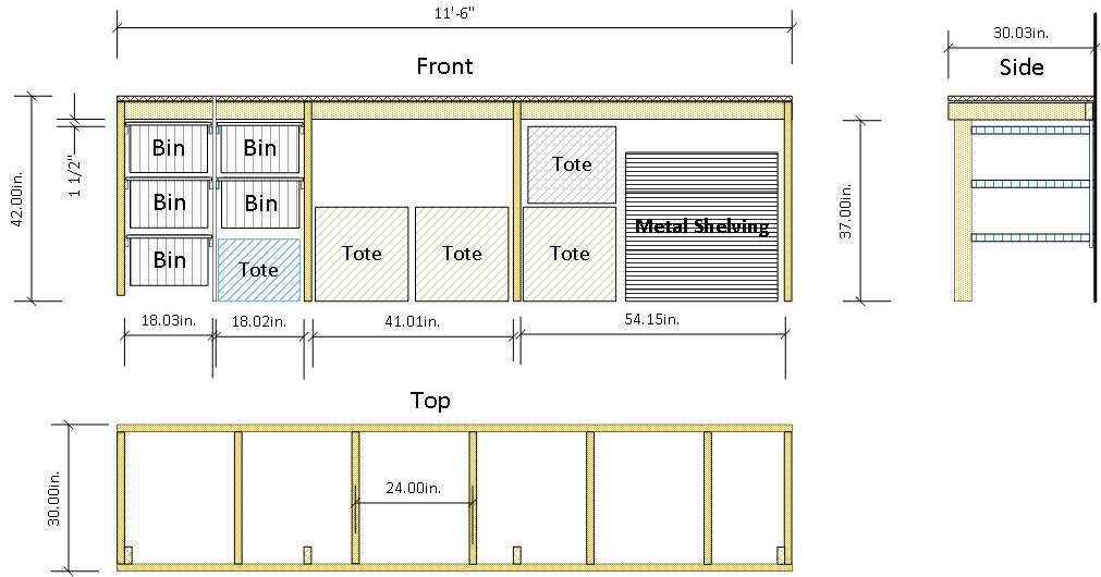

I’ve been working on the design for my first railroad bench. I want it to support up to 4 tracks front to back. Length is determined by available space on the east wall between the tool/hardware box and the paneled ā€œofficeā€ area. One or two tracks will continue around the office corner on a narrower bench or bridge - TBD.
Here is the bench plan that incorporates all the storage bins and totes currently stacked against a wall…
I landed on a 42" bench height and a 30" depth. I should be able to easily reach the back and it’s high enough to enjoy standing or seated.

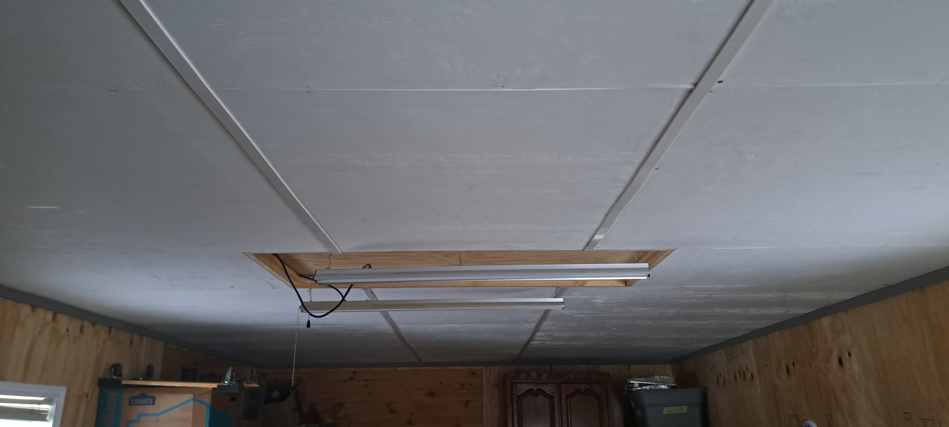

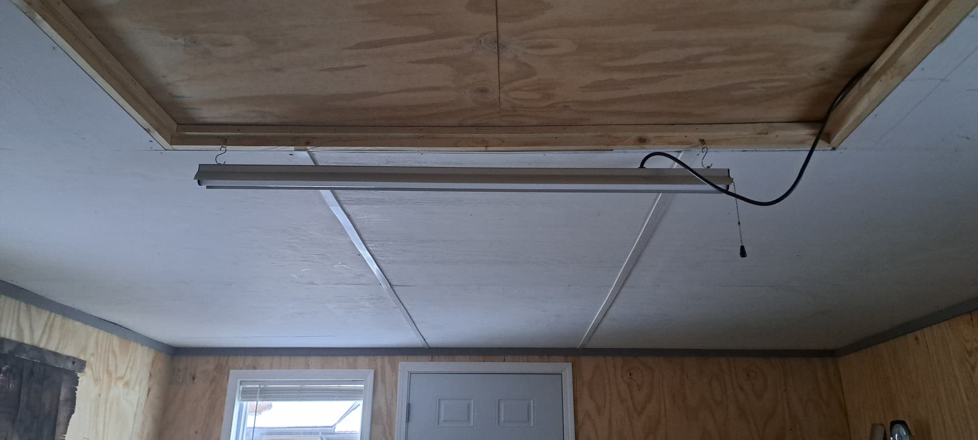

Before I commence bench building, I installed a little more trim on the ceiling.
I was unhappy with the panel end joints, mostly because they were so uneven. The long side joints don’t bother me as most are tight and land on a joist. The short ends have no framing behind them between the joists.
While I was at Home Depot returning the casing I over bought, I looked at some cheap pvc lattice and brought home 6 lengths. I used half to cover the end seams and the other half just to make the panels look symmetrical. OCD…
30" is going to be tight for 4 tracks but workable.
My staging yard is 2’ wide and I have 4 tracks spaced on 6" centers. It definitely close but able to switch cars around at least in 1/29.
Mine is 16’ long with both #6 and #4 turnouts.
I still don’t have my shop computer running. It has all the designs for the CT railroad on it. It was 4 tracks deep, but they were tight. I’m thinking 7" centers minimum. I think CT was about 24" deep.
I could go deeper but I want to stay around 42" high and be able to reach the back without a stool.

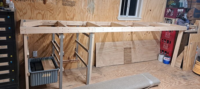

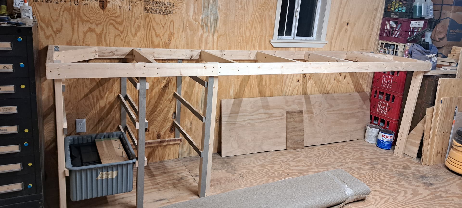

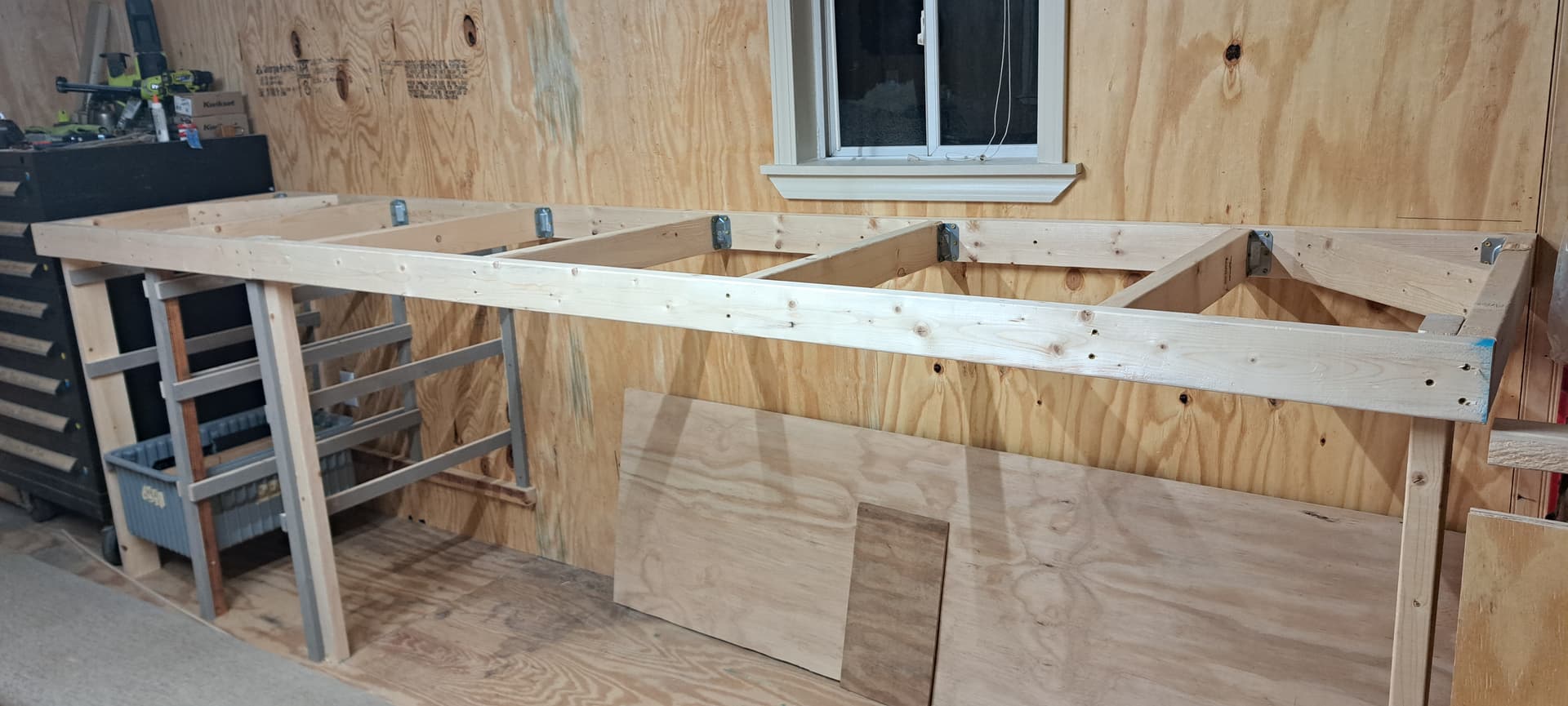

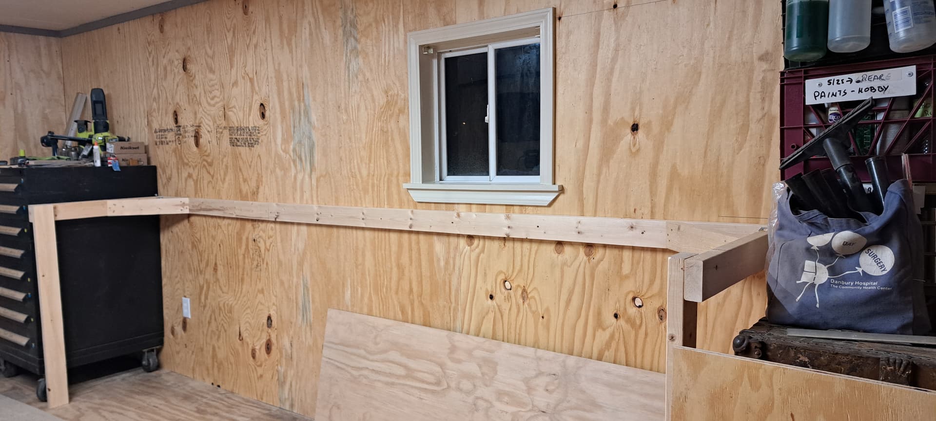

The closest lumber is now 84 in Huntingdon. We ran there this morning. After lunch I painted then started on the bench. I got three sides up before quitting time…
20260205_180259
I increased the bench height around an inch so the top will fall just under the window trim. I have this fantasy of a picture of a model locomotive in the foreground and EBT 16 out the window!
Today I spent most of the day creating sawdust. What was left of the wood when I was done molesting it became 3/4 of a sliding bin storage system. The two horizontal pieces at the wall and the front are assembly jigs and go away.
I had no idea what the future room layout would be when I did the wiring, so this bench is hiding a few plugs too…

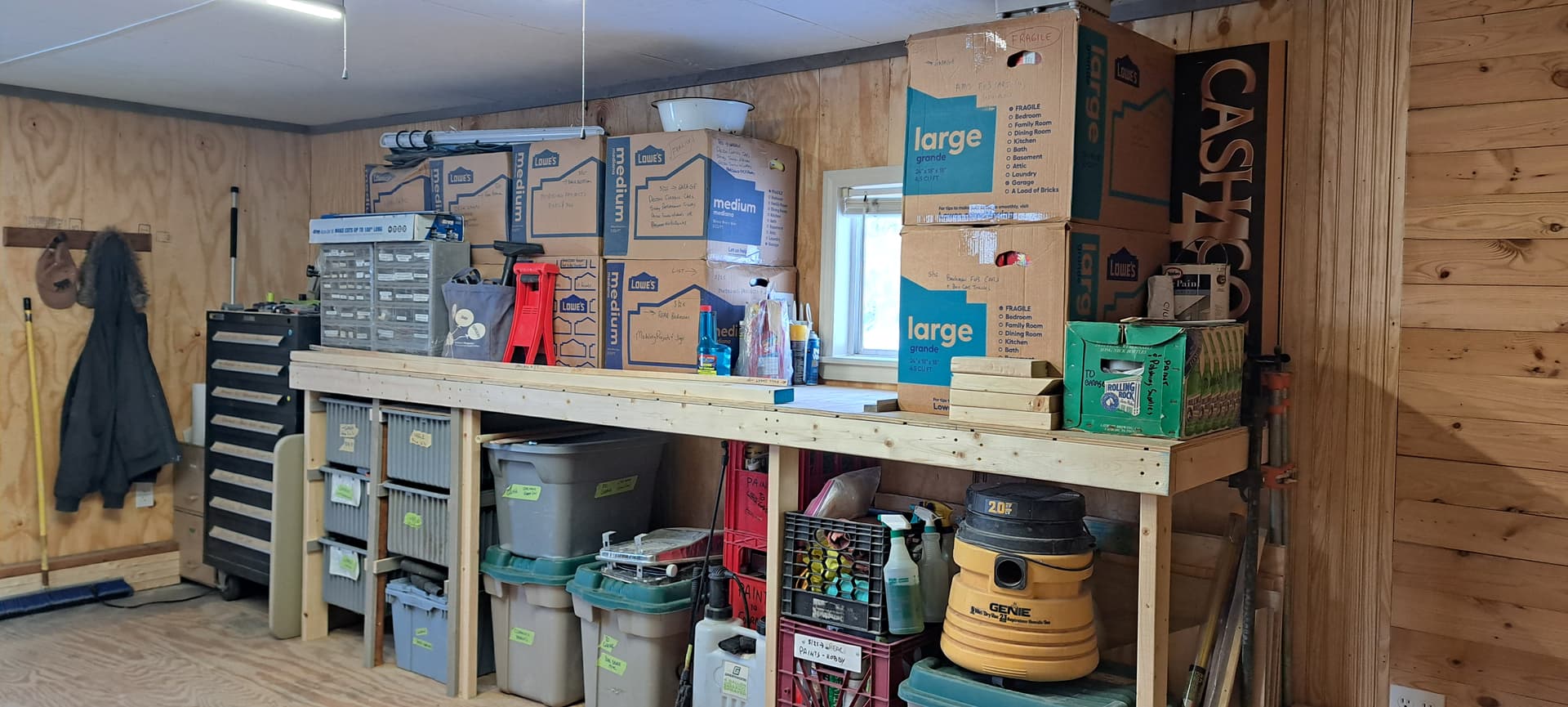

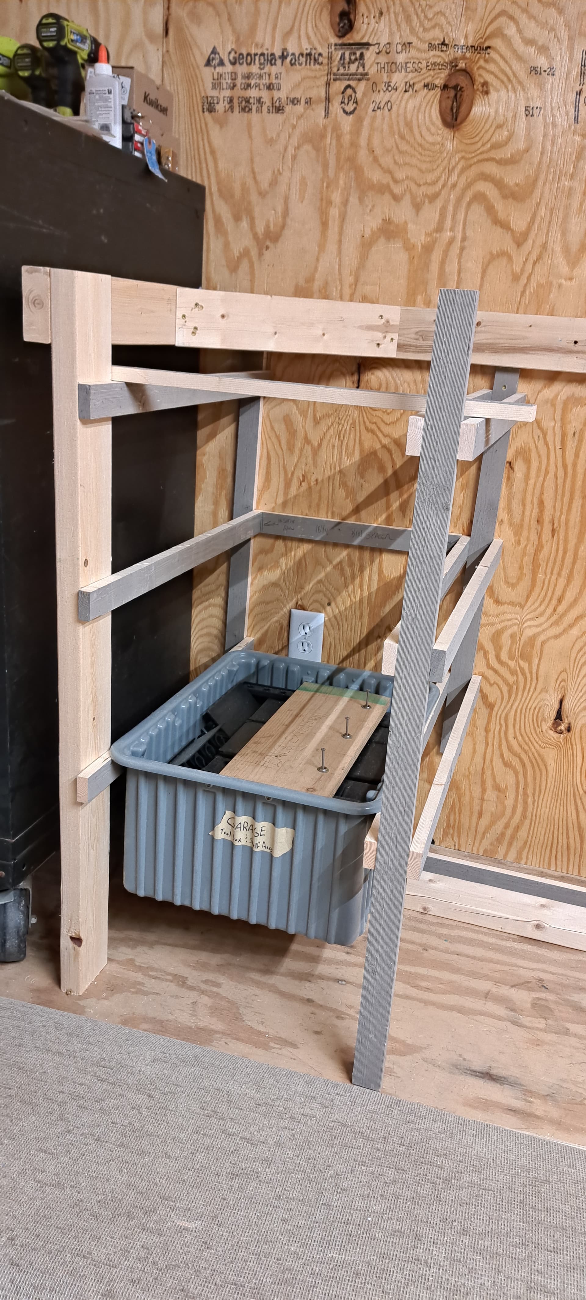

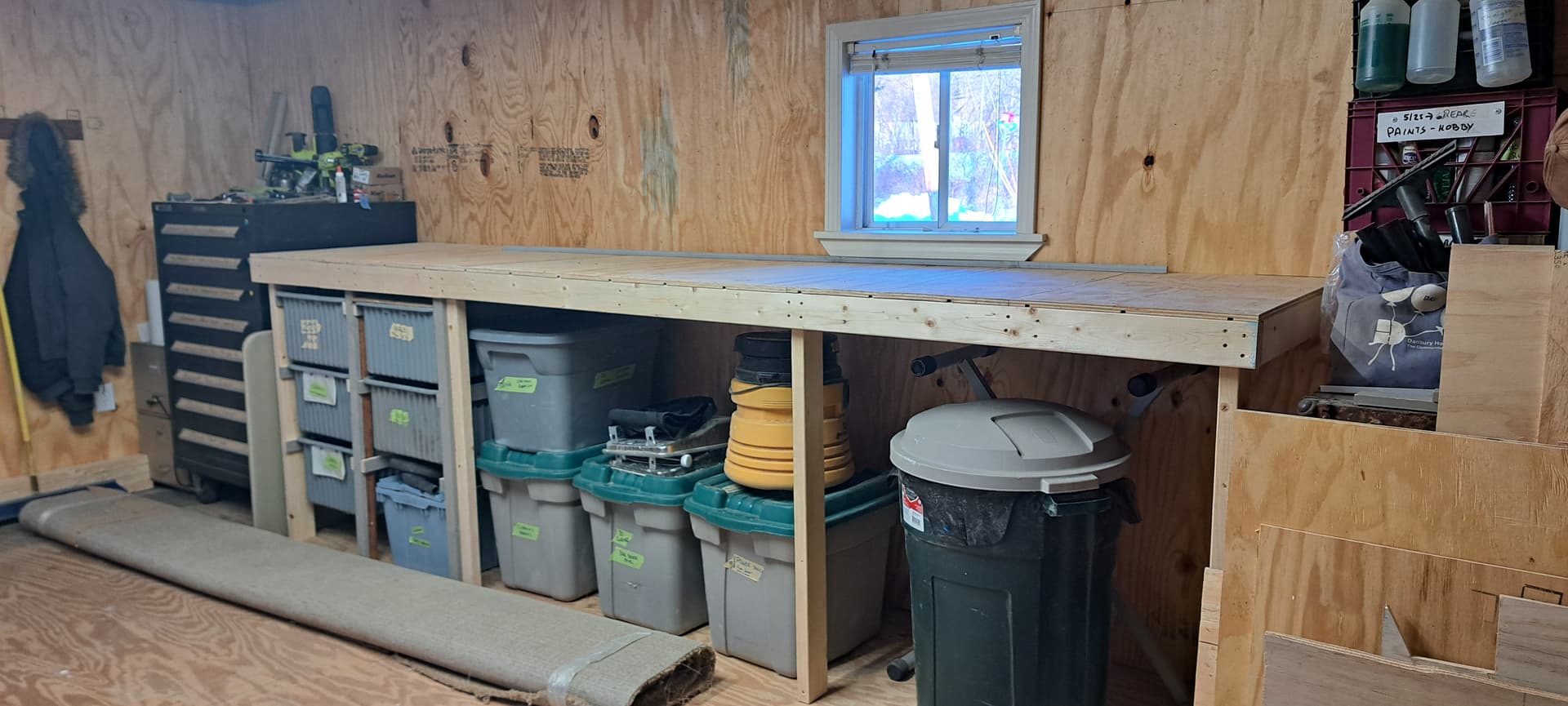

Good progress on the bench today despite a few errors. The space between legs does not work out the way it was drawn because of how I did the bin rails. One more leg to install then the top. Before installing the leg I need to do some real world size testing with the totes. Of course they are all full and some quite heavy.
As of the dinner bell tonight…
Spacing ended up working fine. Complete for now. I’m considering adding some drawers. Built entirely of left overs except the 2x4s…
It’s all perfectly square and level now but Rooster reminded me that it’s a shed and will probably shift around. We’ll see :eyes: :smirk:

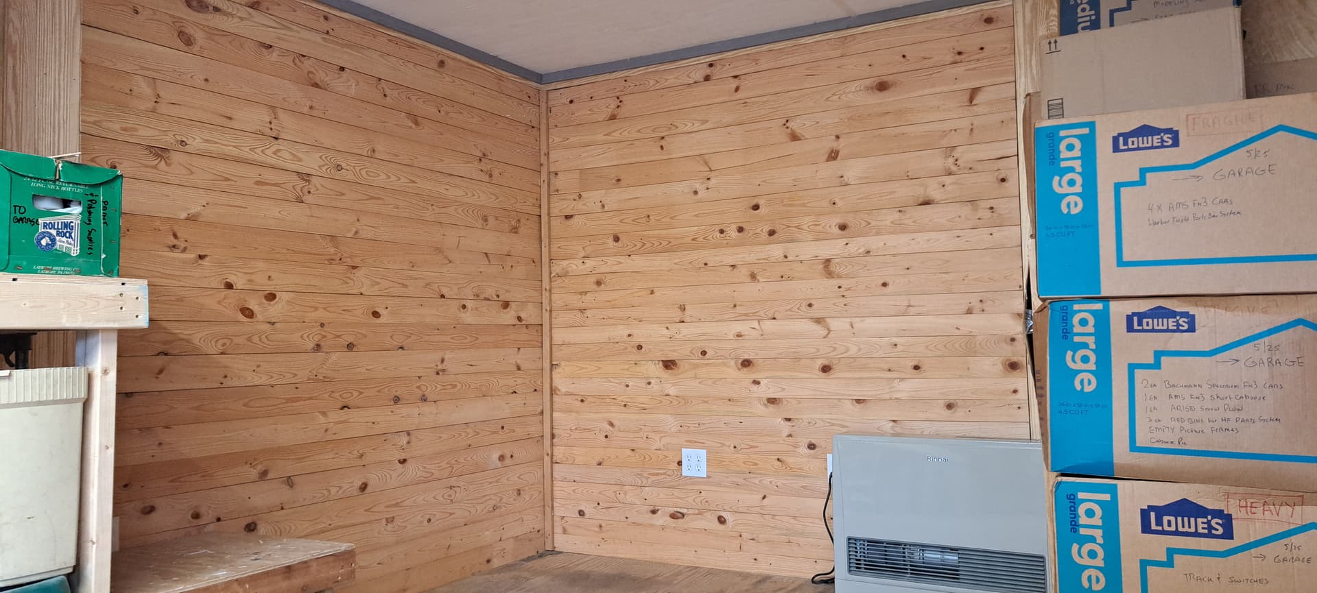

All that and more came from this area. I wonder what Fudd’s plan is for this empty space…
I need to replace that corner ā€œtrimā€ I’m trying to decide on the gray barnwood or natural pine.
I like that wood wall… Is it safe to assume, the trains go there?
