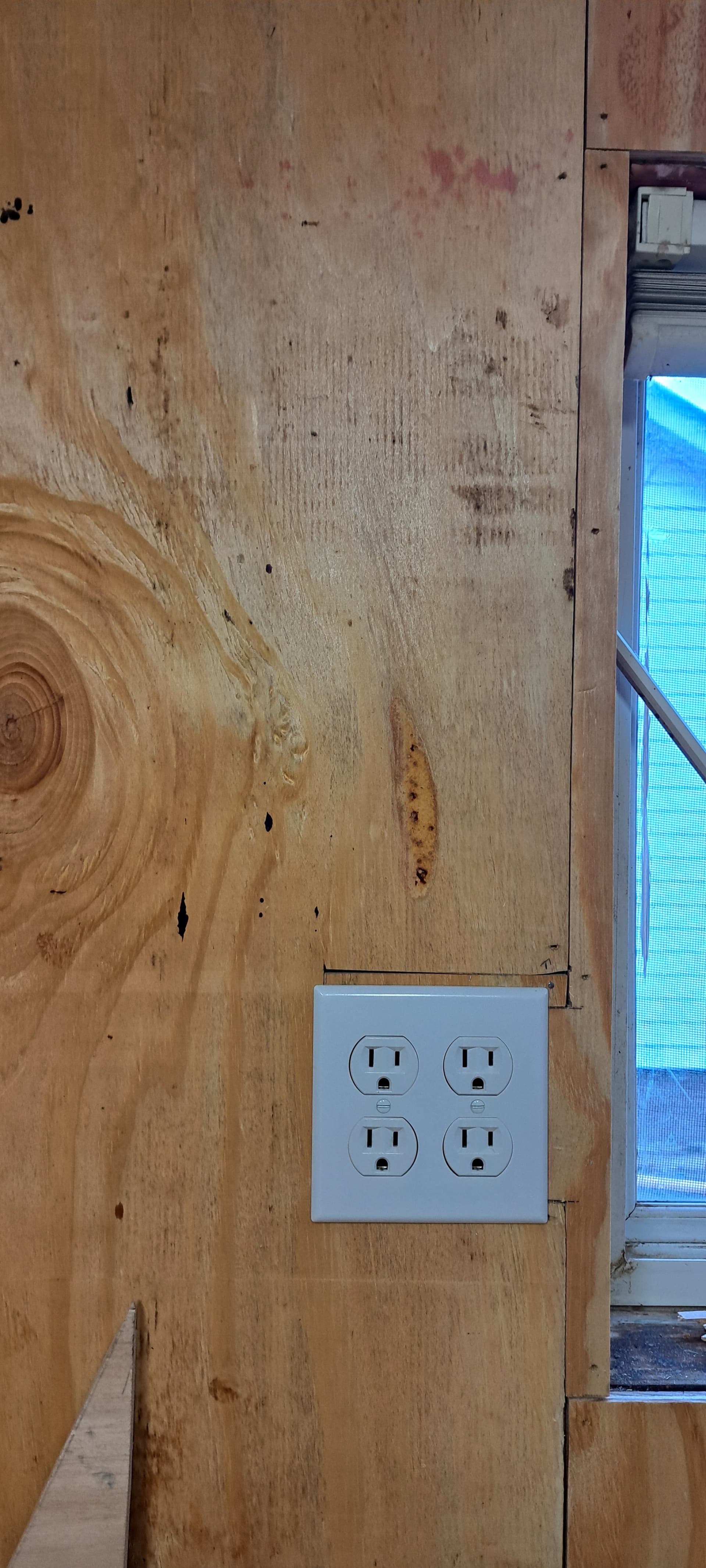

Just in case some of you think I might be a bit OCD, I am posting this detail shot of fill-in pieces at the window in my defense…
You are OCD cause you could have just raised the box but NO your outlets had to be EXACTLY all at the same height!
Yes, I have standards for outlet and switch heights. This was a new work box. I mis-measured the opening so I needed to make it bigger at the bottom and fill at the top.
The crazy one is to the left of the outlet. Took me 3 tries to get it cut correctly. It would have been easy if done in three pieces.

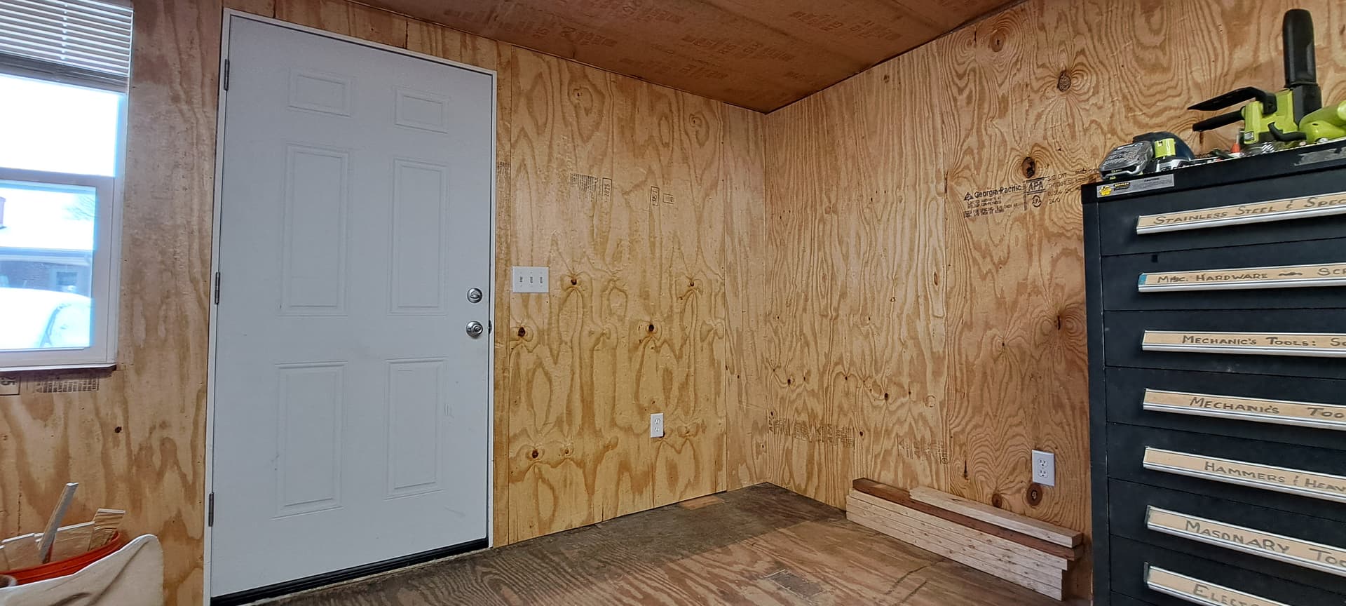

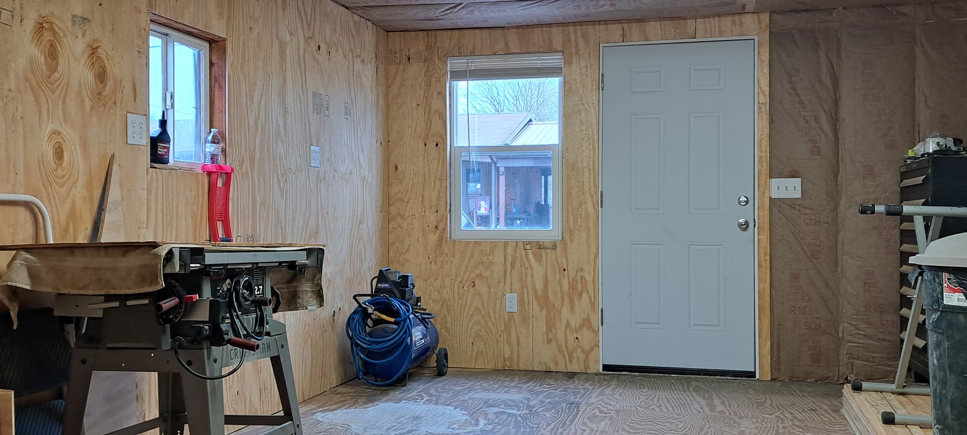

Today I finished hanging the last of the panels where the walls are accessible…
After that picture was taken I set up for painting more cieling panels, but couldn’t get motivated to paint today.

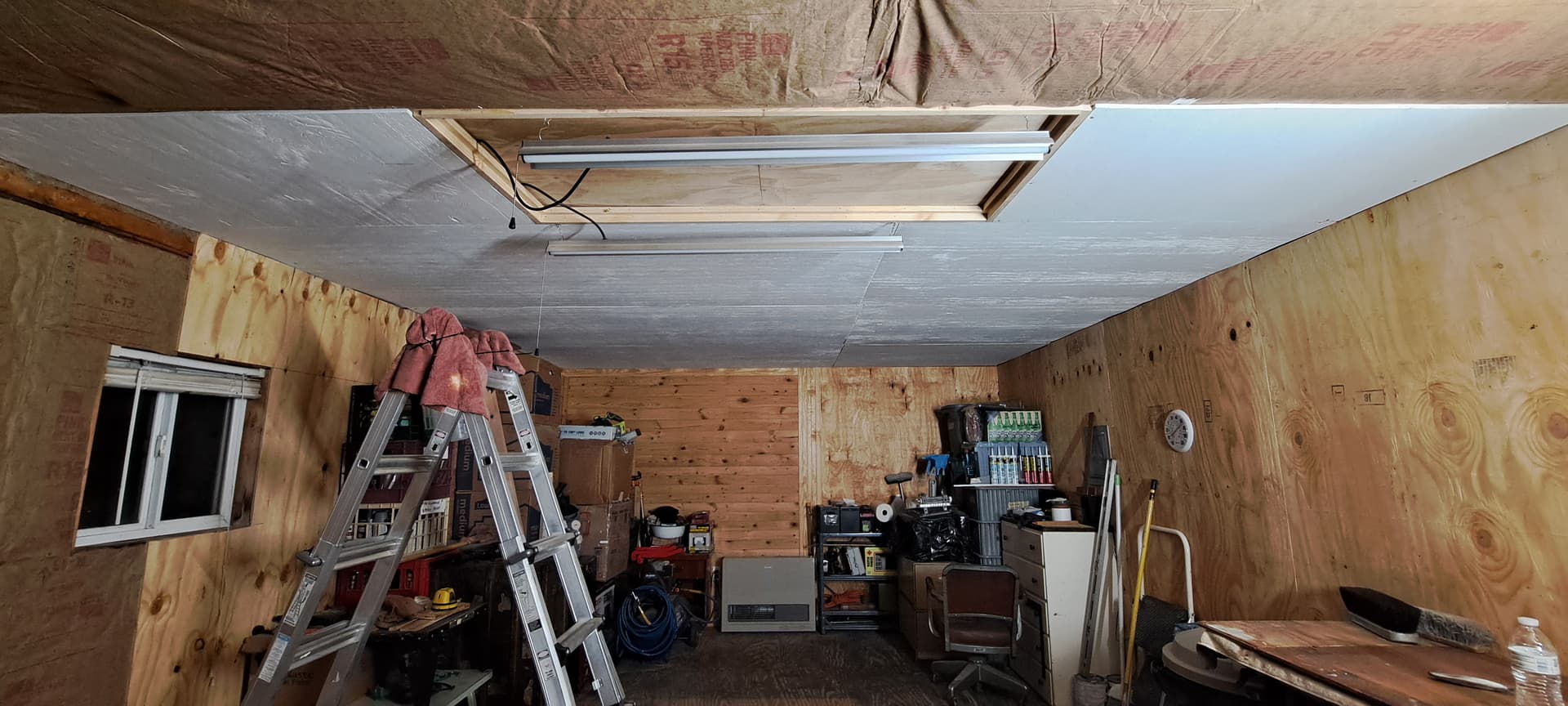

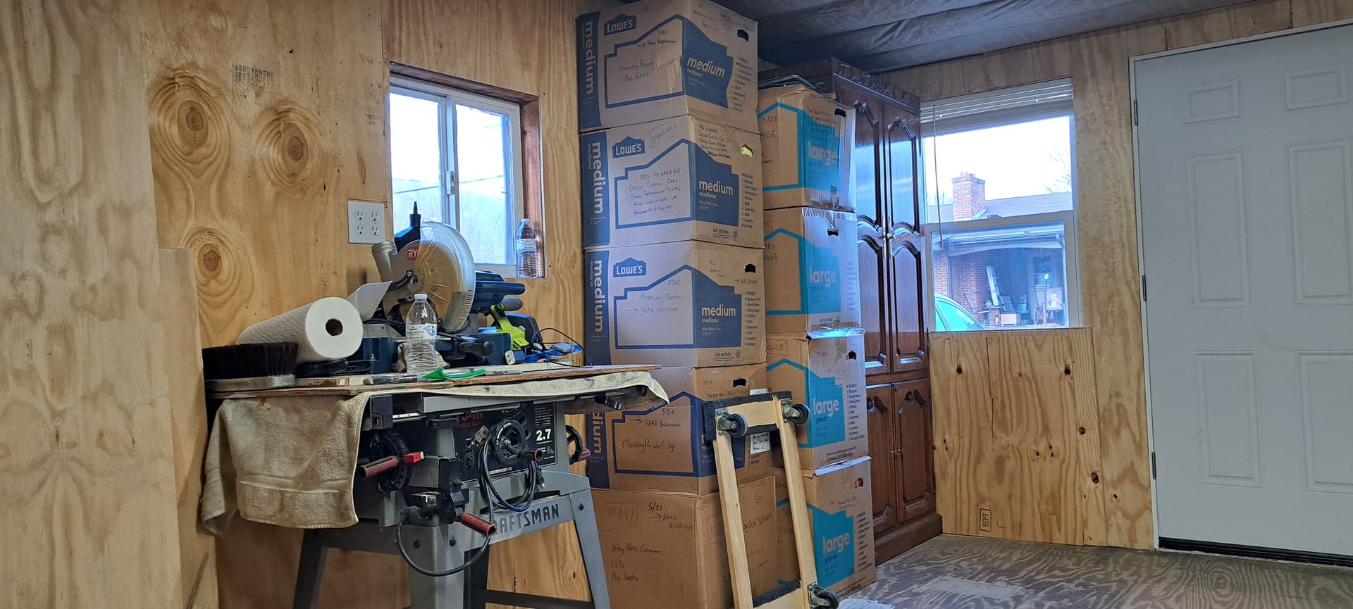

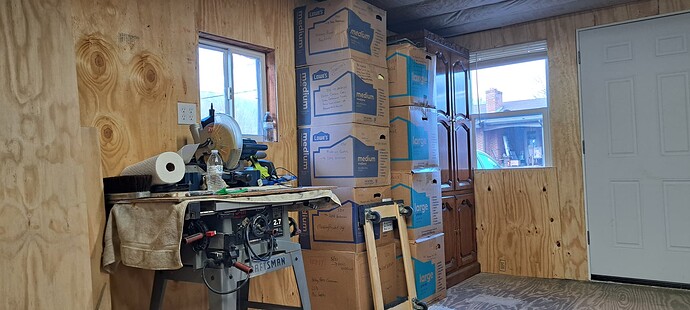

Today was move a whole bunch of stuff so I could hang the ceiling panels I painted yesterday. That big armoire in the corner was Marilyn’s craft cabinet in CT. Unfortunately it was too tall to stand up in the house. It just barely cleared the cieling in the shop while tipping it up. Once all this was moved…
These two 4x8 ceiling panels were hung. Sorry about the weird angle…
In order to finish that section of ceiling, I need to move even more stuff. I think Ill do one more wall panel first.

Marilyn has ceded the cabinet to me. Once all my crap is out of the back bedroom it will become her craft room and I’ll build her shelves to replace this. I had to abandon several cabinets in the move, so this will replace those for paint and tool storage.

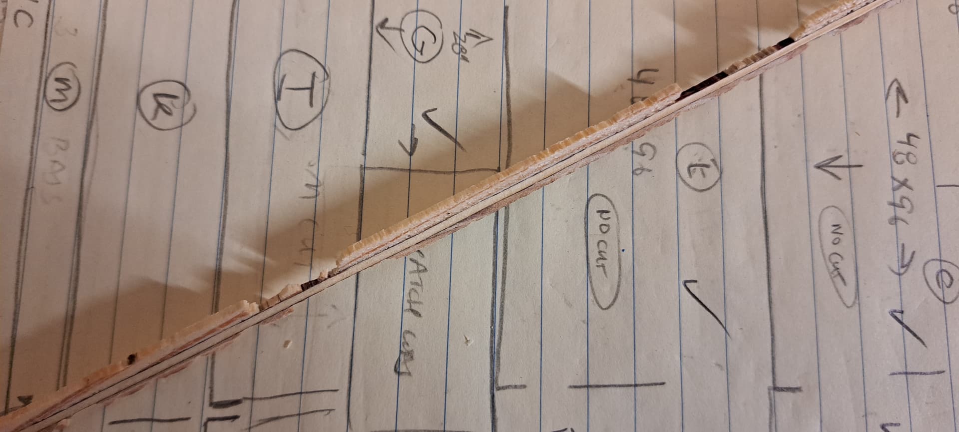

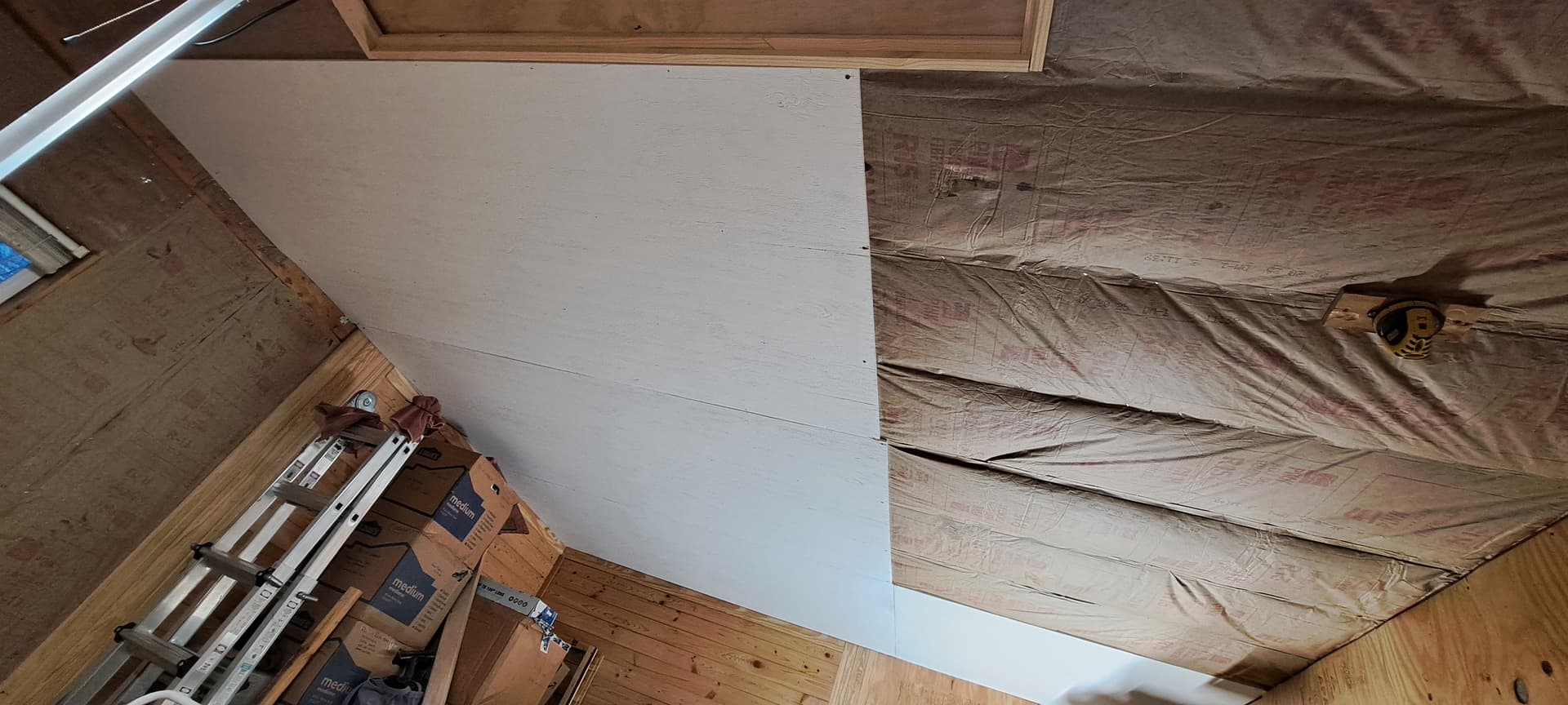

It was a struggle, but I managed to hang the last three pre-painted ceiling panels. They all gave me grief. I measured before trying to hang each, but square error made even my adjusted pieces not fit. My second trim was only 3/16" off of the short side of a 4x5 panel. There is no way I could have done that cleanly on the table saw and a hand held saw would be too inaccurate. The Kreg track saw adapter did it perfectly! Check out the drop…
So now that I’m more than half done with the ceiling, I’m going to back to walls and trimming out of the widows and door before I go back to the ceiling. In order to finish walls I need to move the plywood stack yet again. At least it’s only 10 sheets left now.
This is the ceiling progress where it will stay probably into February…

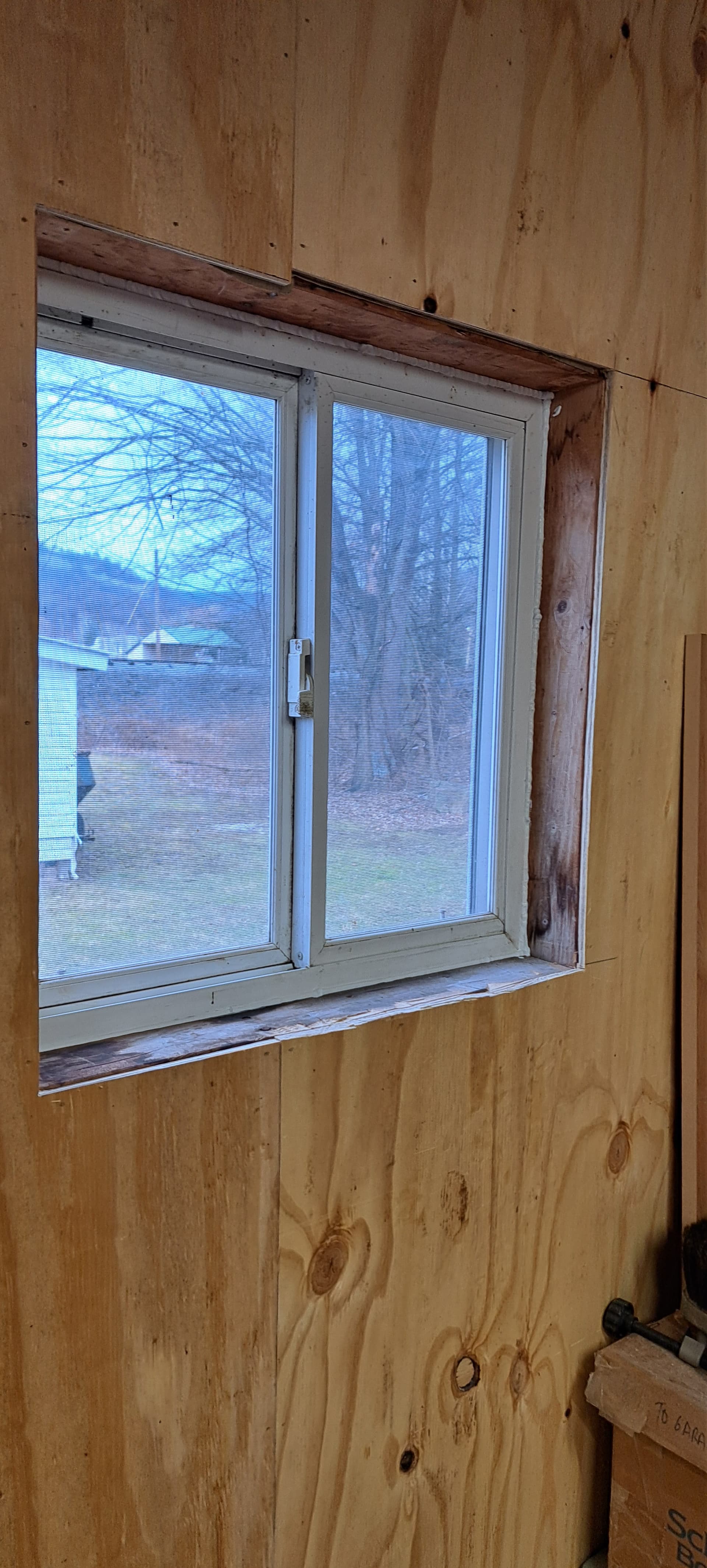

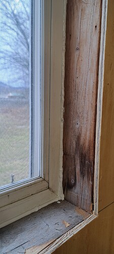

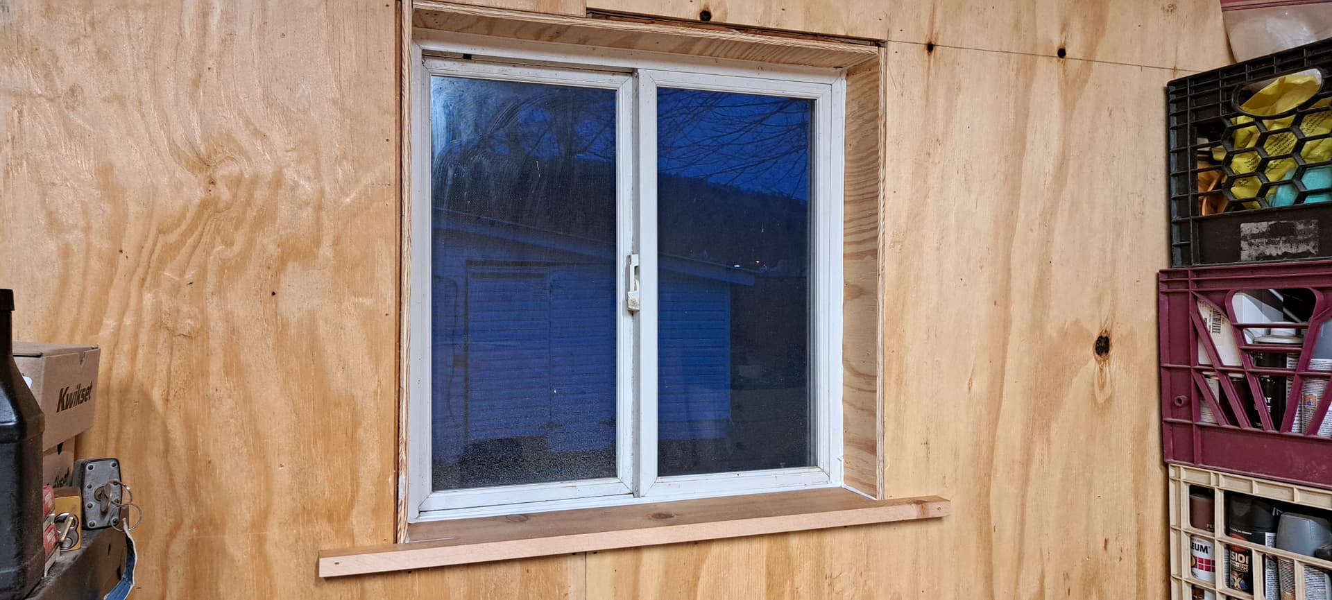

I’ve never claimed to be skilled at trim carpentry, but I wanted to seal up the gaps around the existing windows and cover the old framing. I started by filling the gaps with Alex latex caulk… .
All of my wall panels are around 7’, so I have lots of 1x4’ drops. From these I ripped a bunch of 3.25" strips that I covered the framing with and cut a sill from one of the existing shelves…
There will be some standard trim around the outside that will cover those gaps from measurement errors.

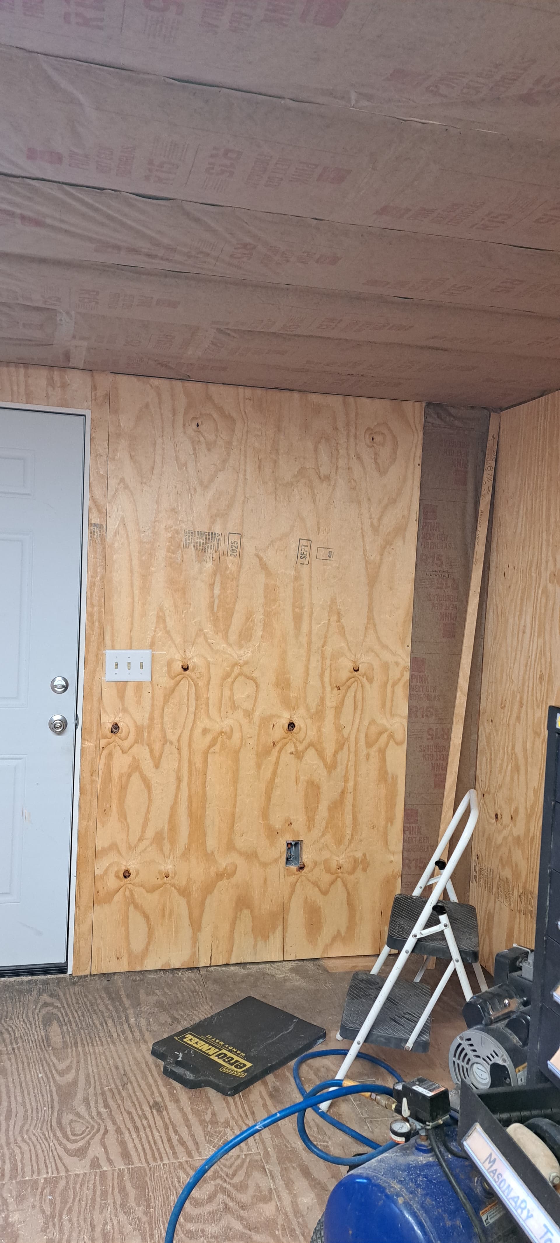

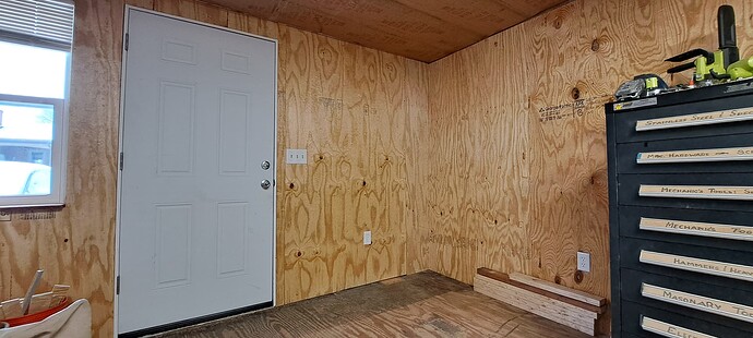

Walls and electric are done!
That last narrow sheet on the right of the front wall has a compound taper because the old wall is leaning out a bit at the top. I’m really happy with how tight the corner is! A tip of the hat to my anonymous helper who taught me a great measuring technique.
Next up is to trim out the new front window then back to my least favorite task: the ceiling. Two full a sheets, two 5 foot sheets and two narrow sheets and it’s done. It looks like Monday it’s back to painting :disappointed:
