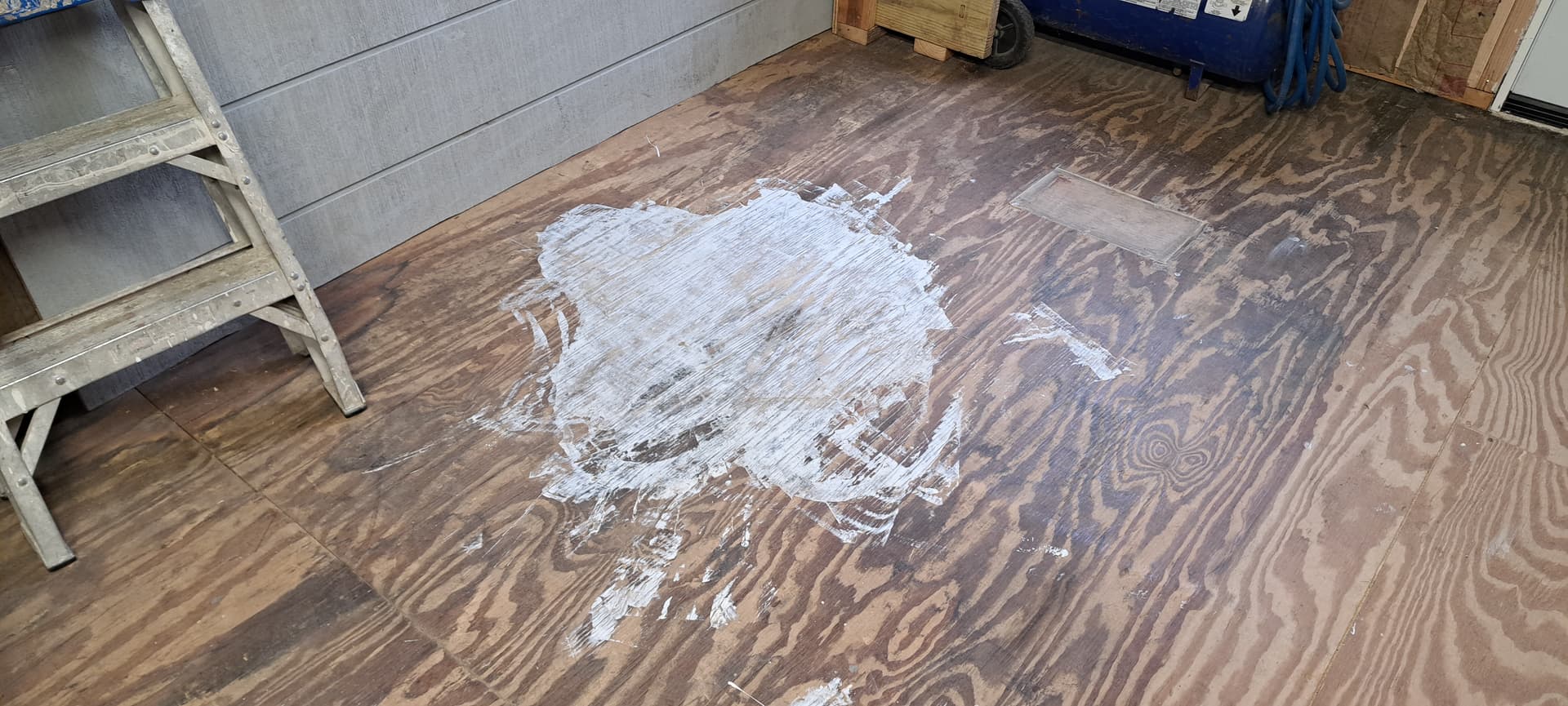

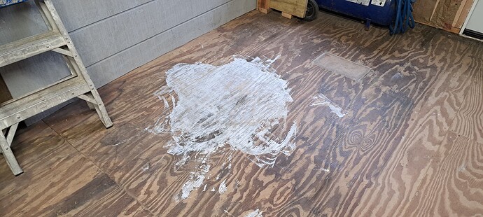

I am a long way from thinking about what to do for floor covering, but an oops yesterday may have made the decision. I was moving what I could into the attic storage to get it out of the way. I had an unopened gallon of Kilz Primer purchased for the ceiling panels. In my haste, I knocked that gallon to the floor where it burst open and dumped out :disappointed:
I was able to recover about 80% of it, but the floor is permanently marked. So I guess I will be painting it at some point.

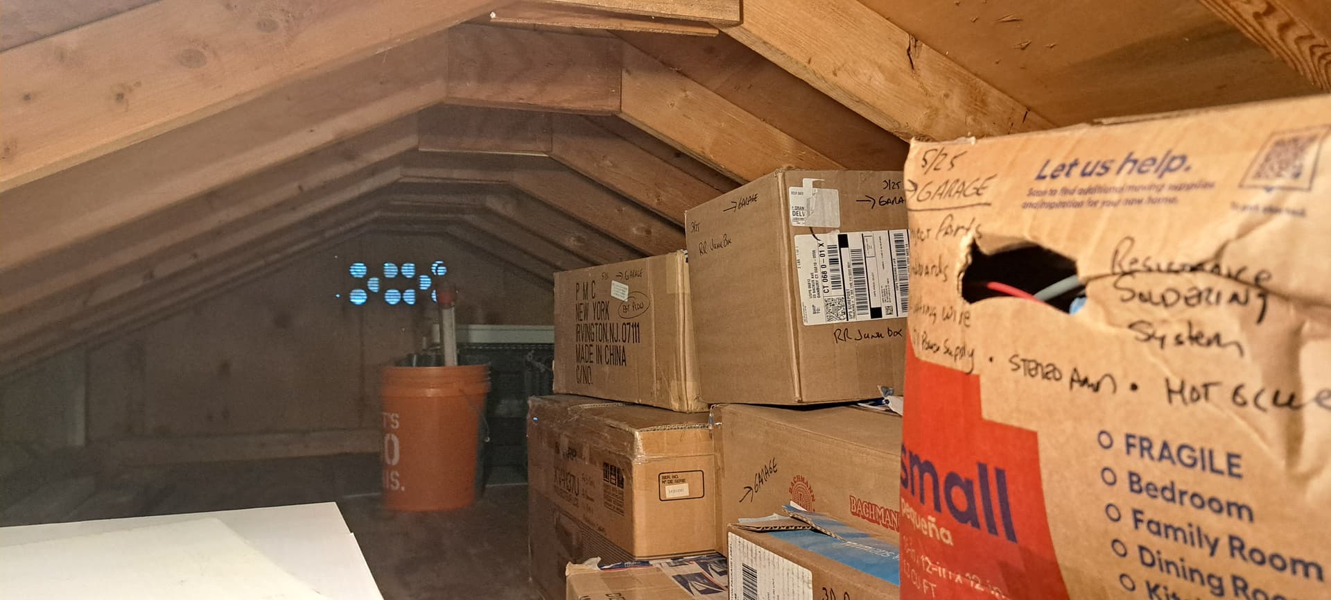

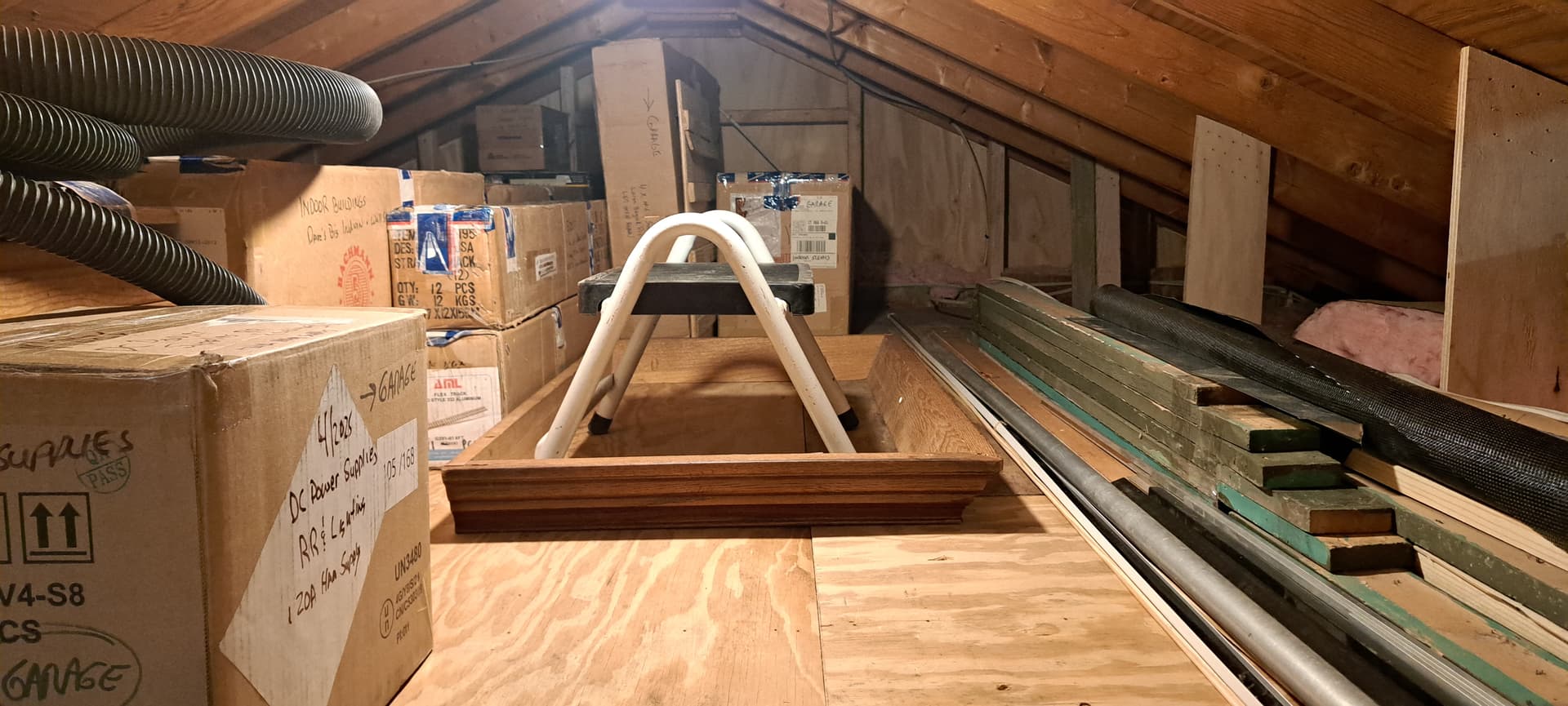

On a positive note, I moved a lot of track and rolling stock to the attic. The large and heavy boxes stayed down…

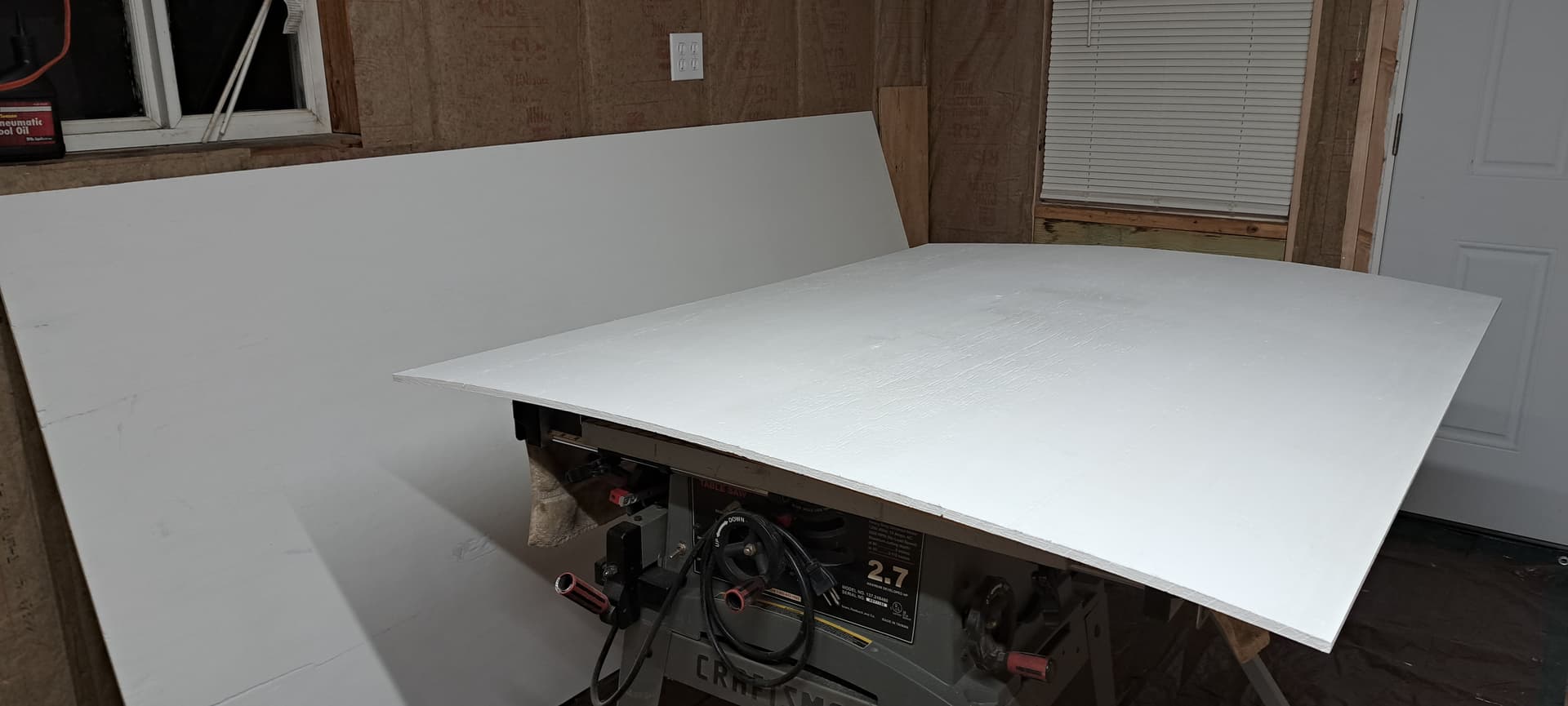

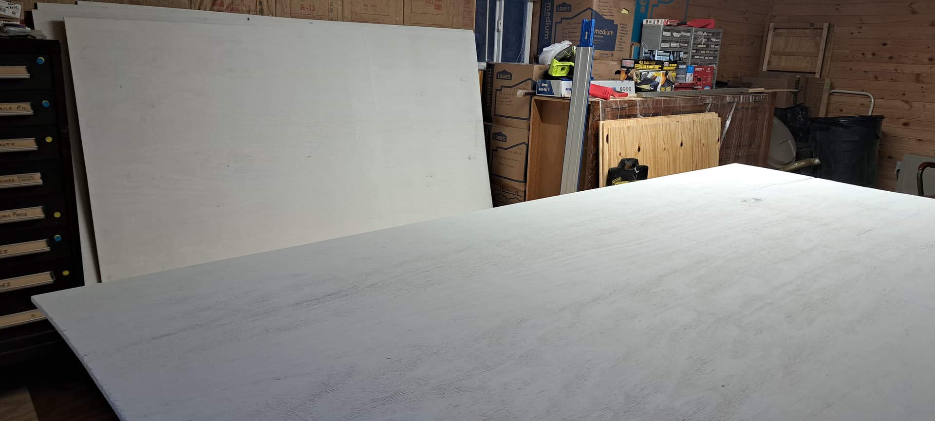

One of my least favorite tasks when I was working at the sign shop was roller painting large panels. I want my ceiling to be white and budget dictated that it would be plywood. So, I’m roller painting 4x8s and 4x5s…
One coat of Kilz primer and one coat of Glidden Ceiling White from a full gallon that might be 10 years old. So far I’ve finished two and for C/D sheathing, I think it’s going to look OK…
I’ll hang these two and then finish the south wall and maybe some of the west wall before finish painting and hanging the other 4 I cut and primed.

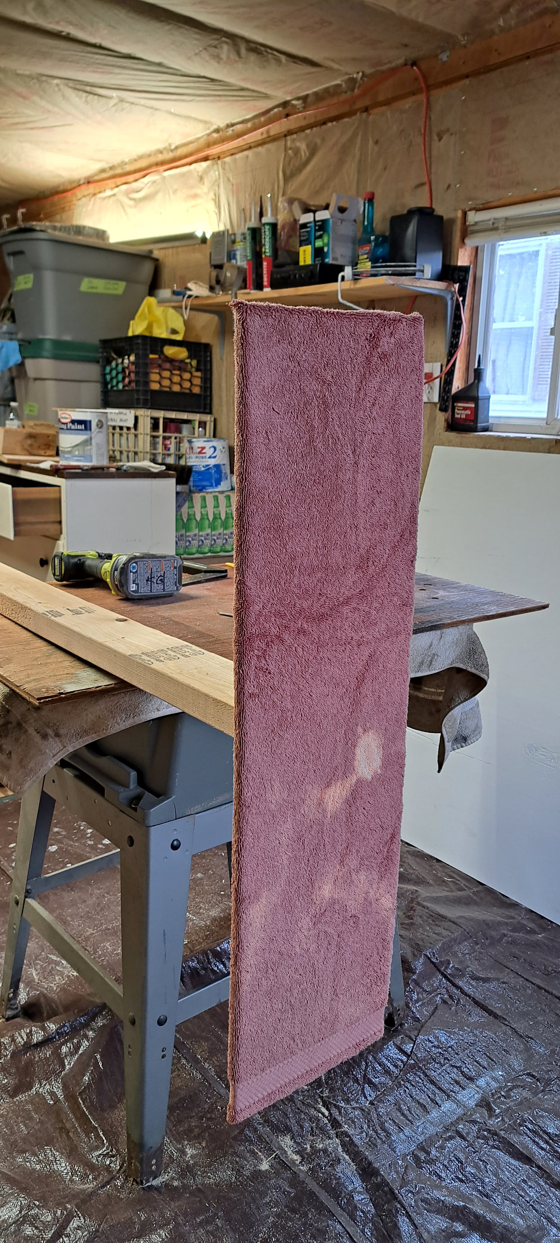

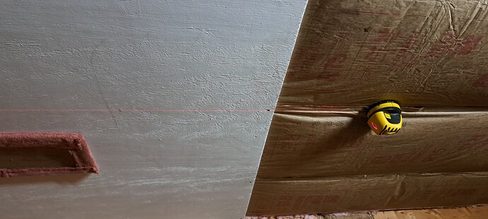

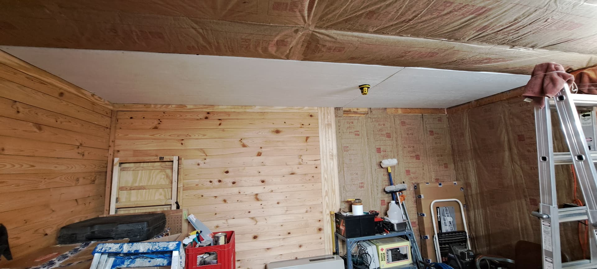

Today was ā€˜can he do it’ day for the ceiling panels. I devised a few jigs to help; a a resting strip for the wall and a T Post covered with an old cotton towel…
A drywall lift certainly would have been easier. I’m still considering a used one. My problem is that there is too little floor space to move it around. I struggled a bit, especially with the 8 foot piece, but managed to get them hung. A laser level my dad gave me for Christmas 30 years ago came in handy to keep my nail line straight and centered in the joist…
By dinner time I had both pre-painted sheets hung…

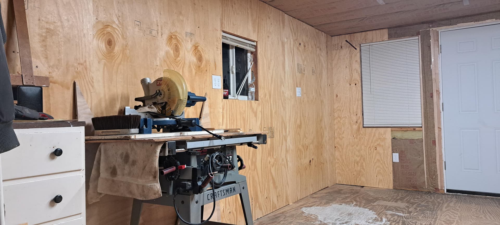

So I don’t have to move a bunch of stuff yet again, I’m going to cut and hang some wall panels before moving on with the ceiling.

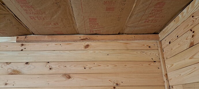

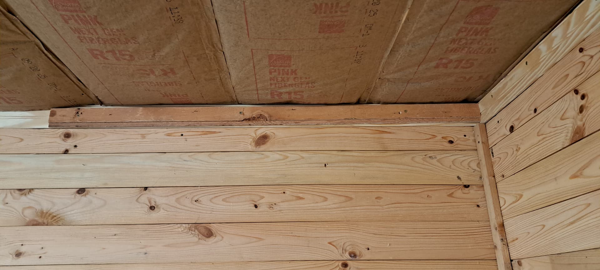

Looking great, Jon, especially the walls. You say ā€œpanelsā€ but it sure looks like individual planks…?

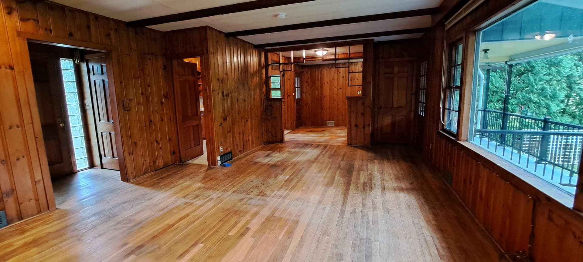

That corner section of T&G boards was mostly pre-existing. You can see it in inspection visit shot from last spring…
I evened up the edges and extended the top with some non-matching T&G pine. This corner will become my ā€œofficeā€ area.
The balance of the walls will be unpainted plywood sheathing. I considered cheap paneling, but it requires a plywood backer, so for now, just the backer!

I’d love to do t&g for the whole place. Our CT house was almost 100% knotty pine T&G laid vertically…
I miss the wood.

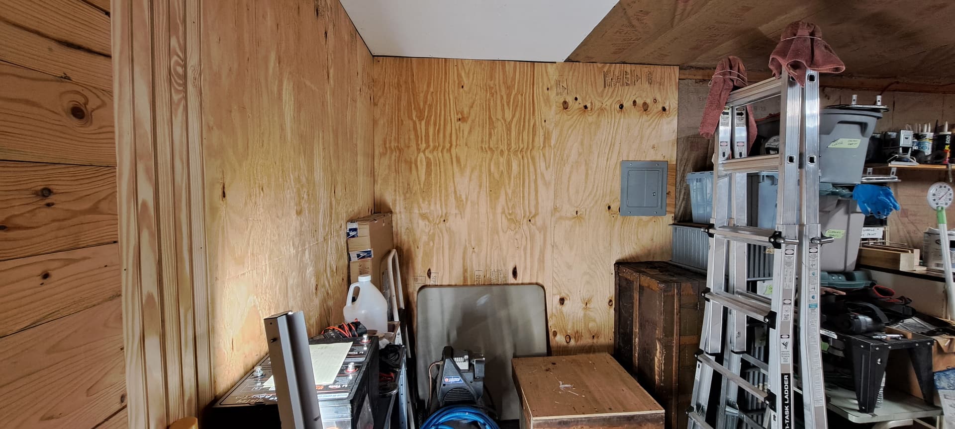

Yep, I think I’ve moved every box or bin at least 4 times. It helps having the attic area done, most of the small stuff went up there last week. Today’s task is to move everything at the right of the photo to the finished area at left to hang one more wall panel, then paint and hang more ceiling panels.
I’m sure it’s not noticeable unless you zoom way in, but the 16" section below the breaker box is attached with screws. This is to access to the feed wiring should I decide to change it to direct bury cable. At this point, that is way down on the priority list!

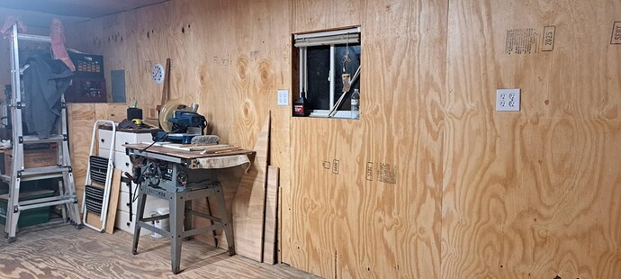

I was having so much fun hanging wall panels, as opposed to painting, that I decided to keep going while the area was relatively clear. The entire west wall is done and I’ve turned the corner. Once I get past the door I have way too much stuff to move.
As of quitting time Saturday…
