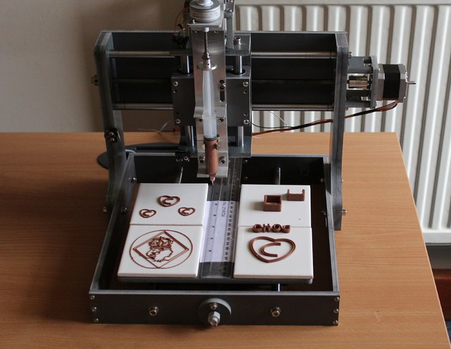

We could try to print them in chocolate first, then when they break we can eat them
(http://www.dudeiwantthat.com/gear/food-drink/3d-chocolate-printer-3473.jpg)
