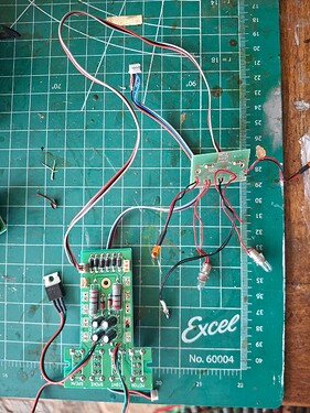

Christmas preparations and crummy weather (rain…lots of it!) have brought work on our projects to a near standstill. We thought this was the weekend to install the wiring…
…button things up, and put her in trim. Nope. First, there was a broken wire connection. KID-zilla learned the importance of noting which wire goes where before cutting and resoldering things!

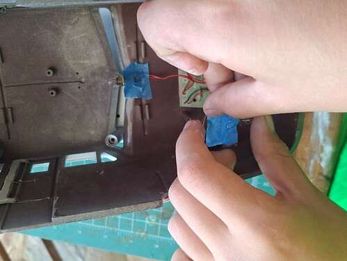

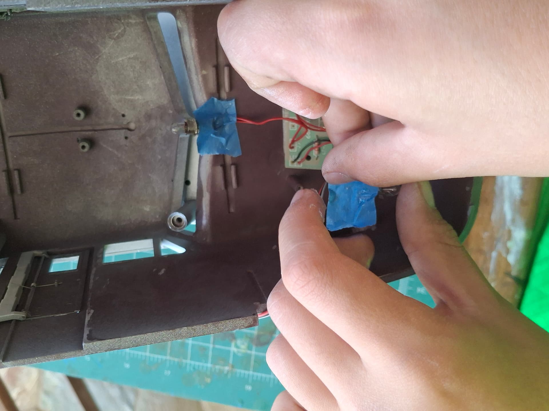

He likes soldering…Also, I wanted to record how he used some of the existing bits of the ALCO shell to mount the smoke generator under the roof.

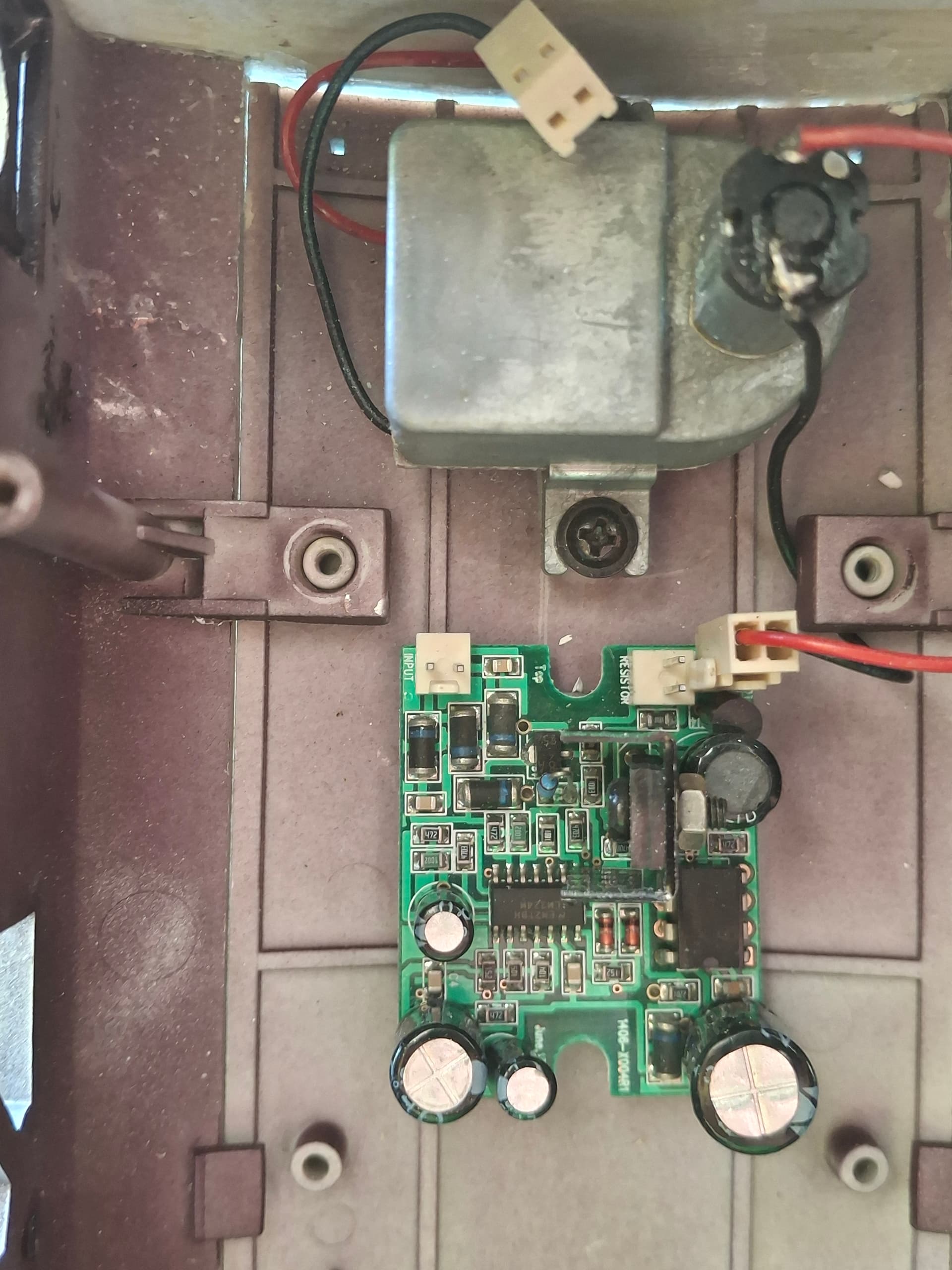

Double sided tape works well to hold the circuit board in place.
With everything good to go, it was time to put power to the circuit.

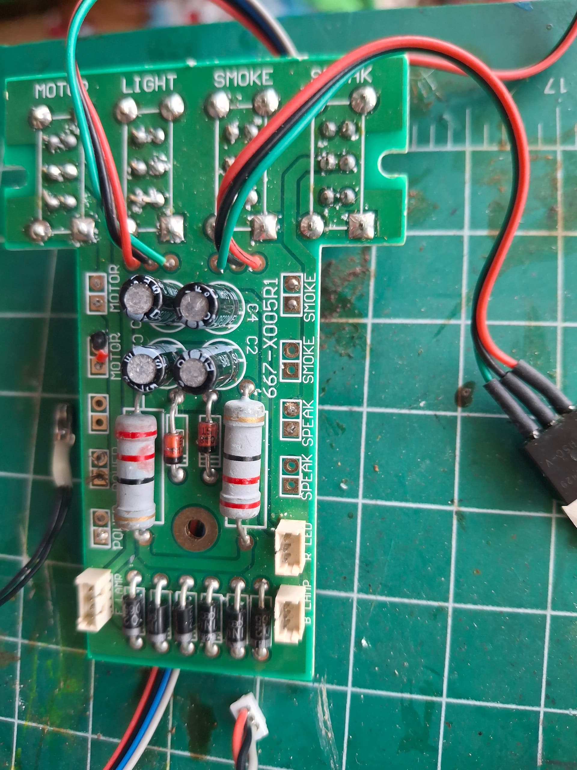

Nope. Only one light came on. We verified each LED worked, but there is some mystery in how the 'trons go from the main circuit board to the little light board. We tried looking for schematics (@Pete_Lassen , were these USA Trains boards), but no joy. Pictures are below:
We can probably follow instructions on how to wire this all together; apparently, the labeling on the circuit board is not as self-evident as we had hoped! I also suggested we look for a small batter powered lantern we can install in the cab and activate as needed. It’s a poor work around, but I sense his ambition is leading to frustration. I am trying to get him to move on to the diaphragm, fuel tanks, and striping so that he can score another intermediate victory as we fiddle with the lights.
