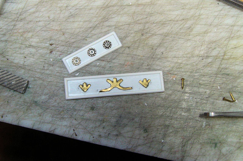

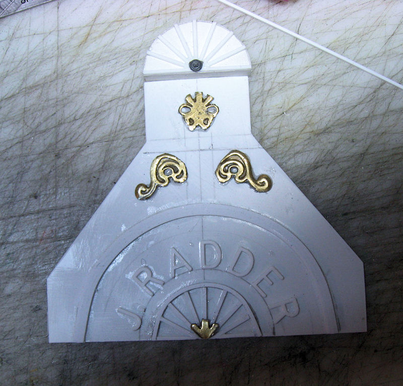

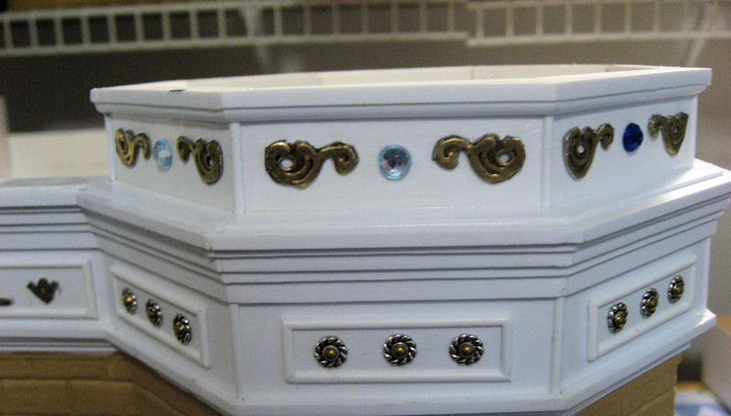

Started building the panels. The top ones are built with some jewelry spacers, also from Michaels.
(http://www.jbrr.com/Pics/Structures/JRadder/IMG_0112.JPG)
I put some rhinestones in between the stamped metal pieces.
(http://www.jbrr.com/Pics/Structures/JRadder/IMG_0118.JPG)

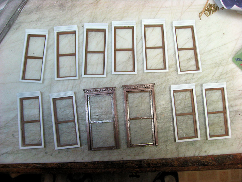

I trimmed up the windows. All but two will go on the side and back; the two larger ones go on the front. I still have to put some satin finish on the “wood” parts. The front windows are painted with the blackened bronze.
(http://www.jbrr.com/Pics/Structures/JRadder/IMG_0124.JPG)
I’m not sure which color I’ll paint the side and back windows. I’m leaning towards a lighter bronze I picked up.

Thanks, guys. The windows are really not THAT hard to make; just not all that quick.
And, in the spirit of providing more detail… :wink:
The outside part of the frame is done in .040" x .100" strips, with a .040" x .250" strip across the top.
The triangular shapes on the two front windows was done by slicing some .125" triangular rod from Plastruct. I have the NWSL chopper and had it set up to do slices of about .030".
The upper part of the other windows was built up with four strips of styrene: .060" x .125", .040" x .100", .040" x .060", and .040" x .040". IF I had planned ahead, I might have obtained more even spacing, but this is what I had on hand.

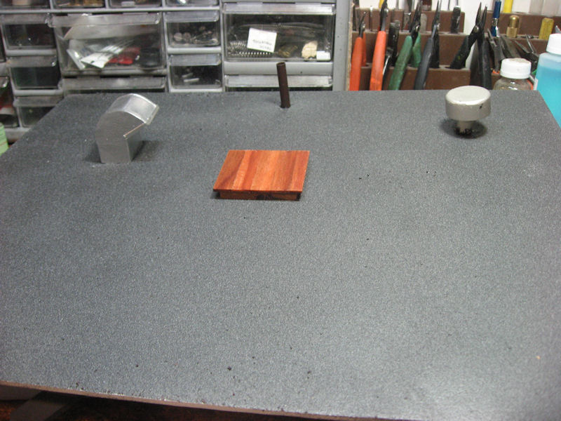

I painted the roof with some dark gray textured spray paint and added a few details. The two silver vents actually open to the building, so they should help air it out a bit.

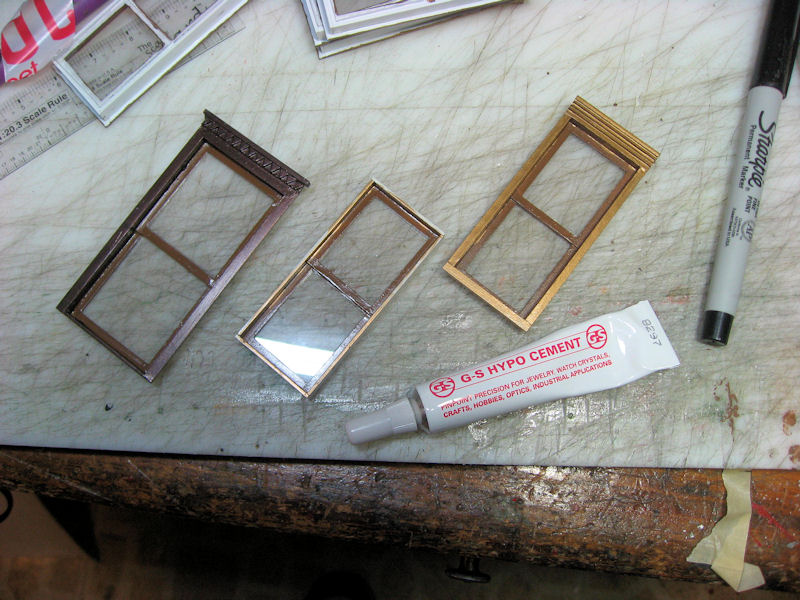

I ordered some chimneys after deciding my scratch built ones didn’t look so hot. :frowning: I glazed all the windows with some thin polycarbonate I had on hand. I’m sure glad I standardized on only two window sizes as it makes cutting that stuff a lot easier.
(http://www.jbrr.com/Pics/Structures/JRadder/IMG_0134.JPG)

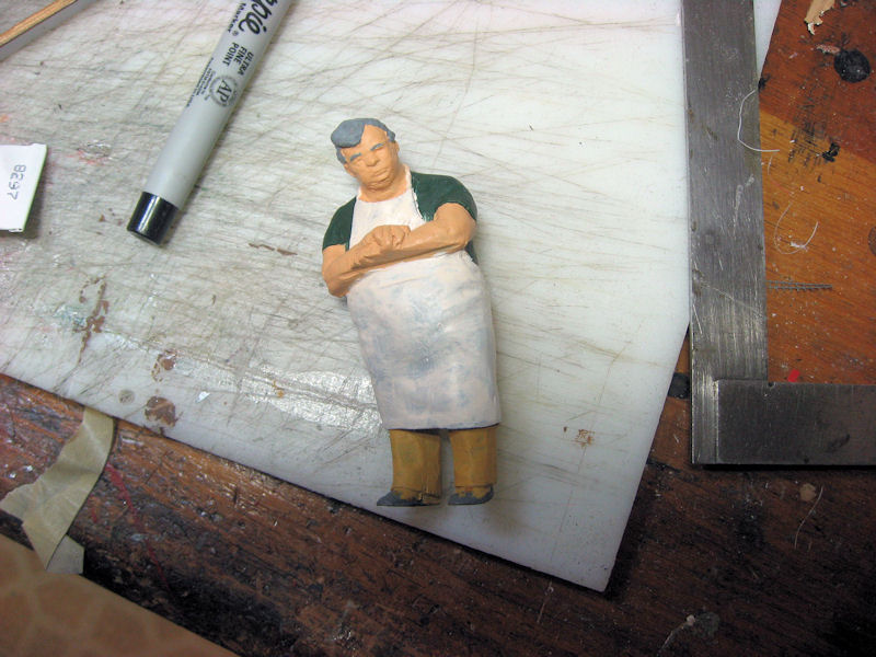

I’m trying something new this time: I got this glue from Scale Art Models. According to their site: Hypo-Tube cement is a tacky-crystal clear cement that is ideal for gluing glazing to you window and door castings. It dries water proof and is unaffected by extremes in temperature or UV exposure. The tube has a hypodermic-like applicator manufactured into the tube for super accurate -no mess gluing. It is also ideal for attaching small parts. While at their site, I also picked up a guy that looks like he could be the proprietor. I gave him a shave and started painting him.
