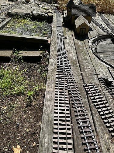

Today I cut in the new #8 switch from Sunset Valley on the far end of the Burke yard runaround, and connects to the SS inside track of the yard. This switch has the SV switch throw on it as well.
I am now out of rail and need to order some more.

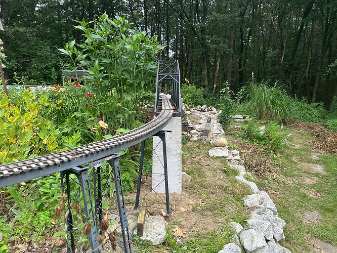

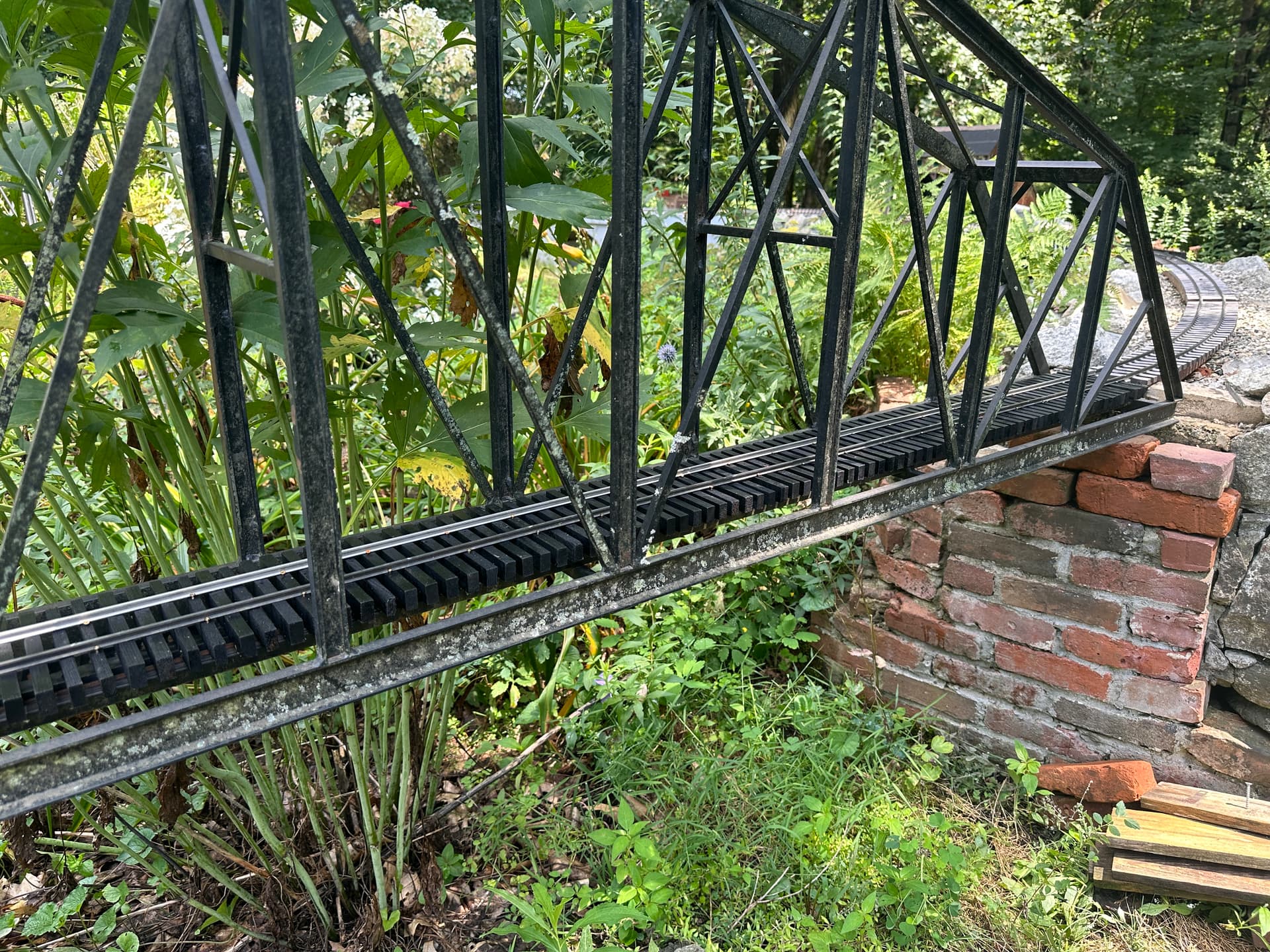

Some work on the big bridge, too. Moved the second arch bridge from where its behind everything and hidden, over to the side here. Cast concrete pier holds the front end up. I’ll (probably) be skinning the concrete with stucco and carve in blocks.

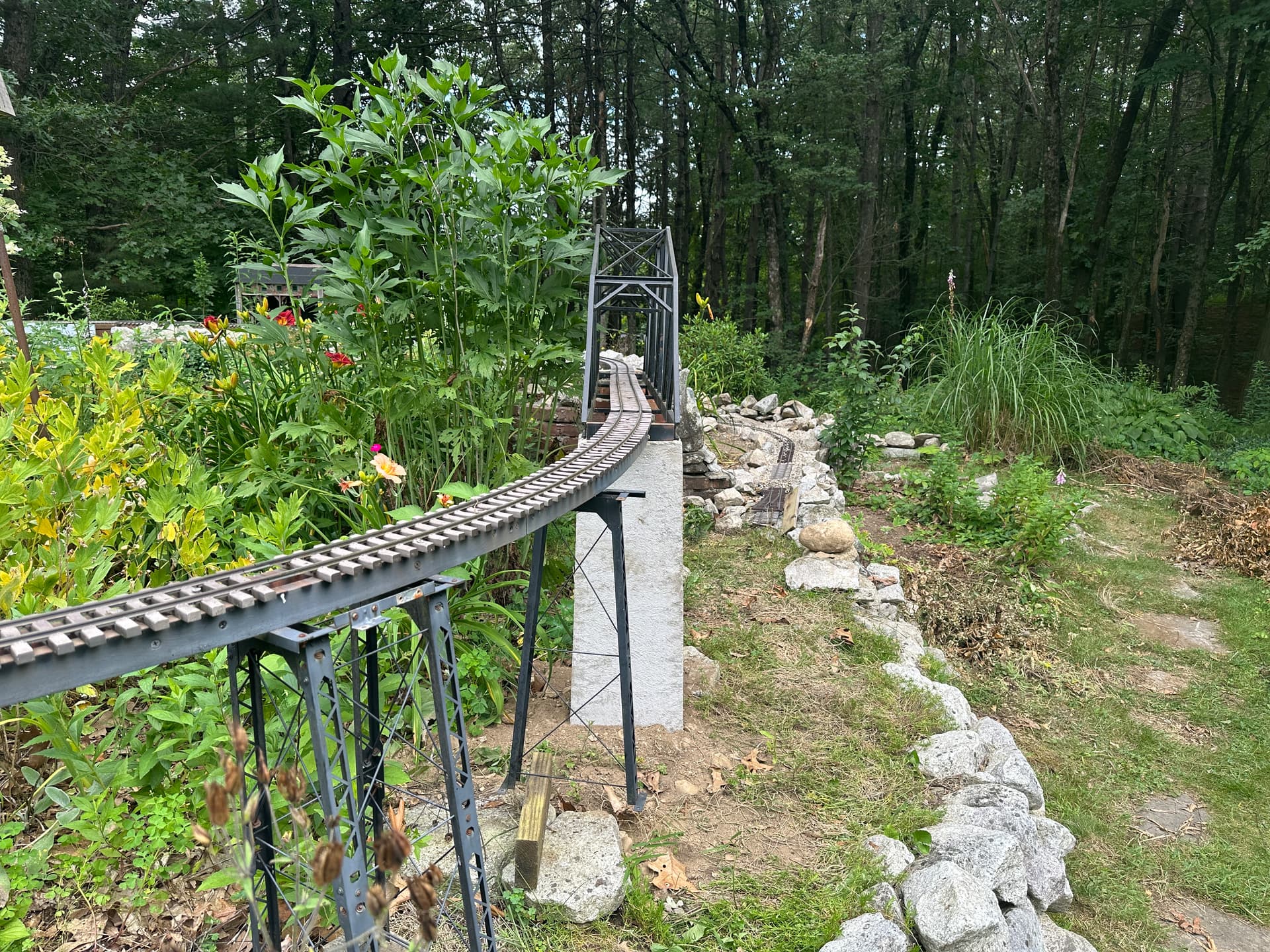

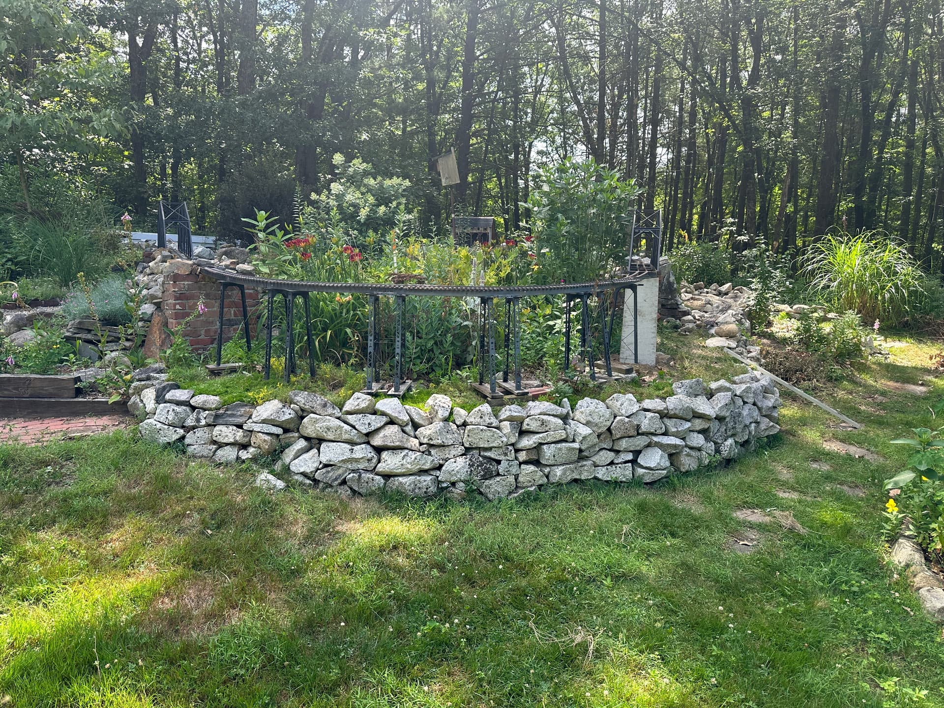

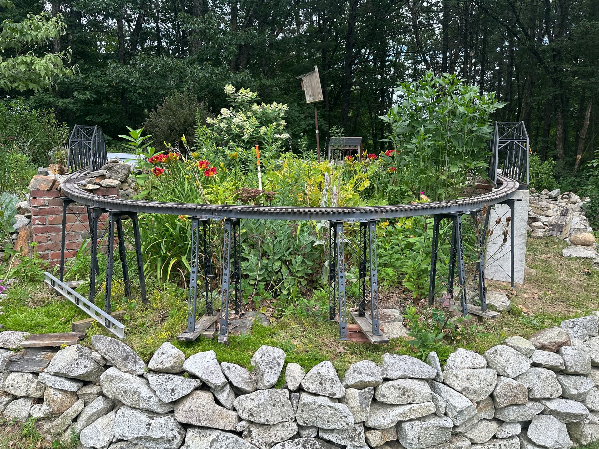

And an overall view of the loop, with the ‘new’ bridge on the right. Curve needs a bit of realignment but not too bad. The metal piers will get moved closer together, and I’ll be adding girders between them.

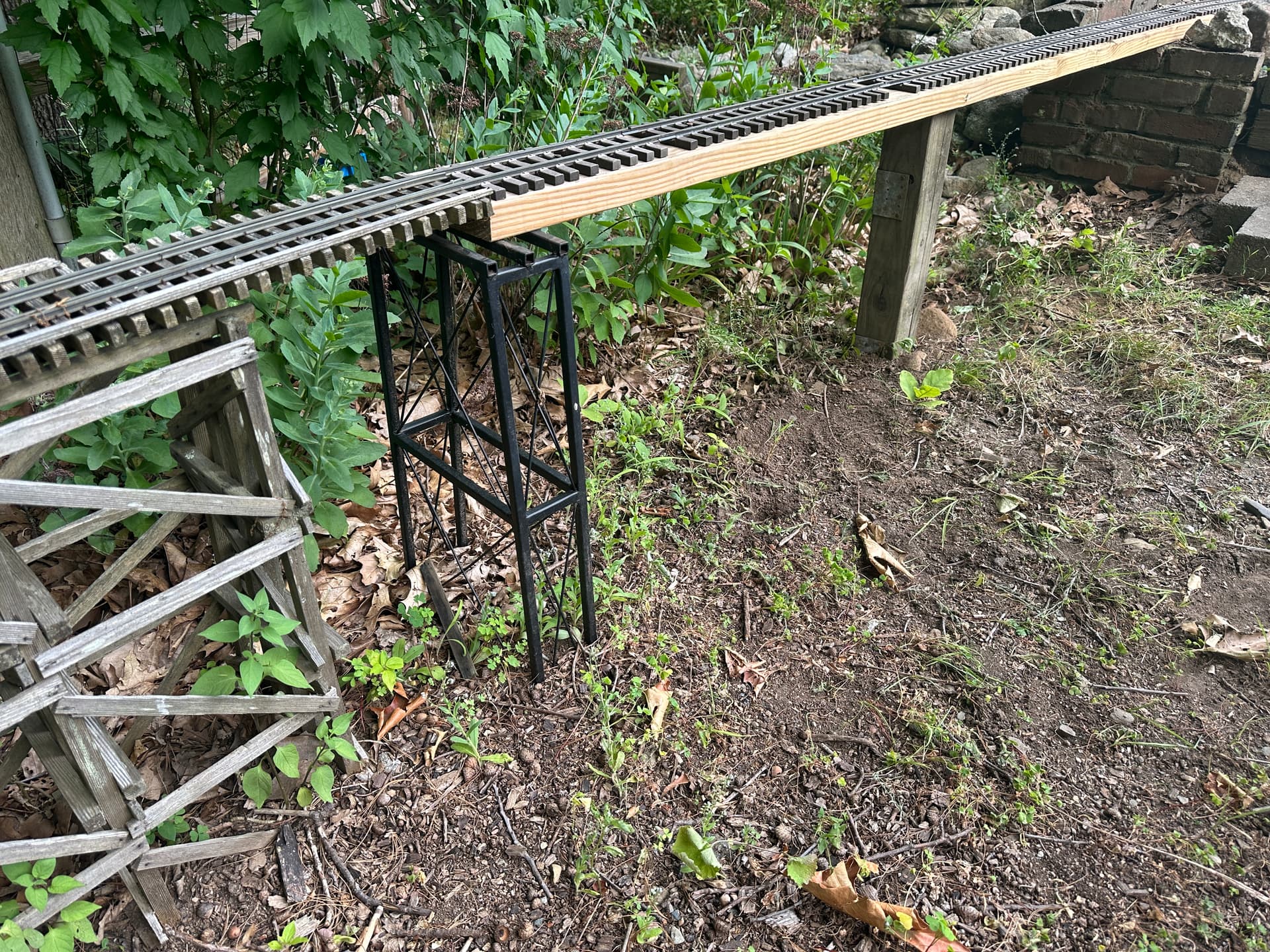

Re-aligned the metal piers and trimmed the spline that makes up the support of the bridge. They’re a bit more than half the distance apart that they were. Looks much less spindly.

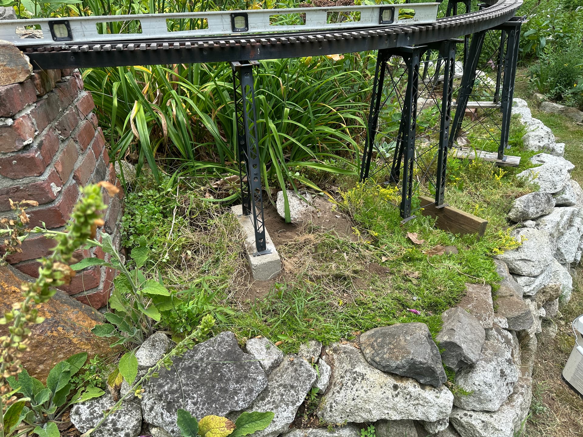

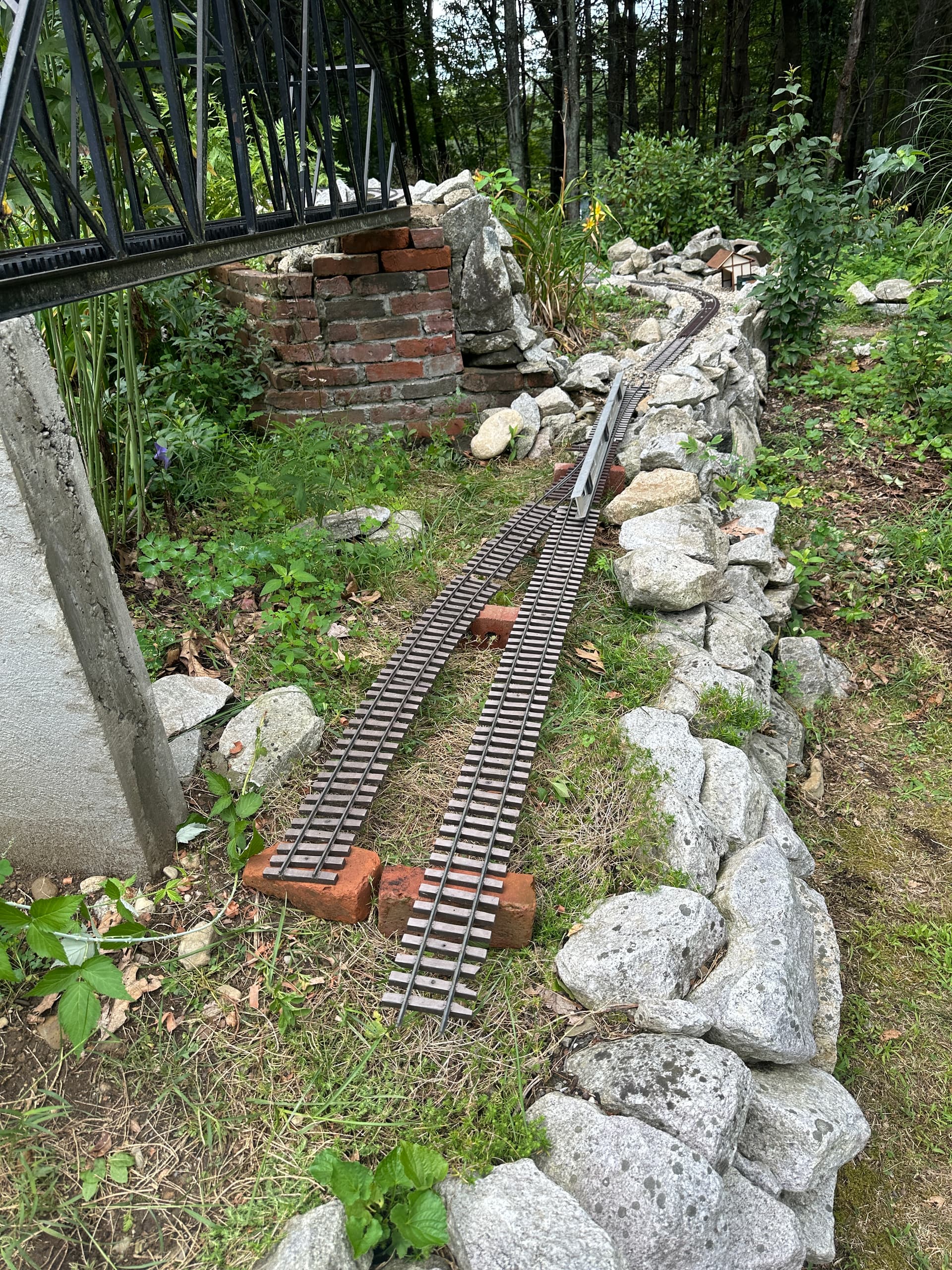

Re-laid the track, and leveled everything. Next up will be digging for the footings (last picture)

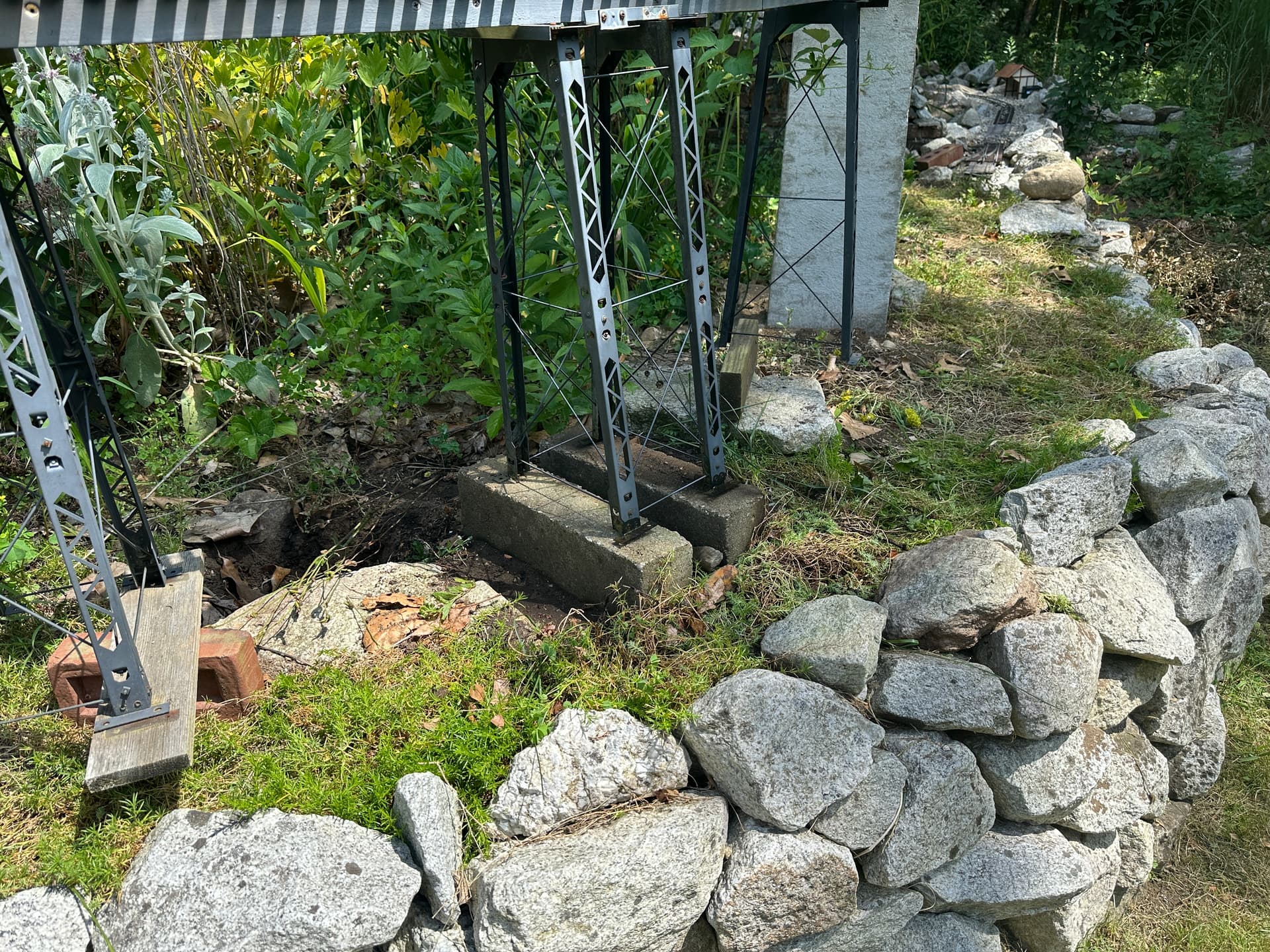

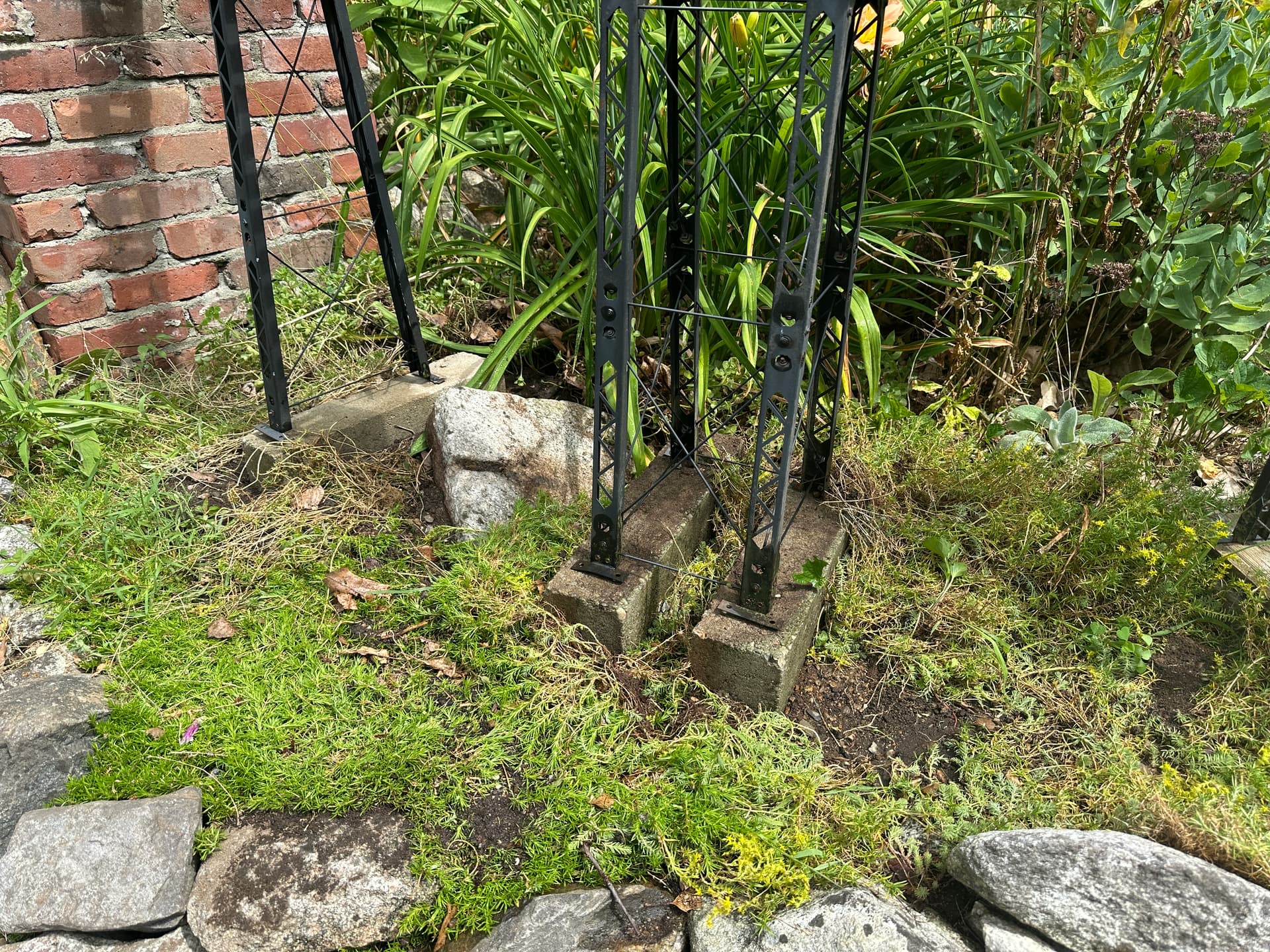

Hot working on the railroad today, but Ill try to get a few of the footings done.
Another one done. I might have one more in me today. It’s pretty hot and humid out right now.
Last one today. Too hot and humid to do more. The rest involve digging out a bunch of rocks and hauling some fill.

Nope, They are out of level …get back out there and get it right!

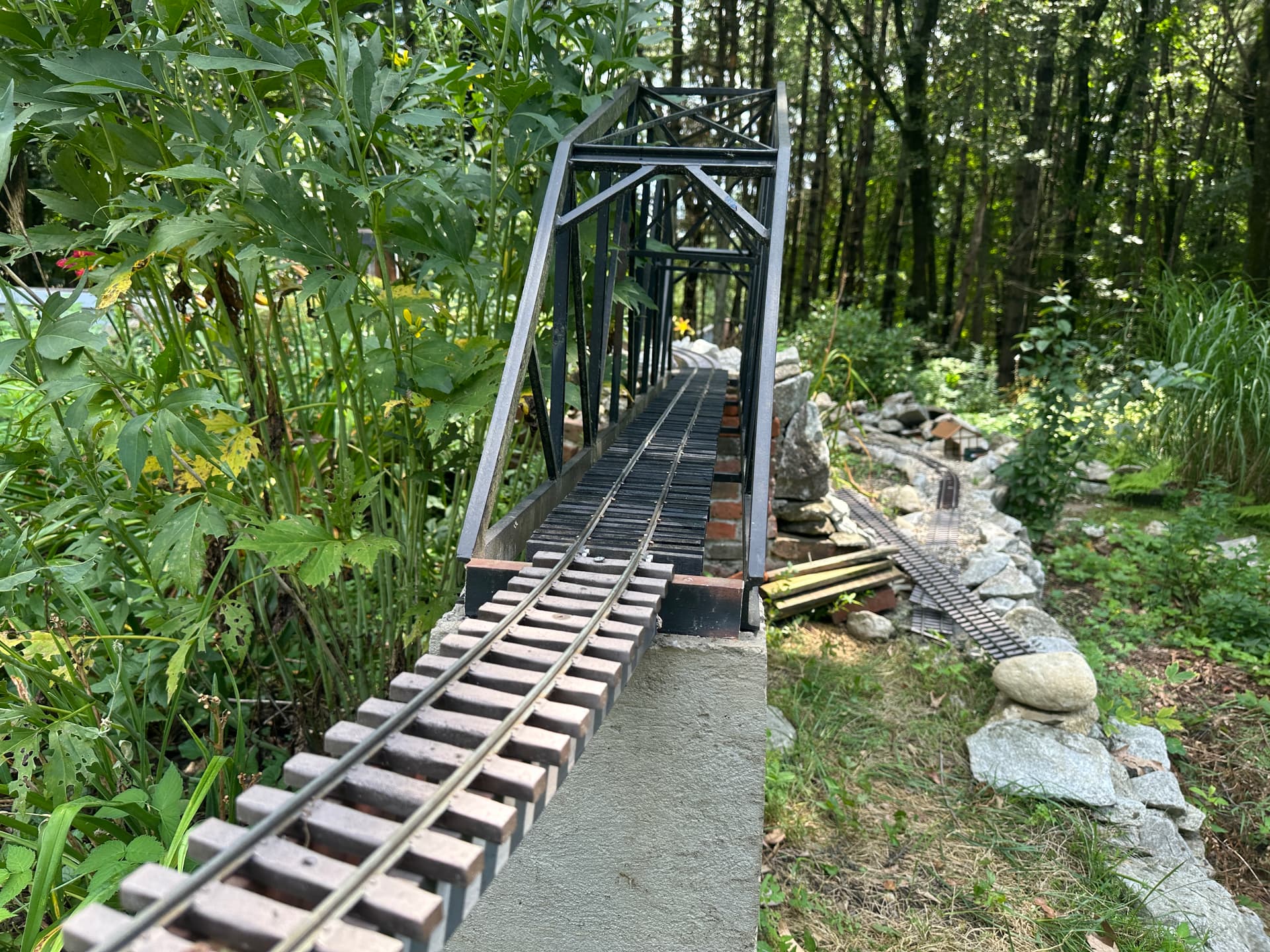

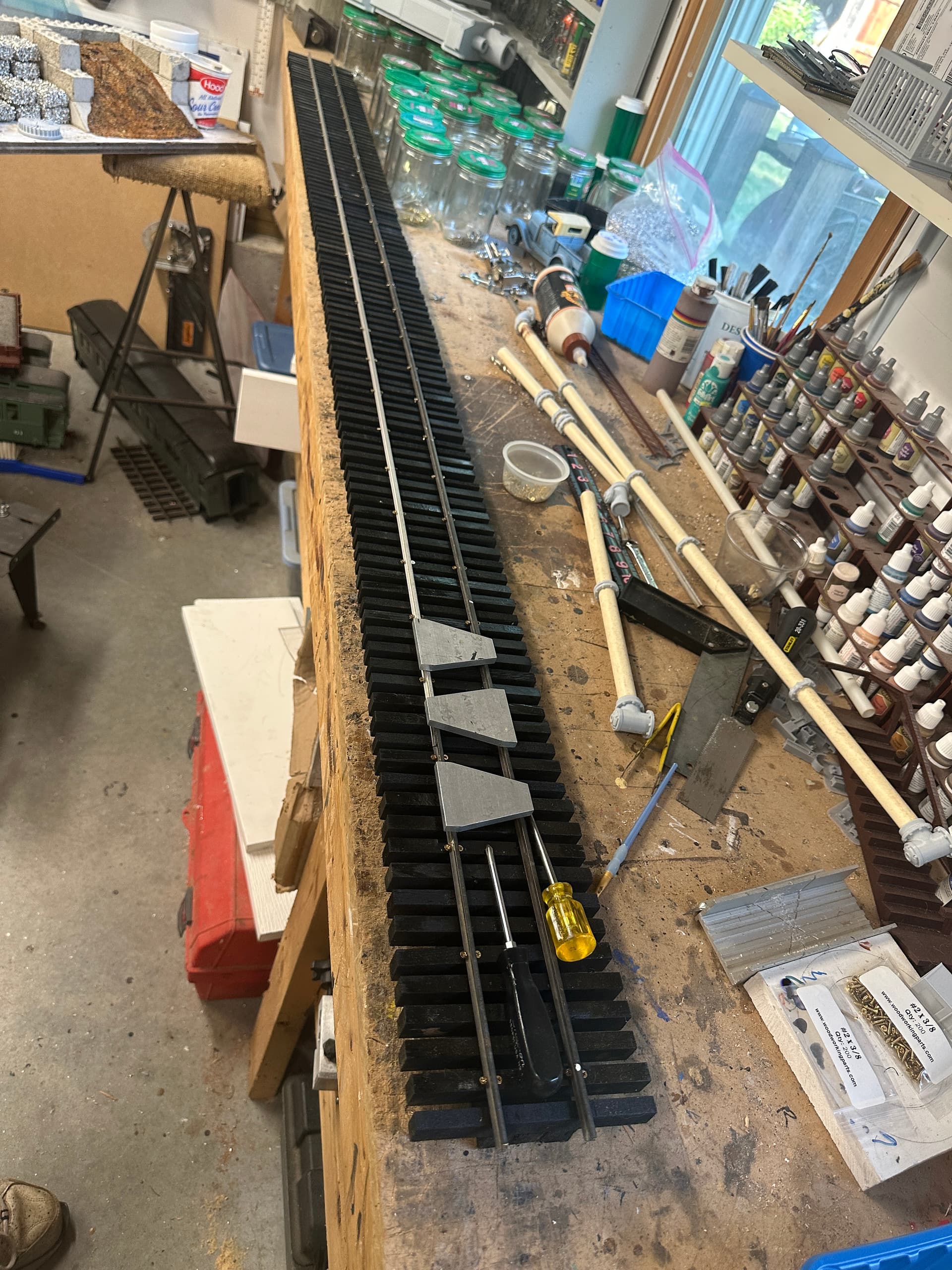

Ties for the bridge are done, with one piece of SS rail and some brass until I can get more SS in a few weeks.
And temporarily laid in place.

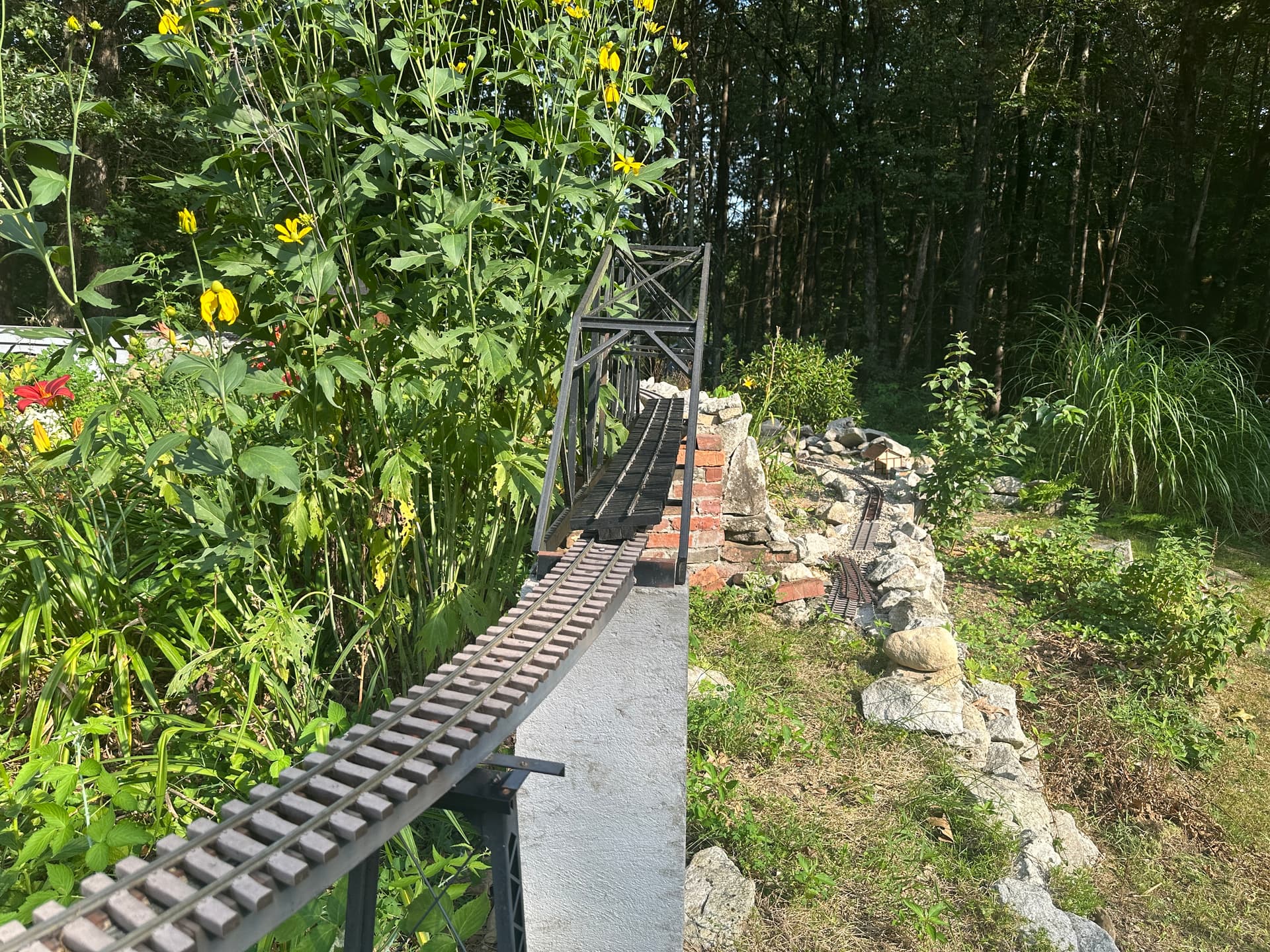

Bridge ties installed semi-temporarily. Once I get more SS rail, Ill be replacing the brass, and adding guard rails. But this will at least let the mainline reopen for operations.

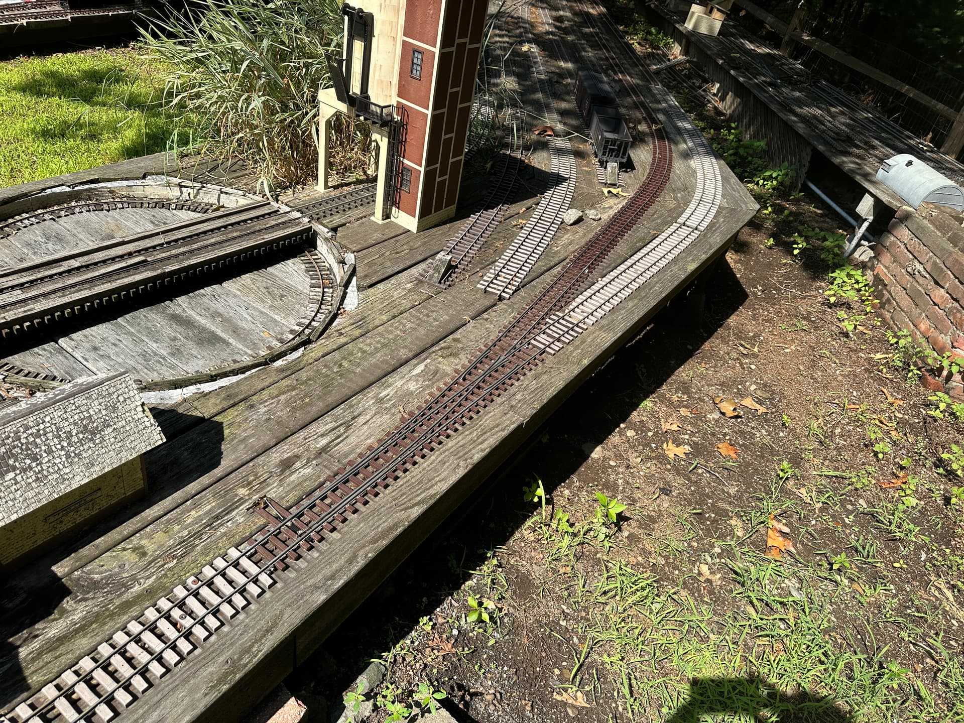

Track at the colliery at the new Majestic. Again, this is semi-temporary until I get more SS. Now to move a bunch of fill, I need to raise this whole area about 5" to meet the track level.

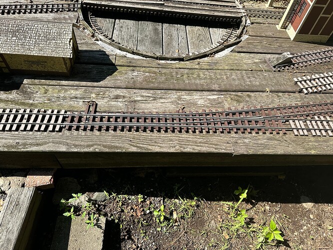

And the last (?) bit of trackwork for today. Cut in the new #8 at the west end of Burke yard. This replaces the old Switchcrafters #8.

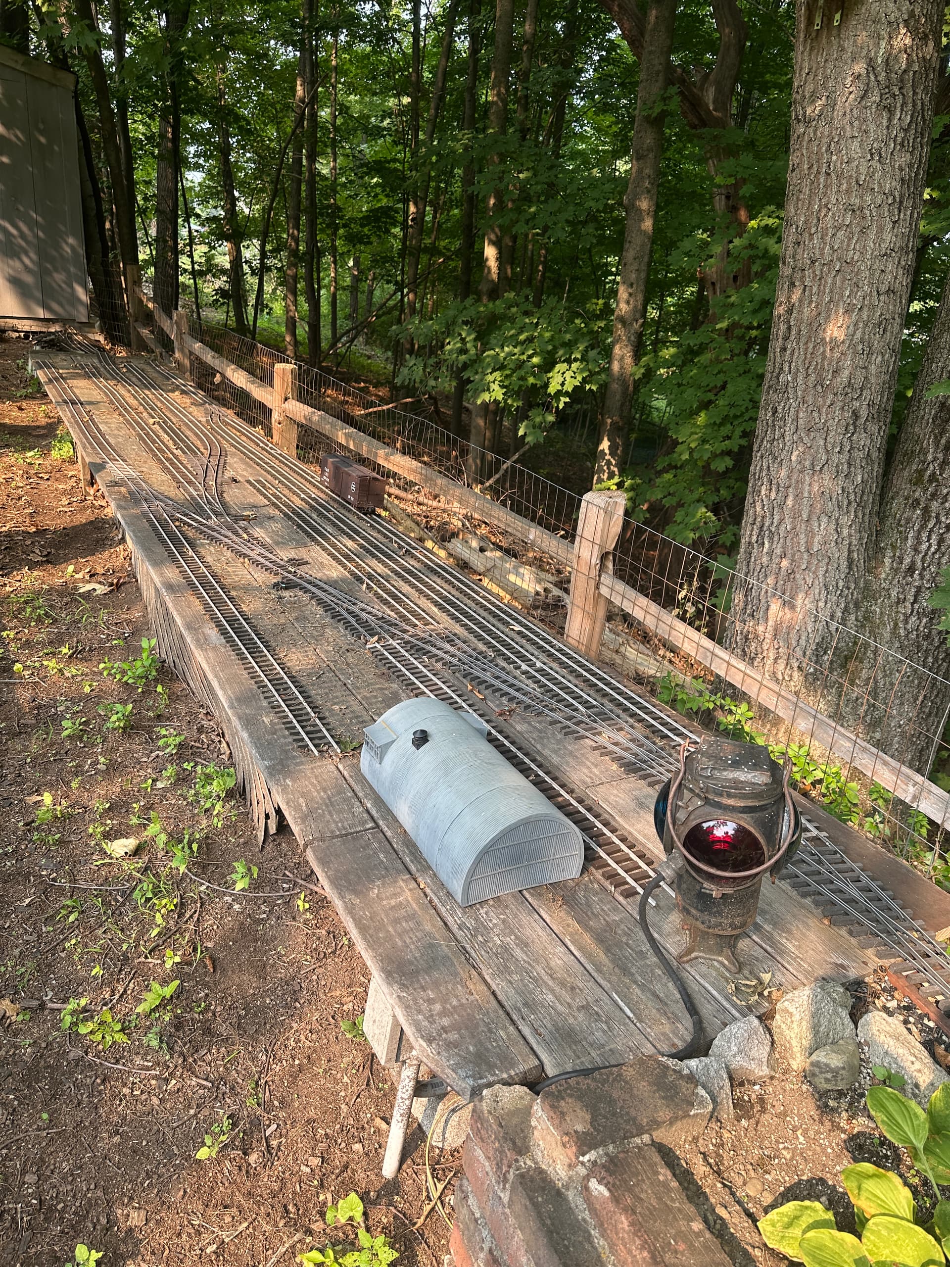

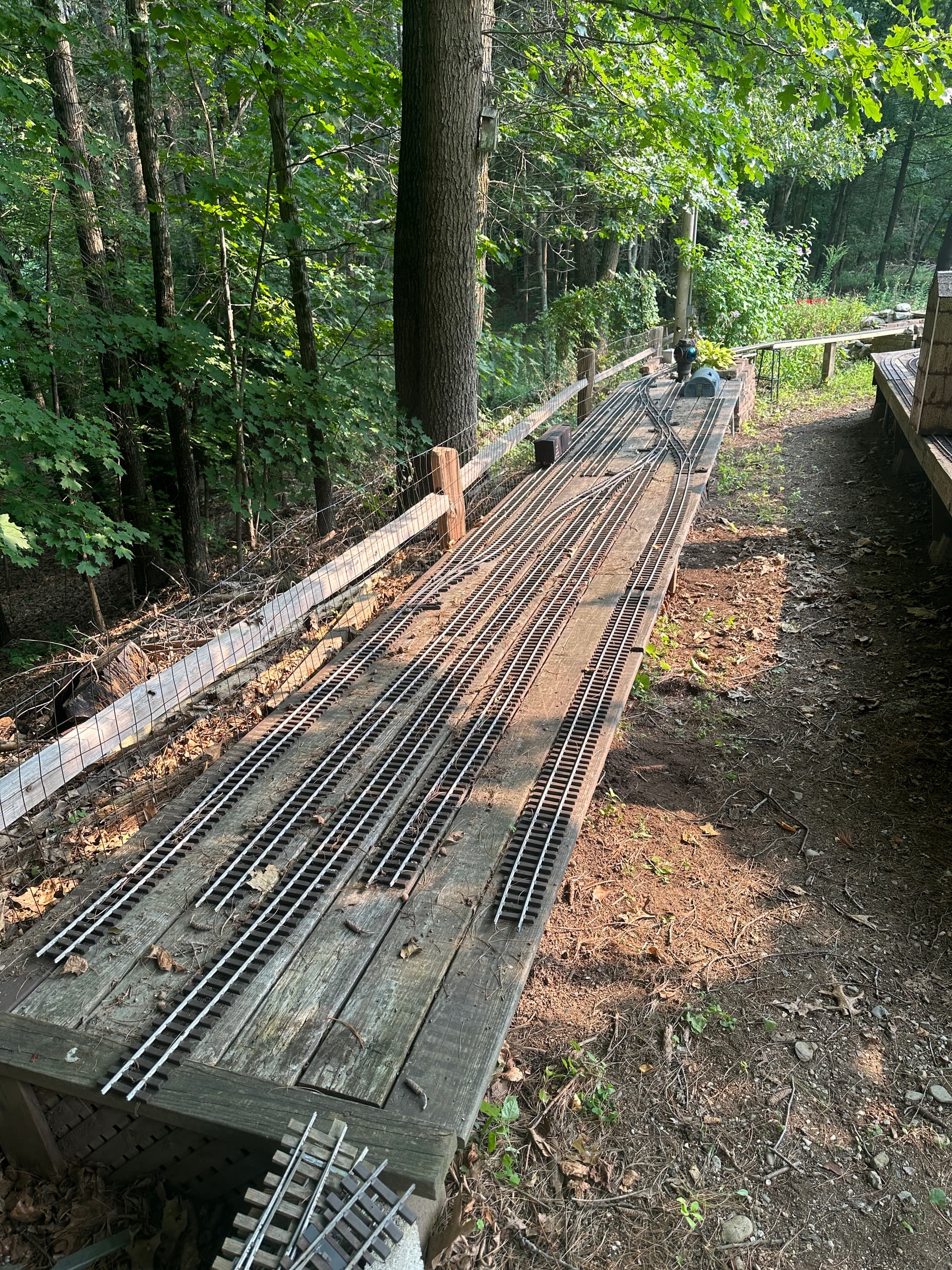

Temporary-ish yard and industries at Franklin Falls. The bench work needs to be rebuilt but that will be post-TrainOps. But this gets us 3 yard tracks, a runaround, and a few industry sidings for now.
