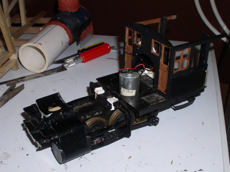

Caution - Major revisions ahead! I probably should have been working on the Derrick today, but I wrecked this thing and started over, instead… It probably was no real secret that I wasn’t all that happy with the Aristo cylinders. And since Kim vetoed me buying a c-16 to make into a Camel, my options became pretty clear.
(http://www.the-ashpit.com/mik/WINANS4.JPG)
In the bottom of Vic’s goody box there was also a set of cylinders from a Stainz. After about 2 hours of fussin’ and cussin’, I managed to figure out how to make them work.
(http://i1082.photobucket.com/albums/j371/AlleghenyValley/2012/P2020001.jpg)
The Lionel 0-6-0 is really, really short. So my Camel will be a short firebox version by necessity. 89c worth of pvc pipe, some leftover plexi, and an empty pill bottle, and I was on my way!
(http://i1082.photobucket.com/albums/j371/AlleghenyValley/2012/P2020003.jpg)
Since about the only way to lift this thing will be by the cab sides. I needed a way to ensure that the cab was not only level, but attached securely. Drilling the boiler to put some 1/8" music wire under the floor sounded like a pretty good idea.
(http://i1082.photobucket.com/albums/j371/AlleghenyValley/2012/P2020004.jpg)
The old Lionel cab floor pieces were re-used… waste not, want not!
(http://i1082.photobucket.com/albums/j371/AlleghenyValley/2012/P2020005.jpg)
Fenders were fabbed from a bit of leftover c-16 boiler shell and coffee stirrers. They should look OK once they are painted.
(http://i1082.photobucket.com/albums/j371/AlleghenyValley/2012/P2020007.jpg)
sand boxes installed and cab started…
(http://i1082.photobucket.com/albums/j371/AlleghenyValley/2012/P2020009.jpg)
I’m thinking it actually may look more attractive as a Camel than it did as a Vauclain…
