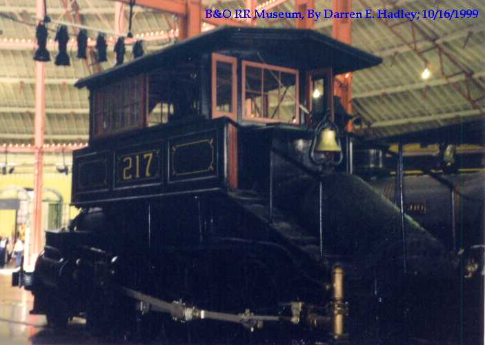

Personally, I’m thinking a Winans Camel as a “must build” sooner or later… totally different beast, but many do confuse them.
(http://www.railarchive.net/centprog/r_winans.jpg)
(http://www.the-ashpit.com/mik/WINANS5.JPG)
(http://www.the-ashpit.com/mik/WINANS4.JPG)
(http://www.trainweb.org/rradventures/images/1999-10-16_BO_Museum/abc.jpg)
