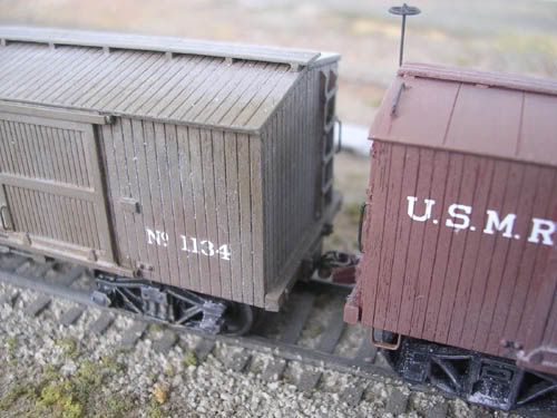

(http://www.the-ashpit.com/P1010003_08.JPG)
Mik, does your friend have more photos of USMRR?
