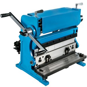

The other thing that happened today was that a metal shear came in. It’s cheap and not high quality, but from reviews should shear brass reasonably well. Al was kind enough to shear my initial stock for this, but, inspired by him, I’m trying to tool up for the rest that’s needed, and also future efforts.
Sucker’s heavy, my back still hurts from uncrating it a couple hours ago and getting it on the table! Yes, I lifted with my legs, and did a team lift (with me, myself and I). Anyway, it’s dang heavy. I need to assemble & calibrate it, and (as Al did, but probably not near as professionally) modify it for repeated shearing of identical strips.
Harbor Freight?
Has slip rolls on top, is it a brake as well?

Rick, it’s a shear-brake-roller. Several have them (3-in-one metal shear or machine); I got mine from here:

Rather than modifying the shear for adjustable stops (I realized it was sort of beyond me), I took the easy way out and clamped down a bar of aluminum, using a 3/16" square styrene strip to gauge it from the blade.
As long as I had enough sheet material to grab onto from the rear, and push it against the clamped bar, I was able to get reasonably consistent strips, even from 1/32" sheet.
The shear’s stated capacity is 20 ga steel, but it barely did the .03 brass. I wouldn’t try .03 steel… But since I only need .025 brass, I think it’ll do fine.
