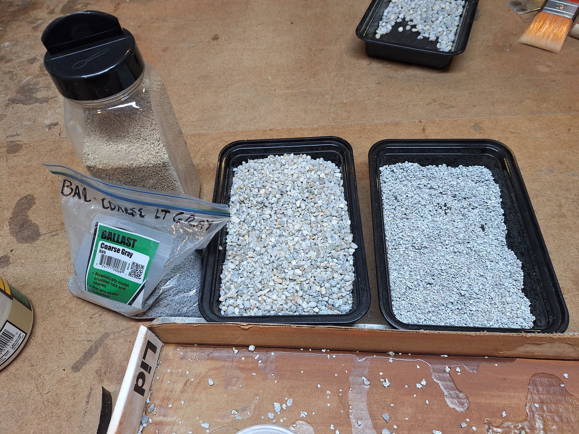

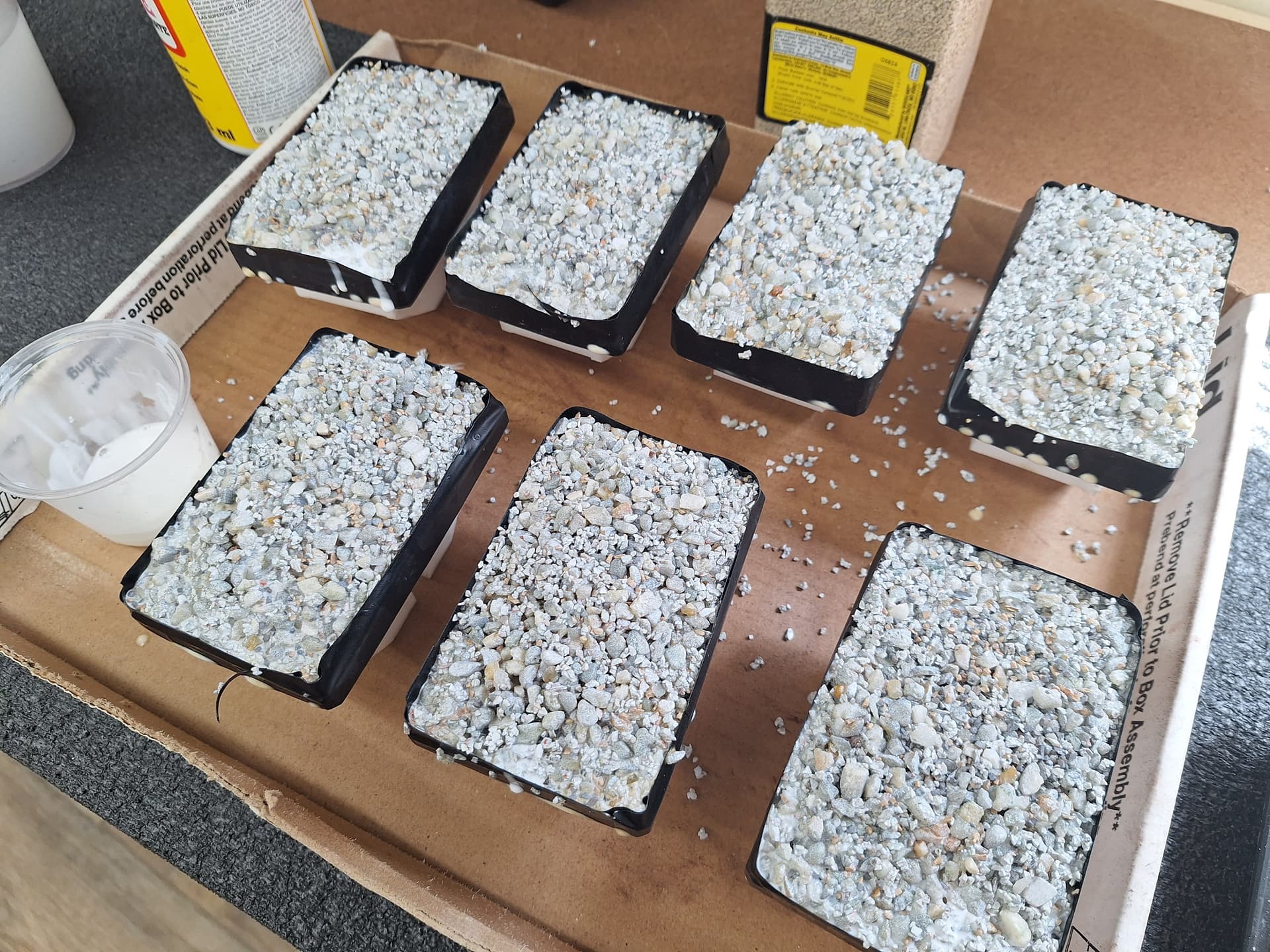

Here’s how the load build has been coming, starting with two sizes of gravel, all of which was painted with white, some green and some black. I also sprinkled on some buff and gray ballast.

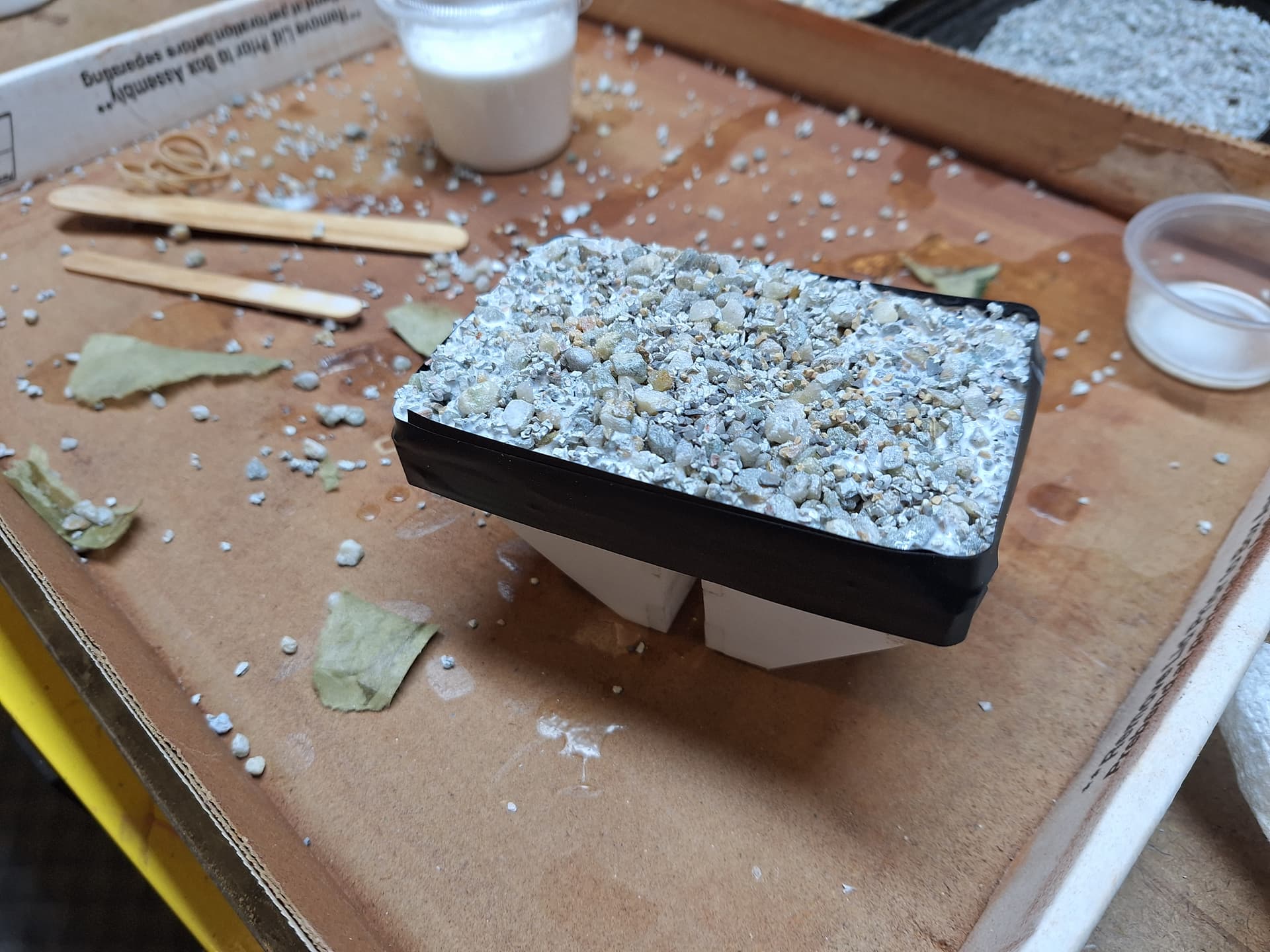

The first article:

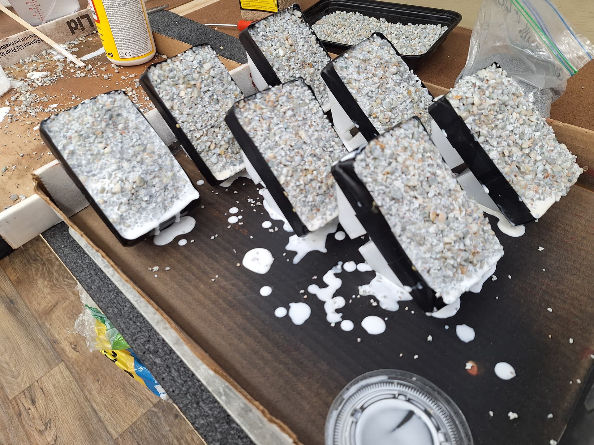

It seemed to come out fine, after a bunch of belt sanding to make it fit. Here’s the other 6 in process.
The gravel is held with mod podge (with 33% water), which dries matte. After draining came touchup gravel. After all is dry tomorrow, and tape is pulled and sanding done, I’ll probably find more bare spots to fill. Then I’ll need to check-fit with the bins (but I hope they’ll be interchangeable, we’ll see).
The magnet idea is likely to fail, because the rocks are going on thicker and heavier than I expected. I had originally planned on a thin layer of ballast, but after going down the ore rabbit hole I ended up here.
So to get the loads out, I’m belt-sanding them to have a decent gap with the bin, so I can just tip them out.
