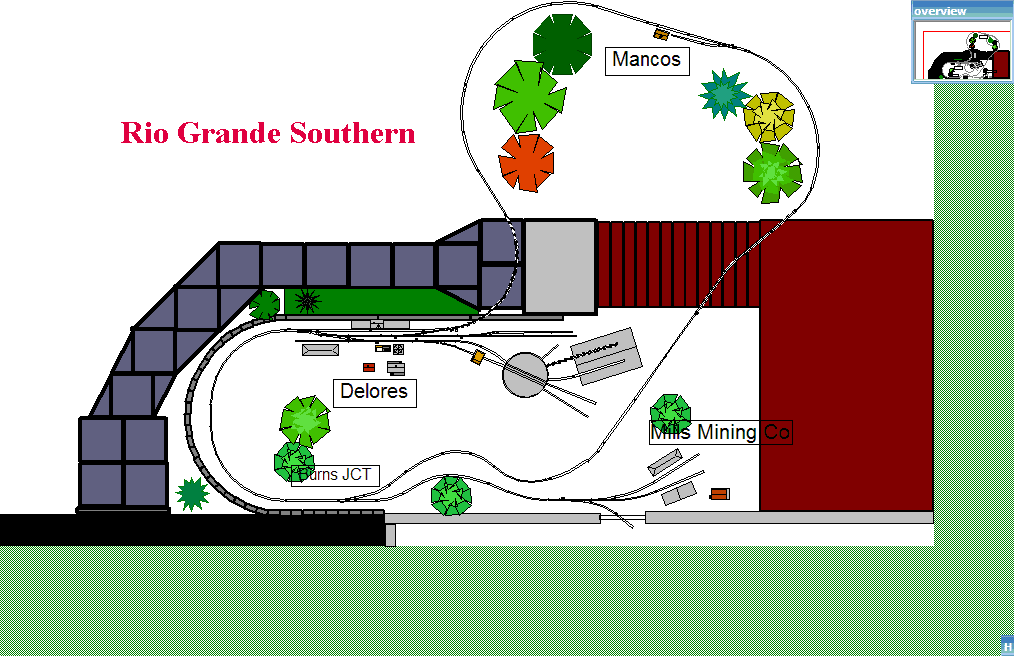

Whatever works, HJ. Here’s how mine works. for the time being since it’s just a simple loop, I have just 2 trains running, An East Bound Extra and a West Bound Extra. (EBX2 & WBX1). Here’s a track diagram…
(http://i253.photobucket.com/albums/hh58/rgseng/RGS4.gif)
Trains originate in Delores, west bound is clockwise, east-bound vice versa. In Delores there are basically just 2 industries, a freight house for local LCL freight and the coal tipple. The FH can get Flatcars, Boxcars and Reefers. The Tipple gets Drop Bottom Hoppers and Gons. So far, that’s what it gets. Both industries can handle 2 cars. The next town, Mancos has a short 2 car siding for LCL freight. It can handle Boxcars, flatcars, and gons. It may get up to 3-4 cars, some not the type that I have marked to go there. Mills Jct has 2 industries, Mills Manufacturing(track 2) and Mills Mining (track 1). Track one can handle 3 cars, boxcars, gons and DBH’s. Its length can handle 3 cars(40"). Track 2 is the same length and handles BC’s, TC’s Gons, and Flats. Burns Jct is the Interchange. The connection to the outside world and also to my storage area. It can handle every type of car. The problem I still have is that a train will deliver any type car to any siding. I’ll have stock cars being delivered to Mancos. Or to Mills Mining. Example: (from my last run) Switchlist - Train EBX1 (East Bound Xtra 1) - 4/17/1924 Rio Grande Southern Locomotive: 20 - RGS 4-6-0 Caboose: 587 - D&RGW Proceed to Mills Jct., arrive with 7 cars Industry: Milling Co. Industry: Mills Mining Non-industry Pick up: Boxcar 8729 RGS Non-industry Pick up: Boxcar 3527 D&RGW Non-industry Pick up: drop bottom hopper 003 RGS Drop Off : Flat Car 2 CCLCo Drop Off : Stock Car 7341 RGS Drop Off : Stock Car 2015 SV RY Drop Off : Stock Car 1 D&RGW Drop Off : Refrigerator Car 513 RGS Drop Off : Refrigerator Car 71 D&RGW Drop Off : Refrigerator Car 3 SV RY Drop Off : Boxcar 8729 RGS Drop Off : Boxcar 3527 D&RGW Drop Off : drop bottom hopper 003 RGS Now I can usually get around this by un-checking the cars that shouldn’t be going there, but that sometimes leaves me with an empty train. BTW, what is a Non-Industry Pick-up? It’s acting as if Mills Jct is an Interchange, which it isn’t. As you can see, way too many cars and not the types I should be getting there. Another ongoing problem I’m still having is when I build a train and the program goes to open up Adobe , it hangs up and I have to do an “End Task” thing. If I open Adobe before I open TrainOps, no problems. I also have 3 cabooses but the program only recognizes 1 (Switchlist - Train WBX2 (West Bound Xtra 2) - 4/17/1924 Rio Grande Southern Locomotive: 42 - RGS 2-8-0 Caboose: ________________________________) No caboose on this train and none show up on the drop down list. Here’s a “realistic switchlist”: Train # : EBX1, Thursday, April 17 1924 at: Burns Jct Call Time : 04:50 AM Origin : Burns Jct Clearance#: 94-177 Destination: Mills Jct. Engine : 20 - RGS 4-6-0 Cabin: 587 - D&RGW --------------------------------------------------------------------------------------------------- ## Car Number E LG KND Consignee SPOT NxtLoc Tons Contents Move --------------------------------------------------------------------------------------------------- CONSIST ON LEAVING BURNS JCT *** When done proceed to Delores *** 1 CCLCo 2 L 16 FC Interchange track Burns Jct Burns Jct 35 OUT 2 RGS 7341 L 16 SM Interchange track Burns Jct Delores 35 OUT 3 SV RY 2015 L 16 SM Interchange track Burns Jct Burns Jct 35 OUT 4 D&RGW 1 L 16 SM Interchange track Burns Jct Burns Jct 35 OUT 5 RGS 513 L 16 RF Interchange track Burns Jct Delores 35 OUT 6 D&RGW 71 L 16 RF Interchange track Burns Jct Burns Jct 35 OUT 7 SV RY 3 L 16 RF Interchange track Burns Jct Burns Jct 35 OUT DEPART BURNS JCT WITH 7 CARS, 245 TONS 112 INCHES *** Interchange *** DEPART DELORES WITH 7 CARS, 245 TONS 112 INCHES DEPART MANCOS WITH 7 CARS, 245 TONS 112 INCHES 8 RGS 8729 E 16 BX Agent Mills Jct. Mills Jct. 35 OUT 9 D&RGW 3527 E 16 BX Agent Mills Jct. Mills Jct. 35 OUT 10 RGS 003 E 12 DBHP Agent Mills Jct. Mills Jct. 35 OUT ARRIVE MILLS JCT. 11 CCLCo 2 L 16 FC Mills Jct. 35 IN 12 RGS 7341 L 16 SM Mills Jct. 35 IN 13 SV RY 2015 L 16 SM Mills Jct. 35 IN 14 D&RGW 1 L 16 SM Mills Jct. 35 IN 15 RGS 513 L 16 RF Mills Jct. 35 IN 16 D&RGW 71 L 16 RF Mills Jct. 35 IN 17 SV RY 3 L 16 RF Mills Jct. 35 IN 18 RGS 8729 L 16 BX Mills Jct. 35 IN 19 D&RGW 3527 L 16 BX Mills Jct. 35 IN 20 RGS 003 L 12 DBHP Mills Jct. 35 IN Mills Jct has 2 sidings. It’s not telling me which cars go to which siding.
