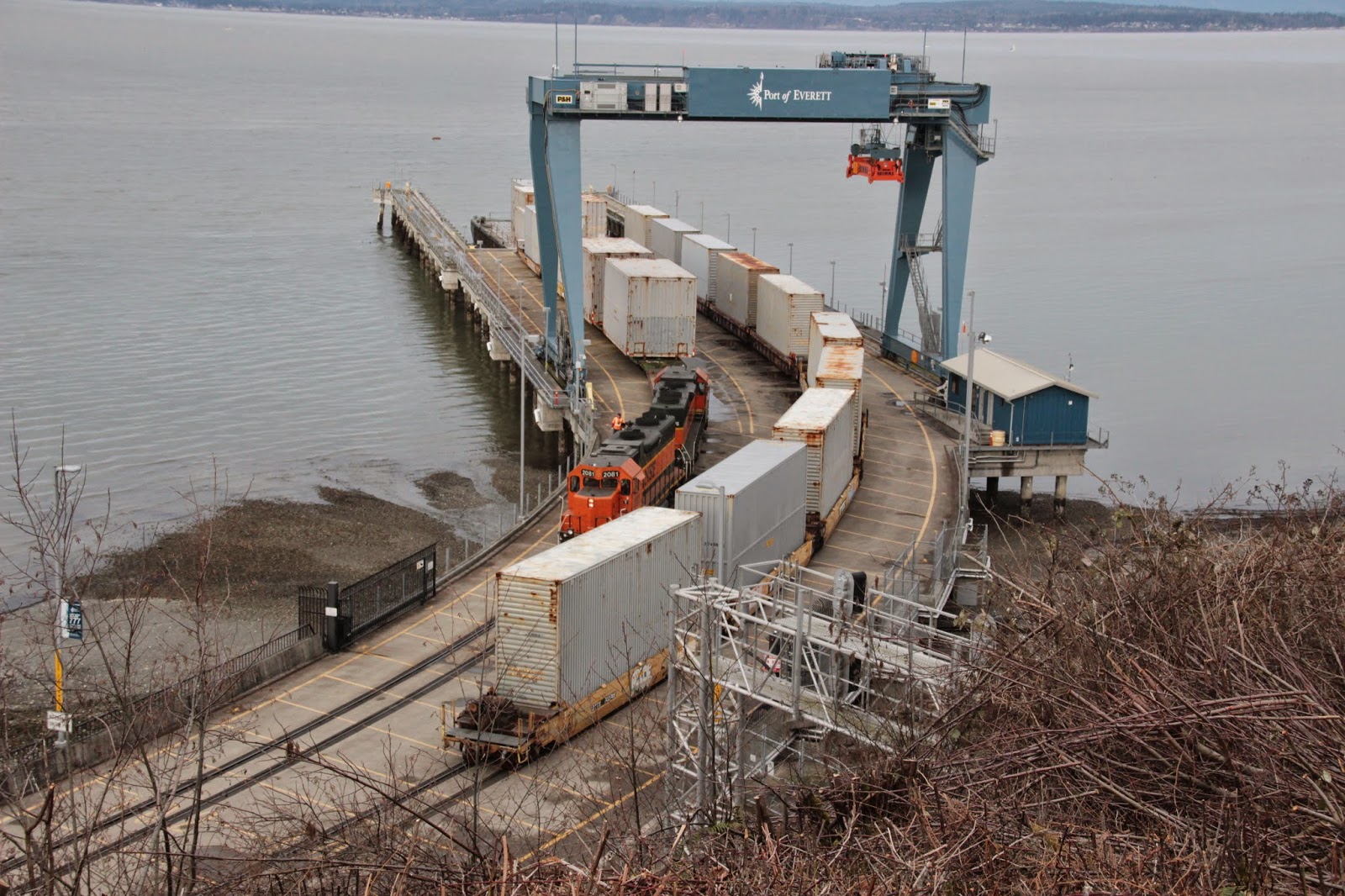

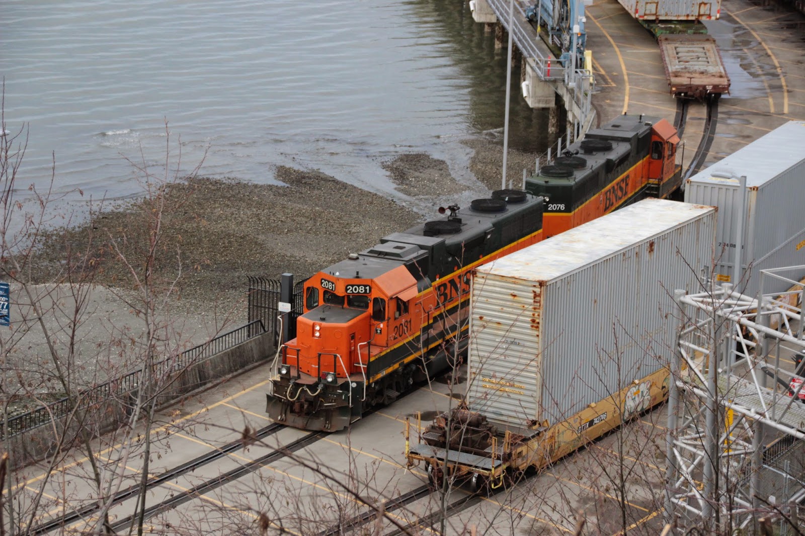

Just found these online of the ‘new’ slip. I’m not 100% sure, but I think the widebody cans come off a regular ship at the Port of Everett, transloaded on to a barge, which is then brought over to the new slip.
