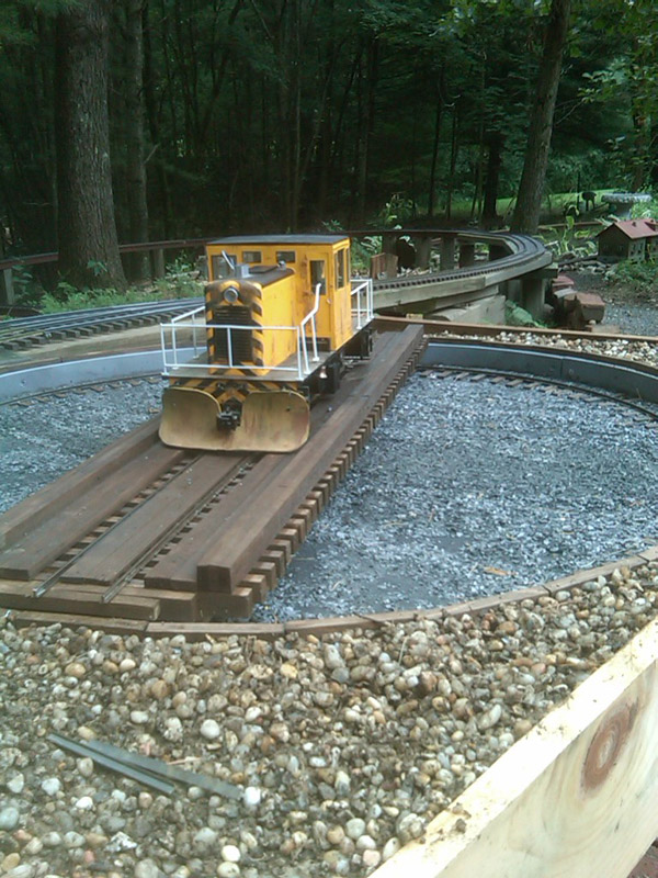

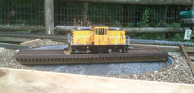

Today I attached the pit top timbers, benchwork sides, and put down some gravel to see how things look.
Next up are railings, and possibly a light over the middle of the turntable. And, of course, connecting it to the rest of Burke Yard.

Looking good! How big is it?
about 40" long. Fits the K with a bit left over.
I thought the K was shorter than a yard? My Mike is right at a yard. I THOUGHT that this was Robbie’s K27 last year at Ric’s…and it sure looks shorter.

Lookin’ good Bob! I like your shallow turntable pit too. Mine’s a bit deeper (and a little the worse for wear) which just leads to a greater accumulation of debris. I have to build another one soon for Port Orford’s terminal and I think I’ll emulate yours somewhat now that I’ve seen how good it looks.

I have this pic of the ties and ring rail, also shows the pit wall and supports, and the base.
Bruce, that IS my K. According to Google, the Accucraft one is 36.45 inches long; I suspect your engine is closer to 40/42 inches?
Nice. What are you using for the carriage underneath it?
Robbie, no, mine is 36"…that’s how big my turntable is…
Bob - do you have any pictures of the lazy susan? How are you holding it in place?
Ken: A 6" lazy Susan base. Greased it up a ton to keep crap out. Probably going to use a surgical tubing ‘gasket’ around it, too. I dont have a picture of it, but its this one from Home Depot

The base of the TT is a piece of 1x pine I treated with PT stain. The lazy susan is attached to this, and the whole thing is set, but not bolted, to the base using the other 4 holes, and some bolts set into holes. With a bit of prodding, I can lift the whole thing out.
