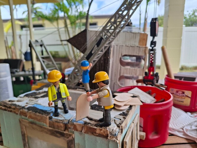

Update:

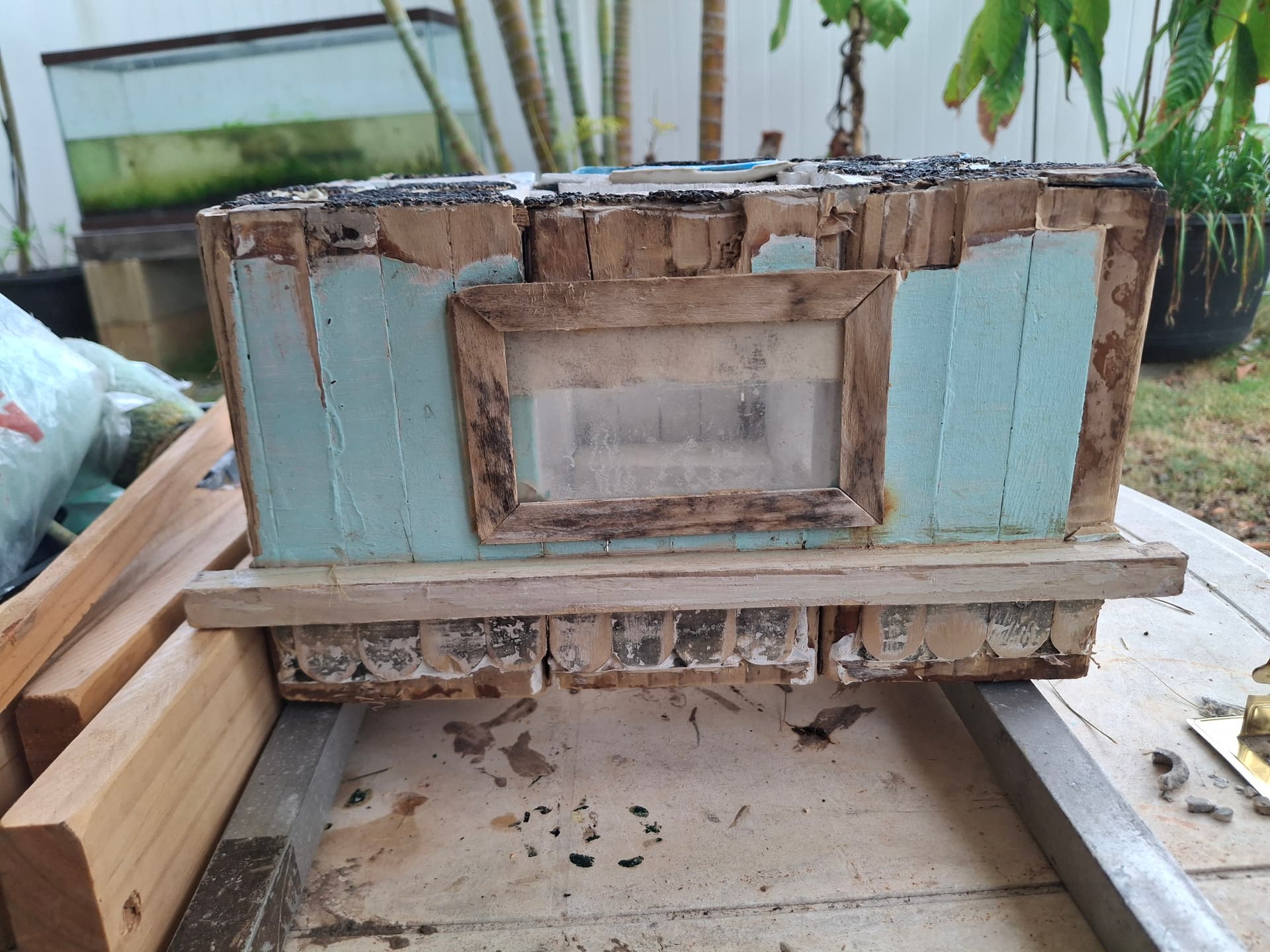

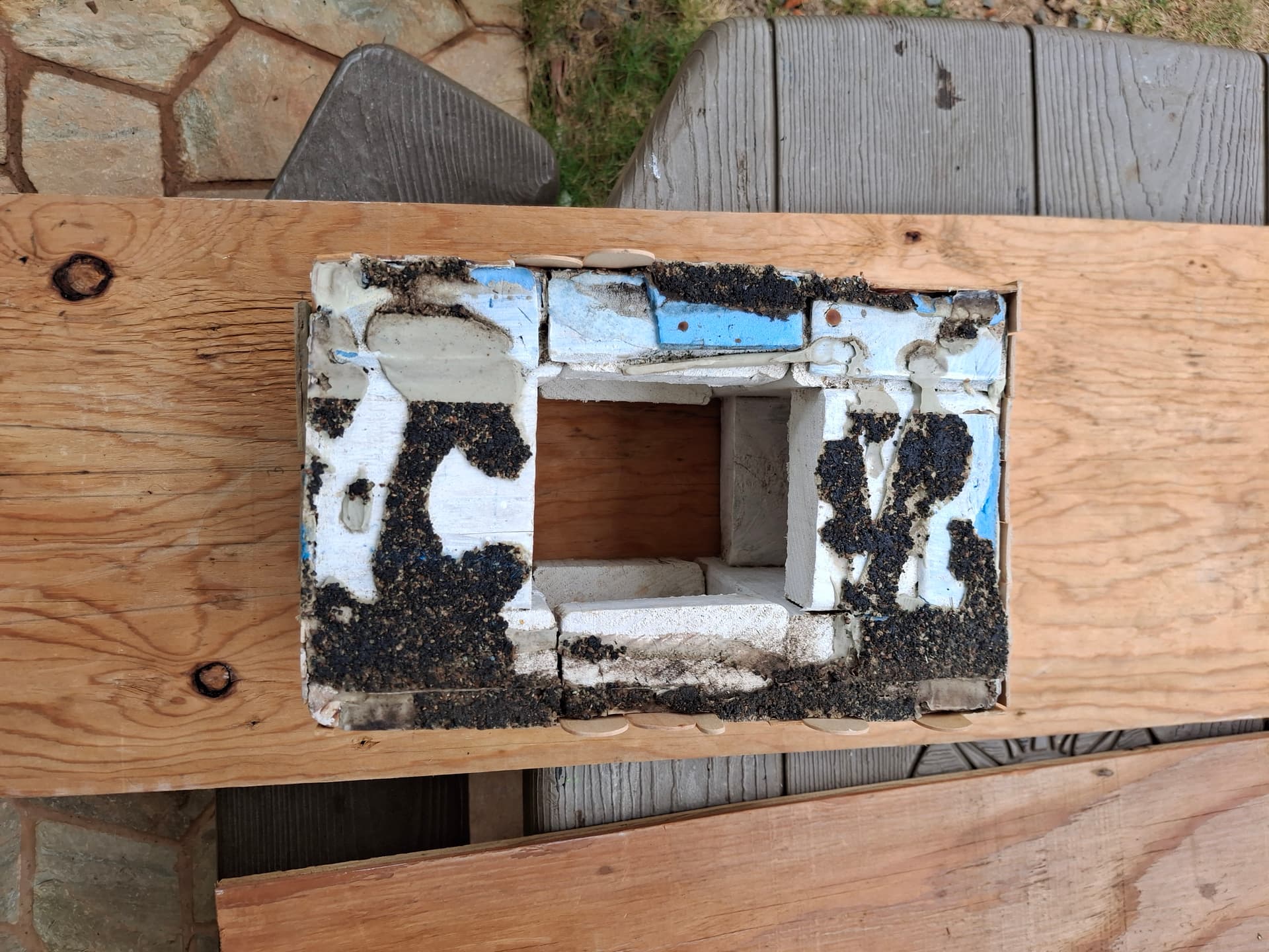

The building core got a thorough spraying with CLOROX. Here are some interior shots…
and here is an exterior shot:
Not a spot of fungus or algae to be seen! Thanks to Dave and Rooster (@David_Marconi_FOGCH , @Rooster ) for that tip.
The whole smells a bit like a public swimming pool, so it is busy airing out and drying up. This allowed me to have a “think” about proceeding. First, since we plan to move the control switches to the roof, the roof shingle will be insufficiently robust. We found some scraps that’ll correct that.

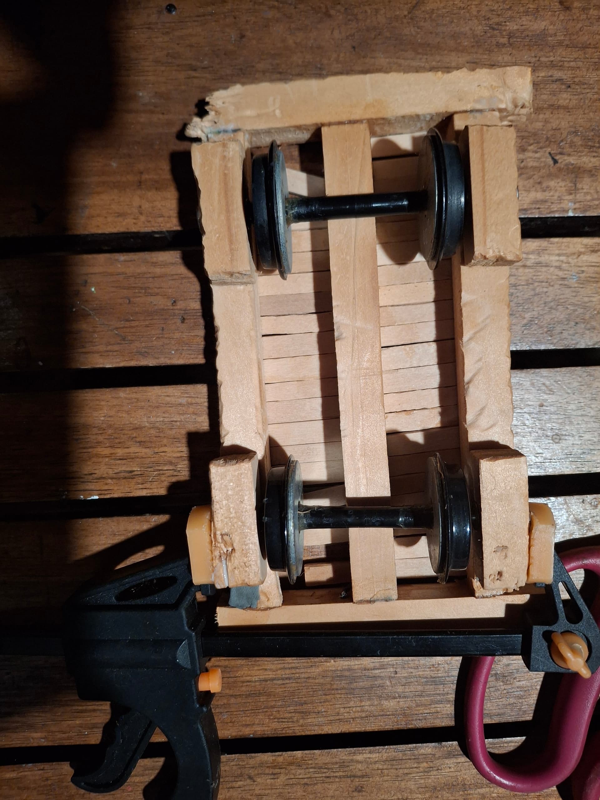

The other side project will be a poling car, made from the remains of the logistics cart for 1:24 Legio X Legio X passed into history this summer, but this scarred veteran of Consul Filis Maximus’ campaigns will serve on!
The green puts it in Triple O colors, but not so much that its Imperial use is hidden. It also needs to be functional, so it got new decking. Later, it got truss rods (shishkabob skewers), and it will get journal bearing covers. Handrails, pole holders, brake handle, whatever will go on as we go…and I get stumped on the project I am supposed to be doing!

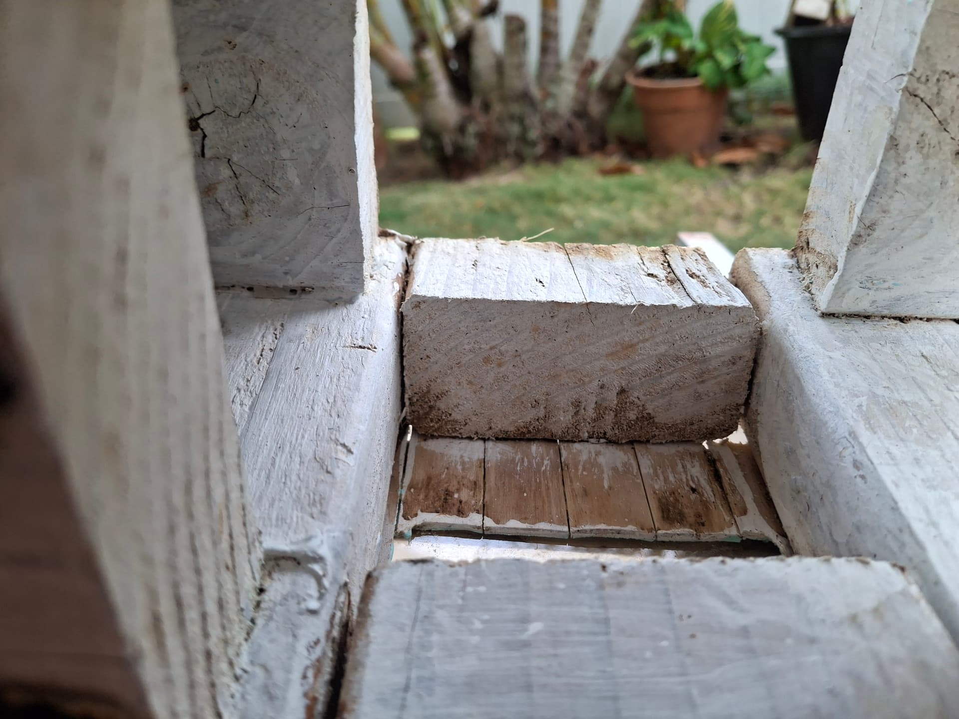

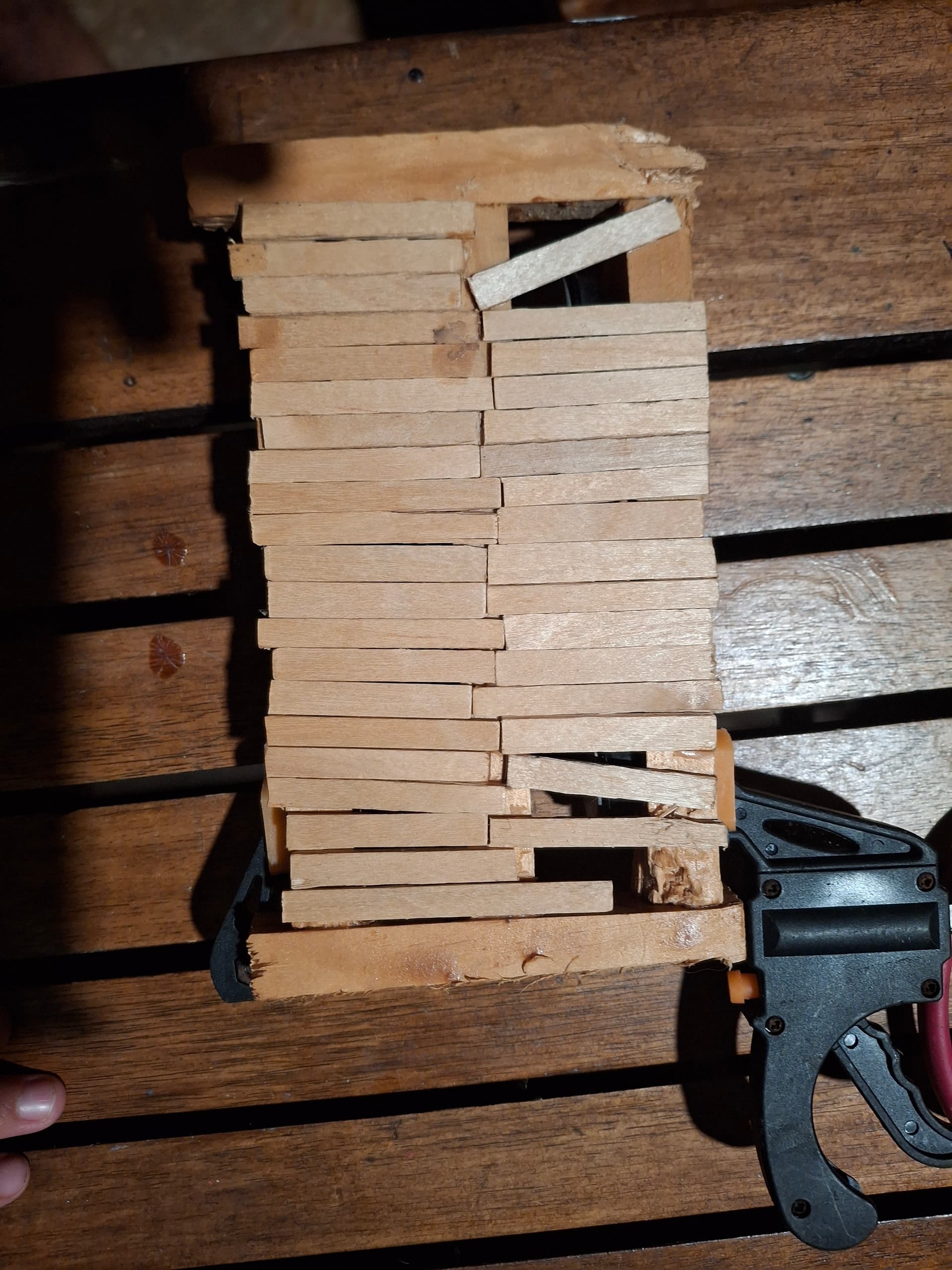

We had a weekend of a million errands, which was perfect for incremental progress across a swath of projects. For this one, it was time to close up the gap where the old light switches used to be. The 1:24 gang (the unions decided both Triple O crew and “Digger Men” had rights to the project) set to work turning tongue depressors into planks…
…and mounting those planks over the gap using construction adhesive.
I forgot these wider craft sticks can bend in contact with some glues, so despite some clamping, there is some warp.
I’ll brace this wall on the backside, then I’ll bore a hole for the electrical “cabling.” After that, I will attach the posts for the tower platform before priming the whole thing. I found some plywood which will probably make a better roof than the spare boards previously identified, but I will have to us Sabre Saw (shudder :worried:).

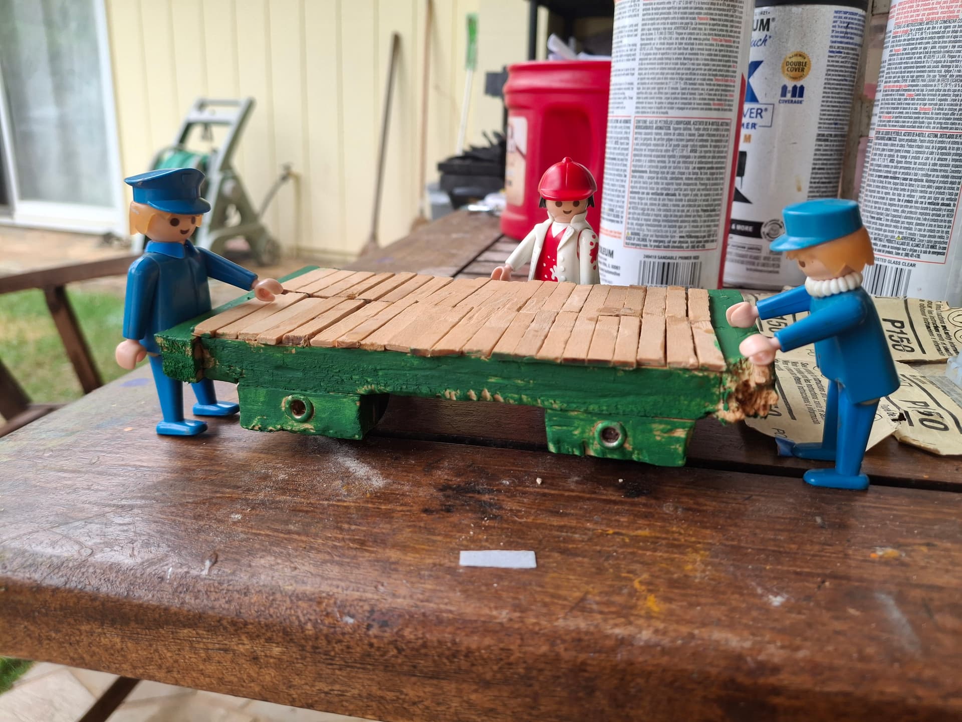

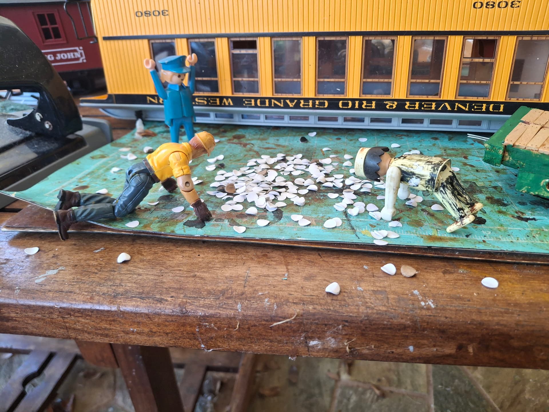

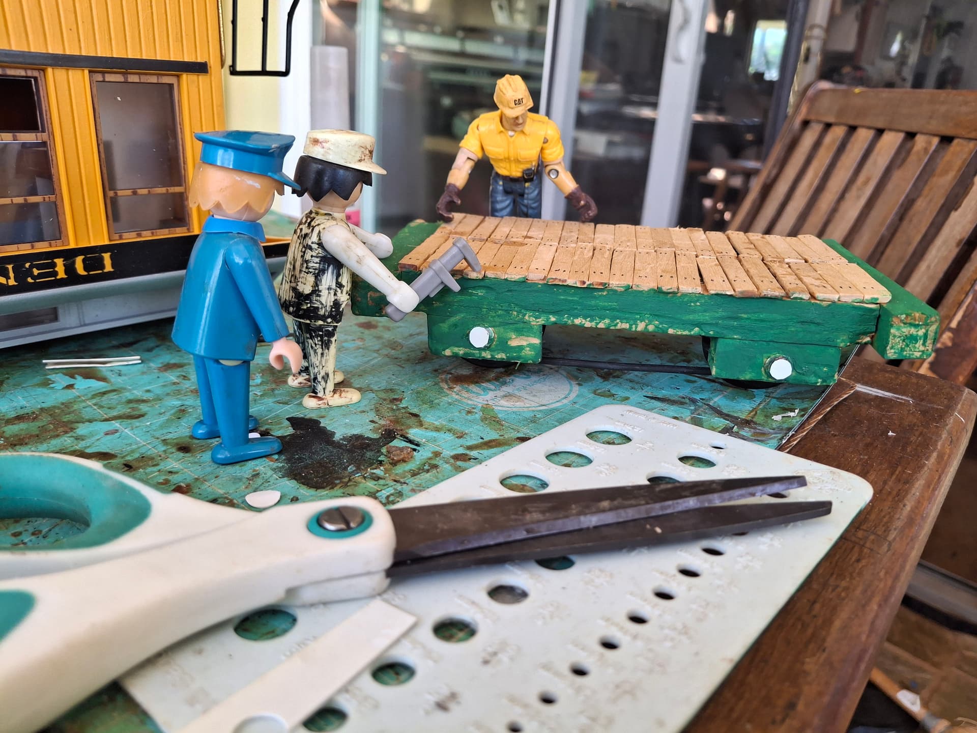

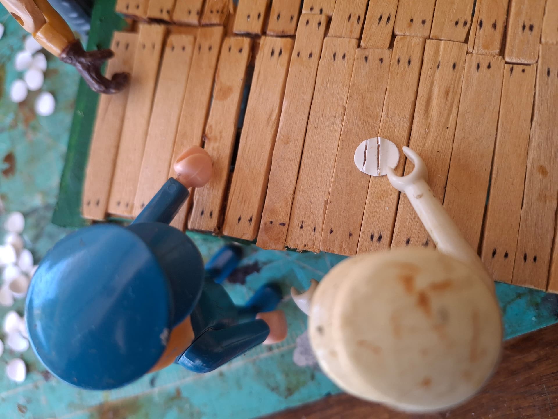

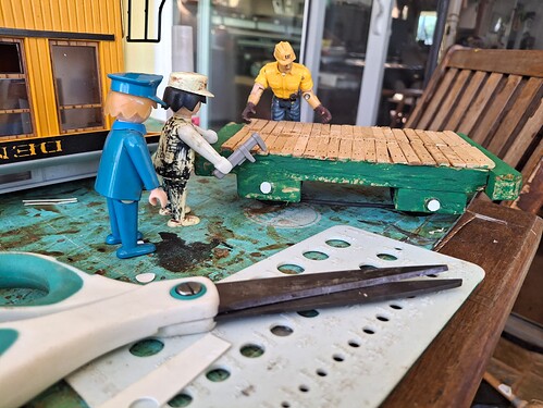

Meanwhile, the companion project, the Roman legion logistics cart to poling car transformation, lurched forward, with an attempt to punch bearing caps from styrene. First, the 1:24 gang and I learned that:
  • a.) The hole puncher should be empty of other waste.
  • b.) White styrene is virtually indistinguishable from white paper.
Then, we found the process failed, anyway…
…so we fell back on a template and sharp scissors.
A bit of black paint, and that’ll do! Next up will be some lettering and lots of weathering.

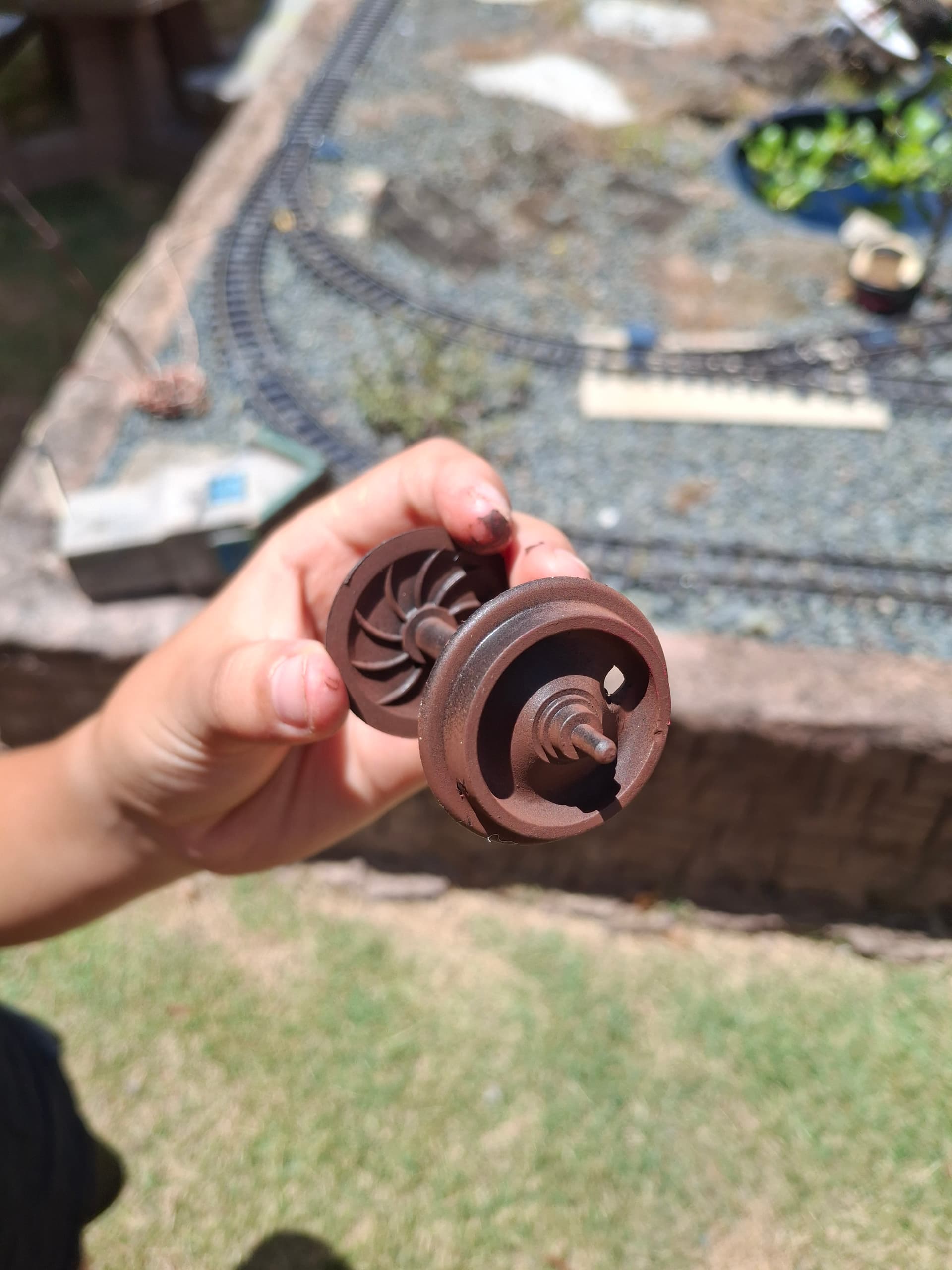

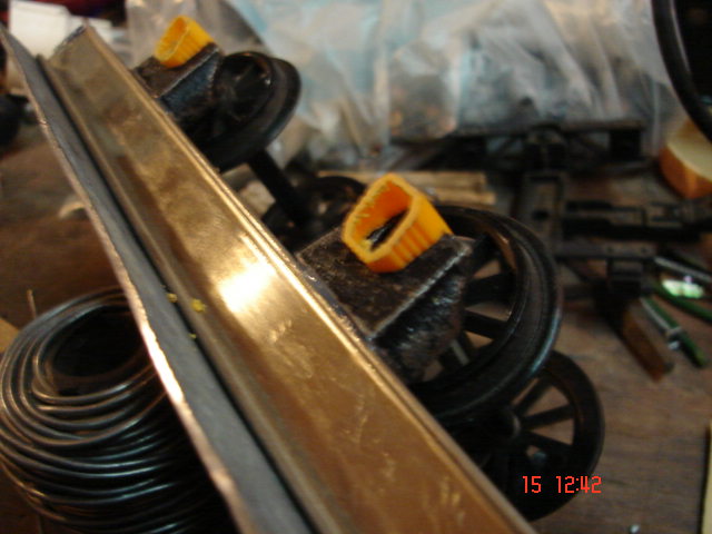

here an alternative way:
sg-tender4
using handles from BIC razors plus plastic caps
Korm,
That’s no good, the BIC plastic plugs resemble a journal bearing. That flat car needs to ride on highs peed roller bearings as represented. Paint them caps dark blue and add 3 black dots with a sharpie in a triangular pattern and call it done. Besides if the boy is shaving already he’s gonna look like a gorilla by the time he is 20!

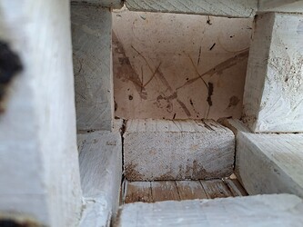

In actual work, I did seal all gaps with various outdoor grade caulking glue. Those areas that trapped water had the worst rot. Now, those pockets are filled with outdoor grade caulking glue! This means I am set to prime the core building as well as the tower supports. As this next weekend will have larger time packets, I hope to get that done, and Kid-zilla and I hope to rig the wiring.
One other item got done. I debated replacing the oversized window frames. This was our first MIK (2018!), so I opted to preserve the frames that I could and replace the parts that were too far gone with similar goofy sizes. As with other rebuilds, I have opted to make preserving the builders’ intent as part of the desired outcome of this project.

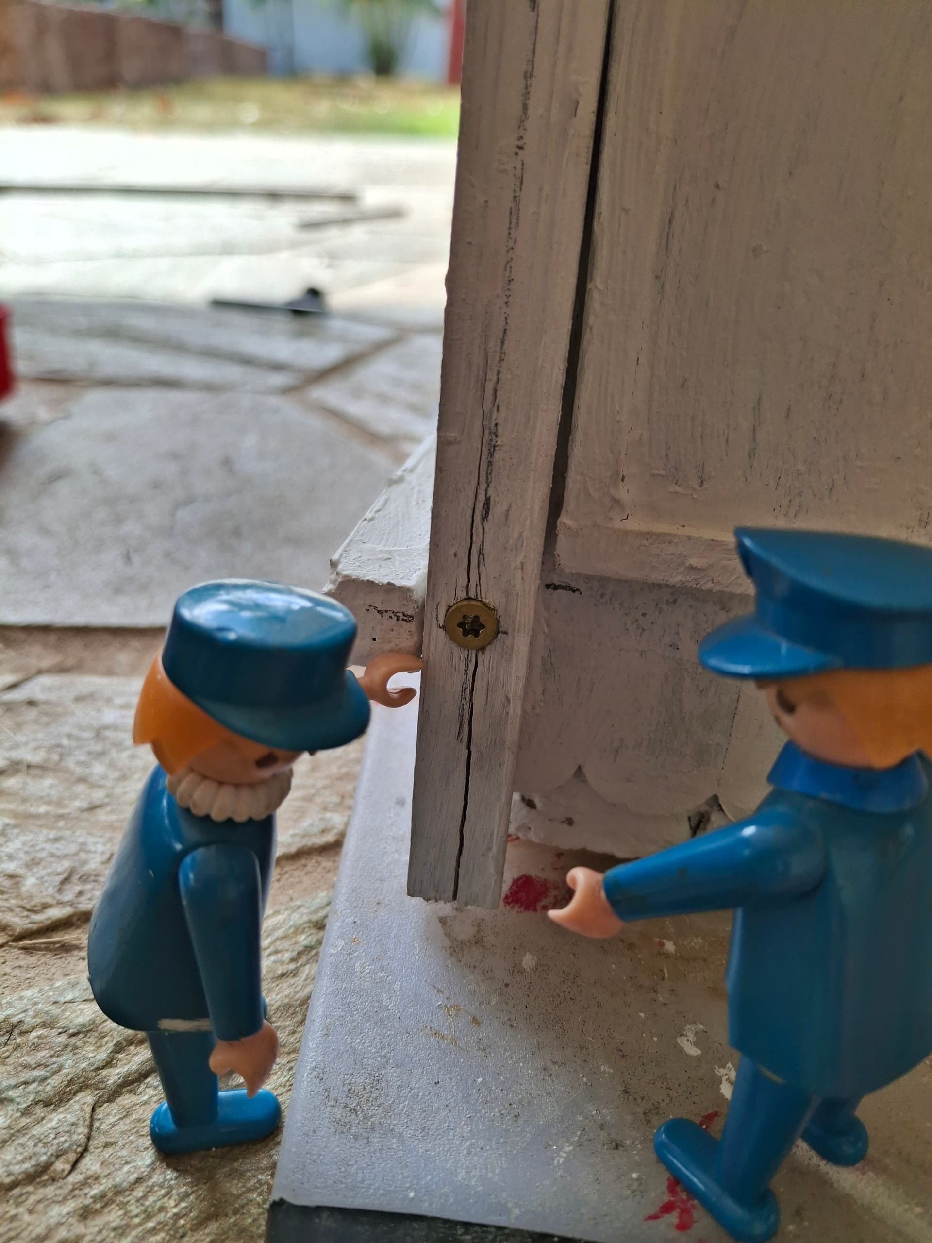

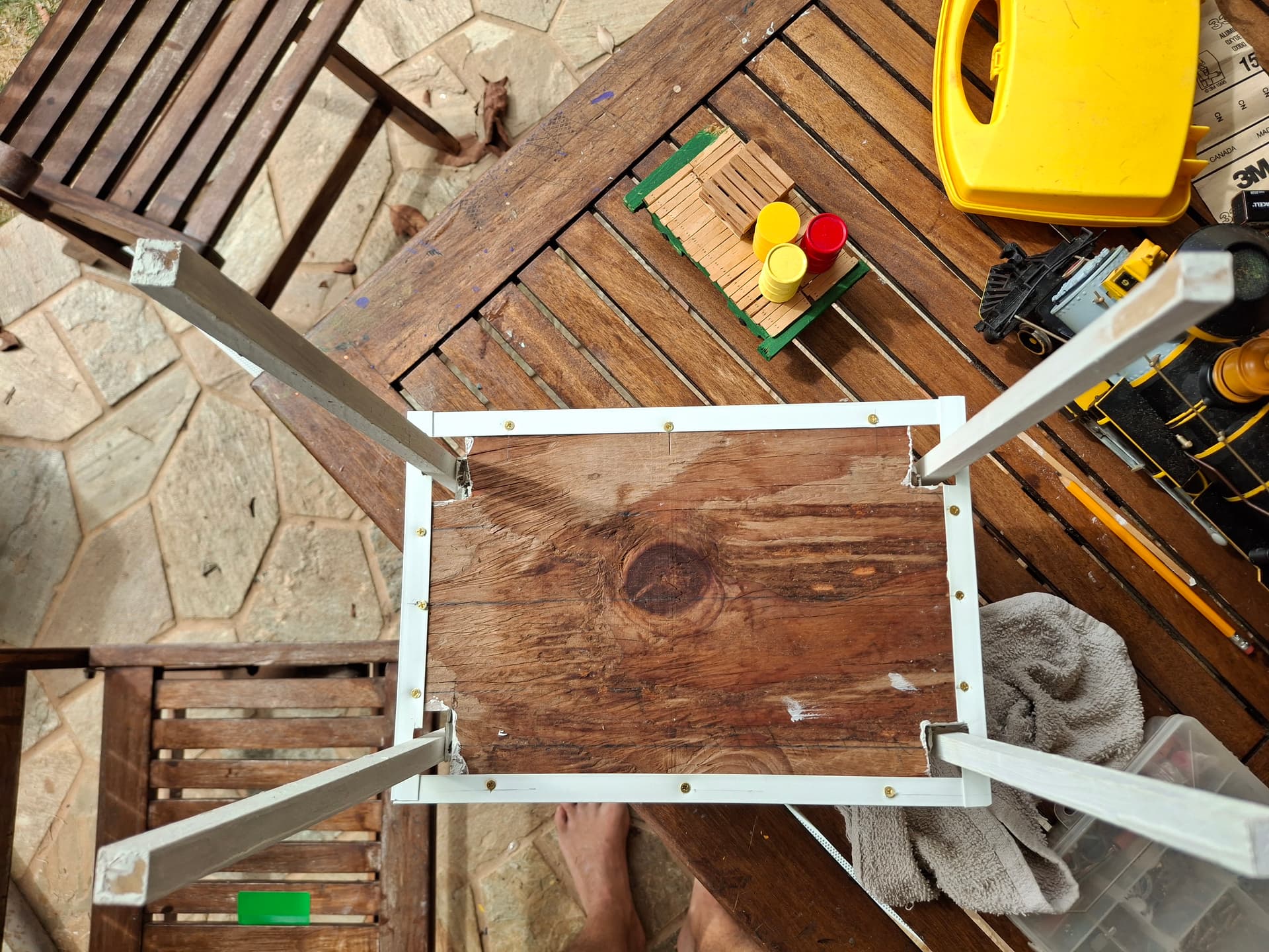

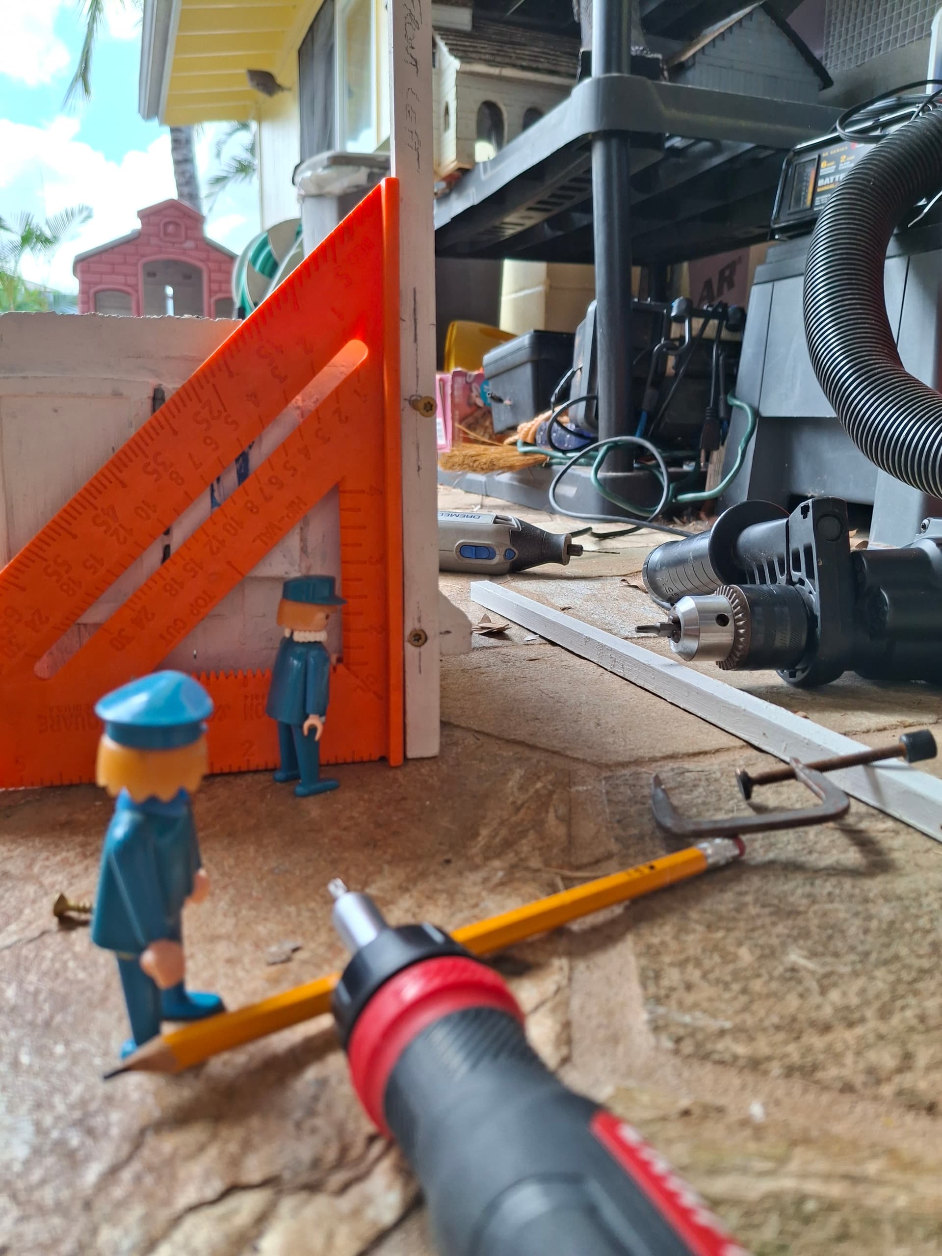

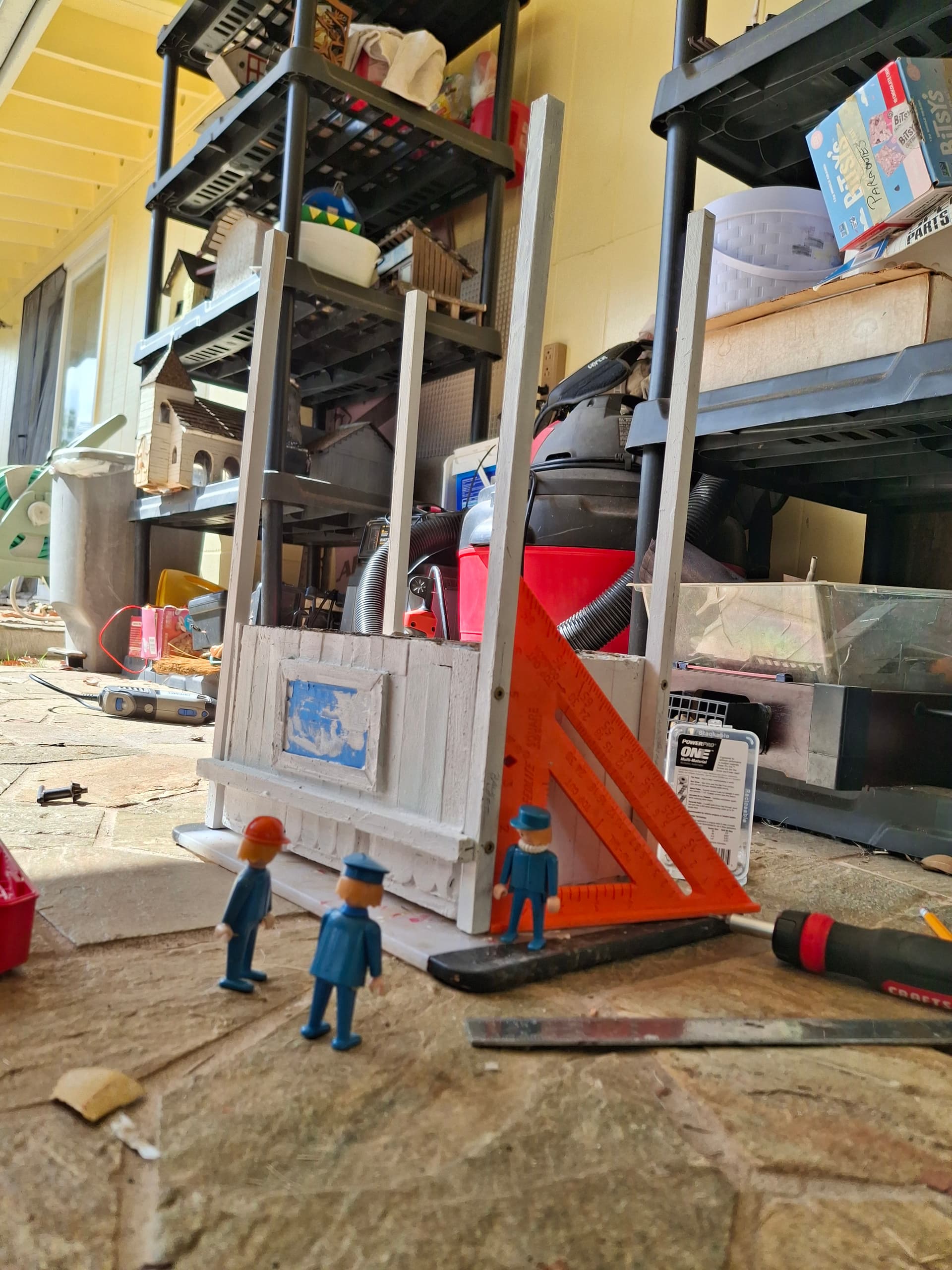

I had previously marked where I’d drill tap holes for the tower supports. The 1:24 gang wisely checked my measurements.
Again, I elected to screw these in place rather than glue them for both durability and replaceability. The originals snapped multiple times over the years.
Despite my far-from-vertical tap holes (I need to get one of those Dremel stands!), the crew got the beams in place.
One did split…
…but it was nothing some TiteBond III and clamps couldn’t fix.
In short order, all four were in place.

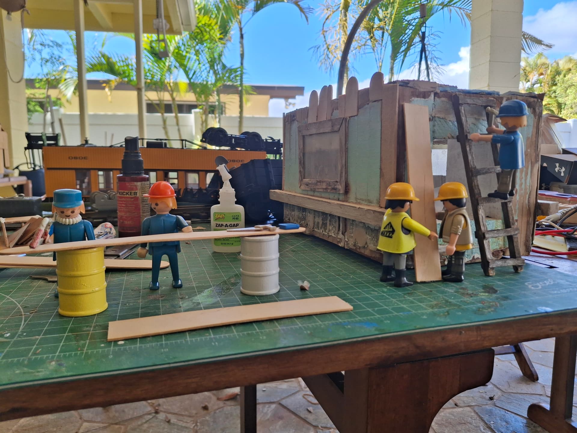

The 1:24 “digger men” and I had the lanai to ourselves. It was time to address the roof.

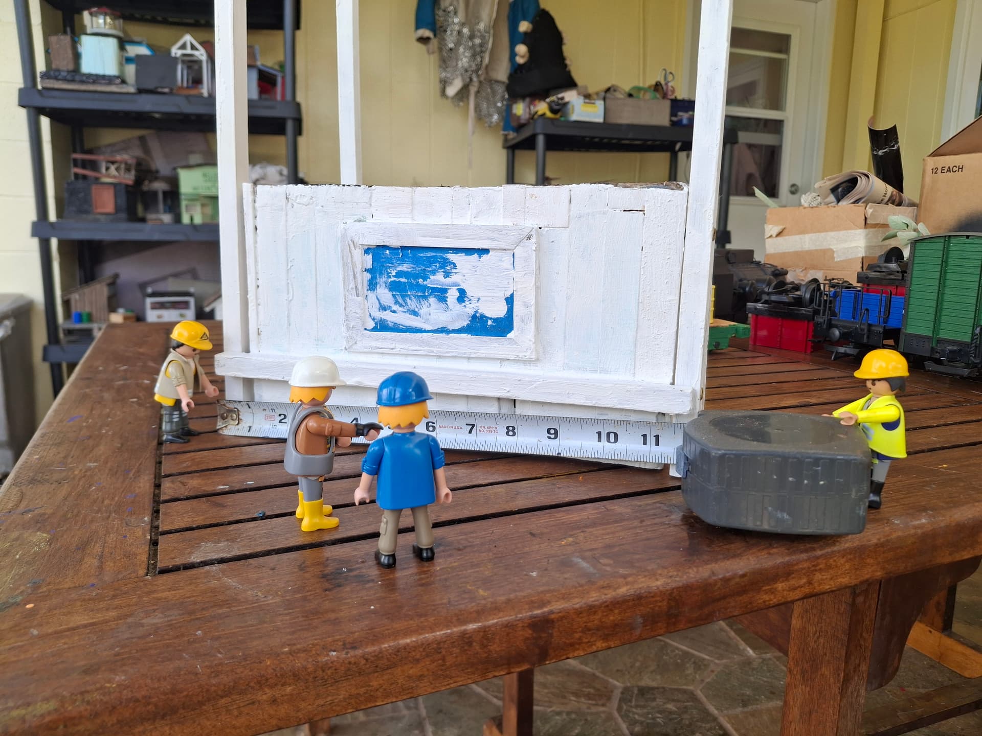

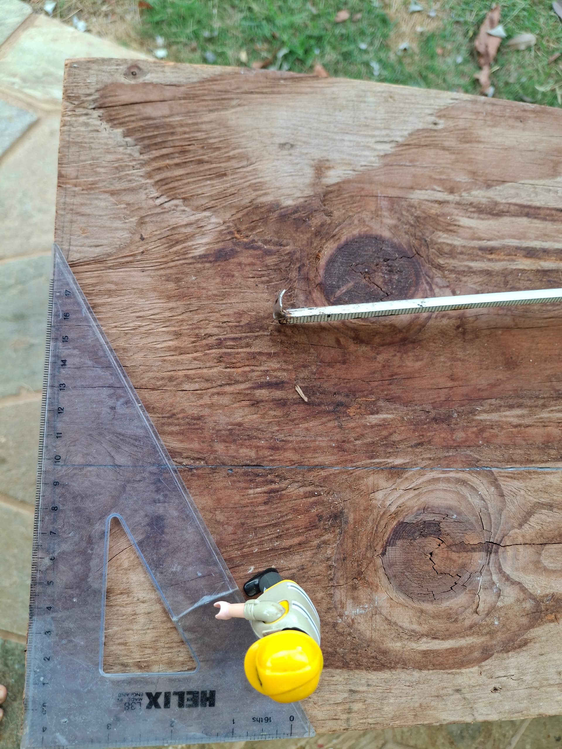

There were, of course, careful measurements…
…followed by a check to make sure the chosen timber was square-ish.

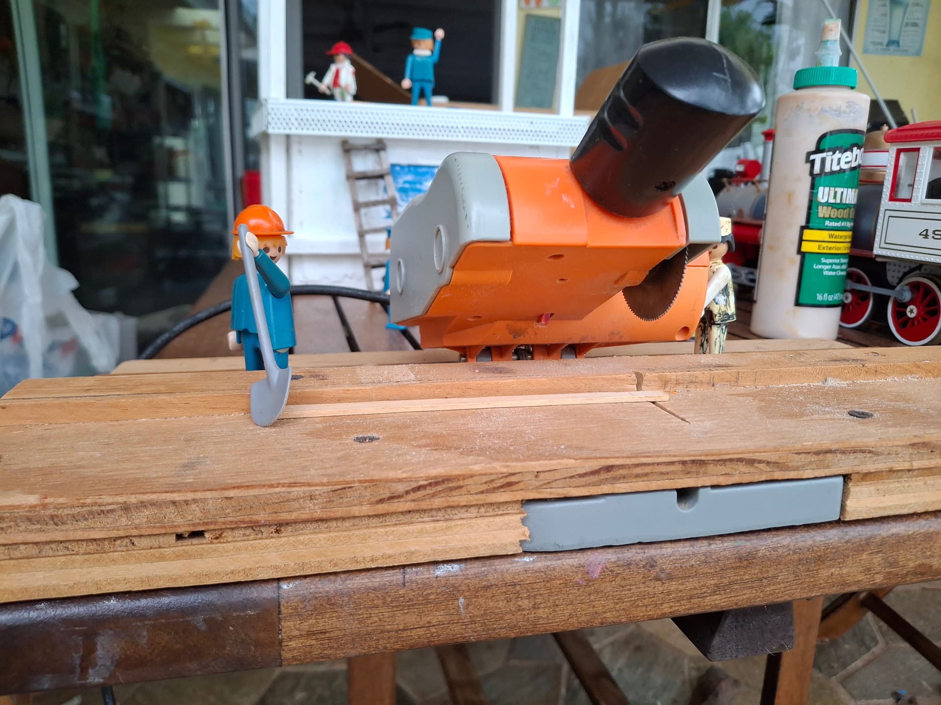

Afterwards, I elected to challenge Jig Saw to battle, so the 1:24 lads clamped the board to the table and prepped Jig Saw
We did position the building on the board before cutting, and, after adjusting the cut lines a bit, set to. BEHOLD! A not awful cut!

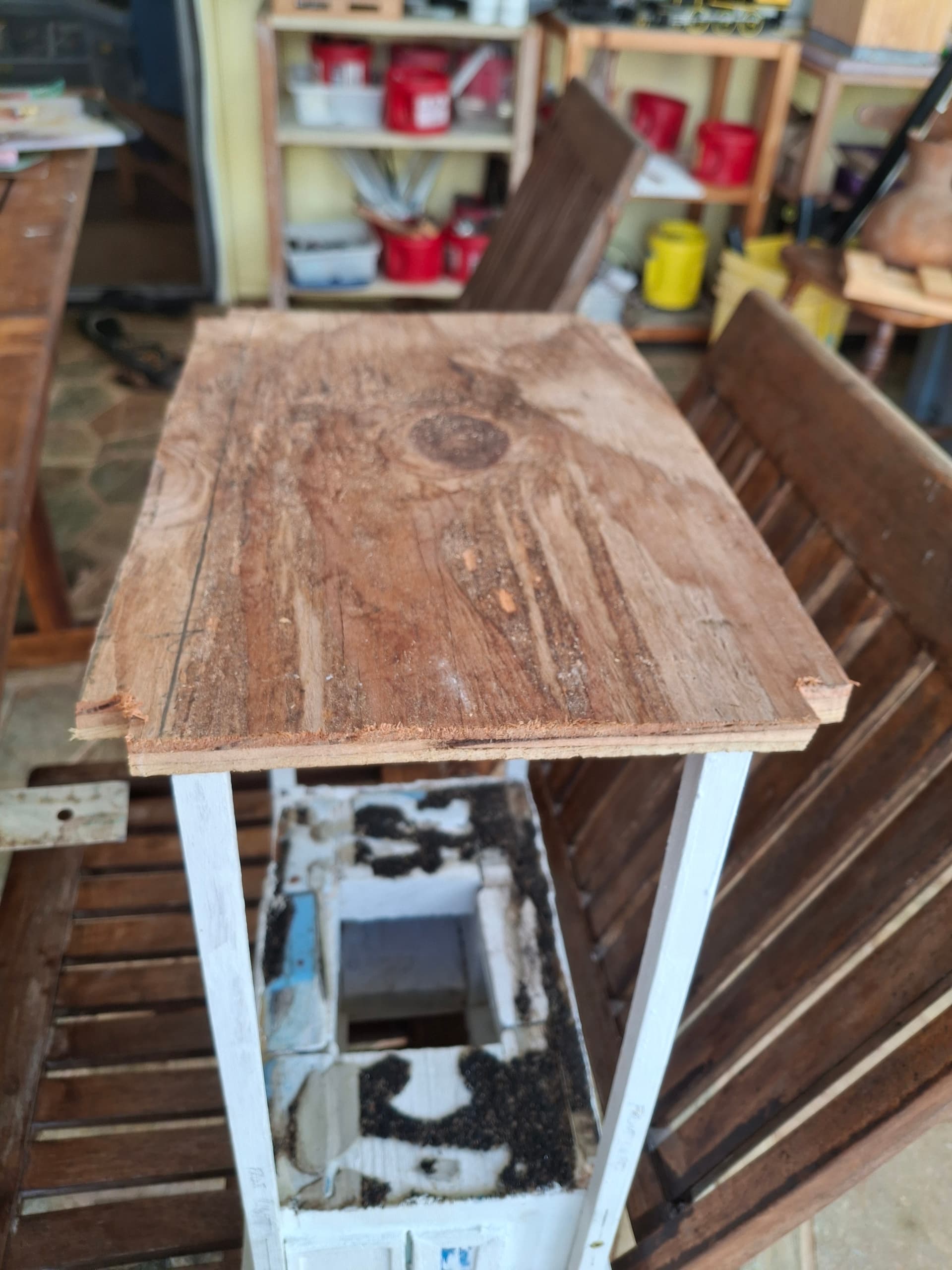

I offset this nominal success by absolutely tubing some measurement or another.
Enlarging the notches to clear the beams left some pretty big gaps.

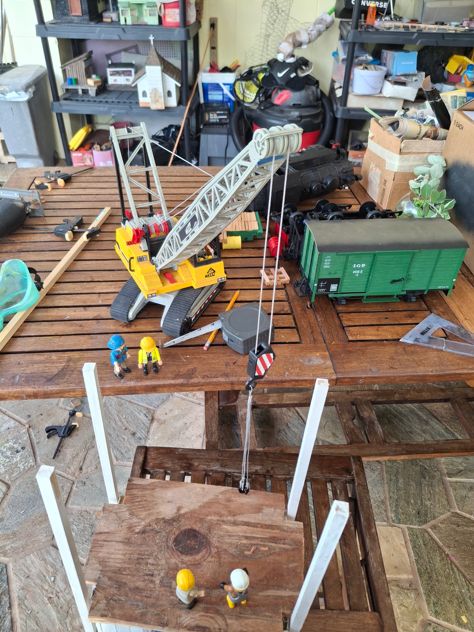

So at that point, I cut the crew loose to have a think. First, I remembered my design elements:
  1. Sturdy enough to hold the electrical switches.
  2. Removable so I could fix and replace wiring.
    Thinking produced no answers, so I went to replacing broken couplers (broke parts sorted and stashed for future projects, just not a functioning couplers! The Triple O wastes nothing!). This let me end the session on a high note.

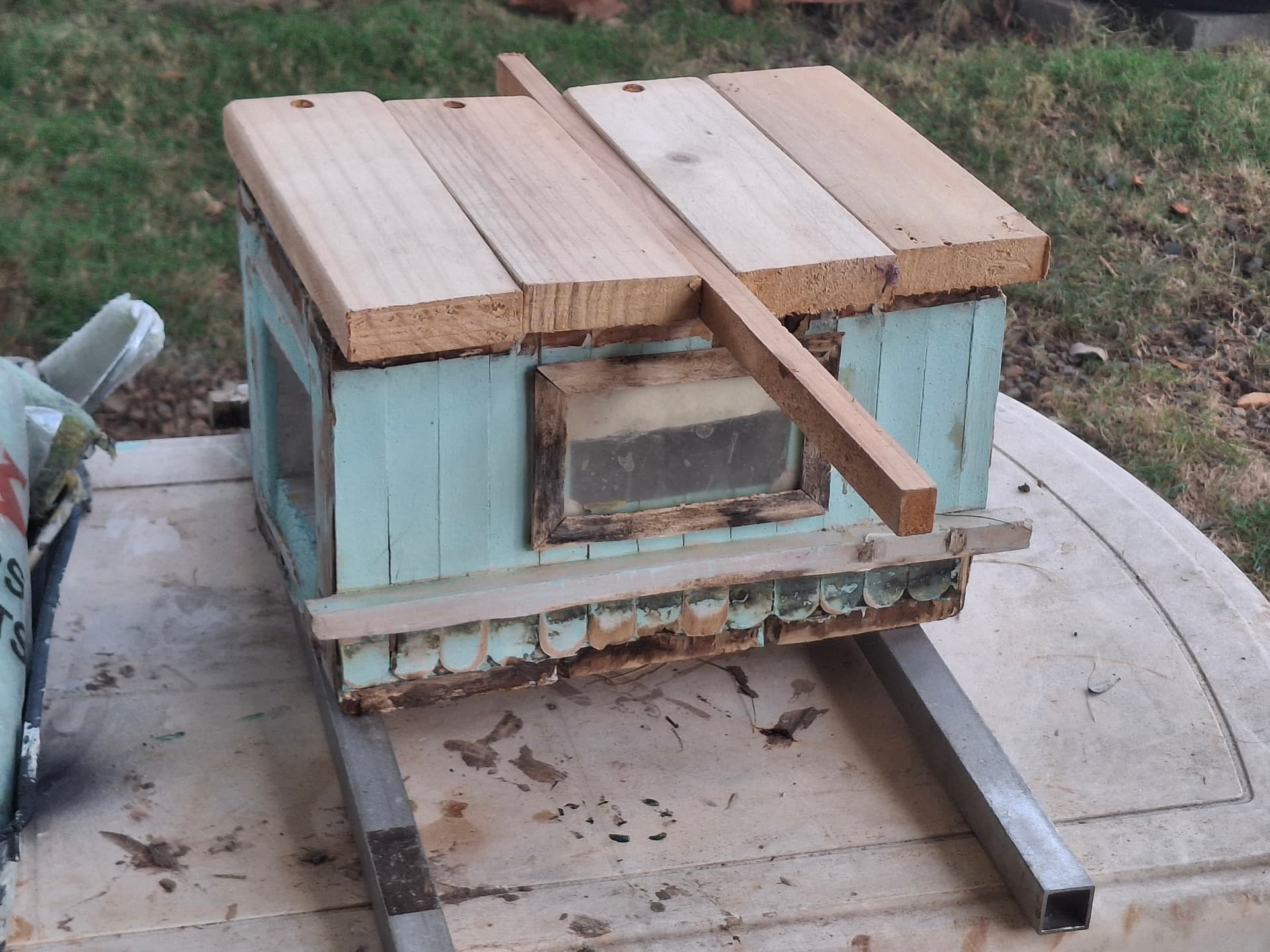

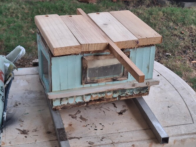

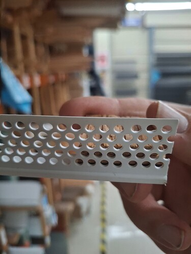

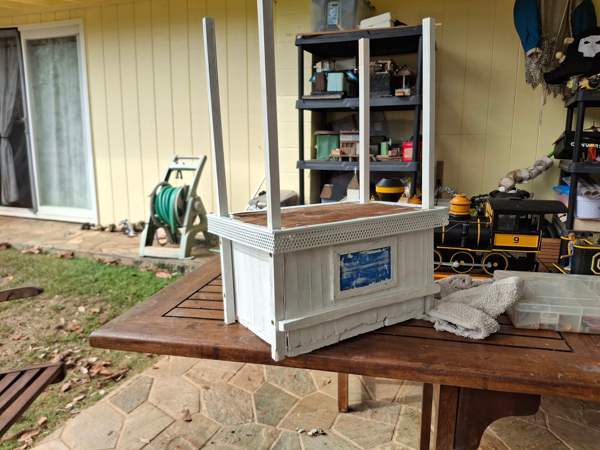

A trip to the hardware store later that day may have provided a solution. I found this in the moulding section.
There is a solid plastic lip I could secure to the roof with screws. The lattice would hide the rough edges of the plywood and be sort of decorative. Some crafstick decking could at least minimize and regularize the gap near the beams, while leaving enough space to wiggle the roof off if need be.
Hmmmm…Open to suggestions, but I think this may be my way forward. It should work, and it will land this project back where it started, functional yet whimsical.
Update:
That plastic molding thing worked pretty well! It cut easily, and it hides mistakes from 7 years ago and mistakes from 7 days ago equally well.
Next up is some craft stick decking, a few more external “braces,” and the wiring! I am in my happy place again in terms of tools, materials, and techniques! Yay!

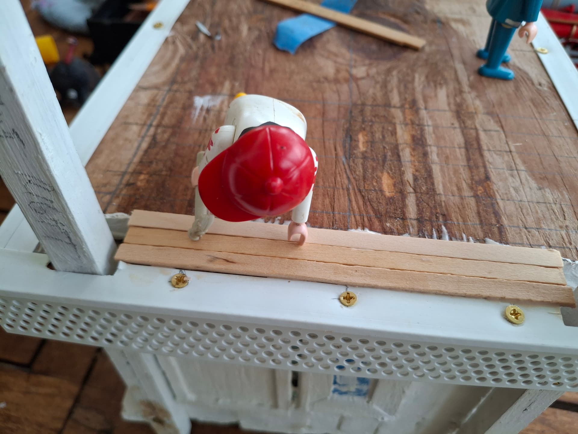

Update:

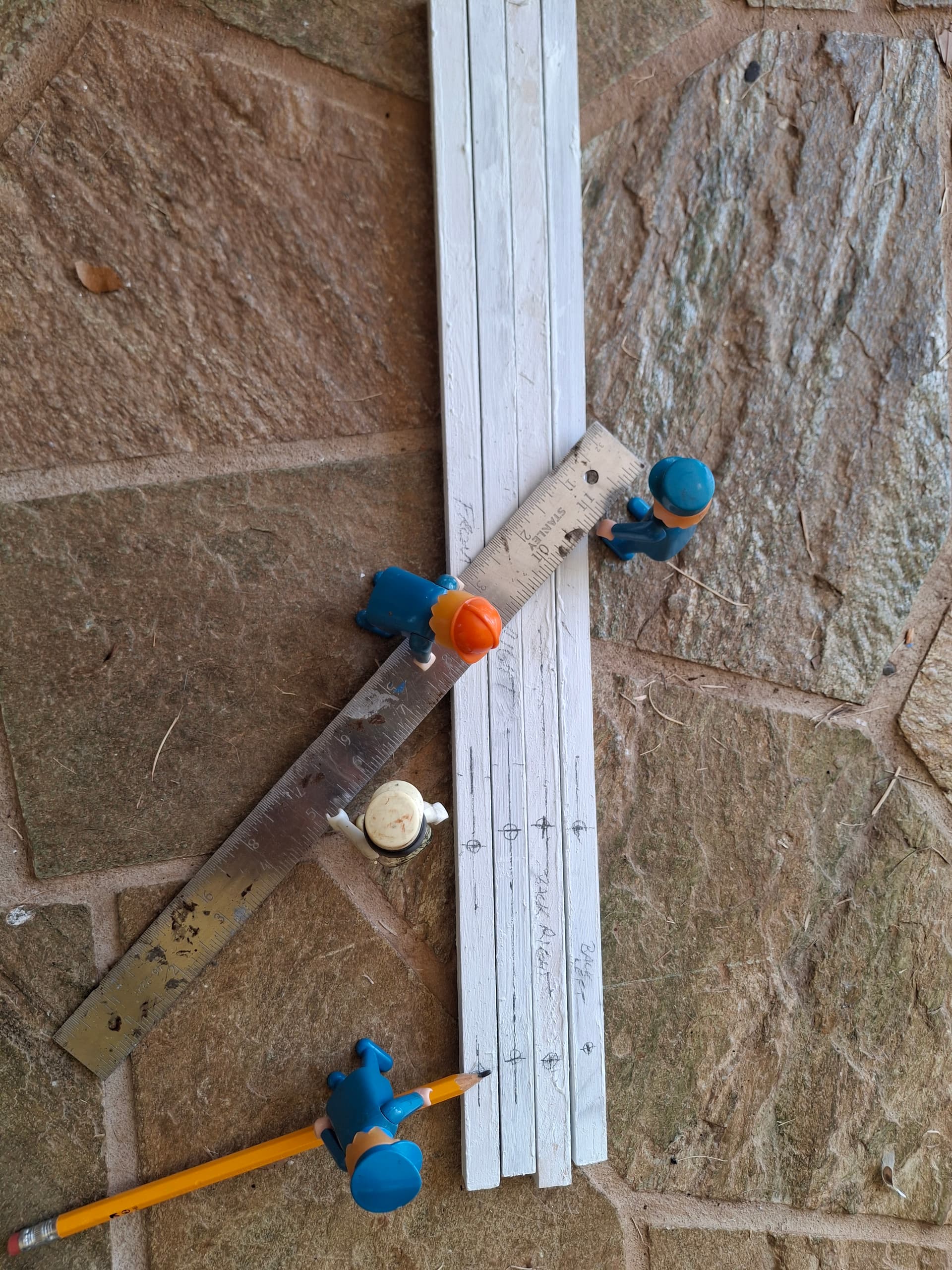

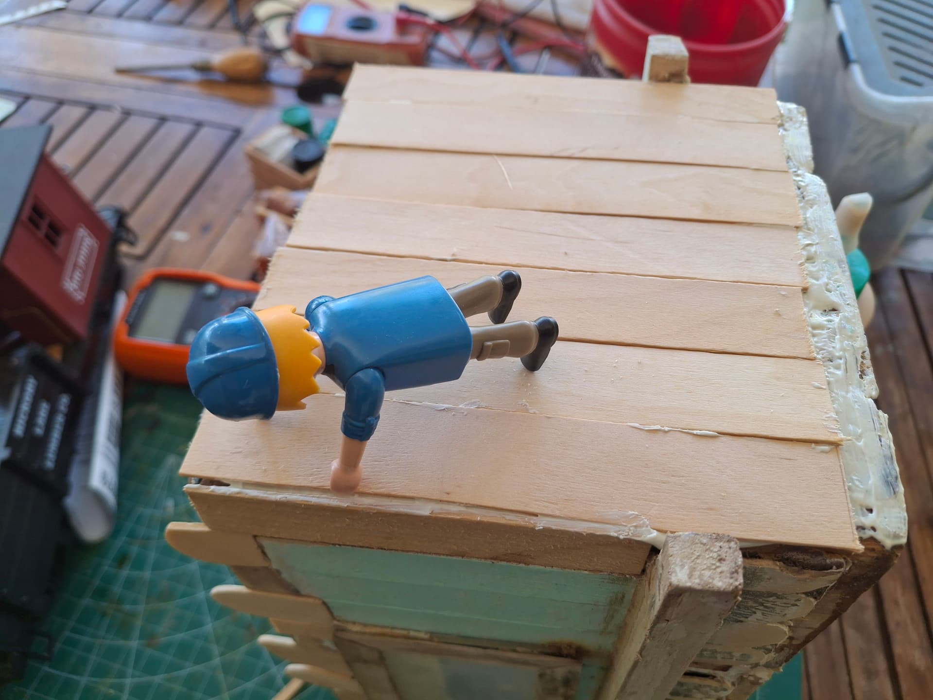

In between a myriad of other activities last weekend, the 1:24 gang and I began to turn the plywood into a roof. I am in my “happy place” of craftsticks, TiteBond III, and various cutters. The crew and I quickly measured and cut the “timber.”
Then we made it fast with TiteBond III. I have tried to eyeball this sort of thing before, only to have alternative perpendicular angles, so this time I drew a bunch of guidelines before commencing Operation CUT’N STICK.
I have what I need to plank the roof over the week when and as I get time. The goal is to stain his weekend so it can dry it while I dig out the electrical stuff that I bought. I am going more slowly than usual to make sure that I don’t do something that will preclude access to the wiring later if repairs are necessary. The plan is to fix this a Hardiebacker base to facilitate moving it on and off the railroad, so that roof doe have to slide open.
