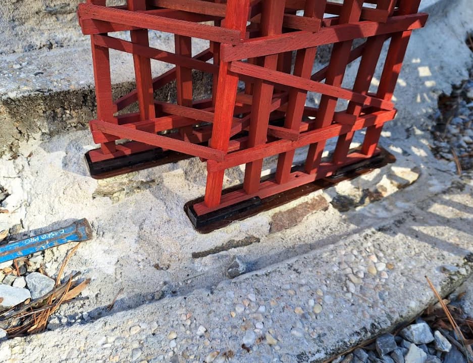

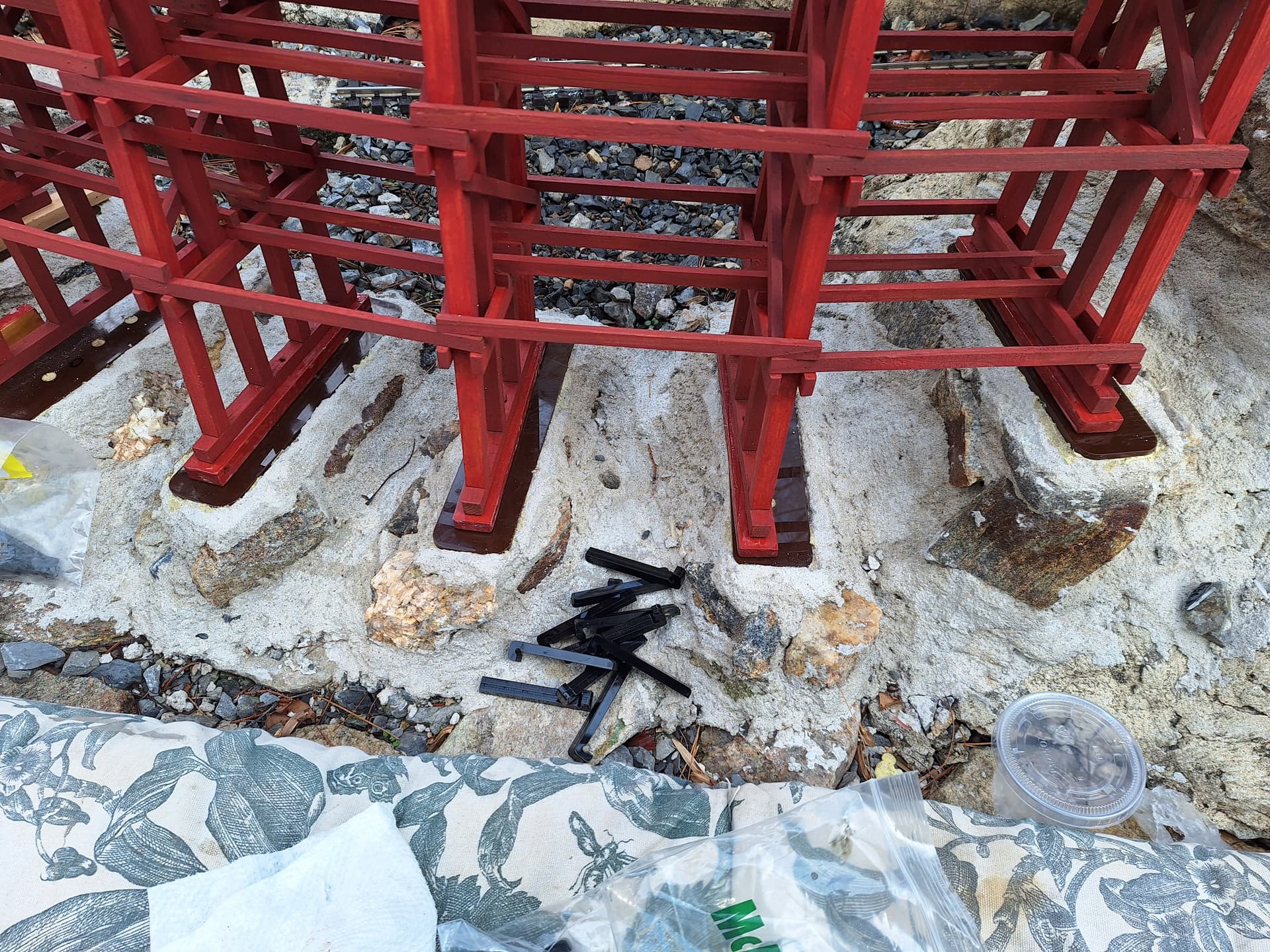

Yesterday morning I worked on shimming and positioning the trestle, trying to find the sweet spot where most of the bents were centered on their piers, with the rails lining up. It’s as bad as I feared; but nothing a load of gravel can’t cover. :grin:
There’s a 1/2" thick base block for each pier, and yesterday I thought I’d be diving into sanding them to deal with the vertical tolerances of the pier concrete. What I didn’t expect to see was that all the end piers were like 1/4" to 5/16" too high, making me think there were flaws in the plywood spine used to set the heights for those.

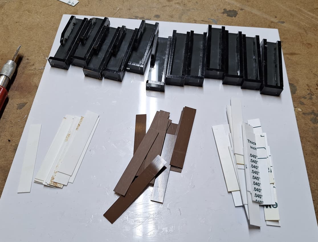

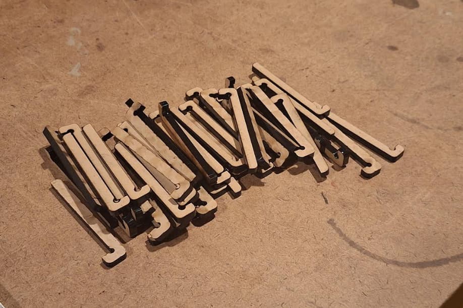

Regardless of the cause, and long story short, I didn’t want to have 3/16" cedar as the base for bents, so I lasered a bunch of little boxes out of acrylic, and cut a bunch of varying-thickness styrene sheet for shims to be placed in them.
These boxes took the place of the intended 1/2" thick base blocks for 4 end bents where the piers were too high.
For both ends of the bottom sill if these bents I fiddled with the shims until the bent was solidly rested. Then I took the boxes loose shims out, glued the shims into the box, applied cement to the bottom of the box, and slid the box under the bent’s lower sill. Here’s two of the nicer outcomes.
All the in-between bents were within range for Plan A. For each of these, I sanded the base block if needed, sometimes several times, until all of the bents were seated firmly on their piers.
I removed those base blocks and stained them. They (and eventually the bottom sills of the other bents) will get a coat of marine epoxy. They’ll be locked laterally onto their piers with little plex L pieces.
I’m waiting on marine epoxy and more acrylic cement. And there’s rain tomorrow, so I’ll pick up during the week or next weekend.
After all this is done, it’s a (hopefully!) only matter of tying in of the rails, and placing a couple anchors. But it’s been cold out (just above freezing this morning). So I’ve decided to push certain related cosmetic issues until the spring or later, and call this project done once I get the rails connected and make a video of a loco running across the thang.

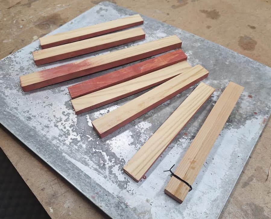

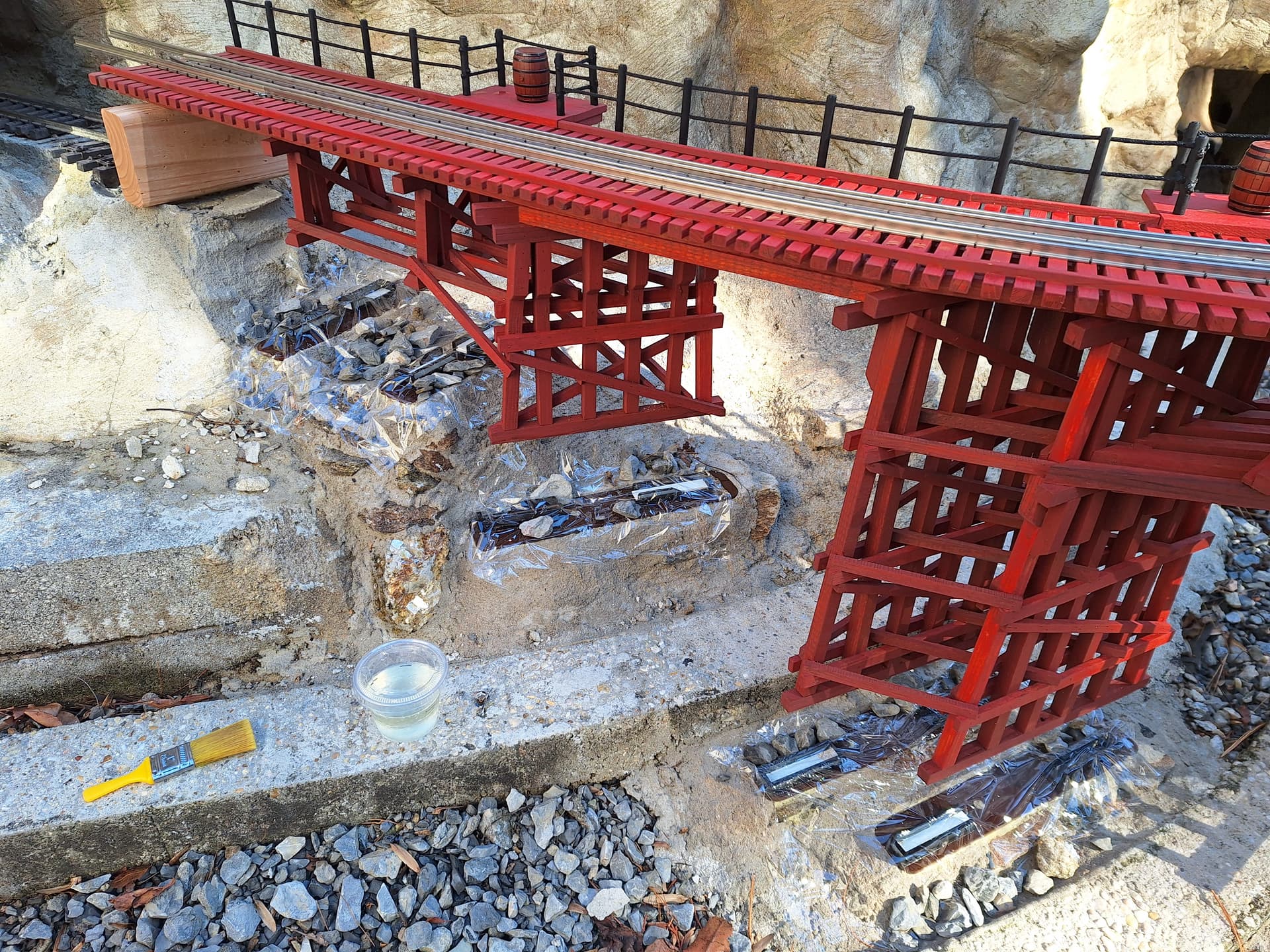

Over the week, when the weather was ok, I finished coating the bottoms of the end bents with marine epoxy (thanks Jerry B. for the tip). Basically blocked the whole thing up, brushed on poxy and lowered it onto plastic cling wrap.
Also gave a few coats of the same to the base blocks of the main bents.
With all that dry, and the snow starting to melt, I went out this morning to hopefully get things finished.
After peeling off the cling wrap, the main thing was sliding the blocks in, sometimes with a bit more sanding, and then cementing down their corner holder thingies.

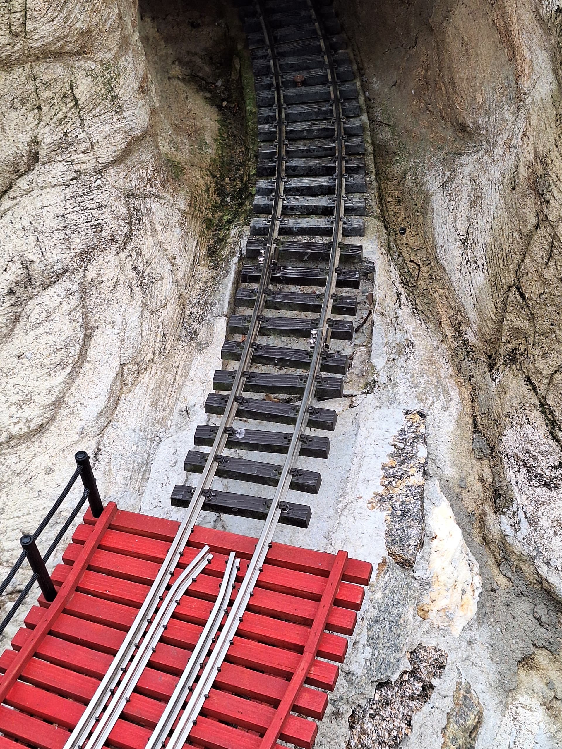

All that’s done, yay. Next was cutting and tying in the rail, which went smoothly.

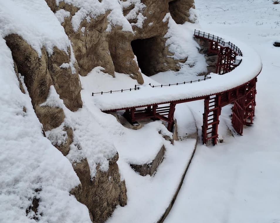

Lots of aesthetic finishing up, but that’s for the spring. So I’m calling this done. And to put a fork in it, here’s its maiden voyage, starring Bruce’s shay and Frothingslosh car.

ignoring the bridge - i like, how natural the partial snowcover upon these mountains looks.
Thanks Korm, I worked hard on that. :crazy_face:
But yeah, it’s fun to see. And unlike the HO / indoor guys, it’s real!

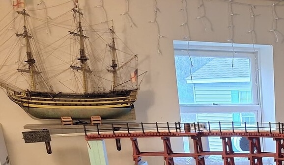

Cliff, I’ve been thinking that 42 years is a long time for this amazing ship to be left in dry dock. So, now that you’ve pretty much wrapped up the trestle build, you truely possess all the necessary skills to tackle the next obvious project: the construction of the much anticipated pier in the port of Virginia City.
All we need now is to unearth a plausible backstory about the pivotal role the HMS Victory played in the Battle of the High Sierras¹. Surely there are enough Bovofaecologists² lurking on this thread who can contribute their “expert knowledge” to assist you in this aspect of the project.
I’m particularly confident Vic can fill us in on the ill fated HMS Victory/Sasquatch encounter, especially after he enticed all of us (me) to stream Sasquatch Sunset. I also suspect when the movie rights are sold, Bruce and Todd will both be itching to lend a giant hand in developing the GHA protocol for high winds and stormy seas. Don’t forget just mentioning David Marconi’s involvement will certainly add a bit of Hollywood flair. :grinning:
The more I think about it, the more I think you could receive a grant to make this an official ShedOps-2026 project. (Probably from Linda who just wants her craft room back.)

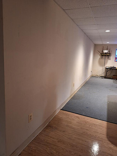

Bill, a bit of update. Referring to your (fairly amazing) response to my photo of “the Victory on the trestle”…
I’m afraid to report that the entire setting is being systematically cleared for a basement makeover.
No trestle, and HMS will travel to a port yet TBD.

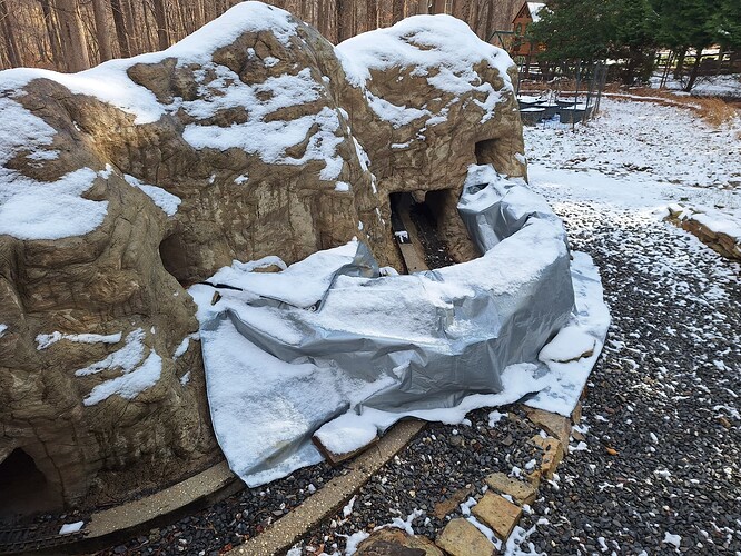

However, the trestle is doing fine on its own, enjoying the nice warm jacket aquired this morning.

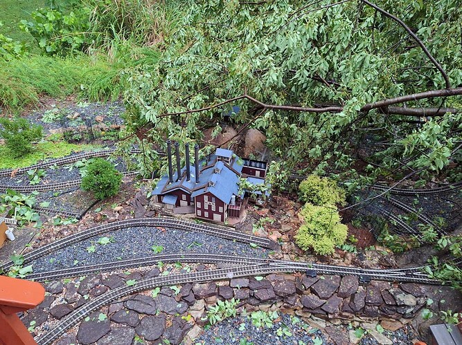

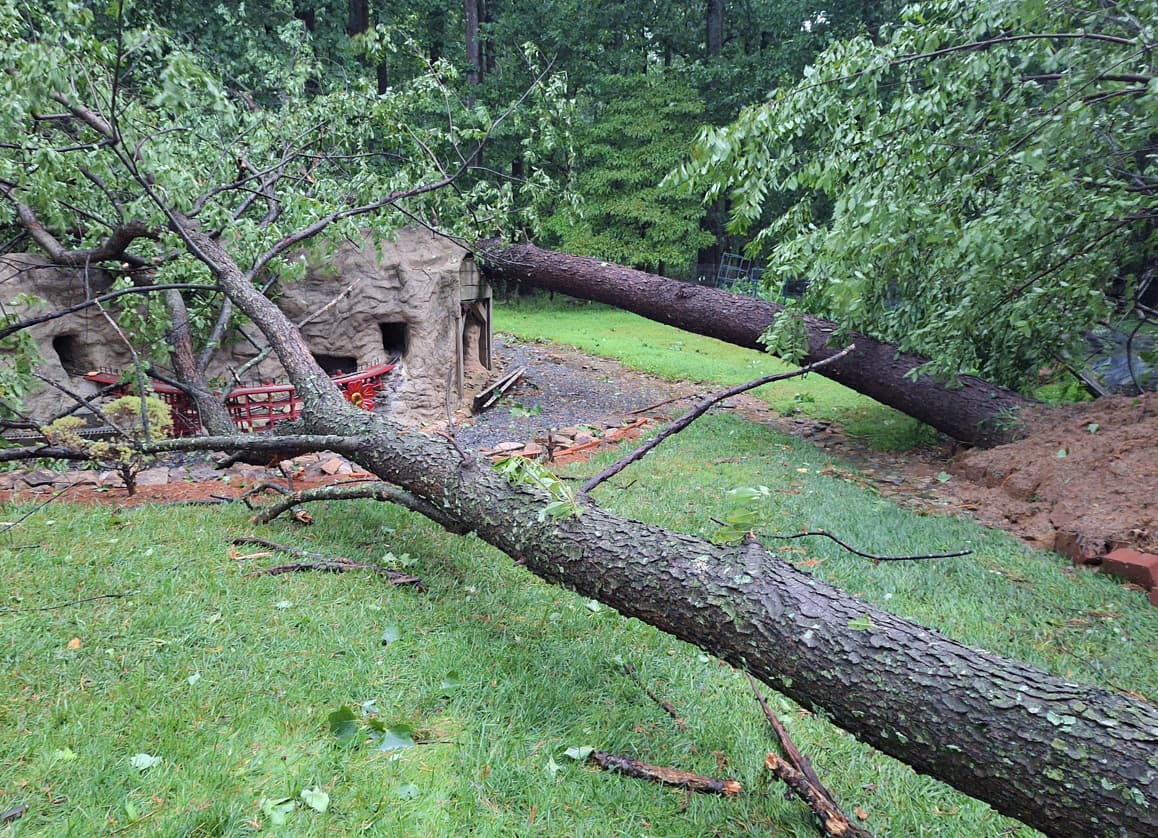

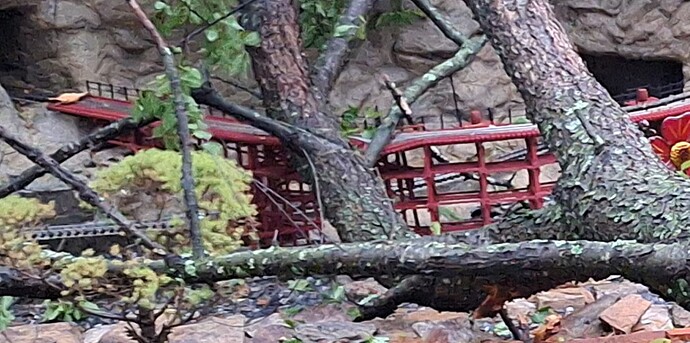

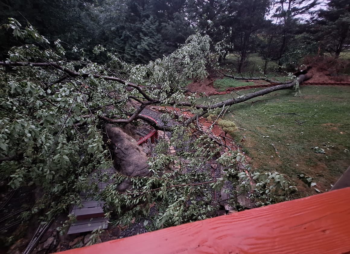

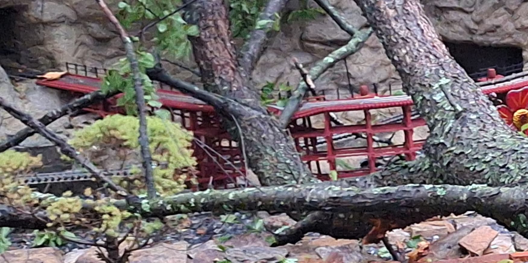

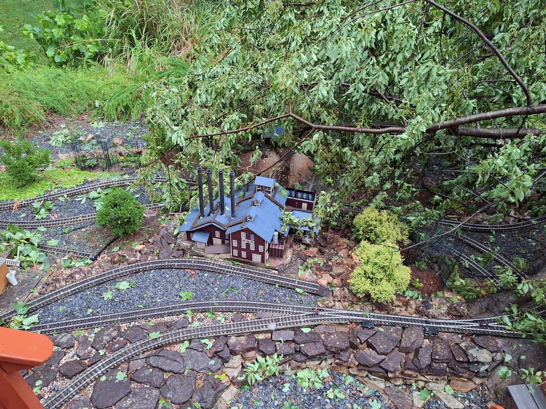

Some sad trestle news from last evening. Big storm came in, with very heavy gusts that took two trees out. One landed some on the trestle and my main structure, the H&N Mine.
Looks like most of the trestle survived but it took a serious karate chop in the middle.
Tree removal estimate is coming later today or tomorrow, and after it’s taken out I’ll be able to see the extent of damage.
Hmmm That’ll buff out ! :wink:
