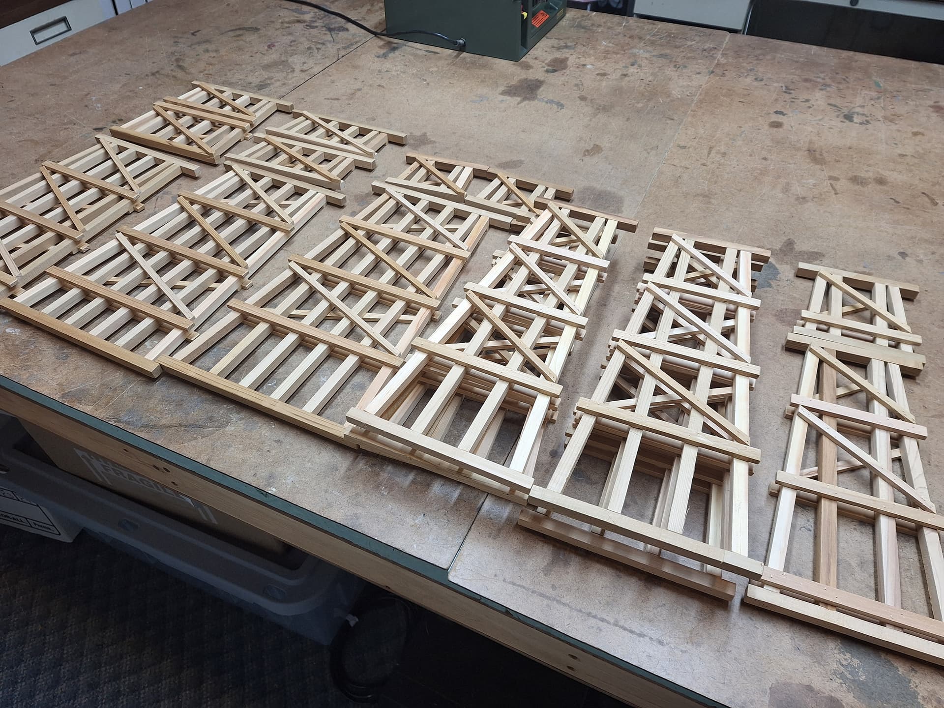

I finished the pressure washing and general cleanup this morning, and should be ready to make bents.
I call this weathering method “tasteful algae blending.” :grin:

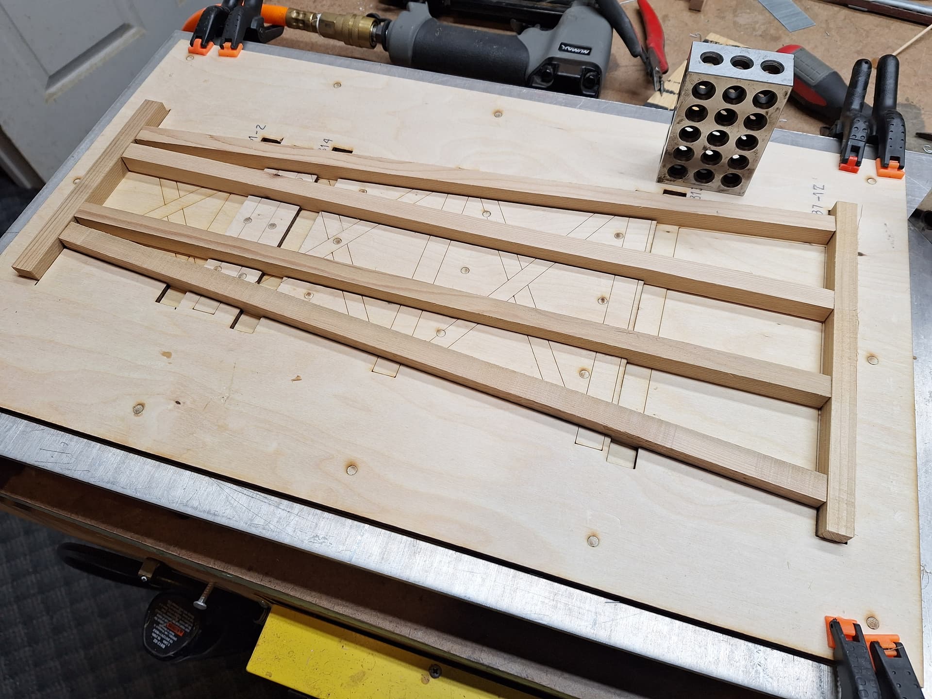

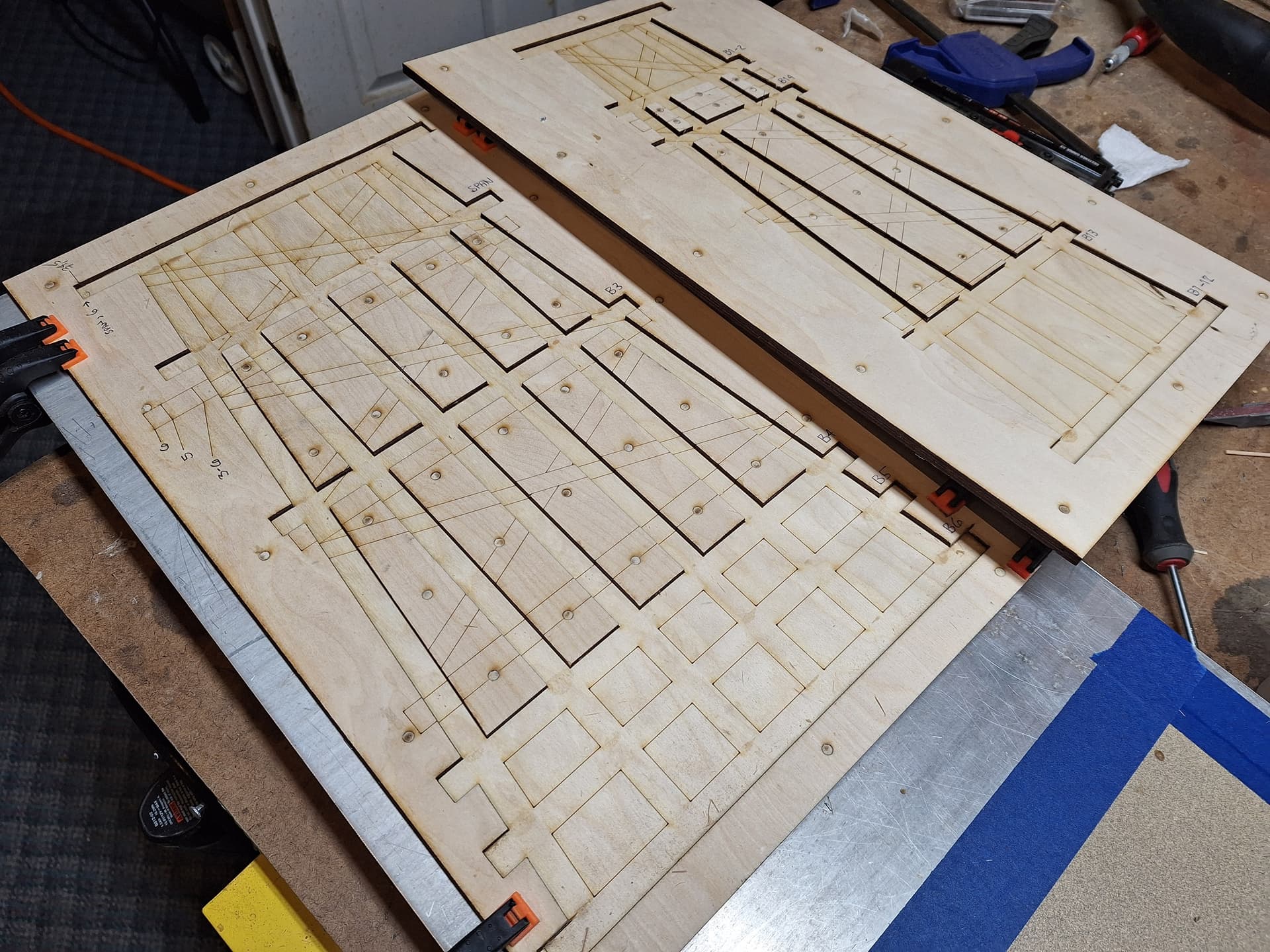

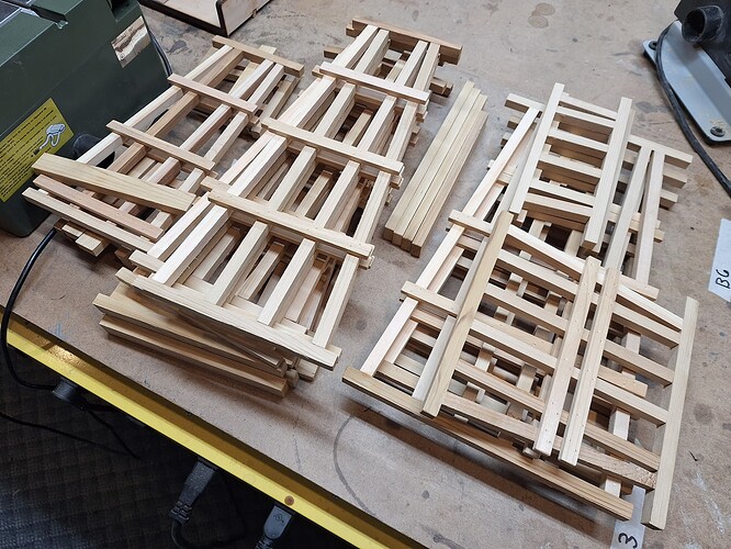

Last Sunday I pre-cut the bent pieces, and during the week made the new bent templates, since there was too much redesign to salvage the ones I’d made a few years back. No big deal though. I had some 1/8" plywood leftover from a project, and only needed the two templates.
A bent underway…
… and all main bent structures done.
Tomorrow I’ll hopefully add the diagonals and set up for the deck build.
That’ll be it for at least a week, since Tuesday I leave for Carson City for the annual V&T conference. Gosh I’ve been looking forward to this trip for months…
Diagonal bracing’s done, and that’s it for this weekend.
Cliff how did you make your jigs?
Bill, the linework came from the 3D model, and was prepped in AutoCAD. Then it went into the laser, which cut / engraved the 1/8" plywood.

No, Bill, nothing that complicated. The jigs could be done many ways, but I’m lazy.
All the pieces were cut on the little mini table saw.

Cliff, what are these markings for?
Bill, if I’m understanding your arrows, those are the pegs holding the two layers of jig together.
they are Cliff-pegs.
anybody else would have used a handfull of nails… :grin:

In my defense, and at the risk of sounding defensive ( :grin: ), since the plywood is only 1/8th thick, I stayed with my usual method of pegs (vs. nails).
The pegs are bits of bamboo food skewers, tapped into slightly undersized holes which are lasered along with everything else. That ensures proper registration, and a firm grip without glue in case I needed to alter anything. But I glued it anyway, couldn’t help it.
