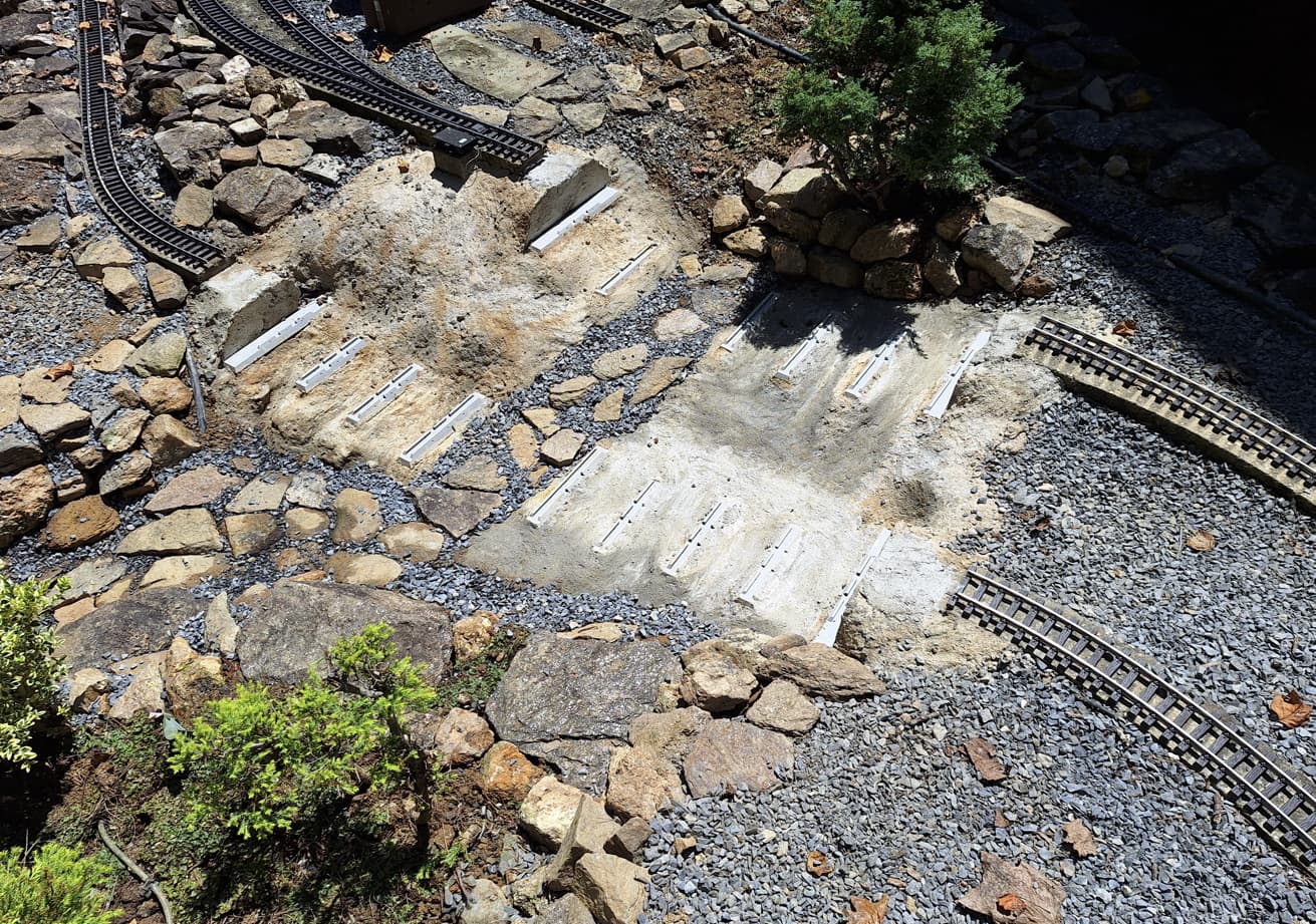

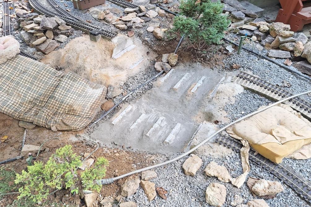

Hi Neil, yes those slots looked a bit dramatic, as I was digging out a bit extra for the mortar to bite. Here’s the “finished” product.
Nothing like the slots in Vegas though. I can’t help myself…

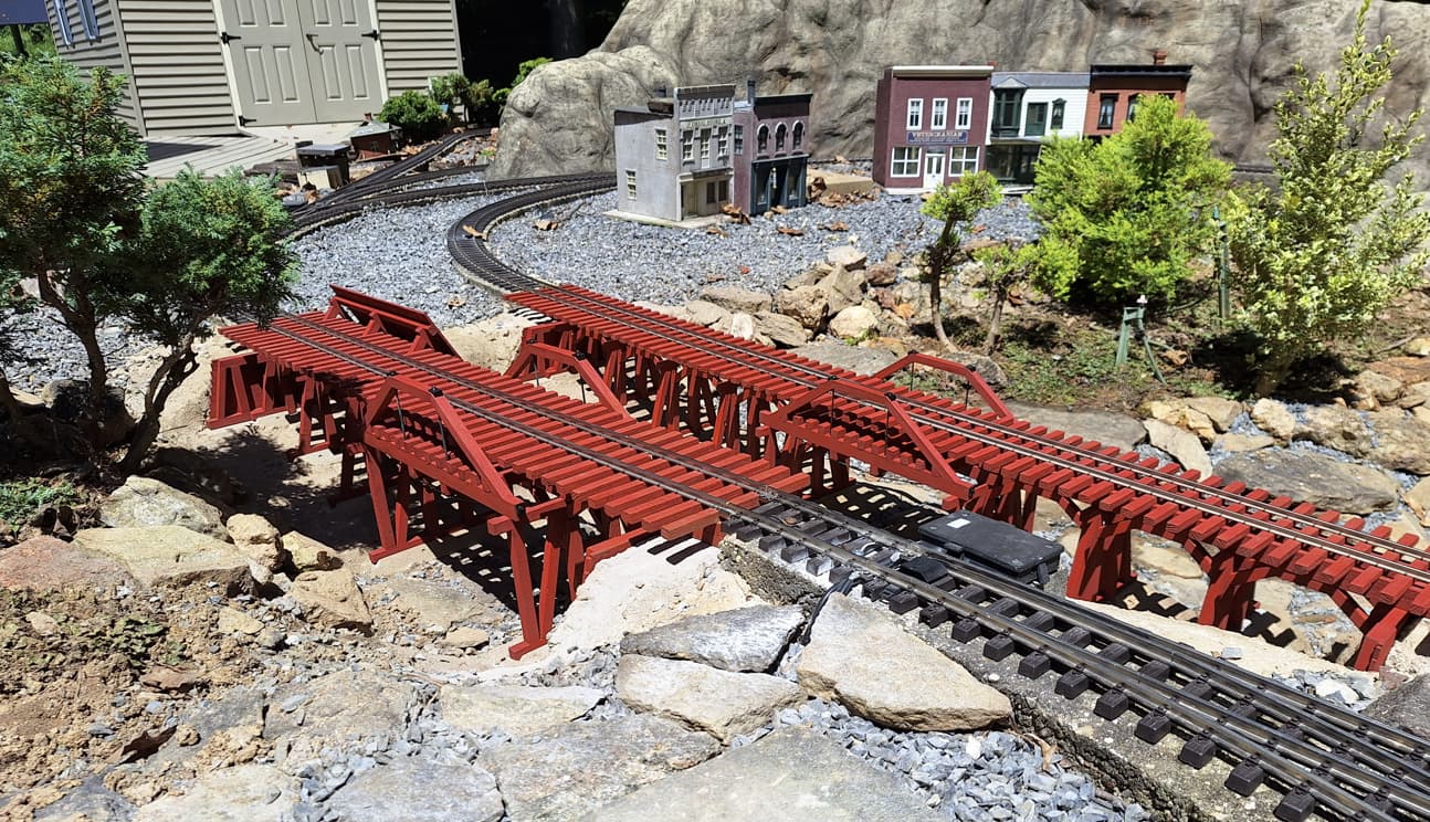

Been playing in the dirt and rocks and mud today. Stepping stones, “river bed,” hiding the sprinkler lines, re-rocking planter and other borders, reworking the outer wall, add mortar to a section of wall that was failing, tweaking the sprinkler locations & connections, replanting ground cover, moving the excess dirt to a place that can use it, and lots of cleanup.
Tomorrow I’ll hopefully get the trestles in and the trackwork done.
Cheers!

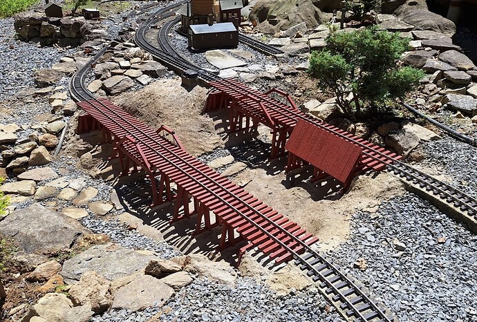

The trestles are planted. I was happy to see that the trestles fit their foundations and abutments without a hiccup.
Each incoming track took time, requiring a mix of cutting slightly longer rails, shimming, re-anchoring, additional bending, etc. So, it didn’t go as smoothly as I expected, but well enough.

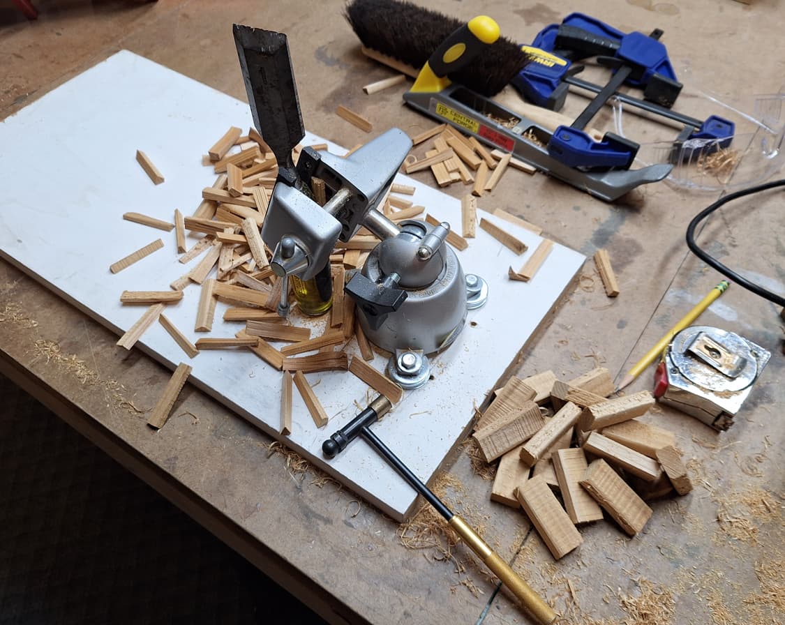

So after roughing up and cutting some cedar leftovers to around 2", I set up a “cordwood mill” and chopped the pieces. Went quickly.
