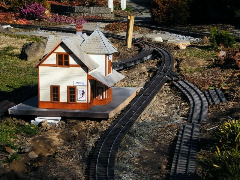

You could get that impression…and you’d probably be right. I put a white post next to one of my harp switch stands cause I was always trippin over it…and bent another one the other day working on the track work in Mancos. And that stick behind the station protects another one…
(http://i253.photobucket.com/albums/hh58/rgseng/Mancos/realign027.jpg)
And he’s not implying it, he’s saying it…
