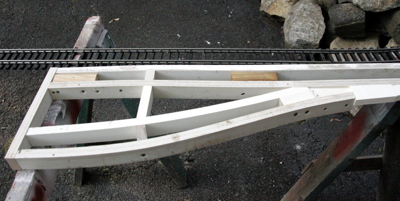

I normally mount all my switches on concrete pads which has worked well for me, but the location of the engine house switch is too close to a tree to dig for a pad - so ladder roadbed will support the switch. I’ve never done a switch pad for ladder before and found it quite challenging. After a full day of fooling around I had an acceptable product complete with custom bent track.
Track on top of the ladder - unsupported track will sit on the engine house floor…
(http://lsc.cvsry.com/post4/EngineHouse06-21-14_01.JPG)

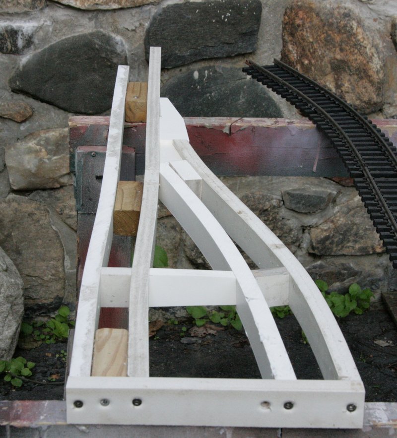

The straight path is a little wonkey, but it works…
(http://lsc.cvsry.com/post4/EngineHouse06-21-14_02.JPG)

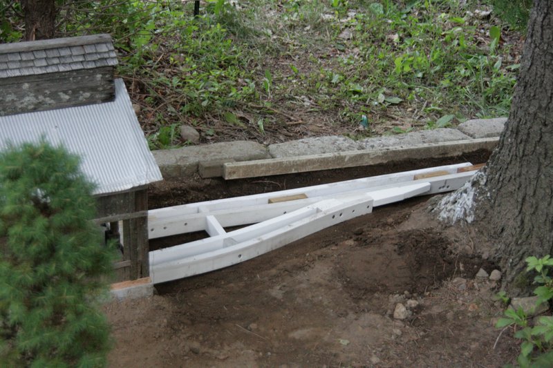

Side view…
(http://lsc.cvsry.com/post4/EngineHouse06-21-14_03.JPG)

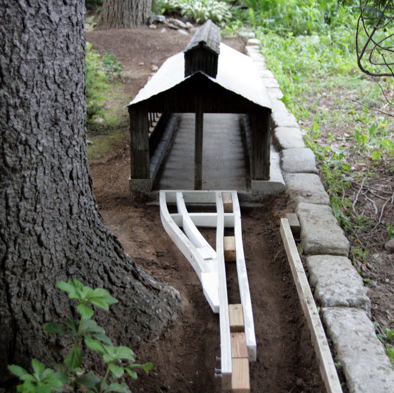

Test fit on the Engine House foundation…
(http://lsc.cvsry.com/post4/EngineHouse06-21-14_04.JPG)
Looks like it will work. Grade was set at 3%…
(http://lsc.cvsry.com/post4/EngineHouse06-21-14_05.JPG)
