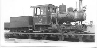

It looks like an articulated to me and very specifically a Mallet design (ish). The rear set of cylinders are smaller than the front set (compound) which is a characteristic of a Mallet due to the increased volume of the cooler steam. It also looks to me that there is no fixed boiler support on that front “truck” which would mean that the front truck could pivot.
Not sure what you mean by a compound cylinder arrangement and not being an articulated. Because a Mallet is by definition a compound arrangement. The boiler would not have to supply a full head to four cylinders. It supplies a full head to the two small-ones and then recycles it to the big ones. That is one of the key features that makes a Mallet a Mallet.
What I don’t see is the plumbing from the rear cylindrical to the front cylinders that I would expect to see.
