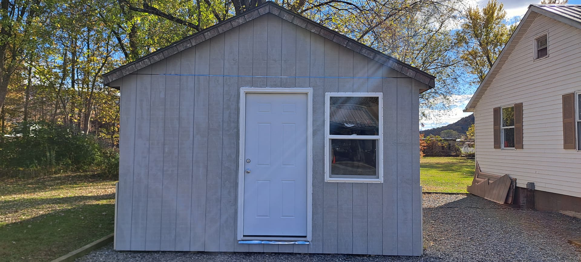

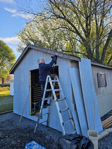

In the original framing they really weren’t tied together except by the siding, but even that had no framing so really nothing preventing the walls from spreading. The East wall (right in photos) leans out by almost 1.5" at the top. Siding wouldn’t mate. West wall leans a bit too, but not so much. If we had realized this before the framing went up, we could have put a cieling rafter in and possibly pulled the top together.
This shed It was originally built in-place where it was used as a garage for years. Later it was moved (probably dragged) here from across the street.
are you sure, that the door opening is broad enough?
It’s the correct rough opening for a 36" pre-hung door. I want a wide door so I can get my table saw and some big items in and out.

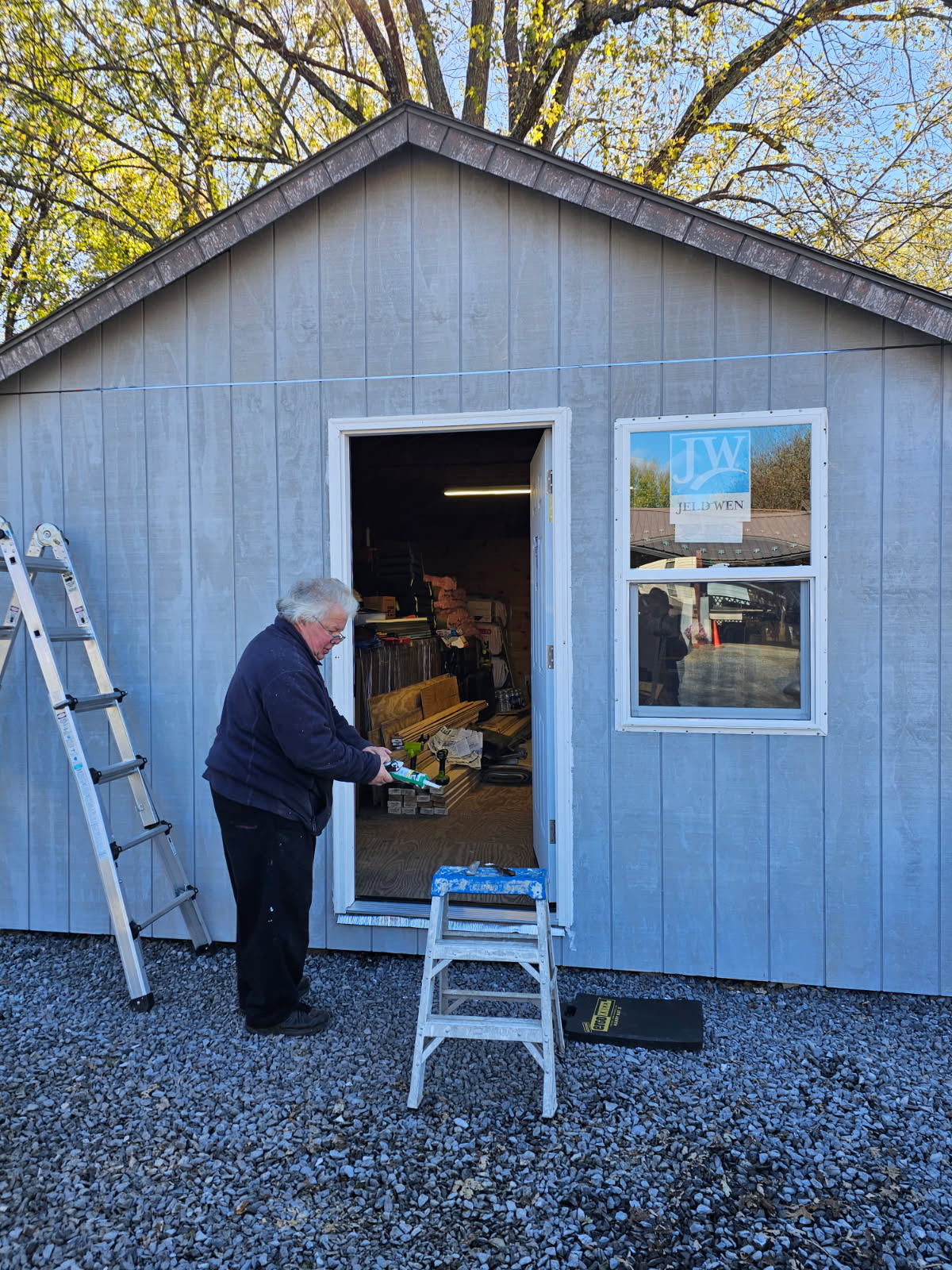

Just in the nick of time, the front exterior was closed in and the propane install completed allowing the furnace to be started. It has been in the mid twenties here for the last 4 or 5 mornings. I have stuff in what I’ll now refer to as the C.V.S.Ry. Rockhill Shop that wouldn’t like being frozen.
I made a 5AM run to Lewistown to get the needed Z flashing. That allowed us to close in the siding. The golden nail was driven on the siding before lunch…
The door and window were installed. There is still some work to do on both, like trim, but everything is basically weather tight in time for big rain here tomorrow…
The priority now shifts to closing in the old door, insulating the new wall, and then getting the cieling rafters and insulation in. I don’t want to burn through that 200 gallons of propane in the first month!
It’s really starting to feel like my place!

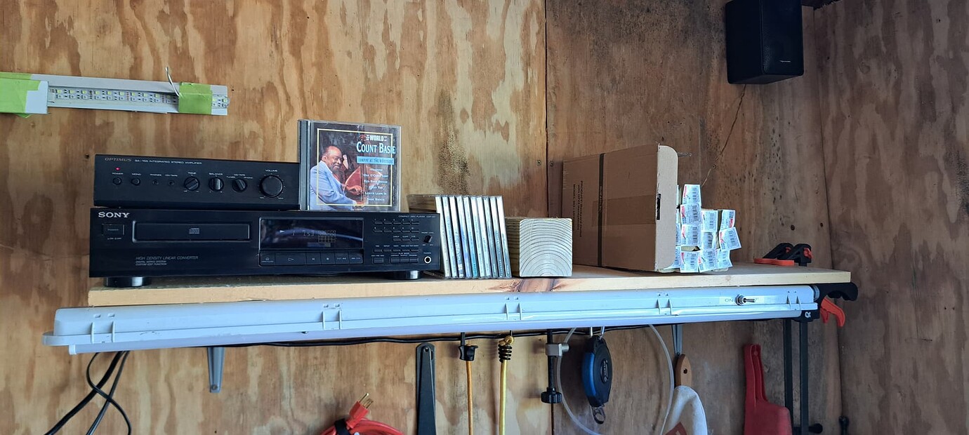

Jon, hope you’ve got stereophonic surround sound installed in the shed.
The temporary system is stereo…
I had 5.1 in the CT basement. The equipment will go in here when construction is done.

I ruled out wood, because I need heat 24/7 all winter. Pellet stoves are nice, but the maintenance to clean them and haul pellets is more than I want to deal with. A mini-split unit would be ideal, but I couldn’t afford what it would take to feed a 50A sub panel in the shed. Propane was my solution. Installing the gas line cost twice what I expected, but all together, the propane solution probably cost half or less what the split would have been.
So far, even without the front wall or roof insulated, my little 16.7K BTU wall furnace is doing great. Hopefully before the temps are real cold all day I will have the room fully insulated. I’m still working on sealing up wall openings!
