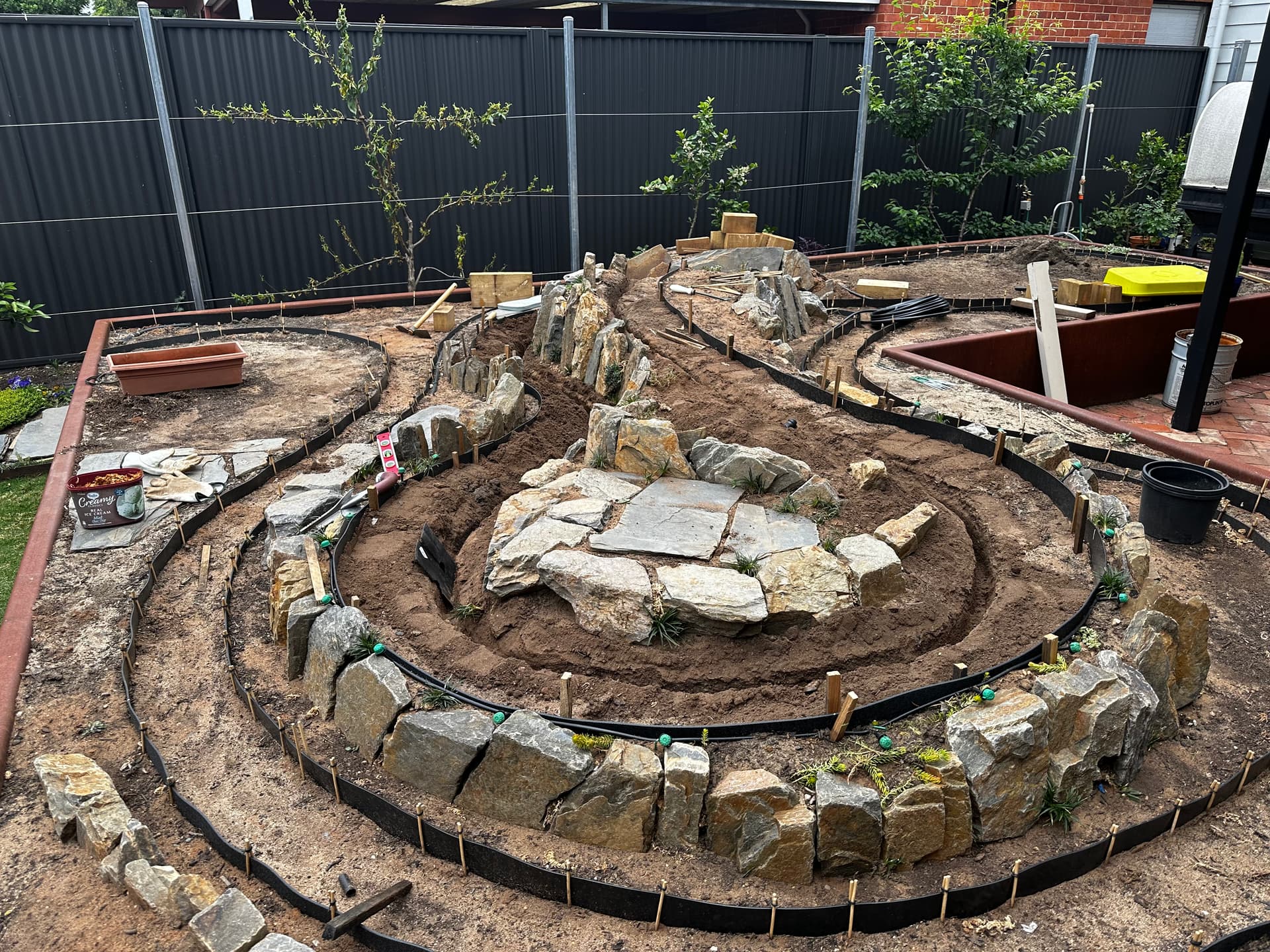

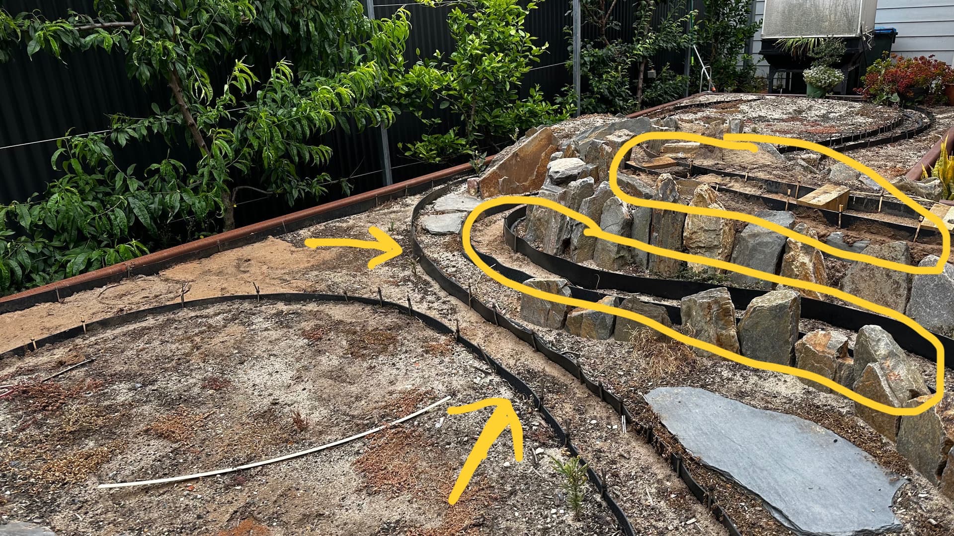

After a year of unexpected interruptions, the garden railway endured a prolonged period of unintentional neglect. During that time, a substantial section of garden edging worked loose. The affected area was approximately 400 litres (14 cubic feet) short of soil, and the edging—only shallowly set on a 3%-grade right-of-way—shifted out of position as the soil settled.
Sigh

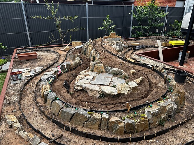

I was hoping that I would be able to find this American ACE Hardware edging here as it would have been much easier to lay and maintain.
IMG_9120

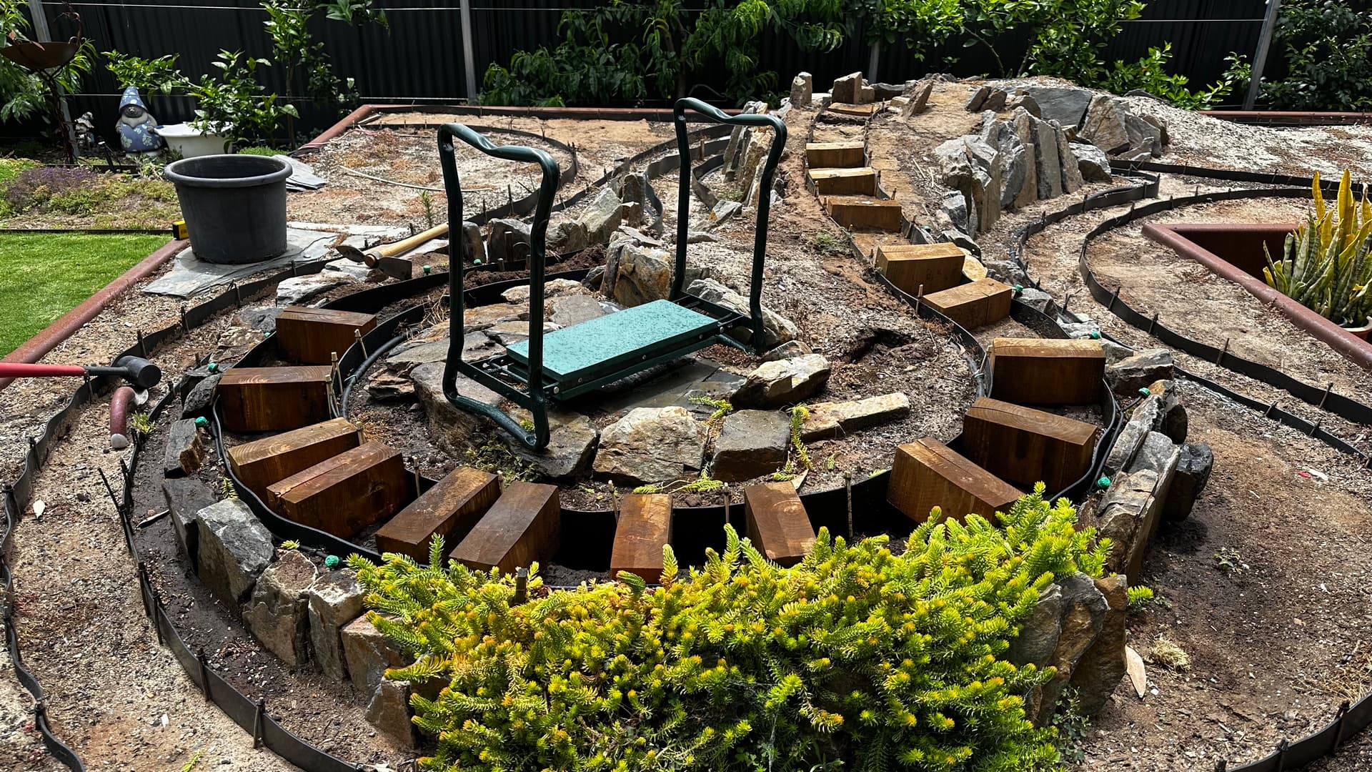

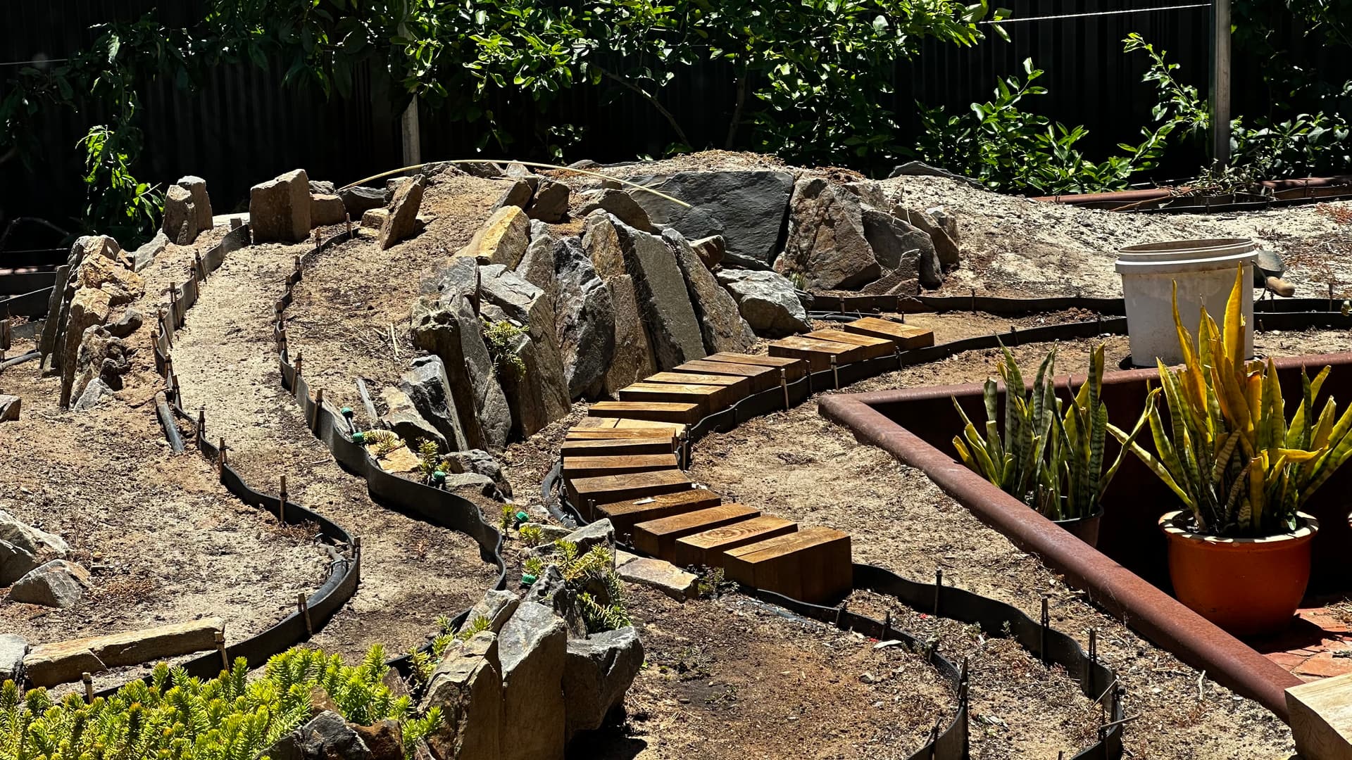

So this is the section currently being relaid. The arrows show other places where the ROW has narrowed and the edging has lifted.

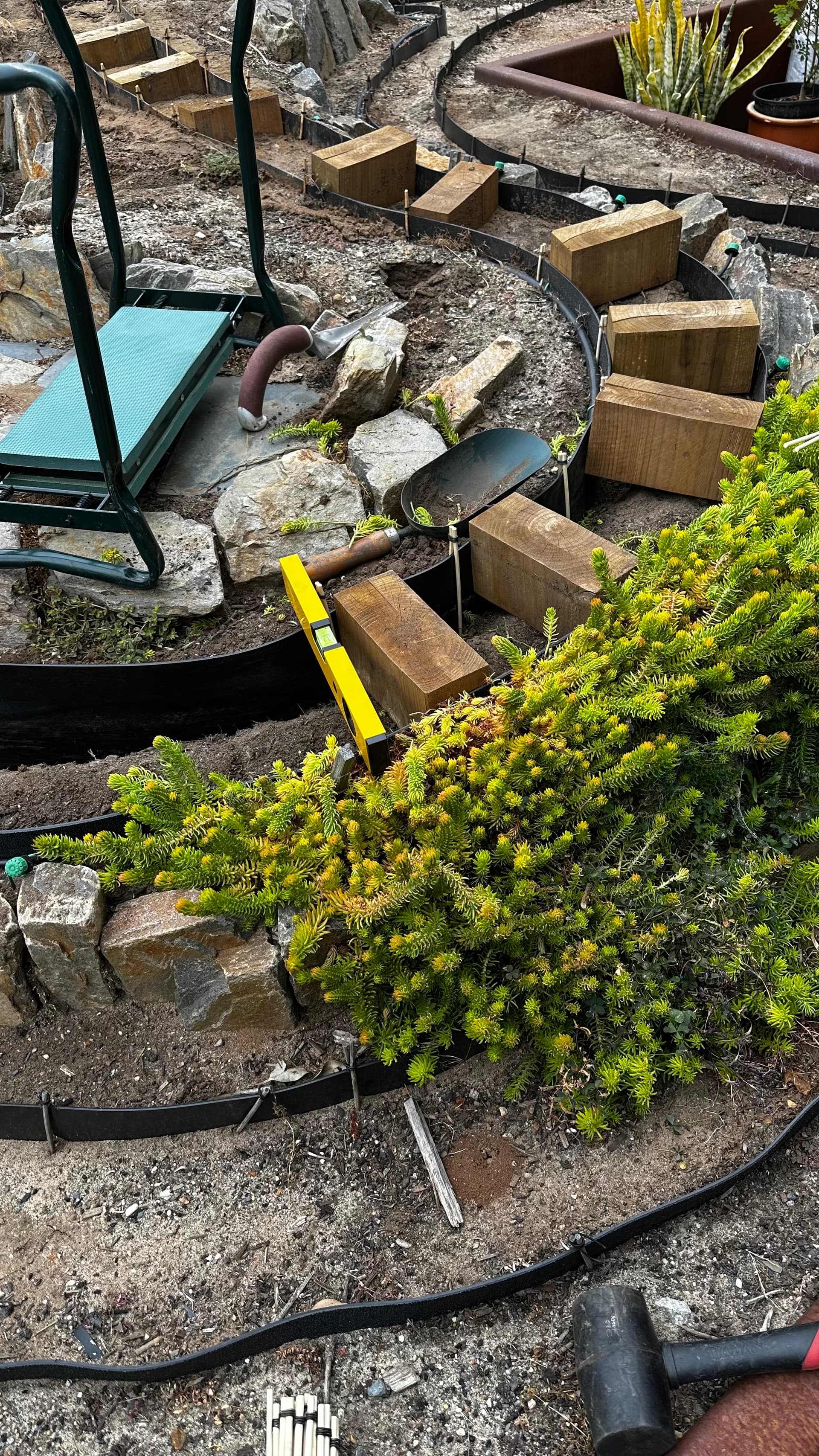

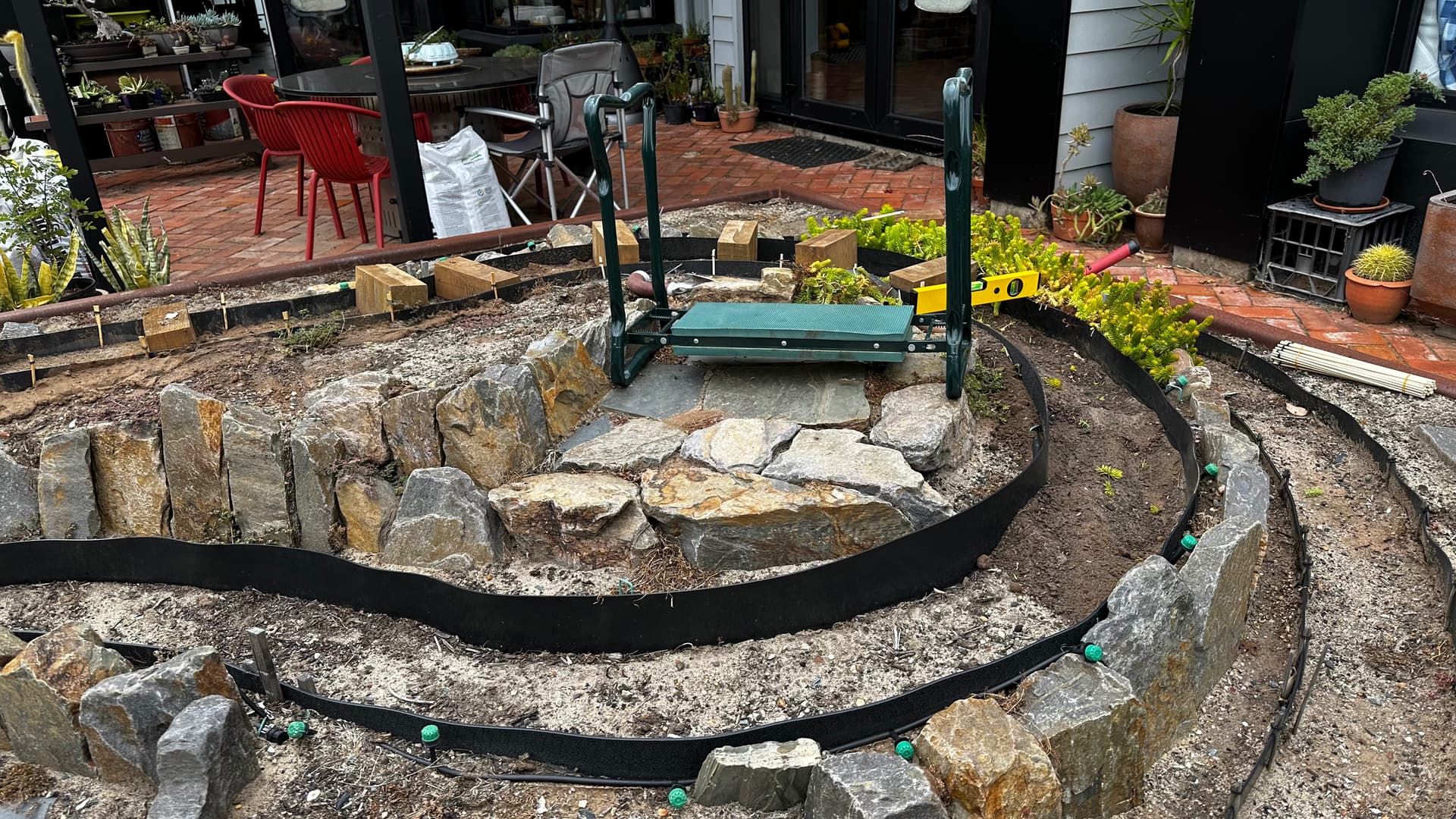

In this section from the kneeler (pictured) clockwise, only one side of the edging needs to be relaid. The opposite run of garden edging is being used as a reference for levelling purposes, while the soil is carefully tamped to hold everything in place.

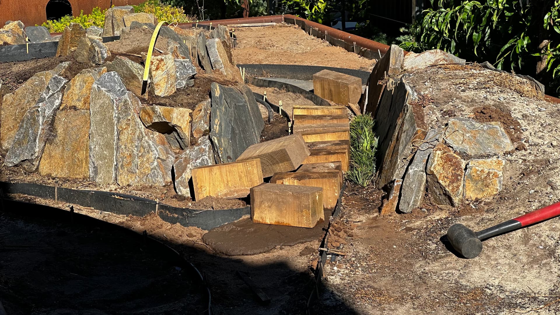

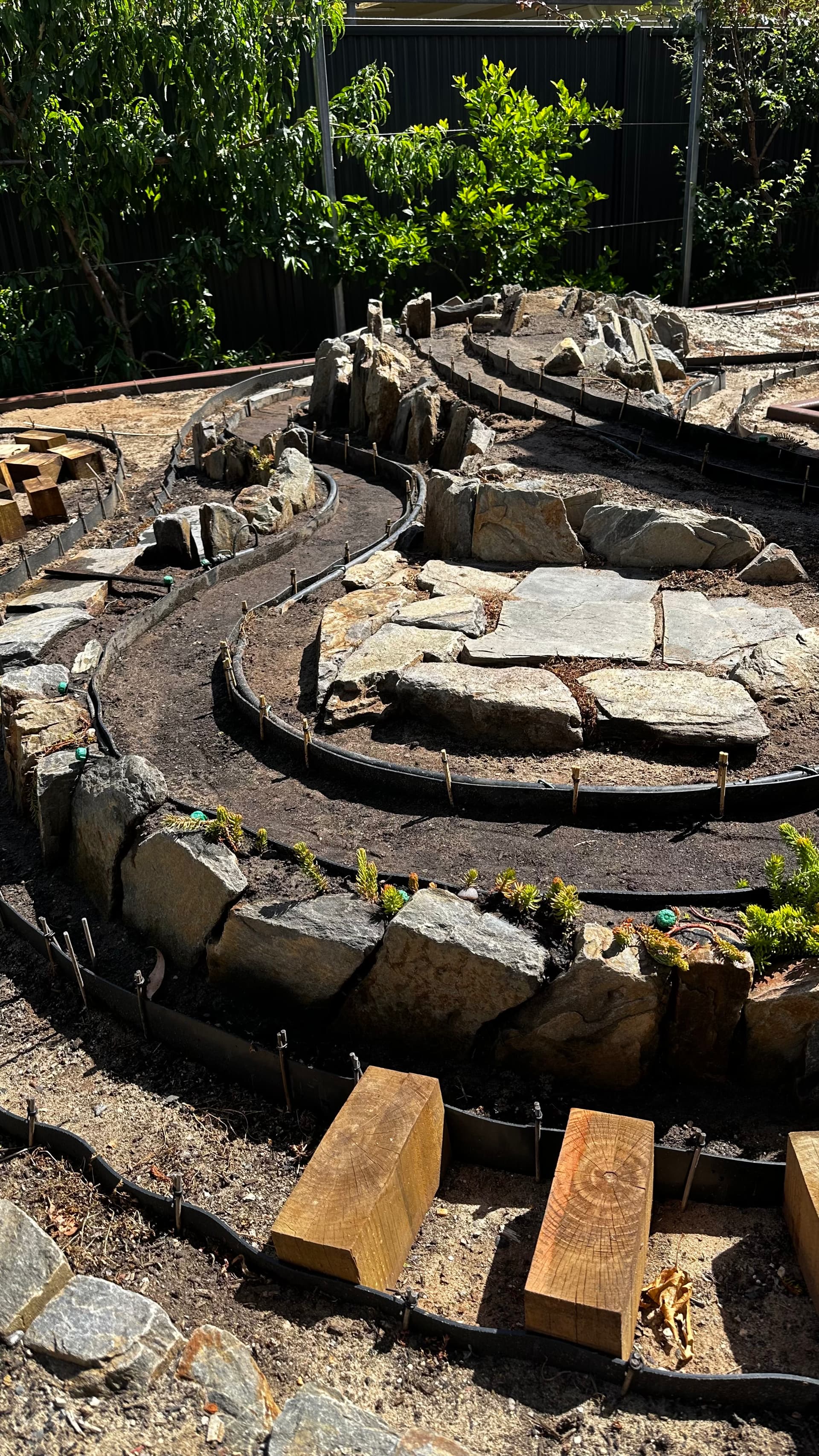

I’m using wooden spacers to maintain some uniformity to the ROW.
It’s been surprisingly difficult to trench the soil to replace the edging. I’ve been able to work 2 meter sections at a time.
Here is one section where the succulents did not die out. Luckily they seem hardy on transplantation.

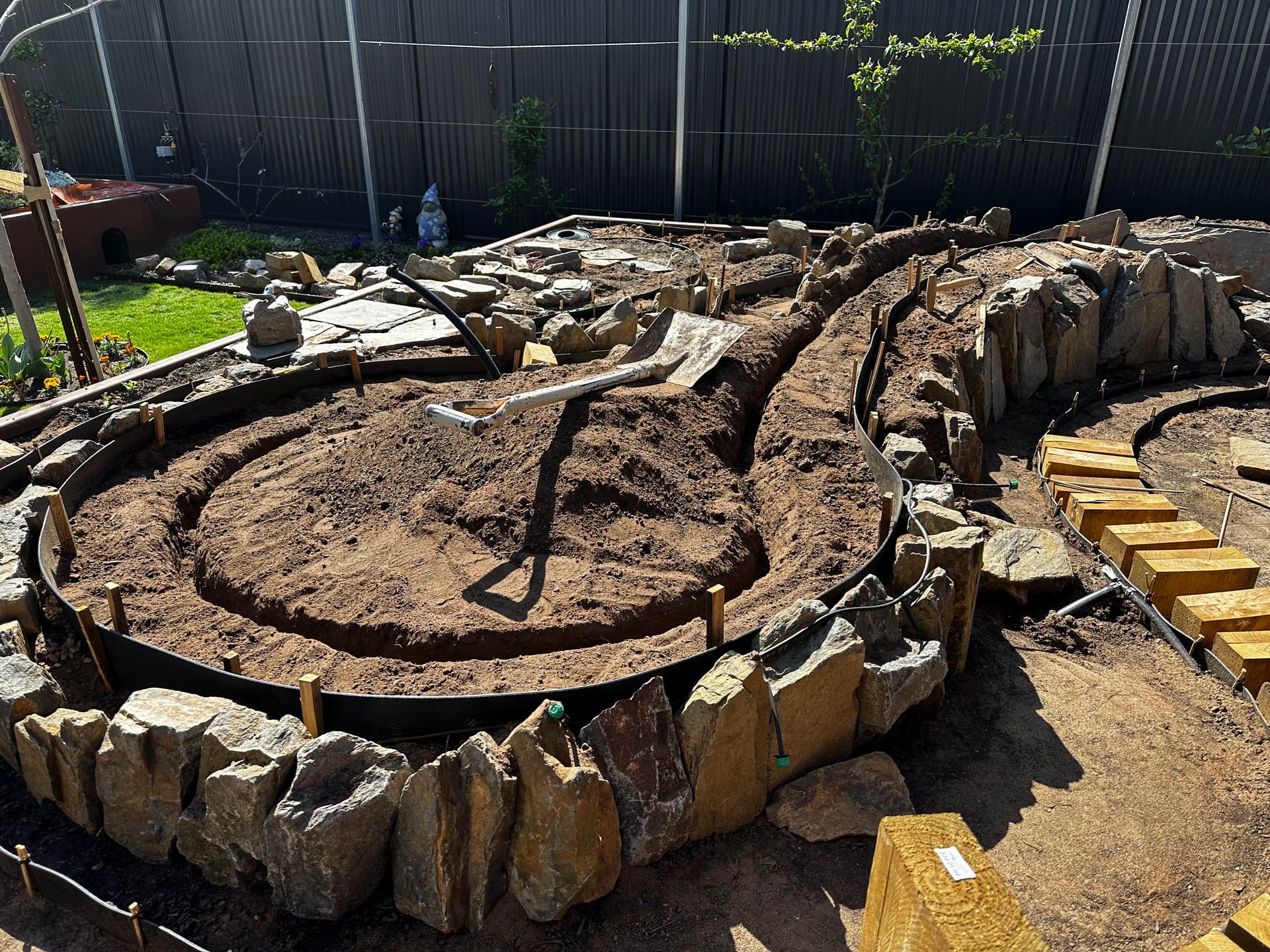

The technique I’m using involves soaking the sandy loam in a bucket and letting it flow into the trench with the levelled, staked and spaced garden edging in place. It is kind of like making sand castles.
Then using stomp action (similar to GHA Bruce @Deneh) to ensure both sides of the edging stays in place.

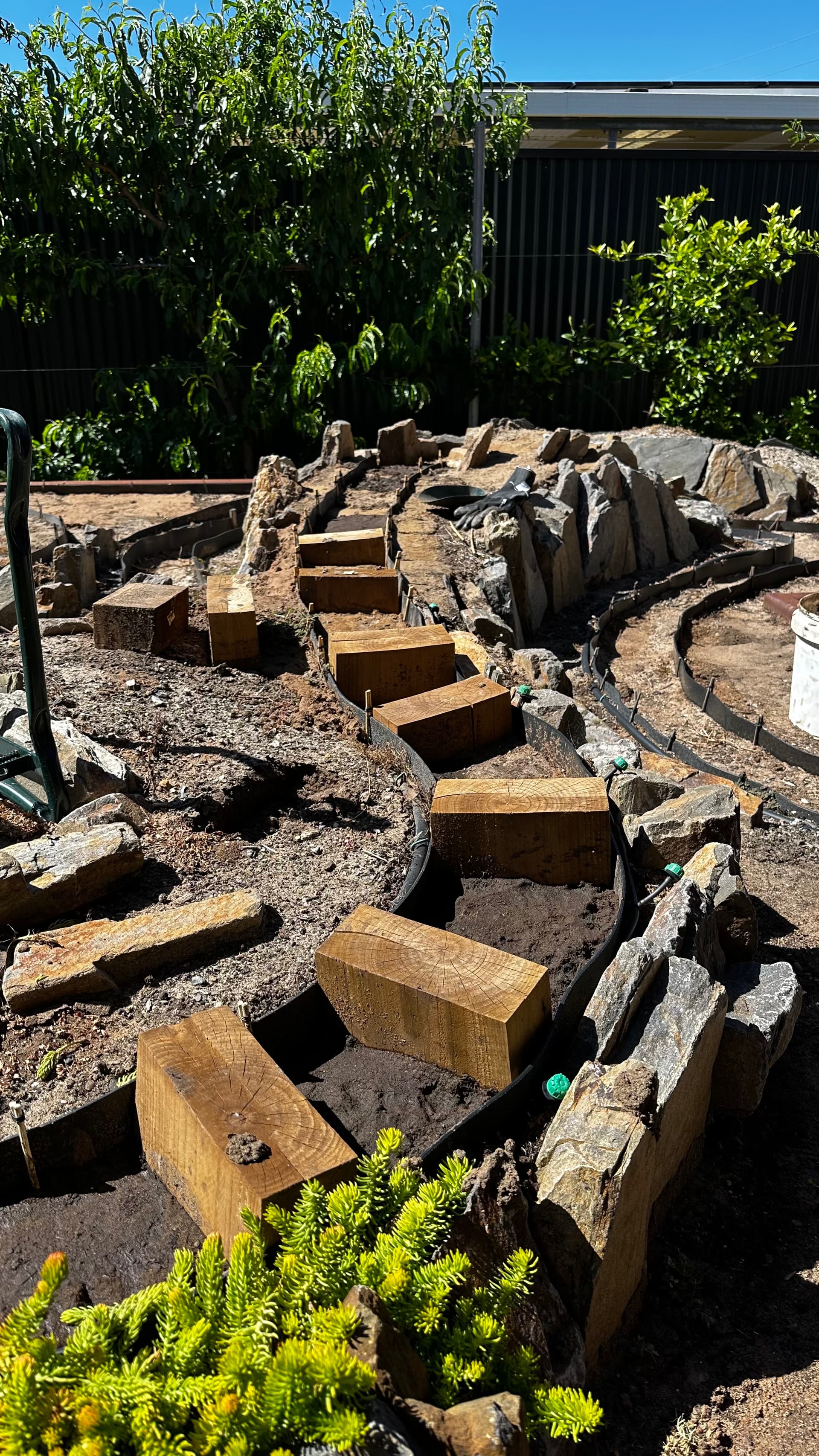

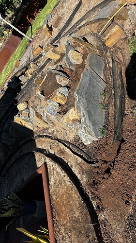

As I transition from 3%grade to the flat (in the cut) I run into difficulties again.
The ROW in the cut had narrowed and most of the mini-mondo grass had died, so the process became even more of a pain.
So I had to play around with the watering system as well. But as of today I’m now on the flat section.

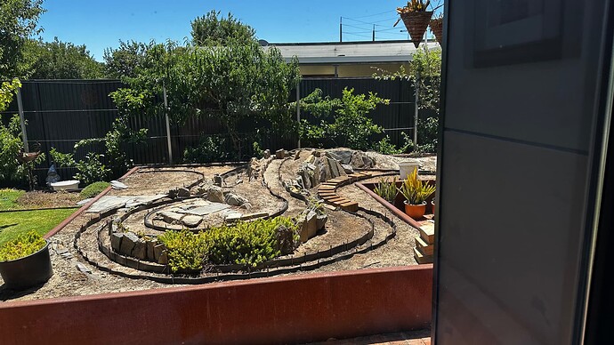

The last two photos are from inside the house, as the temperature has hit 43°, so hot that folks near us went out and fried an egg on the sidewalk.

The edging is 15 × 3.2 mm PETG: smooth on one side, pebbled on the other. It’s stiff enough that it doesn’t like bending in the heat, but it does have a tendency to buckle slightly. Steel would have been the obvious solution, but it was prohibitively expensive.
