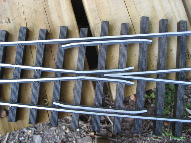

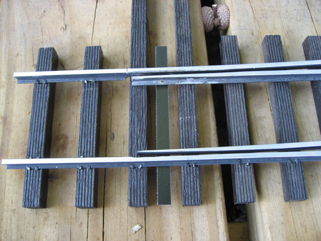

I just got my order from http://www.switchcrafters.com - I ordered a #6 and a #8. Initial impressions are very good. They’re a bit cheaper than some of the others and appear pretty well made. They are quite long and have continous rail for the points, which I like. As a no charge option, he coated the sides of the rail - I think it looks nice. Here’s some closeups:
And a shot next to some Micro Engineering Track
And next to some AMS track:
Of course the real test will be when I get these down on my layout. That may be a while.

Those are nice, and the prices really can’t be beat. I’m a bit curious to see how things operate through the frog, if there’s any bumping because of there being no bottom on the flangeway. Technically speaking, that shouldn’t be a problem, but it will be interesting to see how it works in reality.
How springy are the points? I’m assuming you’d need a rigid ground throw for those, since they’ve a natural tendency to center between the rails. Probably not the best choice for the base of a reverse loop, but a few seconds with a Dremel tool and a railjoiner would remedy that in short order, too.

I know a few of mine I built that way I ended up haveing to put a little 'bottom" in the frog…

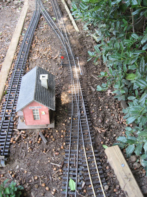

Bruce, you have a #8 down already? Can we get some pictures of it? How smooth is the diverging route at speed? I need a couple #8s,and am considering buying them from this guy…
It’s too dark for pictures. Maybe tomorrow? :smiley:
Seems pretty smooth to me. I really like these swithes.

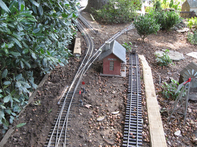

Here’s a shot with a #8 in the foreground and a #6 just behind it.
Looking towards the yard; the main curves off to the left. The route to the right is my interchange track which also serves as the cutoff when I run loopy.
And this is AFTER we cleaned up acorns…
