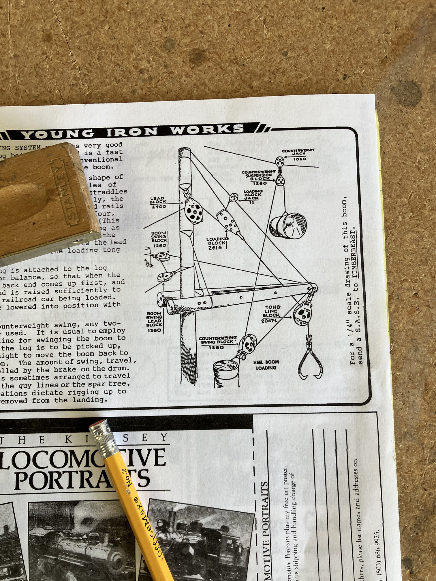

Here is a diagram of a basic Heel Boom loading system on a Spar tree. The boom stays stable in elevation but swings left to right. One donkey drum controls the line that the tongs are hooked to that lift the logs.
The other drum controls the swing of the boom. The drum line tightens and swings the boom into position to attach the tongs to a log which is then lifted and nestled against the “heel” of the boom.
When the drum slacks the line a counter weight pulls the boom into car loading position.
A diagram of a typical heel boom loader rigging.

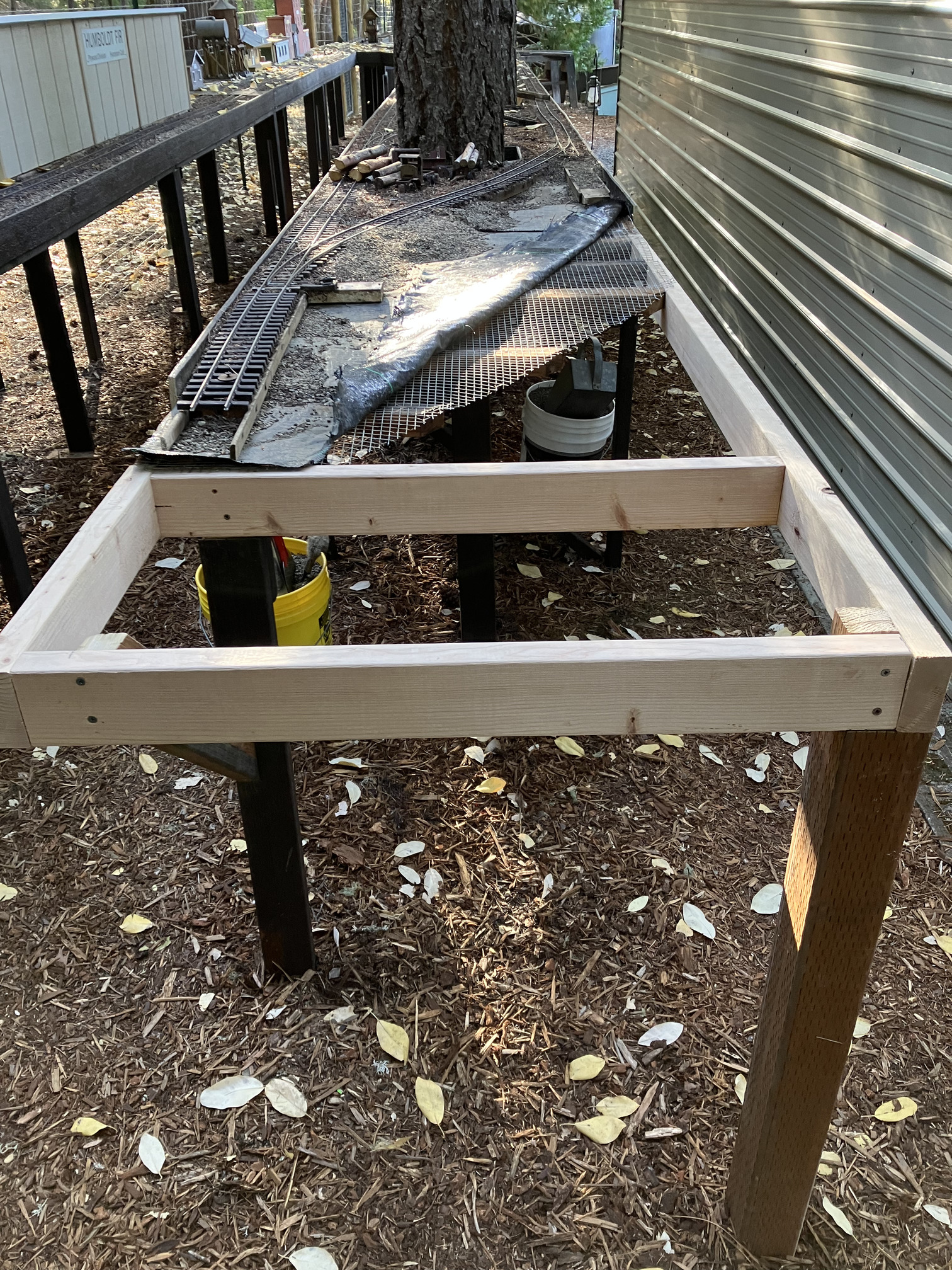

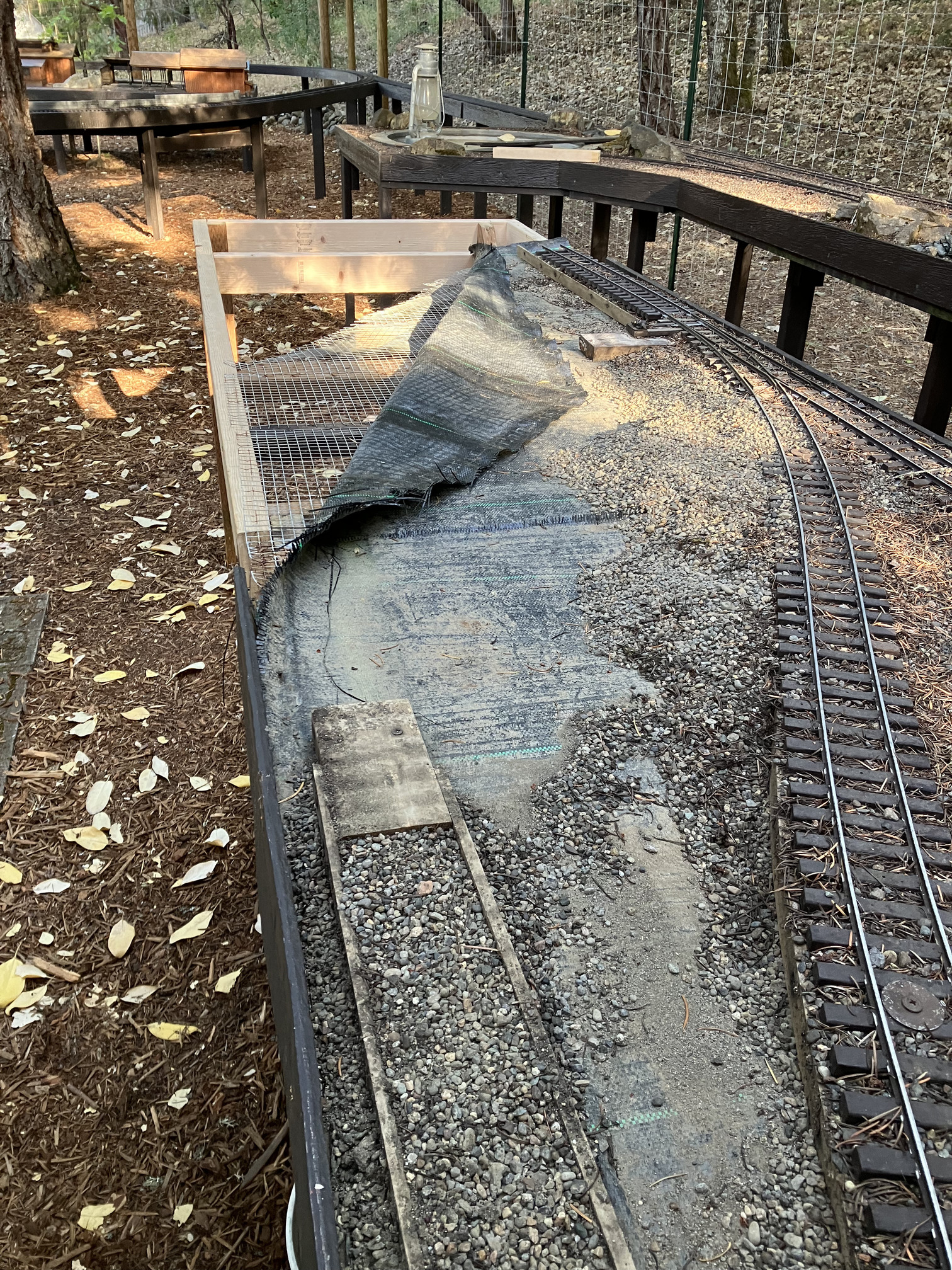

OK,
so the first thing was to acquire the Real Estate necessary for this addition. Luckily the South Fork Timber Co. holds the controlling interest in the Shasta Pacific RR company. The SP being licensed as a Common Carrier has the right of Imminent Domain so the acquisition of ROW was straight forward.
I added about 4 feet on the left and about 18 inches on the right to the existing table. You can see the old table edge by looking at the edge of the hardware cloth wire.
Another view in case the first wasn’t clear.
More to follow if I can get things done sometime soon.
