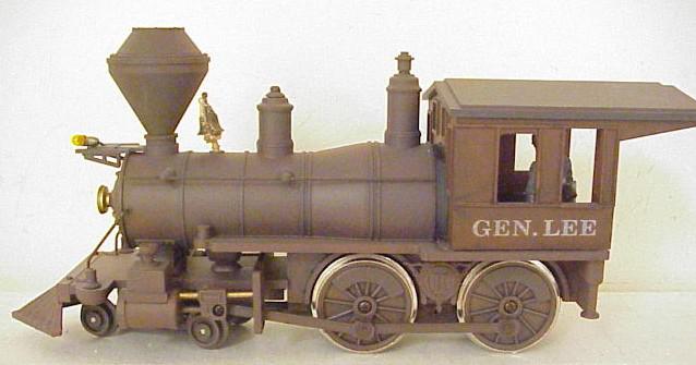

This the one?
https://s3.amazonaws.com/community.trainz.com/MT-0586531/MT-0586531_50F0112_large.jpg
[https://image.invaluable.com/housePhotos/stout/94/719694/H2651-L282917958.JPG]
(https://image.invaluable.com/housePhotos/stout/94/719694/H2651-L282917958.JPG)

Rooster – Pictures? Yes, lots, my engine is this Kalamazoo Yankee one:
